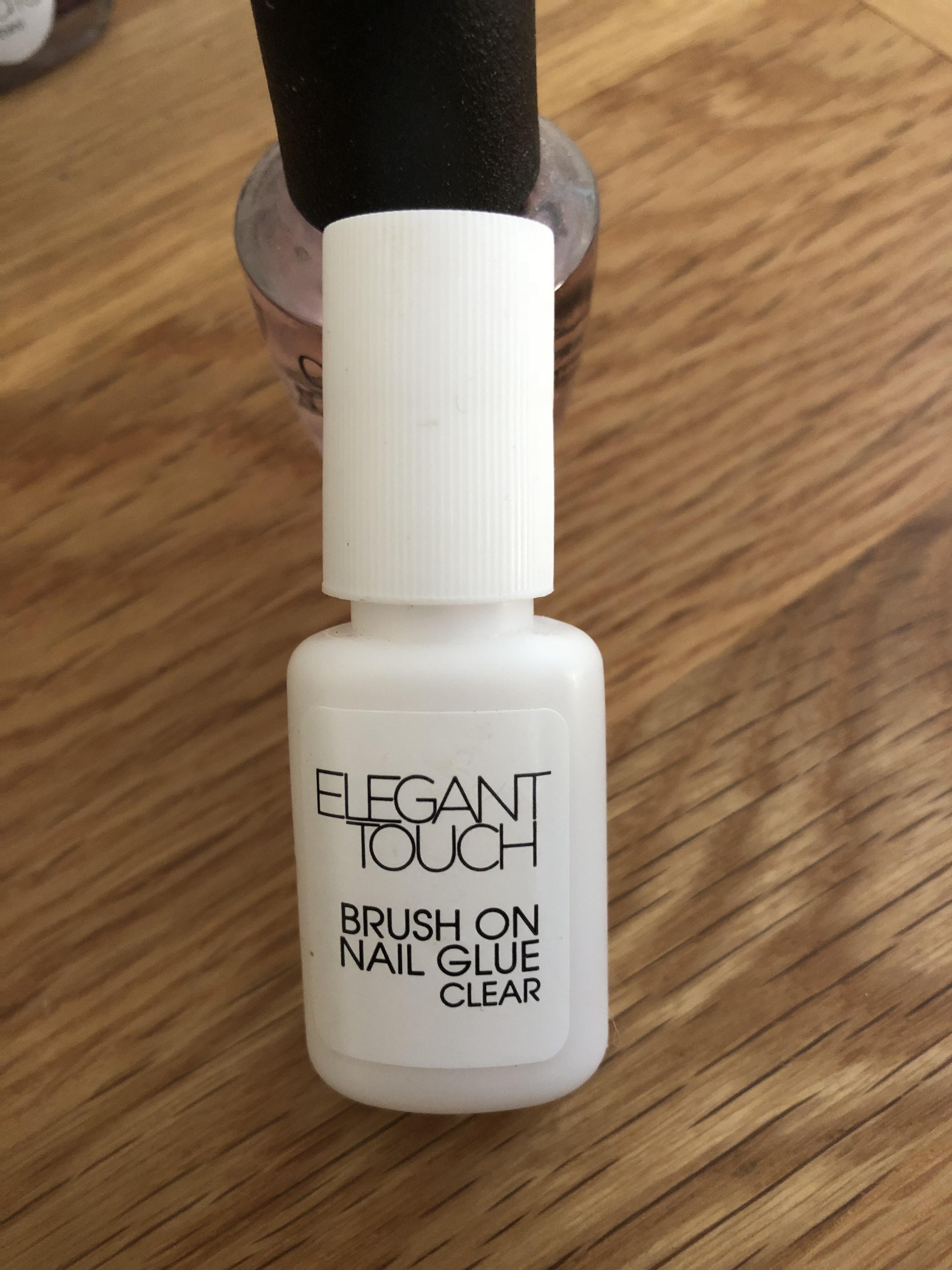

newhome Posted June 25, 2018 Author Posted June 25, 2018 Thanks! This is the one with the brush (and you can see what it’s for ) that’s gone claggy. It’s just cyanoacrylate too but more expensive than superglue so I’ve started buying the tubes. Seems it’s a waste of money to buy the branded tubes then and I may as well go to the pound shop. Cheers, will try the fridge. Is Mitre bond exactly the same and dries opaque(ish)?

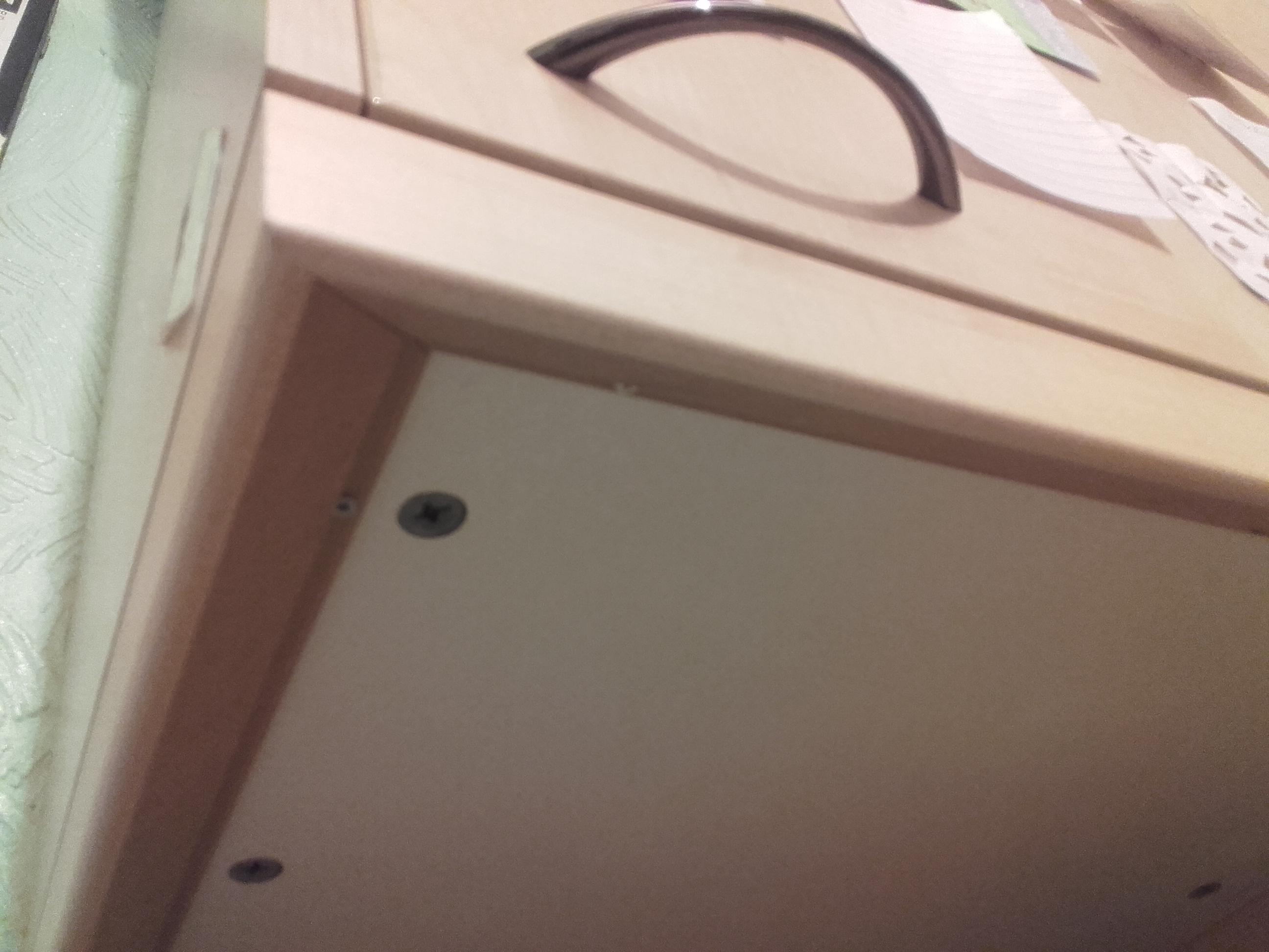

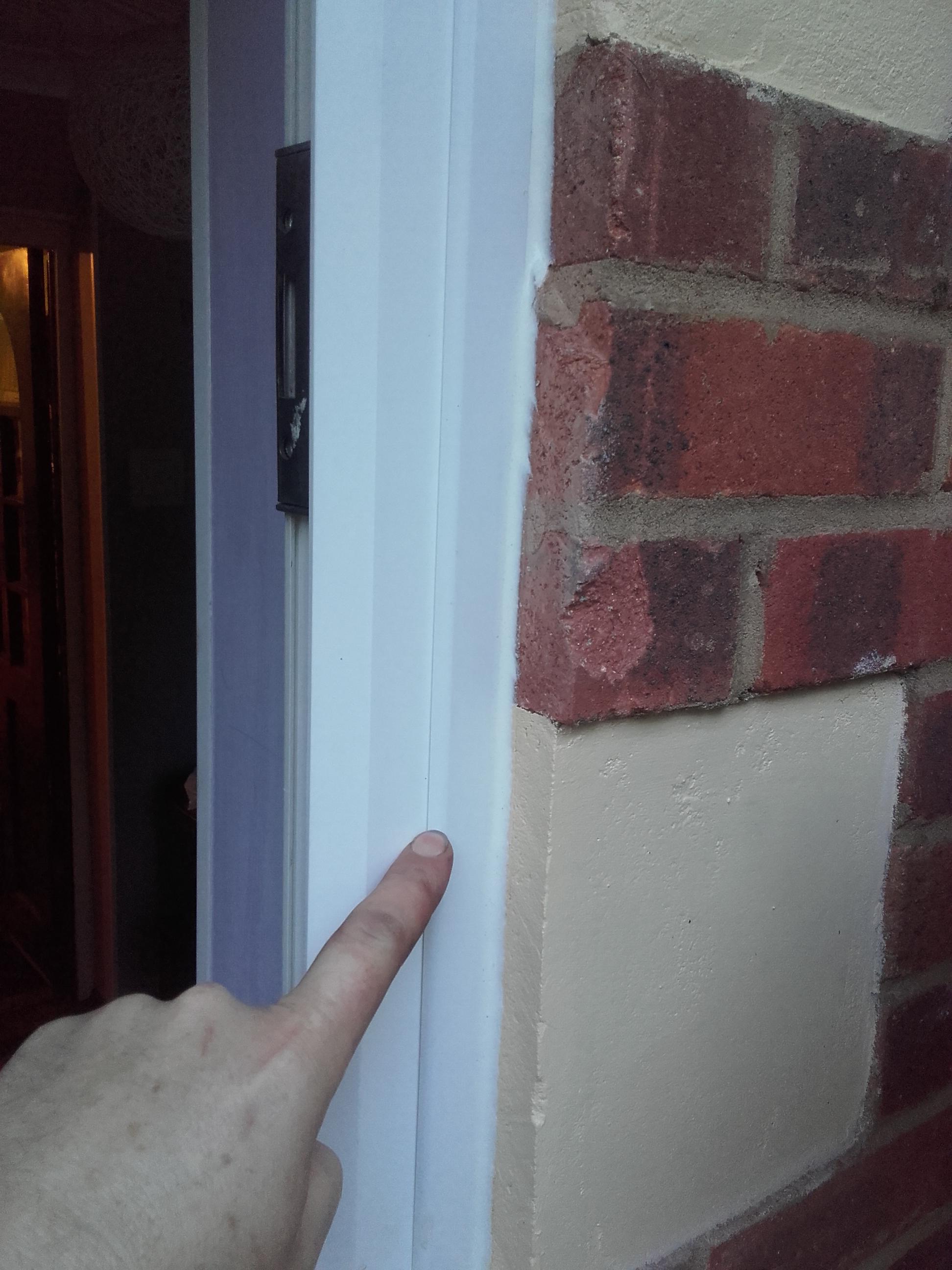

Onoff Posted June 25, 2018 Posted June 25, 2018 10 minutes ago, newhome said: So how does the 2 part stuff work? Put the glue on, stick the item together then spray the stuff? Or spray it before you press together? Can see that working for normal diy stuff but can’t see it working on nails tbh ? . Would like some to be multi purpose if possible and ideally I’d like one that dries clear or worst case opaque. Can’t have yellow smoker’s nails! And @Onoff ‘claggy’ will forever be tainted now! I first saw window fitters use it. See this bit of trim I've fitted to a freebie 2G door I scored. The trim covers the slightly ragged edge where the walls been cut out for the upvc frame. WITHOUT the trim (bit I'm pointing to) you spray activator up the height of the door. You run a bead of glue up the back of the trim piece and push on. Instantly stuck. @Nickfromwales reckons it for sticking tile trims on too. And kitchen cornice too: 1

lizzie Posted June 25, 2018 Posted June 25, 2018 @newhome that brand with the brush is the one i have real problems with but its so much easier to use than the tubes
newhome Posted June 25, 2018 Author Posted June 25, 2018 6 minutes ago, lizzie said: @newhome that brand with the brush is the one i have real problems with but its so much easier to use than the tubes Yes the brush makes it much easier. The tubes are god awful things. Press it and nothing comes out, press it again and it goes everywhere! 1
