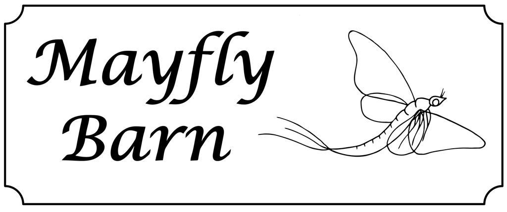

Jeremy Harris Posted June 23, 2018 Share Posted June 23, 2018 I had hoped to have my home-made CNC router built by now, but I've been too busy to put it all together and then learn how to drive it. It's first job was going to be making an oak house sign for the new house. I have the design drawn up in CAD, and also have a selection of oak boards, so I'm looking for someone who can rout out the design for me. The sign is about 500mm x 200mm, and includes text and a simple line graphic, that I'm hoping should be fairly easy to cut with a vee routing bit. All I can find online are people who make complete custom house signs, and they are expensive, as they include hand finishing, sealing etc, all stuff I'm happy to do myself. Does anyone know of someone with a small CNC router that could do this job for a reasonable fee, please? Link to comment Share on other sites More sharing options...

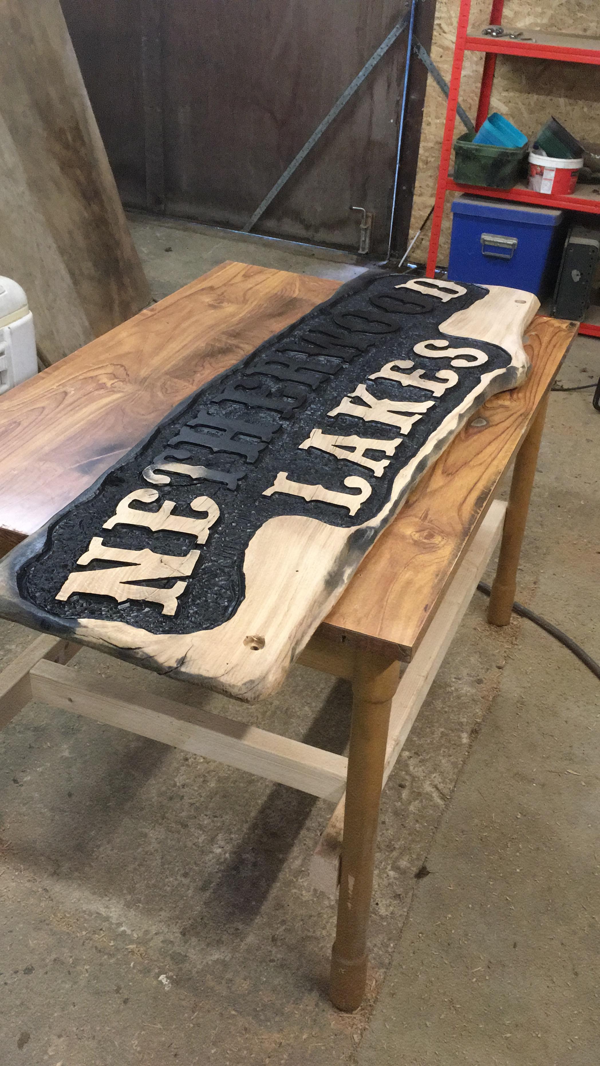

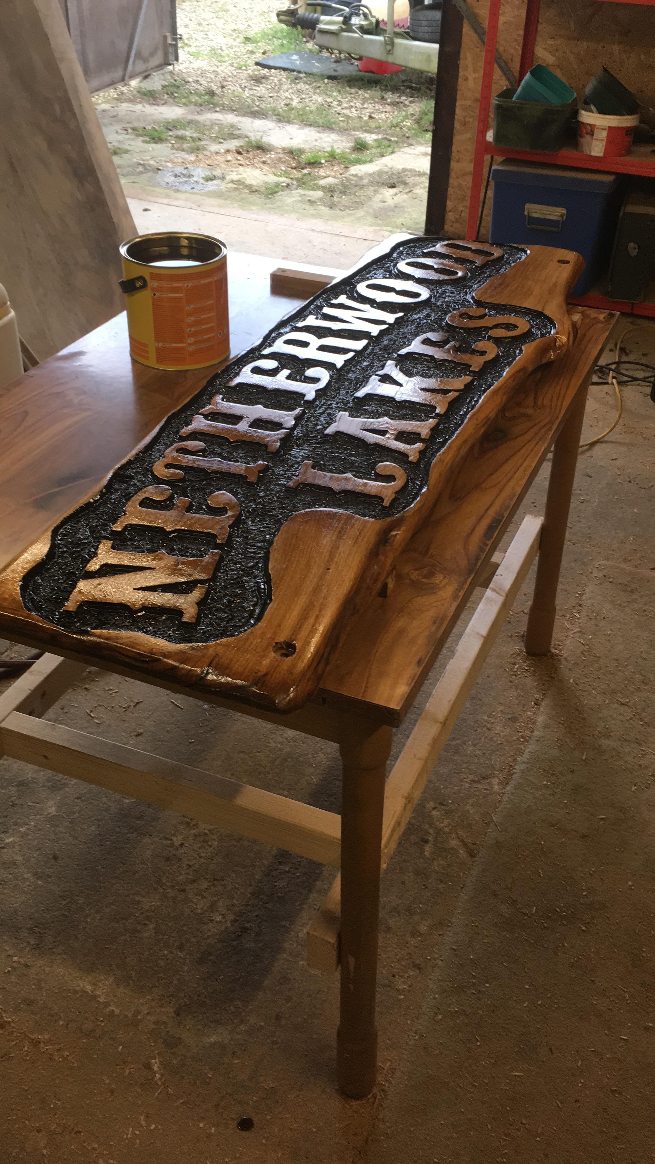

Russell griffiths Posted June 23, 2018 Share Posted June 23, 2018 Blue peter style one I made earlier 3 1 Link to comment Share on other sites More sharing options...
Russell griffiths Posted June 23, 2018 Share Posted June 23, 2018 I did this one by hand freestyle if you fancy doing it yourself I could point you in the right direction for the correct bits, and the better type of router if you haven’t got the time or inclination, I can’t help sorry. @JSHarris Link to comment Share on other sites More sharing options...
Jeremy Harris Posted June 23, 2018 Author Share Posted June 23, 2018 Very many thanks, but I don't think my routing skills are up to that quality! I have the design sketched out, and having seen a CNC router working I'm sure it wouldn't take long to do. I probably have enough oak to do two or three, so could cope with one being screwed up. This is the design: Link to comment Share on other sites More sharing options...

MikeSharp01 Posted June 23, 2018 Share Posted June 23, 2018 The picture you gave is fine for the fly, the machine will scan it, and for the text just let me know the font. Link to comment Share on other sites More sharing options...

Jeremy Harris Posted June 23, 2018 Author Share Posted June 23, 2018 The font is Lucida Calligraphy, approximately 180pt, or around 50mm high for the capital "M". I have the artwork as a pen and ink line drawing that my sister did for me that I've scanned and can either send a JPG or a print at the right scale. I think I've enough 20mm thick oak to make at least three blanks, but need to check, and it'll be a few days until I'm able to sort if out, as we're away for my mother's funeral much of next week. Thanks again. Link to comment Share on other sites More sharing options...

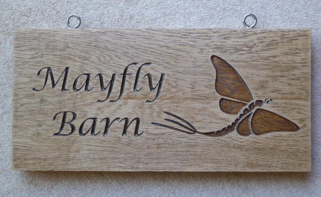

Jeremy Harris Posted July 25, 2018 Author Share Posted July 25, 2018 Just to close this off, by chance I was talking to a neighbour who happened to have a 4ft x 4ft home made CNC router in his workshop. So. rather than take up @MikeSharp01s kind offer, I decided to have a go myself, under the guidance of my neighbour, who clearly had a fair bit of experience of driving the software. I laminated up some of our left-over oak skirting boards, that were 120mm x 20mm, to make a double thickness board, with the joins offset and the grain as best matched as I could make it on the joins. I ran my router down each pair of boards to be edge glued just to make sure I got a tight joint. When epoxied together I ended up with a board about 40mm thick, 500mm long and 240mm high. We started off by playing around with the mayfly design to make it easier to route out - took a couple of ours of fiddling to simplify it and make it looks reasonable. Next, we took a thin skim of both side of the sign (it's double sided) to make sure it was dead flat. The routing out of the text and mayfly was pretty simple after that, we ran a test on a bit of MDF, which looked OK, then went for it with the oak. It came out pretty well, and I stained the oak with a dark oak wood stain, then sanded the flat surfaces to remove most of the stain, leaving the routed out bits much darker. Two coats of clear exterior finish and it looks like this, ready to go up on the gallows post I managed to get concreted in on Monday: 7 Link to comment Share on other sites More sharing options...
MikeSharp01 Posted July 25, 2018 Share Posted July 25, 2018 Looks great @JSHarris they are great machines aren't they. 1 Link to comment Share on other sites More sharing options...
Jeremy Harris Posted July 25, 2018 Author Share Posted July 25, 2018 8 minutes ago, MikeSharp01 said: Looks great @JSHarris they are great machines aren't they. Thanks, I'm pretty pleased with it as a first effort, albeit with a lot of help. It's made me all the more determined to assemble all the parts I have for the one I was planning to build - that stalled when we started building the house, but I have all the parts to make the frame, gantry, all the linear rails and bearings, even the stepper motors and lead screws, and a part built brushless motor driven spindle, with an ER15 collet. Link to comment Share on other sites More sharing options...
