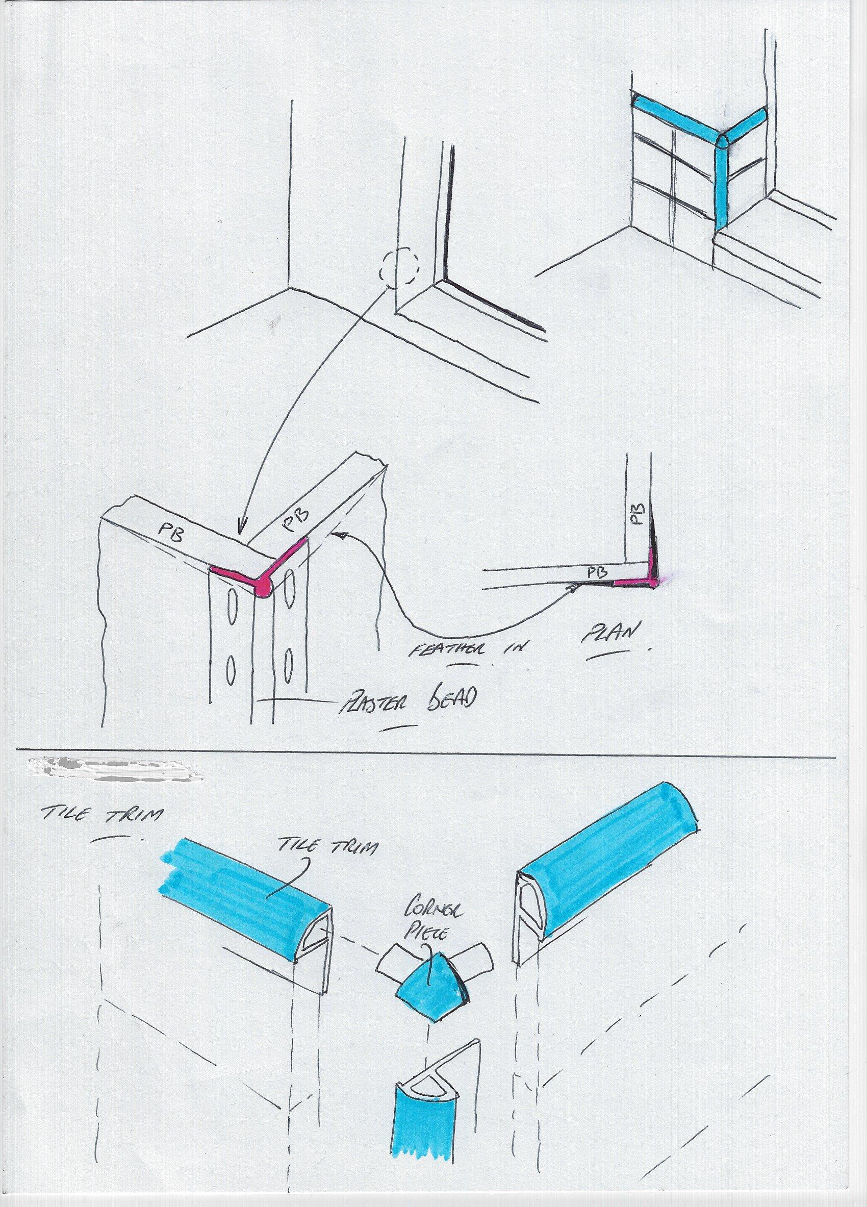

zoothorn Posted October 3, 2018 Author Posted October 3, 2018 @Onoff can you give me an idea how I finish the 3 sides of the reveal area: do these need finishing before the tiling of the corner area (simply the 2 big pB face areas above blender & gaggia)? I was thinking of tiling today, from the LHS vertical edge @ reveal here >> end on RHS vertical edge of the other sill, as I thought this simplest. But exactly where to start the very 1st tile (relative to the reveal edge, at Left, this -is- where I will start from).. I don't know. Set across the reveal edge 1cm? or flush with reveal edge? if flush then how the bare pB ends will be finished/ how much thickness this will add etc etc. I could tile the reveal.. but, I 'm only going up to 60cm of corner, which equates to 2/3rds way up reveal (if I follow this tile top line around).. so what happens to this last 1/3rd of bare pB reveal sides, & upper reveal section.. also as you can see the sink reveal side has a bad convex 'bow' half way up, so I think tiling this out might be tricky.

Onoff Posted October 3, 2018 Posted October 3, 2018 (edited) I'd first sort the reveal corners by fitting pvc plaster beading to the sides & top then filling & feathering. Like my sketch from about 10 thread pages ago. Also sketched I think in 3D somewhere in this thread.... You affix the beading with the aid of a spirit level so you could probably lose a lot of that bow. Edited October 3, 2018 by Onoff
Onoff Posted October 4, 2018 Posted October 4, 2018 I first make good the 3 reveal edges (top & sides) with pb trim and feather it in with filler like Easyfill 20. You have to fill all your screw holes sometime too. This after fitting the sill. Then I'd think about putting tiles on using plastic trim and a corner piece. Something like this: 1
