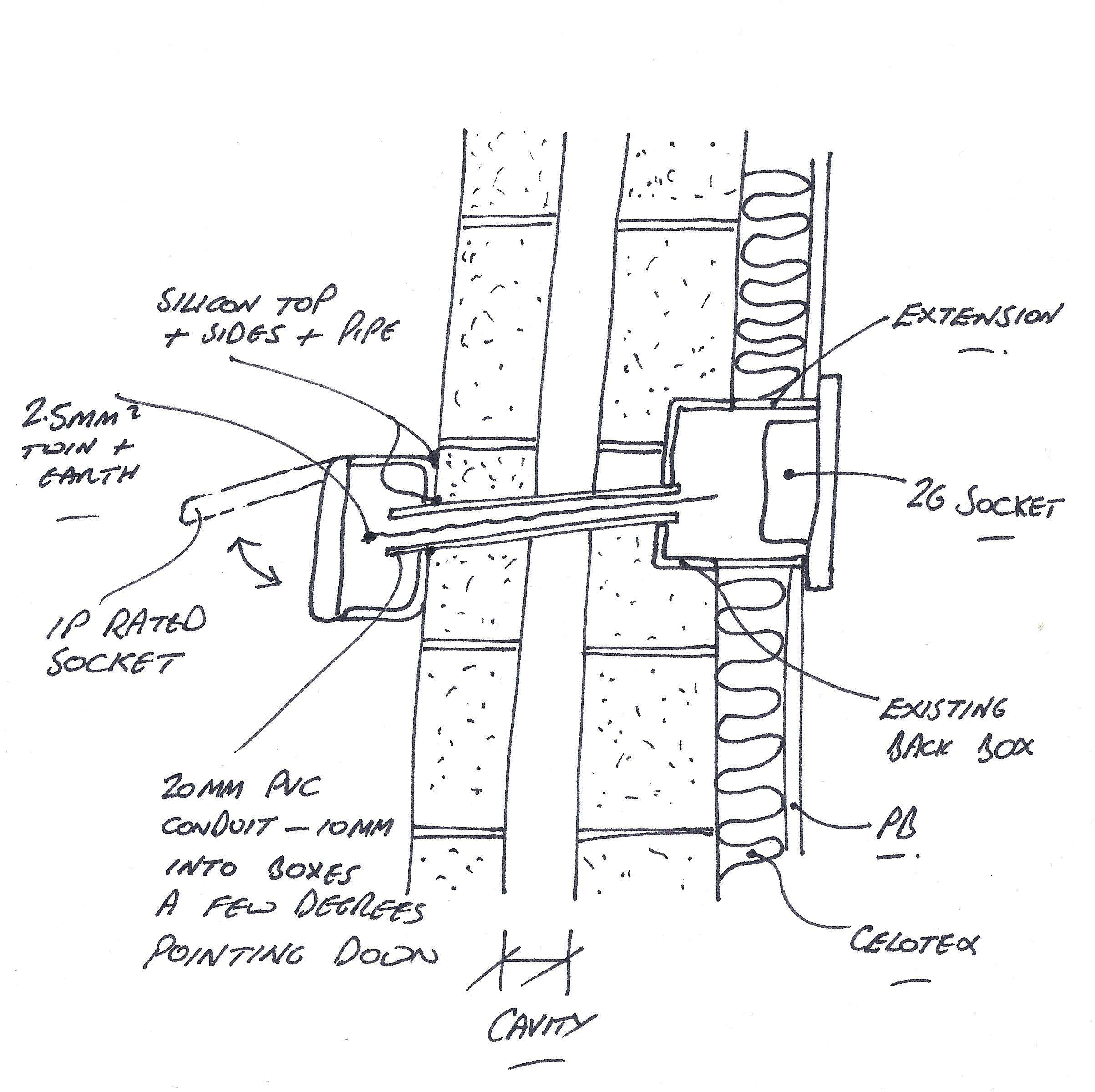

zoothorn Posted August 22, 2018 Author Share Posted August 22, 2018 JSHarris, you've said your thing on this/ you are just repeating. If I am concerned about this cable, then this is my perogative, & I am not. There are FAR greater things of concern in this dreadful 20 yr old DIY disaster of a house than this, which Ive lived with for 2 yerars now! You -could- argue that a jet will land on my house, no point doing anything to it, or even sleeping in it as a jet -could- land on my house. Argue till the cows come home. I'm in a training area, its a feasable argument isn't it? But you wouldn't. Why not? bc the likelihood is so miniscule as to be negligeable. The chance of a jet landing on the house is higher than some muppet 1st plugging this plug into the socket then deciding to drill around it, 1st without checking with a tester for hidden cables, metal, or xyz. It is unconnected. When I post a photo of it connected.. then by all means pipe up with all the advice. This PB isn't even finished yet, it has to come out again so I can change abc, as the extension boxes are proving hard to source (w'out spending £8 on post). This PB is last job now. I have to crack on. Please, I need help with the new wall Im about to start, my kitchen's in a terrible state & its becoming a huge burden to live as it is. If you can help with the work I'd be very grateful as I've said many times to all who have posted helpful posts. I have asked a Q today, can you help? thx Link to comment Share on other sites More sharing options...

newhome Posted August 22, 2018 Share Posted August 22, 2018 9 minutes ago, zoothorn said: The chance of a jet landing on the house is higher than some muppet 1st plugging this plug into the socket then deciding to drill around it, 1st without checking with a tester for hidden cables, metal, or xyz. That isn’t @JSHarris‘ concern tho. He’s saying that the cable will react with the insulation whether or not it’s switched on and will melt. That would put the shits up me personally as the last thing I would want to do is take a risk that involved electric or fire, but maybe that’s just me. Cables and insulation You say that your house is a 20 year DIY disaster but slowly but surely you are addressing that. This job being a case in point as rather than just tarting up the kitchen with a new worktop and sink you are doing a proper job by addressing the one of the big issues in the house which is the lack of insulation. And you are doing a decent job so far too. Link to comment Share on other sites More sharing options...

zoothorn Posted August 22, 2018 Author Share Posted August 22, 2018 20 minutes ago, newhome said: That isn’t @JSHarris‘ concern tho. He’s saying that the cable will react with the insulation whether or not it’s switched on and will melt. That would put the shits up me personally as the last thing I would want to do is take a risk that involved electric or fire, but maybe that’s just me. Cables and insulation You say that your house is a 20 year DIY disaster but slowly but surely you are addressing that. This job being a case in point as rather than just tarting up the kitchen with a new worktop and sink you are doing a proper job by addressing the one of the big issues in the house which is the lack of insulation. And you are doing a decent job so far too. Polystyrene insulation.. this isn't polystyrene insulation tho! If you start you could very well not go in the house at all out of total fear. What about the loft insulation running over the cables? that's what the pro loft insualtors did.. what about the old stuff they put it ontop of? what about the deterioration of pvc cable ontop of treated wood? what about this, that, the other.. you could go on until you're a nervous wreck sleeping in a ditch to be safe (& then the flippin jet lands on your head). Link to comment Share on other sites More sharing options...
Onoff Posted August 22, 2018 Share Posted August 22, 2018 7 minutes ago, zoothorn said: Polystyrene insulation.. this isn't polystyrene insulation tho! If you start you could very well not go in the house at all out of total fear. What about the loft insulation running over the cables? that's what the pro loft insualtors did.. what about the old stuff they put it ontop of? what about the deterioration of pvc cable ontop of treated wood? what about this, that, the other.. you could go on until you're a nervous wreck sleeping in a ditch to be safe (& then the flippin jet lands on your head). YOU are risking people just walking away from this thread mate. This advice thing is a bit of a two way thing. If you ask for advice then choose to ignore what half a dozen people agree is f***ing dangerous they, including me will just walk away. And don't say "I can't". you've proved YOU CAN if you're prepared to listen. 2 1 Link to comment Share on other sites More sharing options...

zoothorn Posted August 22, 2018 Author Share Posted August 22, 2018 43 minutes ago, Onoff said: YOU are risking people just walking away from this thread mate. This advice thing is a bit of a two way thing. If you ask for advice then choose to ignore what half a dozen people agree is f***ing dangerous they, including me will just walk away. And don't say "I can't". you've proved YOU CAN if you're prepared to listen. As I did ask for an opinion on my cable it seems, I accept your point (I thought I didn't ask for advice on it.. maybe I did then). Ok I'll redo it last/ when I take off this pb3. Maybe I can think of adding an outside socket instead, if that is the main job is drilling an angled-down hole through. Surely though any hole will need foam-fill sealing, which is foam next to cable itself-? the only socket it can go from, is this double under pb3 Im yet to extend tho. 2 Link to comment Share on other sites More sharing options...

Jeremy Harris Posted August 22, 2018 Share Posted August 22, 2018 2 hours ago, zoothorn said: JSHarris, you've said your thing on this/ you are just repeating. If I am concerned about this cable, then this is my perogative, & I am not. There are FAR greater things of concern in this dreadful 20 yr old DIY disaster of a house than this, which Ive lived with for 2 yerars now! You -could- argue that a jet will land on my house, no point doing anything to it, or even sleeping in it as a jet -could- land on my house. Argue till the cows come home. I'm in a training area, its a feasable argument isn't it? But you wouldn't. Why not? bc the likelihood is so miniscule as to be negligeable. The chance of a jet landing on the house is higher than some muppet 1st plugging this plug into the socket then deciding to drill around it, 1st without checking with a tester for hidden cables, metal, or xyz. It is unconnected. When I post a photo of it connected.. then by all means pipe up with all the advice. This PB isn't even finished yet, it has to come out again so I can change abc, as the extension boxes are proving hard to source (w'out spending £8 on post). This PB is last job now. I have to crack on. Please, I need help with the new wall Im about to start, my kitchen's in a terrible state & its becoming a huge burden to live as it is. If you can help with the work I'd be very grateful as I've said many times to all who have posted helpful posts. I have asked a Q today, can you help? thx You've missed both the critical points I was trying to make. Yes, it's your life, and yours to choose how to live it and what risks to make, I think it's only reasonable to point out things that are dangerous and which it's clear you have no knowledge of - I'm really not doing this just to poke my nose in or be a nuisance, these are bloody serious issues.. Fact: Flexible cable insulation chemically degrades in contact with some forms of insulation, other plastics etc, whether or not the cable is in use. This has caused cable insulation to break down and fail in the past and there are warnings all over the place about it if you choose to check. It doesn't matter at all whether the cable is connected or not - it's a known chemical issue arising from the reaction of the plasticiser in the flexible cable insulation - the stuff that keeps flexible PVC flexible. Fact: Flexible extension leads are rated for use fully unreeled and in open air. Every one sold has a warning on it to this effect, for a very good reason. When surrounded by insulation that section of flexible cable is likely to overheat and exacerbate the breakdown of the cable insulation - unseen by you; you won't have a clue it's happening until one day when you plug that lead in and turn it on to use it and it silently starts to smoulder behind your wall. You may well have stopped using the lead before any fire breaks out - it could sit there smouldering behind that wall for hours and you would no nothing about it. If you're lucky the fire will self-extinguish, still without you knowing anything about it, because it's behind the wall, and sit there waiting until the next time you plug the lead in, before heating up again. If you're unlucky then you will die in your sleep when the fire takes hold hours later and the fumes from the insulation etc cause toxic smoke to fill the house. By all means choose to ignore the above - that's your prerogative, all I'm doing is stating the risks, because it's clear from your reply above that you are unaware of the chemical reactions that are known to happen between flexible cables and insulation and you seem unaware of the overheating risk caused by surrounding a cable that's only ever intended to be used in the open air (that's in the regs as clear as day as well, if you wish to check). Link to comment Share on other sites More sharing options...

Onoff Posted August 22, 2018 Share Posted August 22, 2018 (edited) 32 minutes ago, zoothorn said: As I did ask for an opinion on my cable it seems, I accept your point (I thought I didn't ask for advice on it.. maybe I did then). Ok I'll redo it last/ when I take off this pb3. Maybe I can think of adding an outside socket instead, if that is the main job is drilling an angled-down hole through. Surely though any hole will need foam-fill sealing, which is foam next to cable itself-? the only socket it can go from, is this double under pb3 Im yet to extend tho. Trouble is the people on here are NOT going to sit idly by and NOT comment if they see something so in your face wrong! Anyway, the solution goes something like this: As you can see all the pvc sheathed cable is touching is the pvc pipe - no rough edges or chemical reactions! As to what IP rated socket to fit then it's a tad dependant on what circuit protection you have on that ring main circuit which I assume that existing 2G socket is on? If it's RCD protected then something like this, there is a slightly cheaper LAP branded one: https://www.screwfix.com/p/bg-13a-1g-switch-socket/35096#product_additional_details_container A single socket linked but you could fit a double one if you wanted. If not then you really need RCD protection so it'll be something like this: https://www.screwfix.com/p/bg-13a-2g-rcd-switched-socket/91095 Your electrician will I'm sure be able to advise you! If you take electricity outside you're into the realms of Part P. Edited August 22, 2018 by Onoff 1 Link to comment Share on other sites More sharing options...

zoothorn Posted August 22, 2018 Author Share Posted August 22, 2018 The main reason I'm using the external cable thru the window frame (as it were), as it was before, is bc fitting an eternal socket will ruin the look of the front of the house. Its a stone cottage, an ugly socket on the stone face now I'm thinking on it more.. is a no-no. Ok what I'll haver to do is cut this cable at the hole in the PB I made/ fill, & cut at the external exit point (reluctantly as I use it daily). Then feed an extension thru the damn fkn window: Exactly what I didn't want (the very reason for this cable) but now have no choice it seems. It'll take me a week to do that socket externally too via the back of the 2G socket as I'm not proficient enough plus it means one heck of a powerful drill + a whopping long large bore bit.. I just don't have, or will cost me a fortune. I want to forget this cable for now. Its causing me stress now. Link to comment Share on other sites More sharing options...
