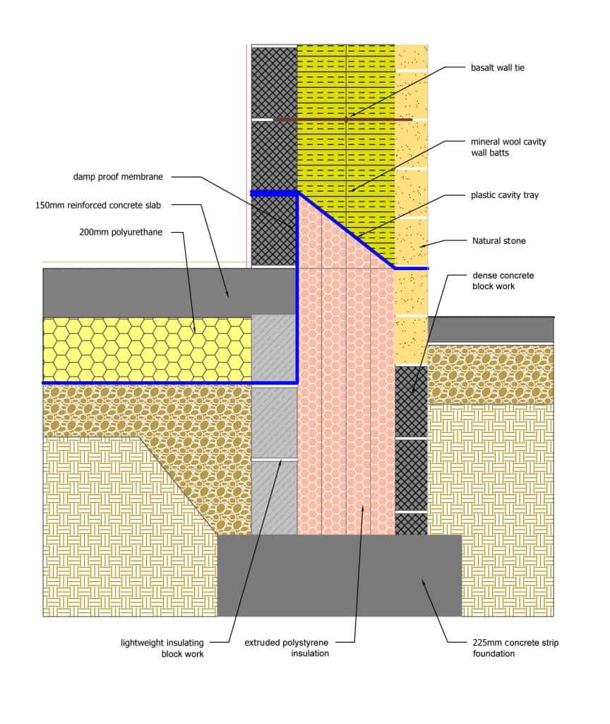

SteamyTea Posted June 17, 2018 Posted June 17, 2018 Welcome. Re your groundwork/foundation/piling, it may be worth having a word with @joe90. He built on the flattest bit of land in the West Country, and it was very boggy. His local Building Control was happy with trenches. I know little about foundations, and each house seems to have unique issues, though I think half of that is lack of knowledge about alternatives by builders/SEs/BCs. As for SIP's Have you checked the U-Values and associated thicknesses of the panels. You may need secondary internal/external insulation fitted. I have stood next to both @JSHarris's ASHP while it was running, and next to @joe90's with it was not. There was no difference in noise. @JSHarris you may have missed my post about monitoring an ASHP for frosting, I am looking to put some kit on a couple or three. 1

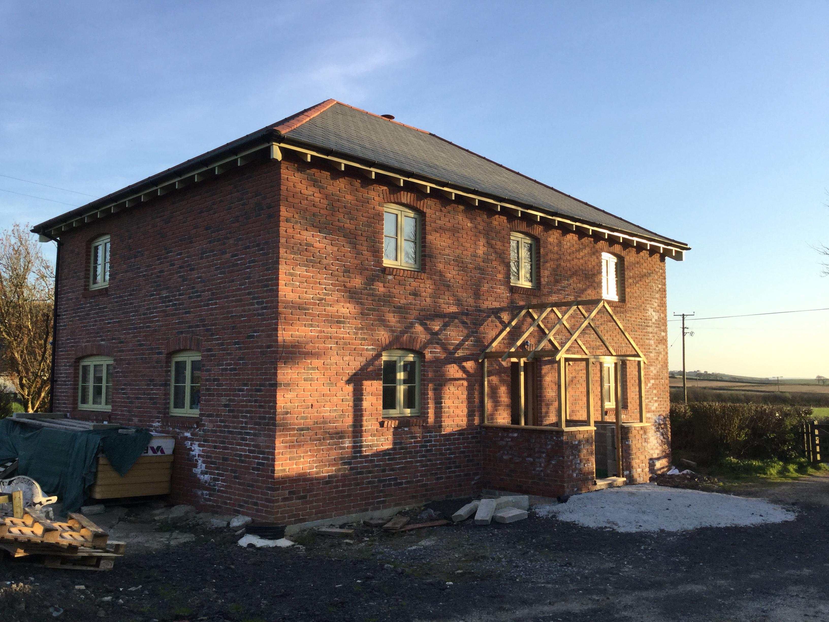

joe90 Posted June 17, 2018 Posted June 17, 2018 As per Steamy,s post above, yes our site is very flat, thick yellow clay and very boggy. The local building control guy was happy with trench foundations and asked for 800mm deep and 700mm wide ( our walls are brick and block outer and inner with 200mm full fill cavity with Rockwool ) we installed a French drain around these (back-filled the trench outside with 50mm stone) and piped it to a local ditch. The foundation detail was as follows to avoid cold bridges and I am very happy with it, we did not need an SE to design or sign it off..You mentioned “cottage”, ours too is cottage P.s. we also have a DIY installed ASHP ( which I have yet to fire up). 1 1
jack Posted June 18, 2018 Posted June 18, 2018 11 hours ago, joe90 said: This would have been better as a 1.5 storey cottage. Much more in keeping with the local vernacular. 2
Caroline Posted June 18, 2018 Author Posted June 18, 2018 43 minutes ago, jack said: This would have been better as a 1.5 storey cottage. Much more in keeping with the local vernacular. Hi Jack Our house is 1 1/2 storey, and I’ve seen one built and it’s fine, however, you would be surprised at the couple of interested people in one of the plots for sale want two storey. Bigger seems to to be better for most, not sure why?
jack Posted June 18, 2018 Posted June 18, 2018 1 minute ago, Caroline said: Our house is 1 1/2 storey, and I’ve seen one built and it’s fine, however, you would be surprised at the couple of interested people in one of the plots for sale want two storey. Bigger seems to to be better for most, not sure why? Ah, sorry, it's a joke based on the long planning history of this house. Joe's local council were insisting on 1.5 storey based on a mythical "local vernacular" requirement. He took it to appeal and won.
