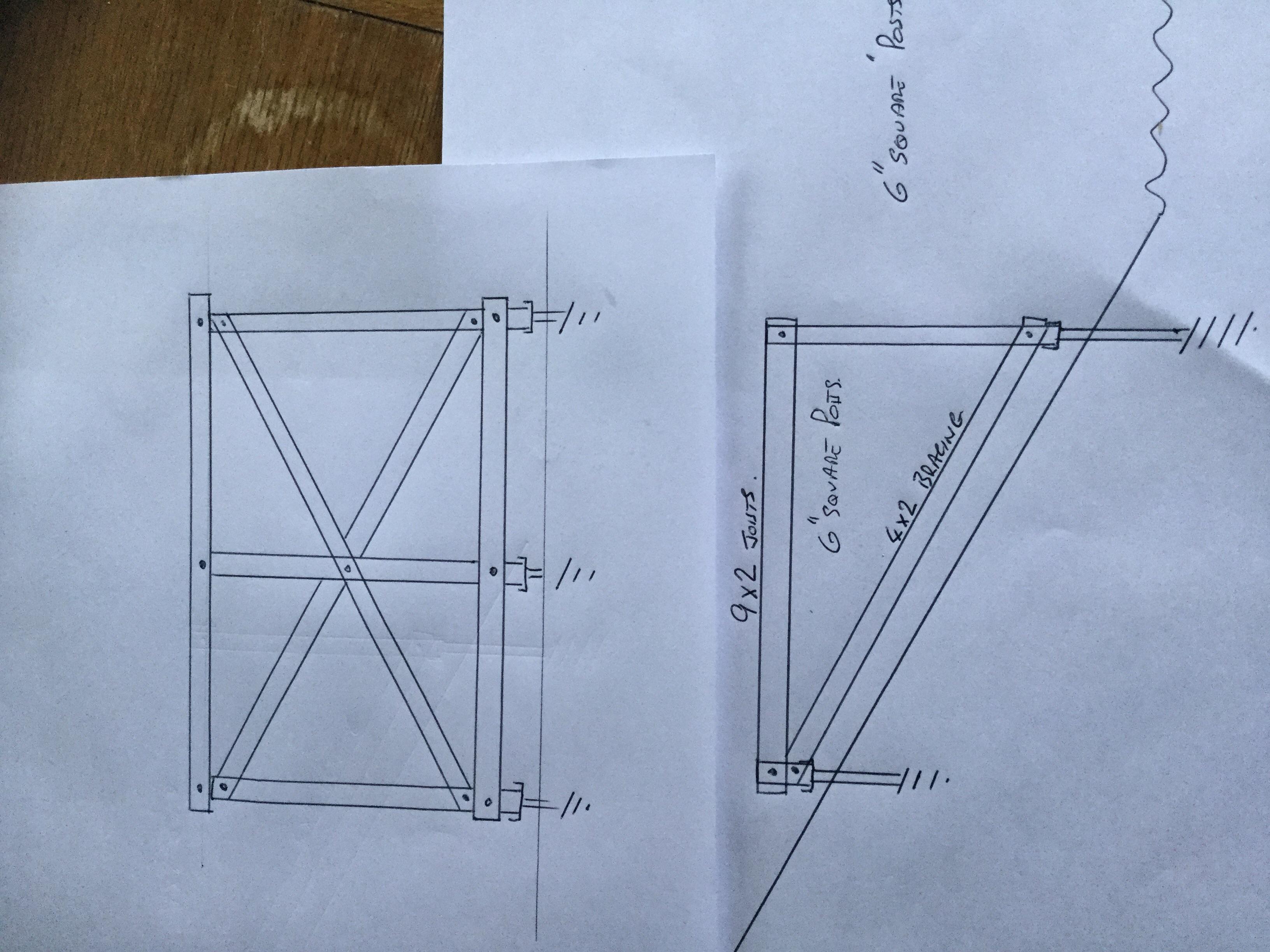

joe90 Posted June 29, 2018 Posted June 29, 2018 Right, I don’t do CAD or anything posh, I am a pencil and paper man. See my very rough and ready drawings as below, 6inch posts (vertical) sat on ground screws driven in till they hit solid matter, 9x2 joists to support the deck, these to be repeated every 400mm (use joist hangers) and cross braces of 4x2. All joints to be M12 bolts (galvanised), all timber to be pressure treated. You will need a deck if the shed/other does not have a floor. Obviously all dimensions to fit your ground, shed/other. Others will be along now with other ideas but this is what I would do.
zoothorn Posted June 29, 2018 Author Posted June 29, 2018 Joe90 a gentleman you are, thanks/ just as I would do, a photo of a sketch much easier to visualise than a pc image. All makes alot more sense now I can see this & sort of what I thought of after your suggestions. I think this (sketch B) might be just the ticket: but others' opinions would be welcome before I go with this as final idea. What I'll do is pass this onto my builder.. he'd never heard of groundscrews, at a guess maybe a recent 'invention' of sorts for him. He & I could do easily I'm sure.. but prefer if a pro on board with me/ alot (in my world anyway) being at stake to sit ontop. 1

joe90 Posted July 9, 2019 Posted July 9, 2019 2 hours ago, zoothorn said: What I need to establish before he starts, is how & where the log cabin should sit ontop. The next-to-stream footings, forming a line of 3, is a good 1m away from where I want my cabin side to be. My Q is if my base is say 4m sq, can the cabin sit happily within it? IE a 3mx3m cabin, onto a 4mx4m base.. is this possible if I were to build the base top in some fashion to suit? Dont understand the question really, why not put the 6 piles where you want the cabin?, 3 along the front and 3 along the back, make sure the 4 corner ones are where the corners of the build will be to support the join from front or rear to side members, do your self a diagram of what you want and post it here fir comments.
zoothorn Posted July 9, 2019 Author Posted July 9, 2019 @ProDave yes that's what he suggested.. & going ahead any day. The thing is trawling log cabin base info, all suggestions are to make the base fit the 4 walls, as the load is peripheral/ only here (not the floor). With mine, bc the only place to site the far side 3 pillars, is right down near the stream. Then if the cabin side walls directly above this line of three (for ideal load bearing etc) the cabin will sit too far over twds stream. I want it shifted inwards from here ~0.5m min. Maybe 1m. So is this oversize base ok? if so do I have to re-inforce its flat top somehow to accomodate this shift inwards? or is it a definite no-no/ I must make the base same size as cabin to distribute its 4 wall's weight directly down onto the footing pillars.
zoothorn Posted July 9, 2019 Author Posted July 9, 2019 1 minute ago, joe90 said: Dont understand the question really, why not put the 6 piles where you want the cabin?, 3 along the front and 3 along the back, make sure the 4 corner ones are where the corners of the build will be to support the join from front or rear to side members, do your self a diagram of what you want and post it here fir comments. @joe90 does my reply to ProDave's shed any light? (clever pun intended).
joe90 Posted July 9, 2019 Posted July 9, 2019 11 minutes ago, zoothorn said: With mine, bc the only place to site the far side 3 pillars, is right down near the stream. Why?, they can go in a slope if that’s where you want the edge of the cabin to be, or am I missing something?
PeterW Posted July 9, 2019 Posted July 9, 2019 If this is a standard 3x3 cabin then you’re talking 7-800kg at most. 9 concrete pillars is a little overkill .... 1
zoothorn Posted July 9, 2019 Author Posted July 9, 2019 19 minutes ago, PeterW said: If this is a standard 3x3 cabin then you’re talking 7-800kg at most. 9 concrete pillars is a little overkill .... Yes I was wondering this too- good so I'll leave out the 3 centre ones he suggested (prob cos he's used to bigass hides etc without a suspended floor like log cabins). Actually its a toss up between the proper whole-hog route: a new 3x3m cabin @ £2k.. or.. Ive been offered a used 2x2m log cabin for £600. Tempting but the door askew/ to fix, window likewise, pain or two gone.. & I need to decontruct it. Saves me £1.4k tho. But the same thing applies: if I were to make the base 3x3, & say change my mind or run out of budget.. could I sit this 2x2m log cabin on it?
zoothorn Posted July 9, 2019 Author Posted July 9, 2019 34 minutes ago, joe90 said: Why?, they can go in a slope if that’s where you want the edge of the cabin to be, or am I missing something? Good Q Joe. The only thing you're missing is just up onto the bank, say 1m away from stream.. the ground is poor/ very loose, & the gradient is suddenly steep so alot to excavate to get down to stream 'bedrock' which is where he wants to go up from, & where I'd be happy only for them to sit tbh so bad the ground is here. The ground topside is alot firmer: I'm happy to dig hole > concrete > paving slab etc footing here. I'm lucky in finding this guy- ideal guy for the job: I knew if the job wasn't sitting well with me, to not rush ahead but wait until the right plan fell into place (chap I found in this case). I think he mentioned a few re-inforcing rods rammed down into the earth prior to concrete filling too. Approx £350 to do these 3, not cheap, but I think sensible. Maybe £150 on the pillars/ deck base. Plus £2k on the cabin. cheers zoot

Temp Posted July 9, 2019 Posted July 9, 2019 You will need some timber or steel beams to make a platform on which to build the cabin. If the pads are further apart than they need be that just affects the size of the beams. No big deal.
zoothorn Posted July 10, 2019 Author Posted July 10, 2019 10 hours ago, Temp said: You will need some timber or steel beams to make a platform on which to build the cabin. If the pads are further apart than they need be that just affects the size of the beams. No big deal. Platform.. thats the word I needed thanks Temp. I wonder then if I were to use the right guage beams, could I space both my side 3x footings to 5M total, my cabin 3M, to then shift cabin farthest back.. to free up a 2M area in front to form a veranda. Its the load of the cabin's front wall across, onto what this rests is the Q here. Talking to the chap at the time (the Co he works for http://www.elmwales.co.uk/ -the pic: Dyfi ospreys reserve) he mentioned 20% overhang can be safely used too. IE a bit of deck over the stream maybe.. could be a neat idea.. but I don't think quite enough area for a front veranda/ sit area etc. One possible concern, is the combined H of both base + cabin re. PP dept. If they were to deem it 'one structure' it'll be ~4.3m high. But if just the cabin.. 2.7m (IE no need for PP). With m sod n'bors itching to get at me they -will- enquire to PP dept just once Ive built it, if I just go ahead. Any ideas? maybe @PeterW might know?
