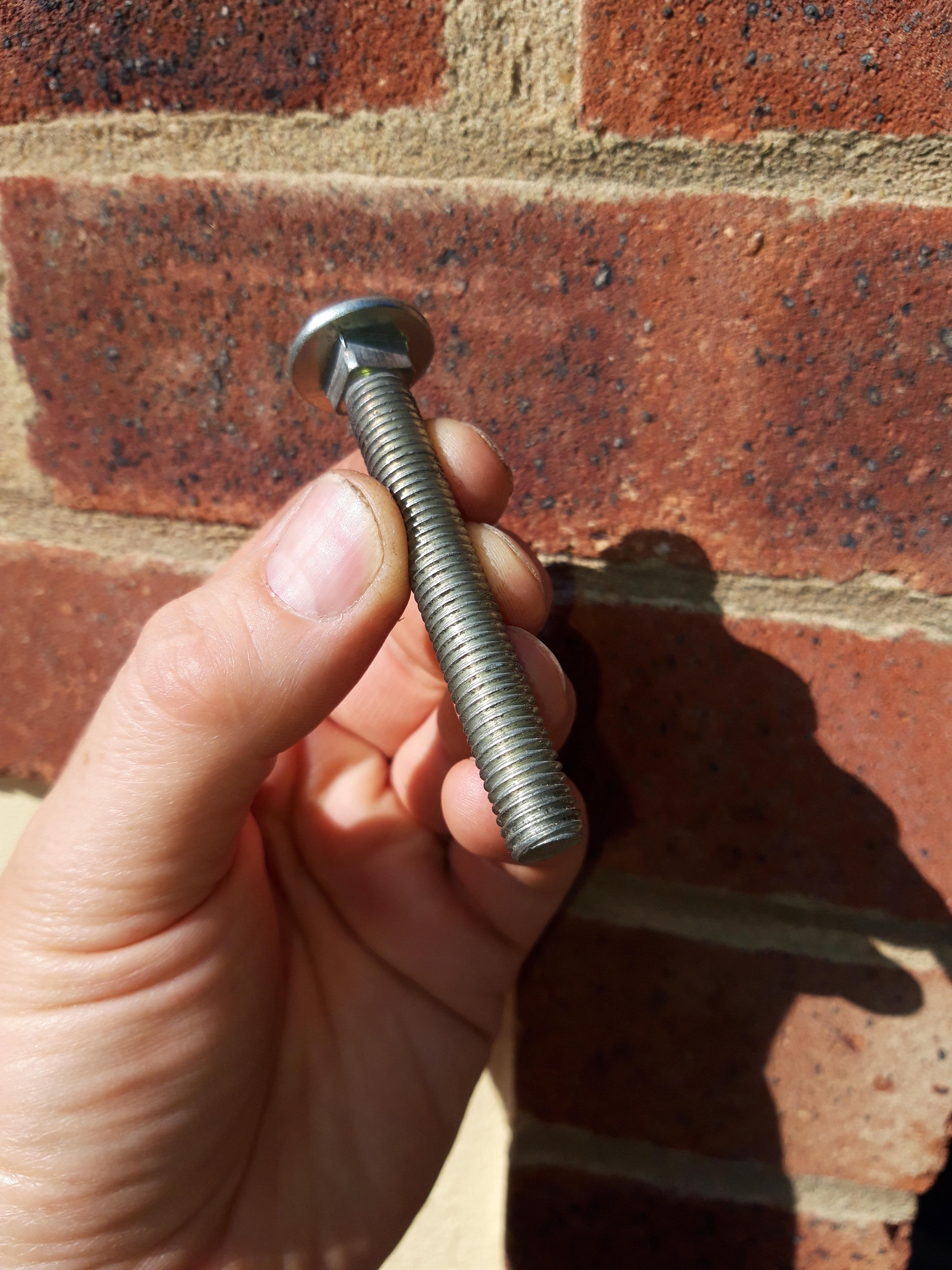

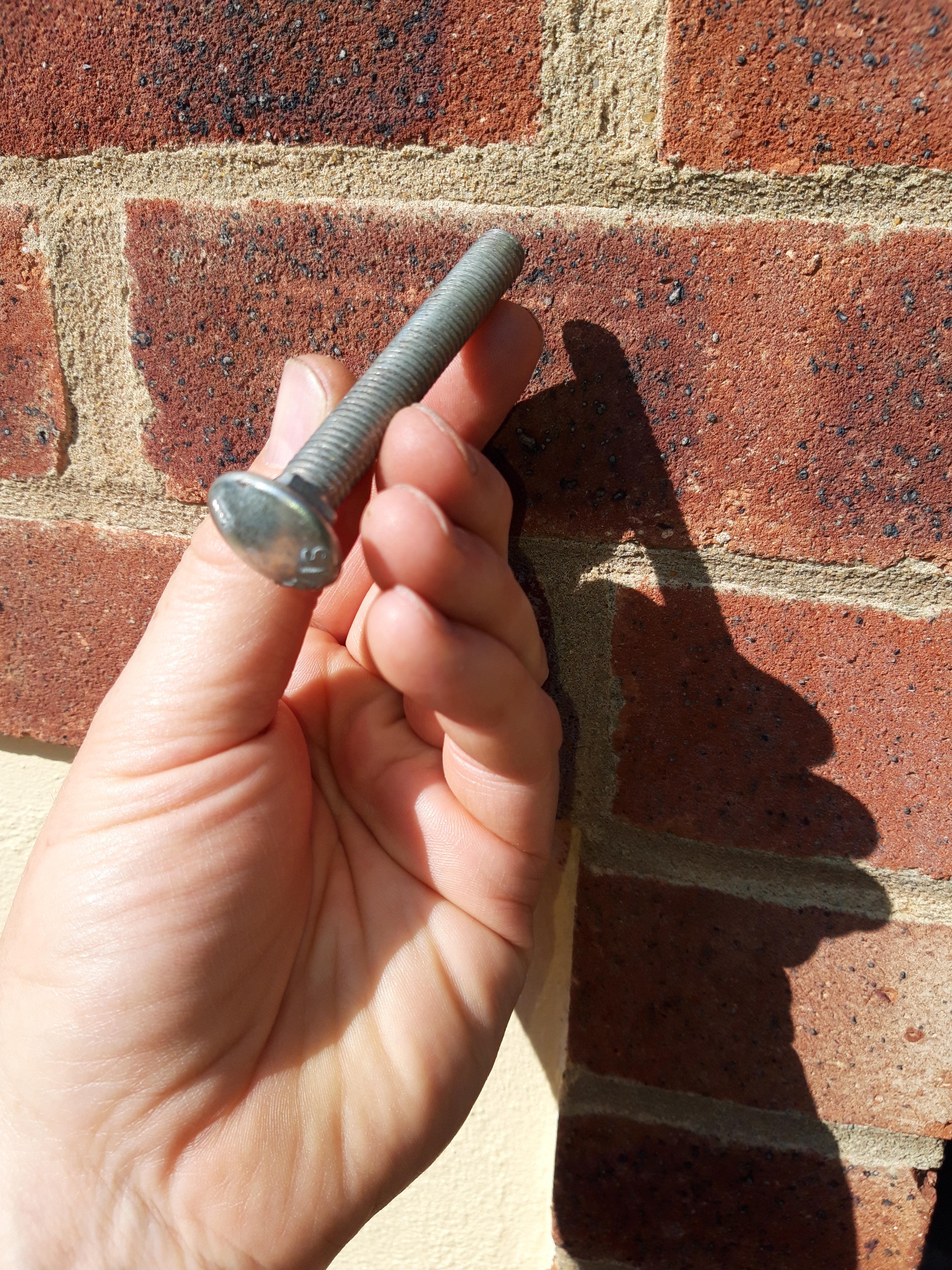

Onoff Posted June 23, 2020 Posted June 23, 2020 On 23/06/2020 at 14:19, zoothorn said: Ok so when you say coach bolt, do you mean these turbos I have? Expand This is an M10 coach bolt in stainless steel. See the square section on the shank, under the head? You drill a 10mm hole then tap the bolt home. The square wedges in the round hole and stops it turning whilst you wind the nut on. The one above has makers marks on the head but you can get them without. I used them on my front gate. Gives nice pinpoints of light against the black (imo). If using bright zinc plated coach bolts you can coat the shaft in grease where it passes through the wood. 1

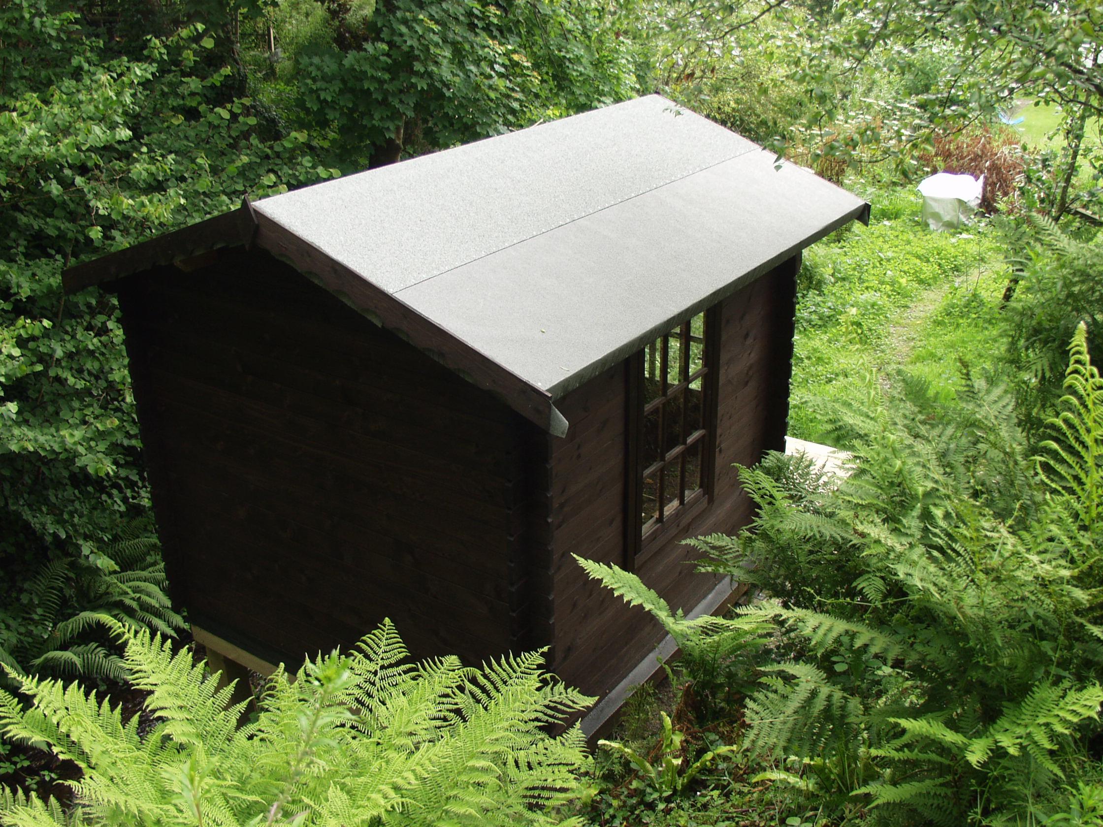

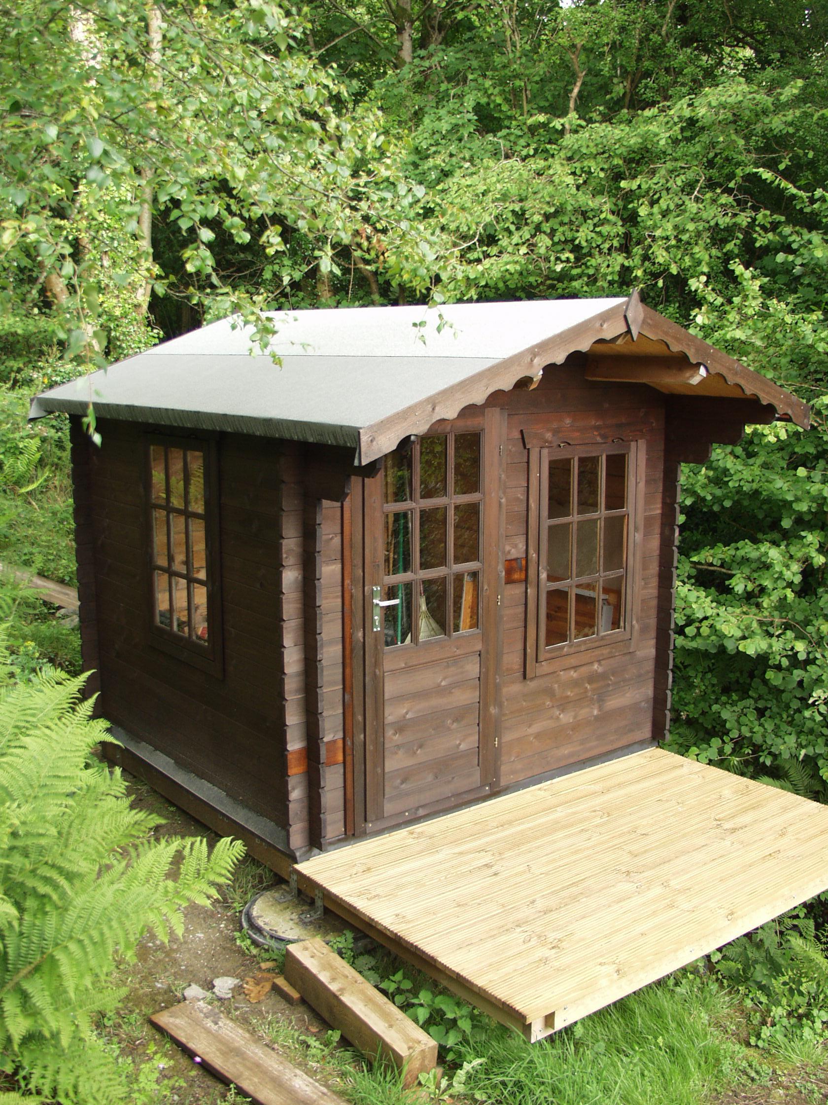

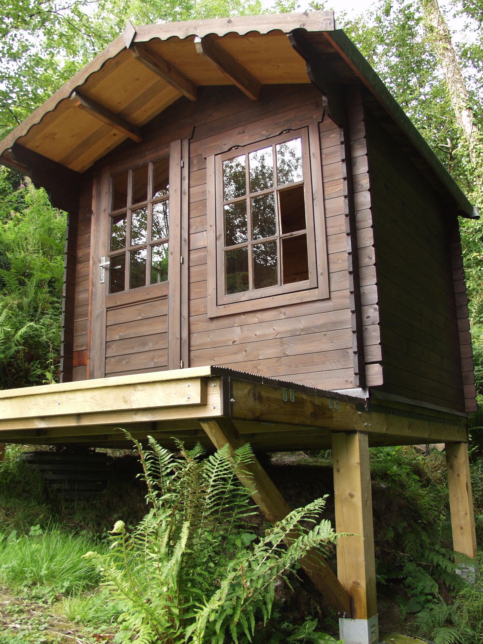

zoothorn Posted July 23, 2020 Author Posted July 23, 2020 @PeterW & @Onoff Pretty much finished.. just got to renew two diddy windows, colour darker than usual due to existing surface of logs.. but seems to have turned out fine, a sort of antiquey look maybe. Hugely appreciate the help from all on this project- couldn't have worked out better. zoot. 3

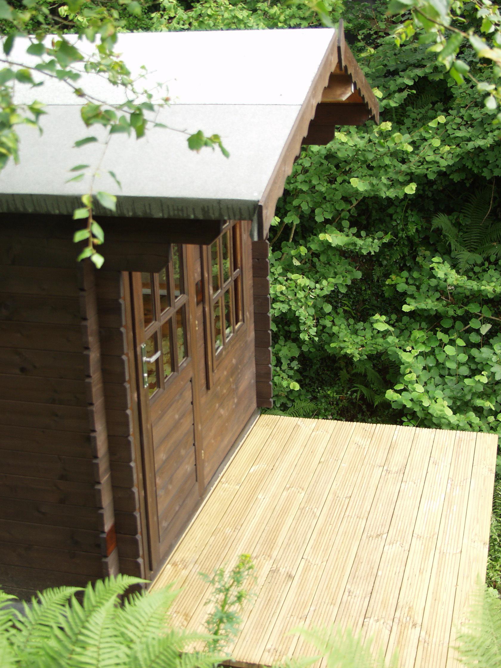

Onoff Posted July 24, 2020 Posted July 24, 2020 Looks excellent ? Will you stain the deck? Fit handrail? Second picture down, don't now how tall you or your friends are but there's no chance of catching your head on the pointy end of that fascia board is there? I did exactly that on my dwarf nephew's shed. On the third or so occasion I got his jigsaw and rounded it off! Fascia just above the oval wooden sign: (I am a bit taller than most mind).
zoothorn Posted July 29, 2020 Author Posted July 29, 2020 @Onoff that looks great- I'd love to have mine a bity more rustic. very characterful. No- I just avoid the pointy stepping up onto deck, thankfully. Deck is 'stained' as is/ tho only 2x coats of nononsense water based stuff, clear. Its fine tbh/ will weather & darken a bit. No side rail- may do next year just stream side. Cheers PeterW- yes hugely proud, the idea of buying this s/h & rebuilding it.. with sections stored over the shop in my house & under a leaky tarp 6 months, I never thought I'd get it up let alone looking this good.. thought it might be a write-off stupid idea. cheers- zoot.

zoothorn Posted May 10, 2021 Author Posted May 10, 2021 (edited) Hi- back to this log cabin job. Guttering advice if someone would please. One side only, top LHS needs guttering. Would you just use standard roofing 'square Marley flowline' stuff? as you get brown it'll blend in, but a bit big/ heavy duty for a cabin I'm wondering/ not correct for the job-? Does it need dedicated 'cabin guttering' I wonder, fixing brackets to consider with the extra area of roof overhang they have (compared to my extention's plastic soffit only 1 to 2 " away from the very edge of roof slates the brackets attatch to). Afaict dedicated cabin gutter brackets attatch to the roof edge, use a 65mm or 100mm gutter. The normal roof gutters like Marley have brackets designed to fix to soffits with a bit wider (than 100mm) 4.5" width gutter .. so I'd need to fettle additional wood packing to get me out to the right position if using Marley brackets: not too difficult using the 12cm 'excess' section of walls that protrude I could attatch packing to. thanks- zoot schmoot Edited May 10, 2021 by zoothorn
Onoff Posted May 10, 2021 Posted May 10, 2021 Use mini guttering: https://www.guttersupplies.co.uk/mini-gutters/mini-gutters-for-sheds-greenhouses/
zoothorn Posted May 10, 2021 Author Posted May 10, 2021 On 10/05/2021 at 11:04, Onoff said: Use mini guttering: https://www.guttersupplies.co.uk/mini-gutters/mini-gutters-for-sheds-greenhouses/ Expand Wow simple as that.. & spent ages trawling 'log cabin gutters' (& bought various full size flowline bits few weeks ago too/ i can now rtn). So simple when you know what to look for! great- thx
PeterW Posted May 10, 2021 Posted May 10, 2021 You need these to support it https://www.plasticdrainage.co.uk/rafter-top-gutter-bracket-2-9365.html
