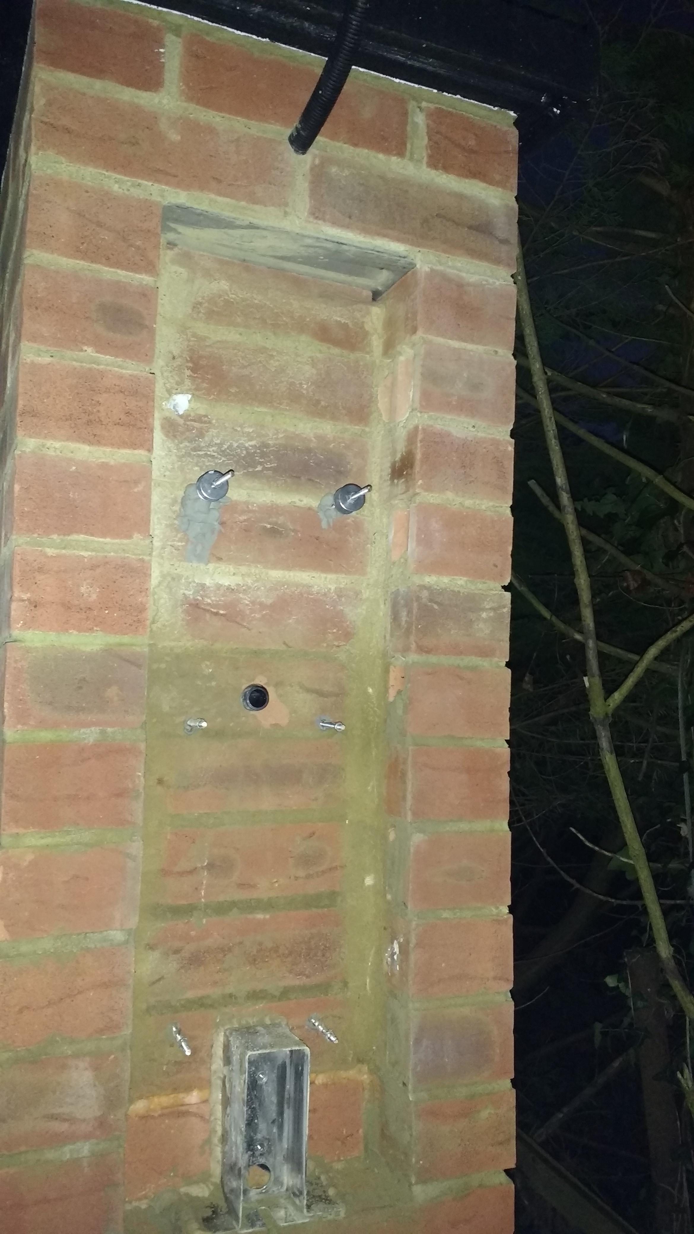

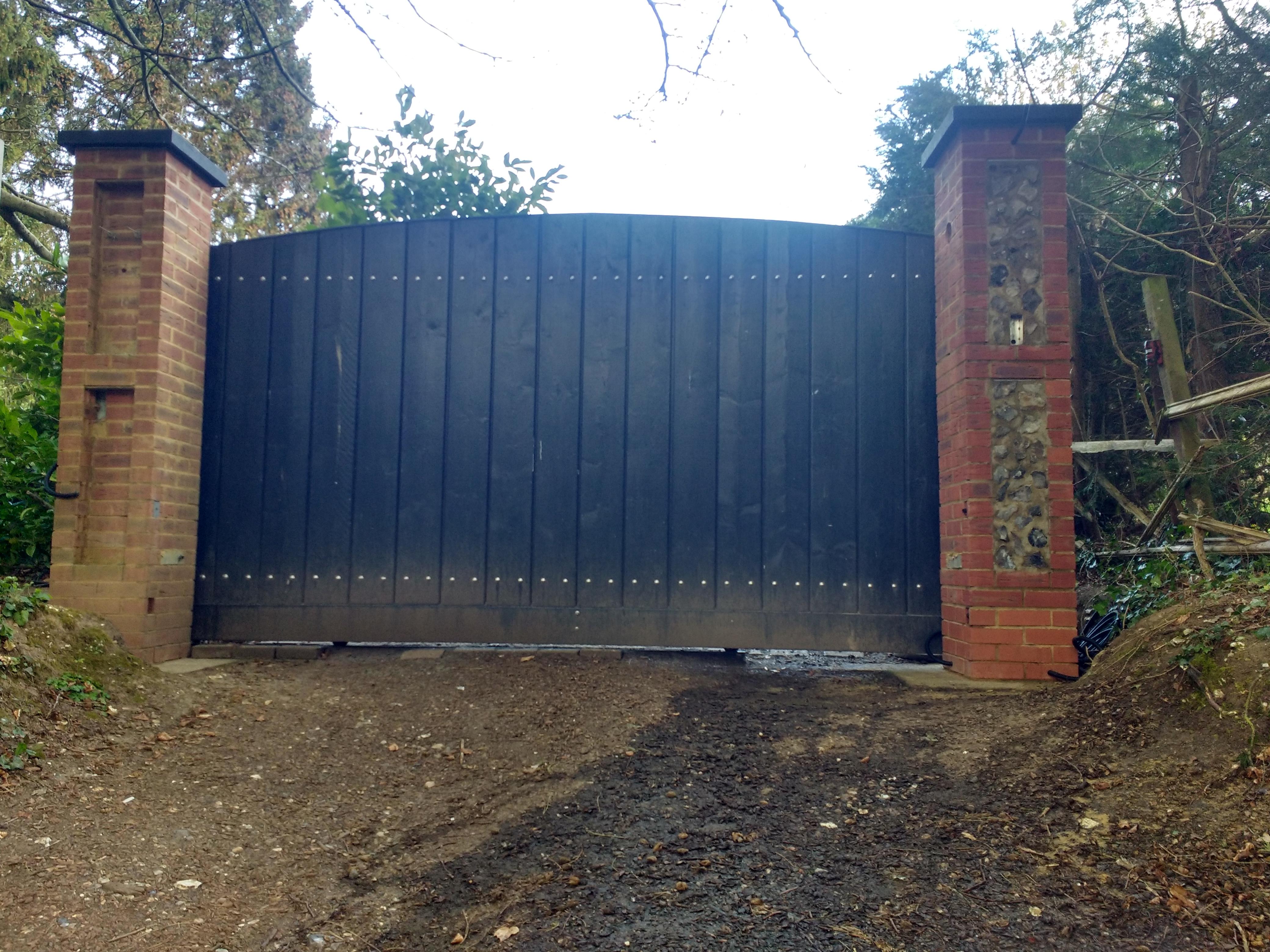

Onoff Posted January 17, 2022 Author Posted January 17, 2022 24 minutes ago, Russell griffiths said: sorry @Onoff but I think you have gone off tangent so far, you need to go back to basics and just bed them in and point as you go. I've watched the videos of the old boys doing it on YouTube, read up on it etc. Either you use fist size square blocks of flint or random shape, again nominally fist sized ones. The thing is with both types you select those that have depth, a tail I think they call it. In many cases these flints have are not much more than slivers and have very little depth. They are selected for their face features not their size. I can't use different flints either. These have sentimental value having been collected by a relative who was an amateur geologist. There is no precedent for doing this, such thin ones would not be used in traditional walling. Next plan is to clean all the flints up where they have resin/mastic on and coat the backs with a SBR/cement slurry before trying the traditional bedding against a board.

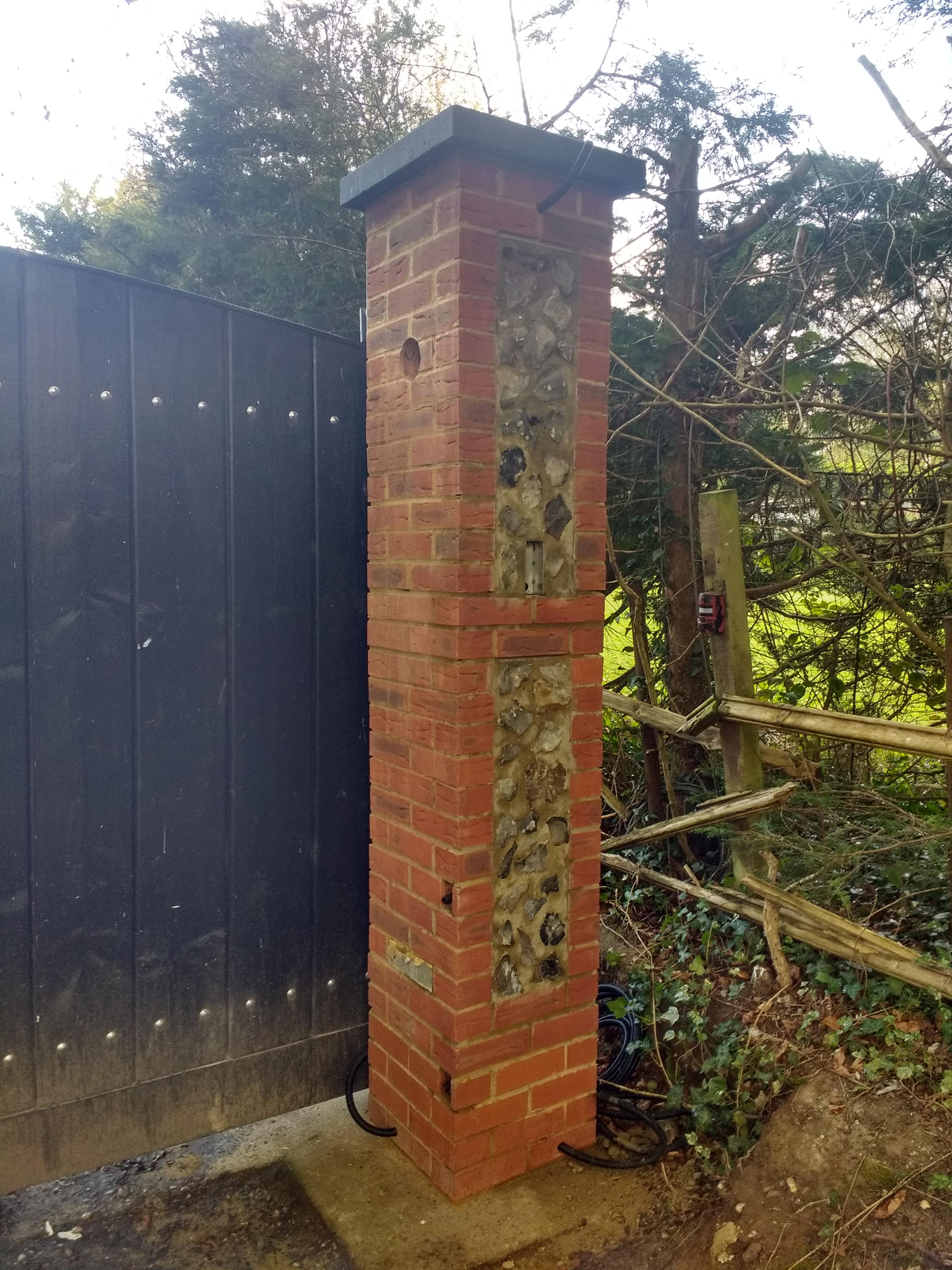

Onoff Posted April 20, 2022 Author Posted April 20, 2022 I let SWMBO lay the flints out in patterns she chose. Threw the mortar into the recess off the end of the trowel, pushed them in, more mortar. Ratchet strapped a bit of scaffold against it and walked away. Came back the next day, another small mix to point etc. Rubbed it in with a gloved hand, brush etc. Bottom panel is going ok I think. Top mortar spacing is too wide but i) hopefully the eye will be drawn away by the coach lantern and intercom, ii) I can't be arsed with it any more. 1

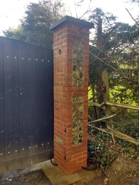

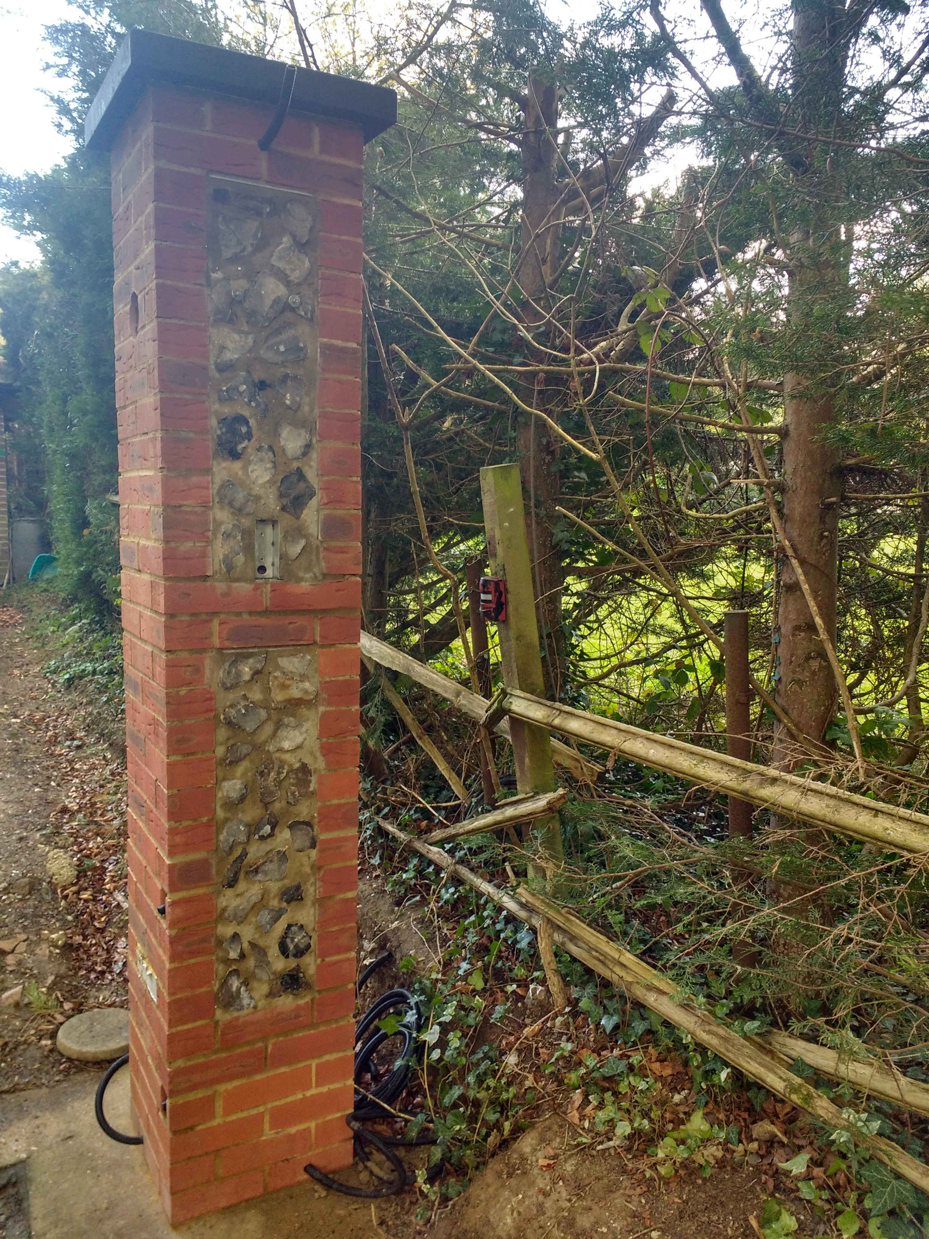

Onoff Posted April 25, 2022 Author Posted April 25, 2022 For the stubborn bits of mortar I might go with neat acid. Just gave another 1:1 dilute wash and rinse off. The fines in the mortar are coming through. I'll let it dry out over the Summer then give a coat of waterproofer. You can see how the washed face is "brighter" on the brick faces. @Marvin reckons it's a gate that says "f*** off!" 😂 Aim achieved then!
