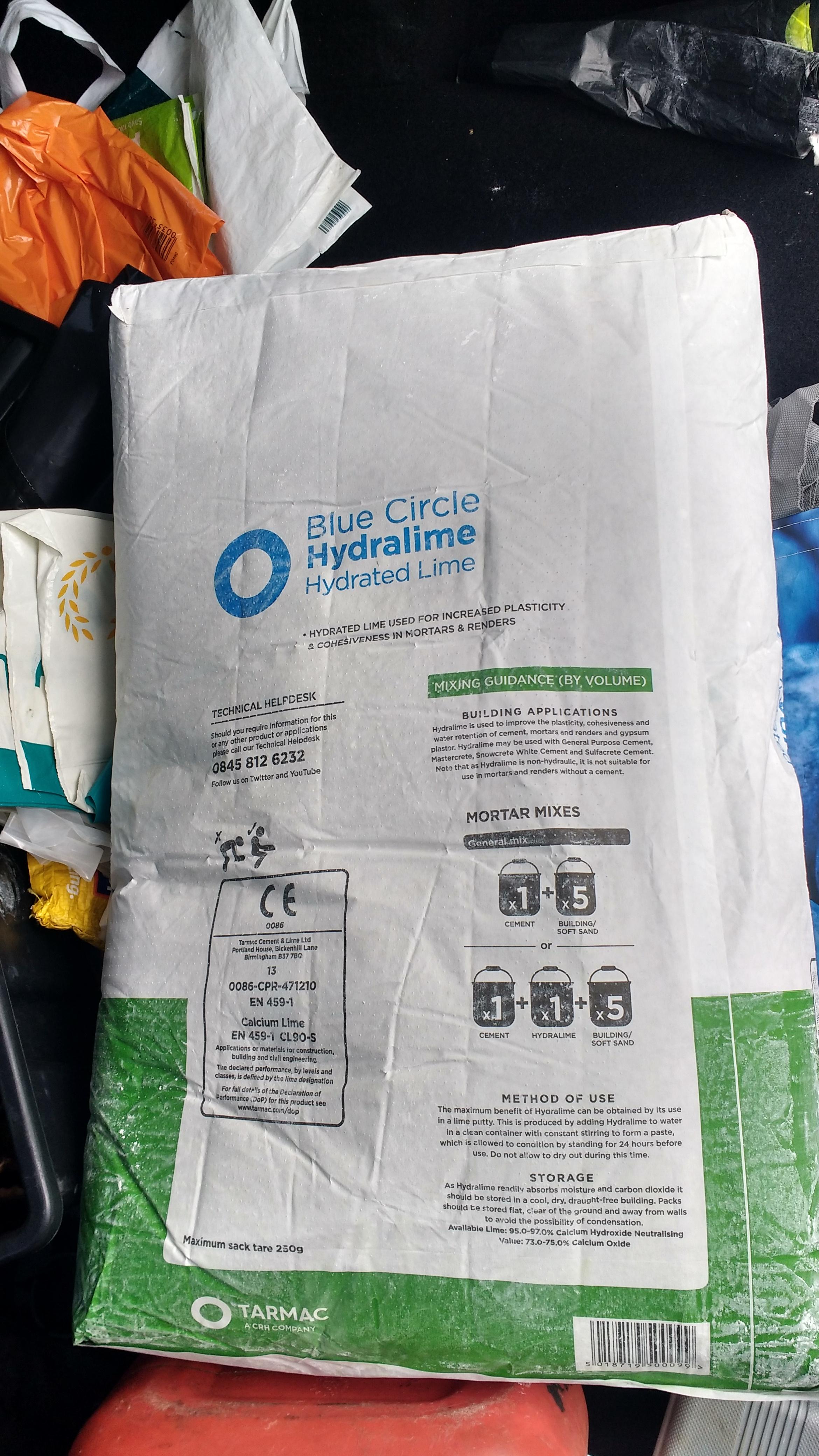

Onoff Posted August 27, 2021 Author Share Posted August 27, 2021 1 hour ago, pocster said: The first question is, why are you trying to make a lime mortar when you seem to have used a cement mortar for the rest of the wall? As I understand it a mix containing ordinary cement mix can shrink away from the impermeable flints causing them to go "loose". Water gets into these pockets, freezes and blows the wall. Others here have said the hydrated lime is OK to use I think. Washing up liquid should never, ever be used as an admix. Link to comment Share on other sites More sharing options...

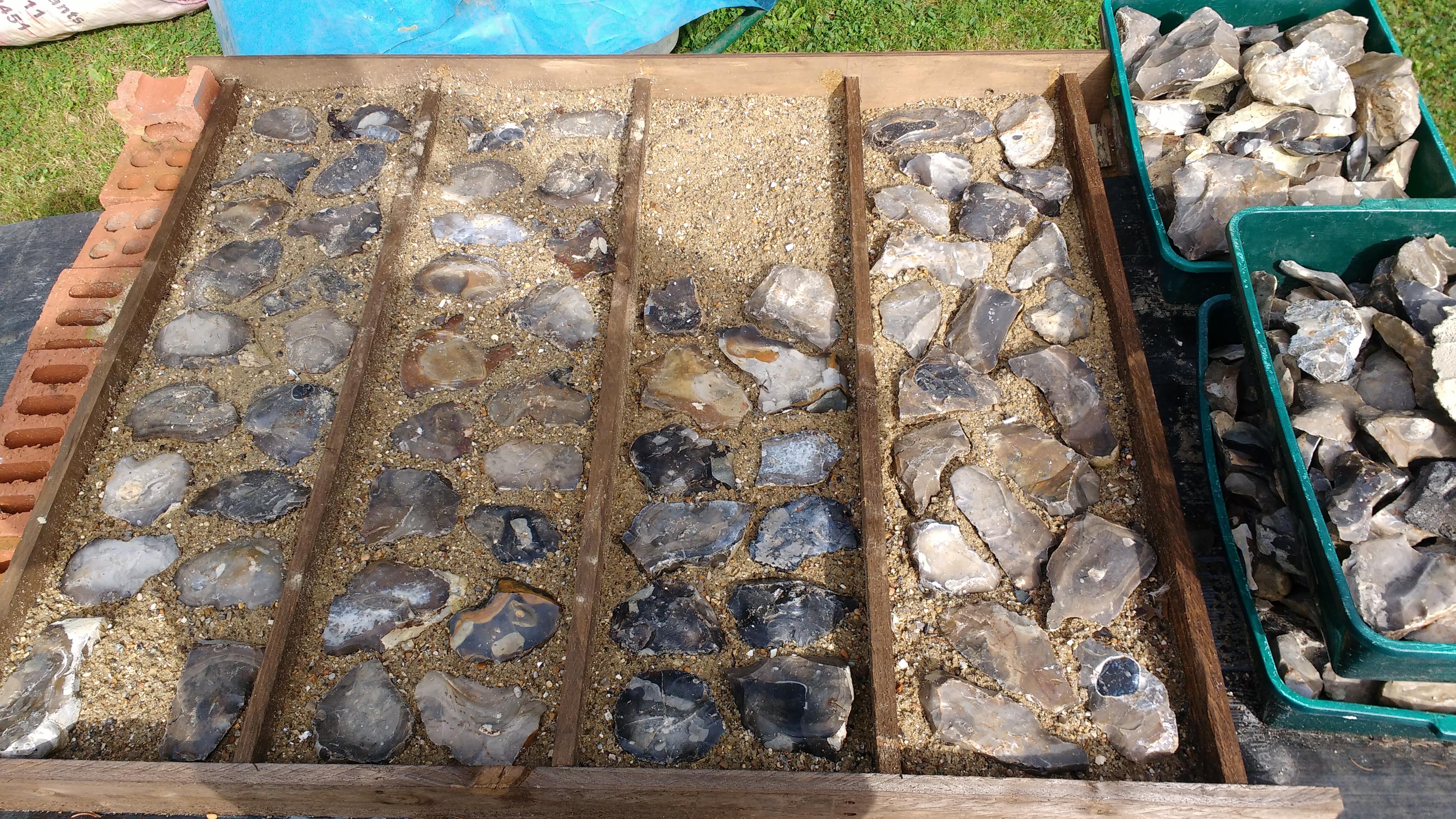

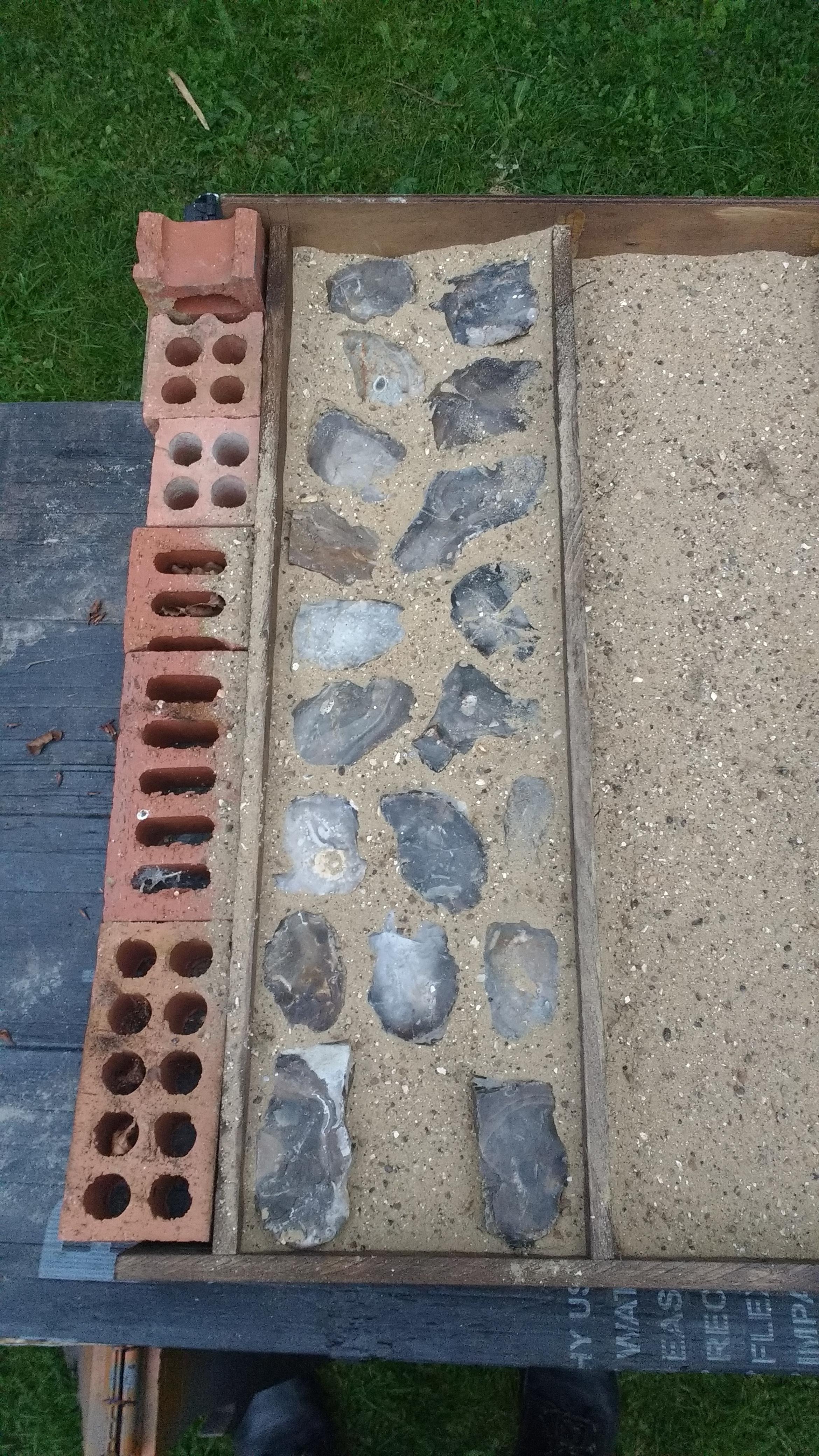

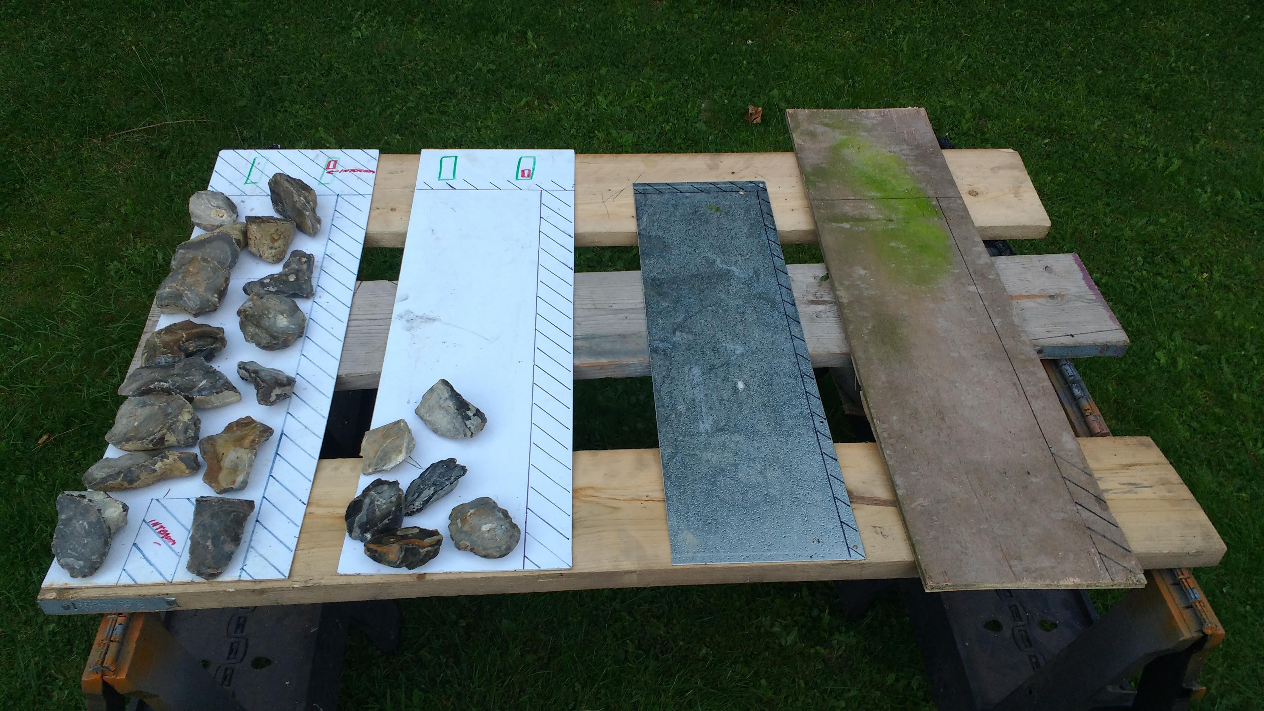

Onoff Posted August 28, 2021 Author Share Posted August 28, 2021 Just playing (again) with laying out the flints I have. Basically got 4 boards and marked the areas to fill. Vague recollection of someone saying aim for a finger width's of mortar between the flints. I do have a set of copper boppers I bought but struggle to shape the flints tbh. I think, in all honesty I'd prefer the mortar for the flints to match the 4:1 I used for the bricks. Is there any way to make it (the mortar) "flexible"? Adding lime I believe acts as a plasticiser, is that the same thing? Tbh I'm not at all happy with the strength of my sample mixes containing just lime & sand. Reading the new lime bag and I'm not sure how I missed where it says it's no good for mortar without cement in the mix! Wondering therefore if a mix containing cement and lime will give strength but also flexibility so the mix doesn't shrink away from the flints? Link to comment Share on other sites More sharing options...
Stewpot Posted August 29, 2021 Share Posted August 29, 2021 Outside my experience, but I doubt you can easily make an OPC mortar flexible. Plasticisers are about workability during use, not flexibility of the end result. I understand your concerns about the mortar shrinking away from the flints, but it looks like you have pretty small areas of flint infill - I wonder if you would get away with just continuing with an OPC mix. The thing is, it's pretty unconventional to mix OPC mortar with lime mortar - they generally don't work well together. Usually, someone who doesn't understand the difference will, for example, repoint a lime mortar with OPC, with disastrous results later. In your case, you are, in a way, doing the opposite, by covering OPC with lime. Maybe that'll work fine. Either way, I think it's a bit of a leap in the dark. If you do use a lime mix, you may only be able to get a close colour match by using mortar pigments, and experimenting. If you choose to use a lime mortar, it would probably be easiest for you to get hold of some NHL3.5 (Natural Hydraulic Lime, which has a strength rating of 3.5 - ie, moderatly hydraulic). There are several online outlets if your local BM won't get it. Mix it in much the same way you would OPC - no need to make a putty out of it first. I once repointed a stone wall this way, and found it easiest to use my gloved fingers to get a neat finish between the uneven stones, rather than a proper pointing tool. But keep the stone faces clean. Afterwards, keep the mortar damp - plant sprayer every day, and protect from direct sun - for a couple of weeks or so to aid carbonation and full curing. Also be aware that, whist quicklime is the most reactive form of lime, all types of lime are caustic - PPP is highly recommended. If you are using powder, a mask is a good idea, and in any case, gloves a must, and eye protection sensible. Link to comment Share on other sites More sharing options...

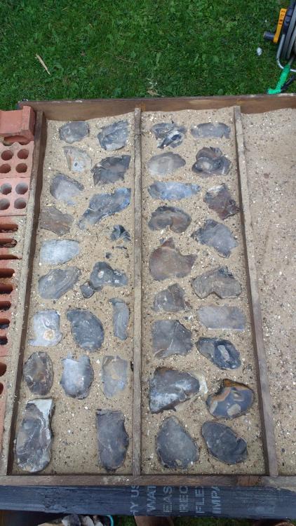

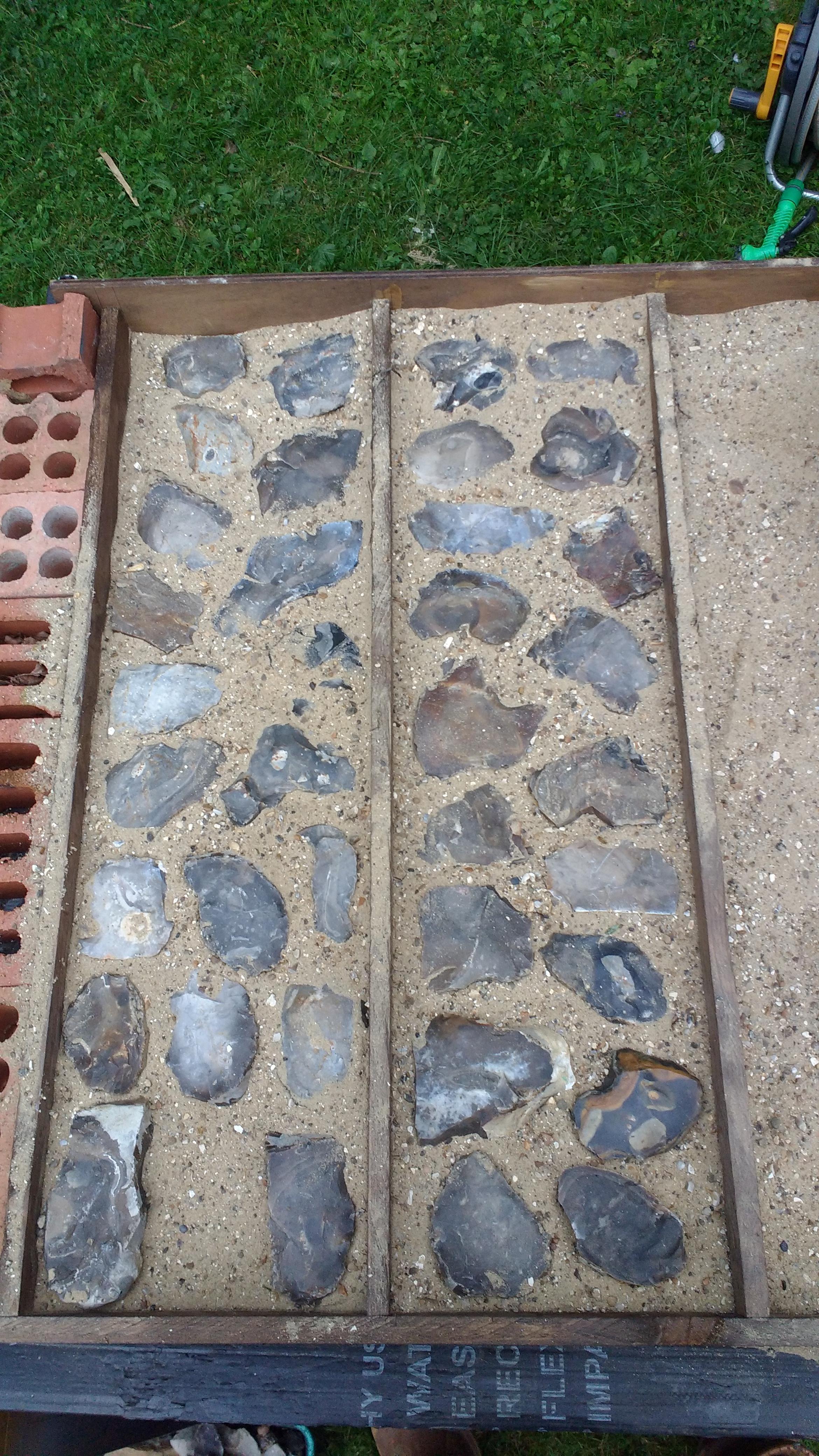

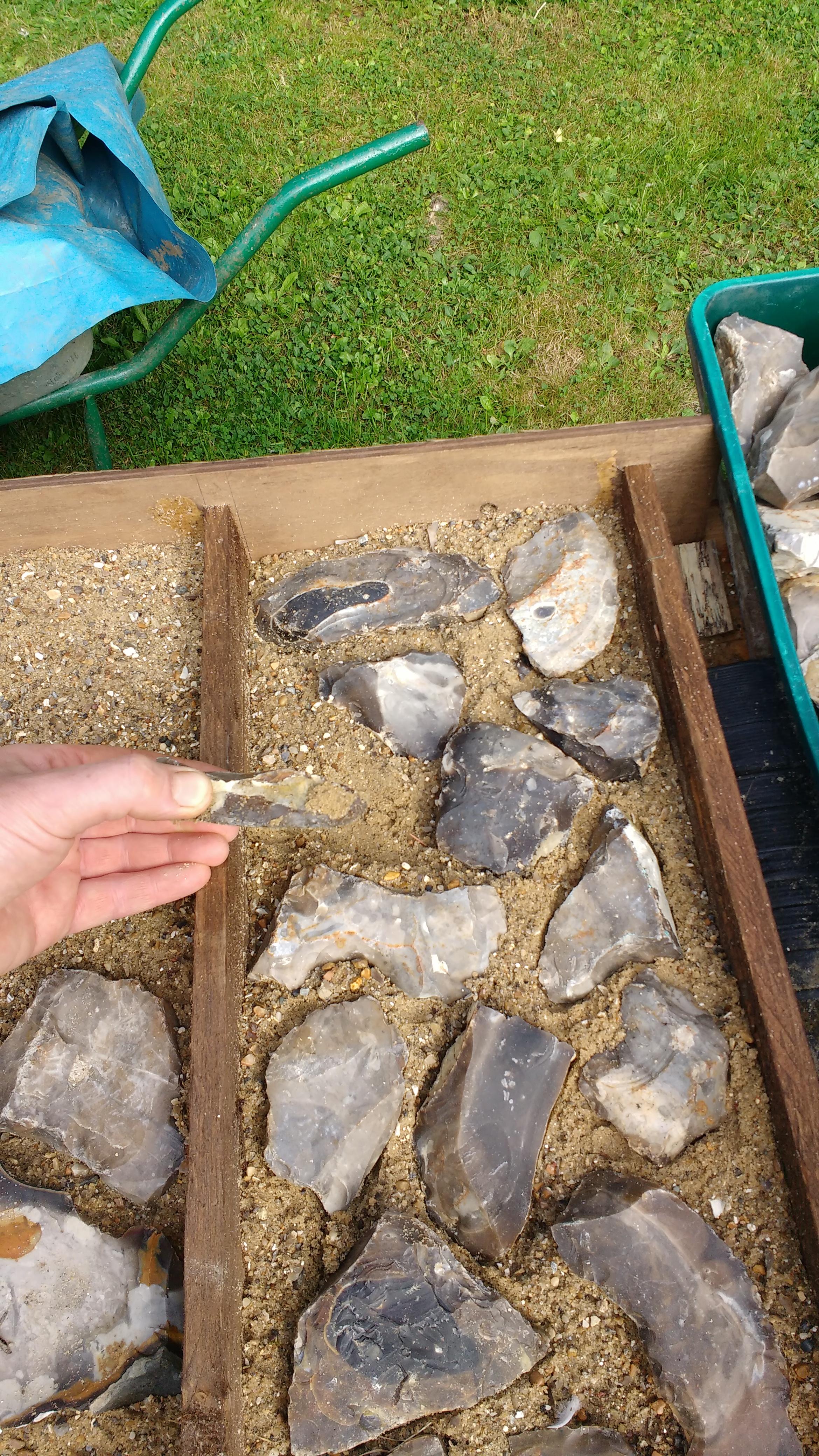

Onoff Posted September 1, 2021 Author Share Posted September 1, 2021 Still undecided as I am on mix I knocked up a quick frame of pallet wood, divided into 4 to represent the 4 flint panels. Dumped some sharp sand in each. Apparently I get to choose the stones for one then SWMBO and the kids one each. This is my attempt (the rectangular gap at the end nearest the camera is where the intercom sits). I might change the couple of whiter stones for blacker ones. I've read that "fist size" are ideal but without knapping them this is the best I can do. If I start knapping I'll likely end up with just loads of broken flints! Playing with the second panel: Some don't have a tail / much depth so I'll be relying on the suction of whatever mortar then CT1 when bits fall out! Link to comment Share on other sites More sharing options...

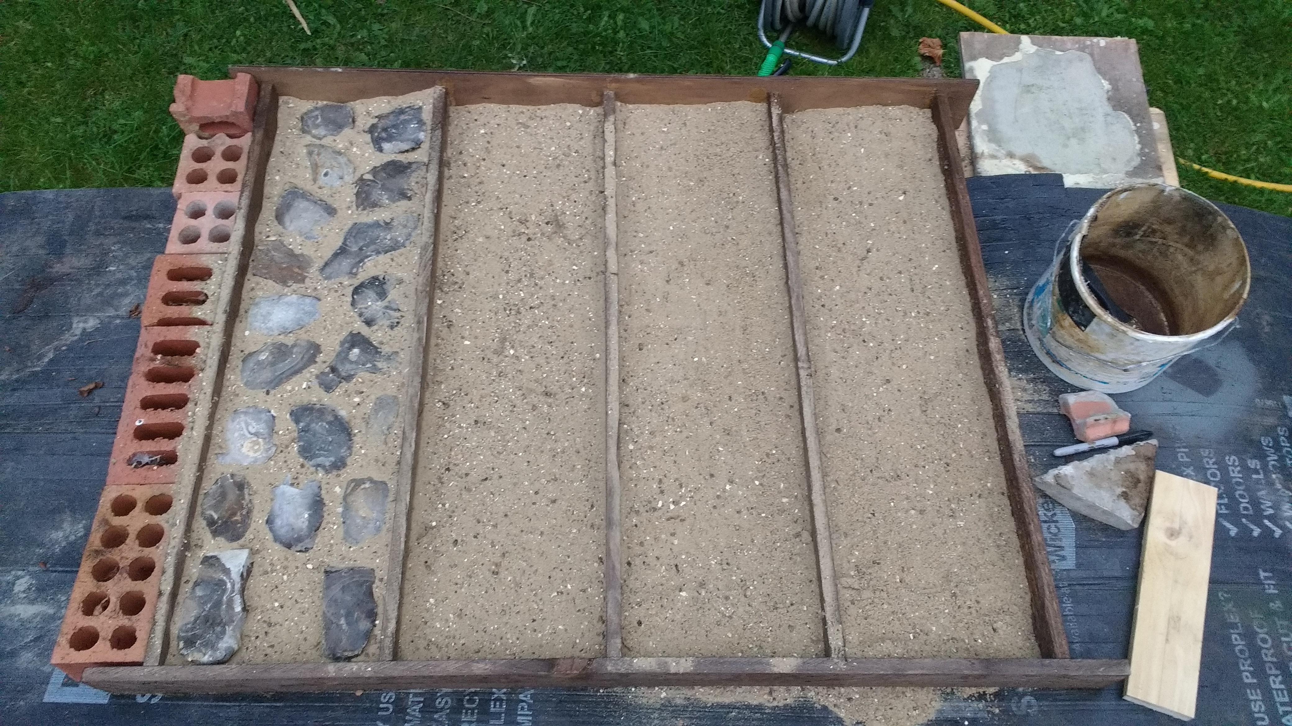

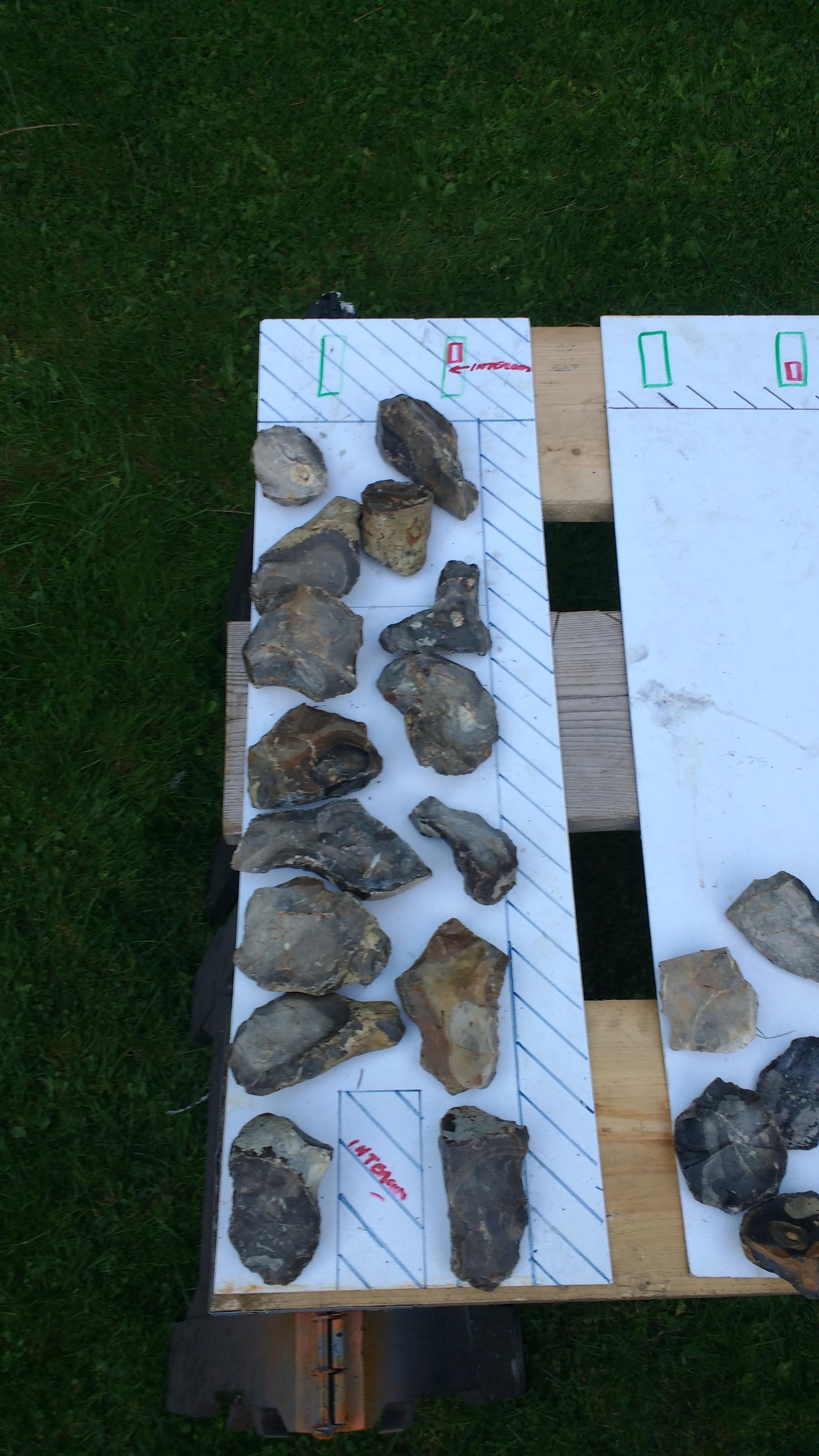

Onoff Posted September 20, 2021 Author Share Posted September 20, 2021 I've decided on my mix. Was waiting for SWMBO and the kids to lay out their panels. SWMBO had a go and imo it looks alright (panel No 4) but I don't think it'll work as there's little depth to the stones she's chosen. Thinking these shallow stones will maybe fall out over time? Link to comment Share on other sites More sharing options...

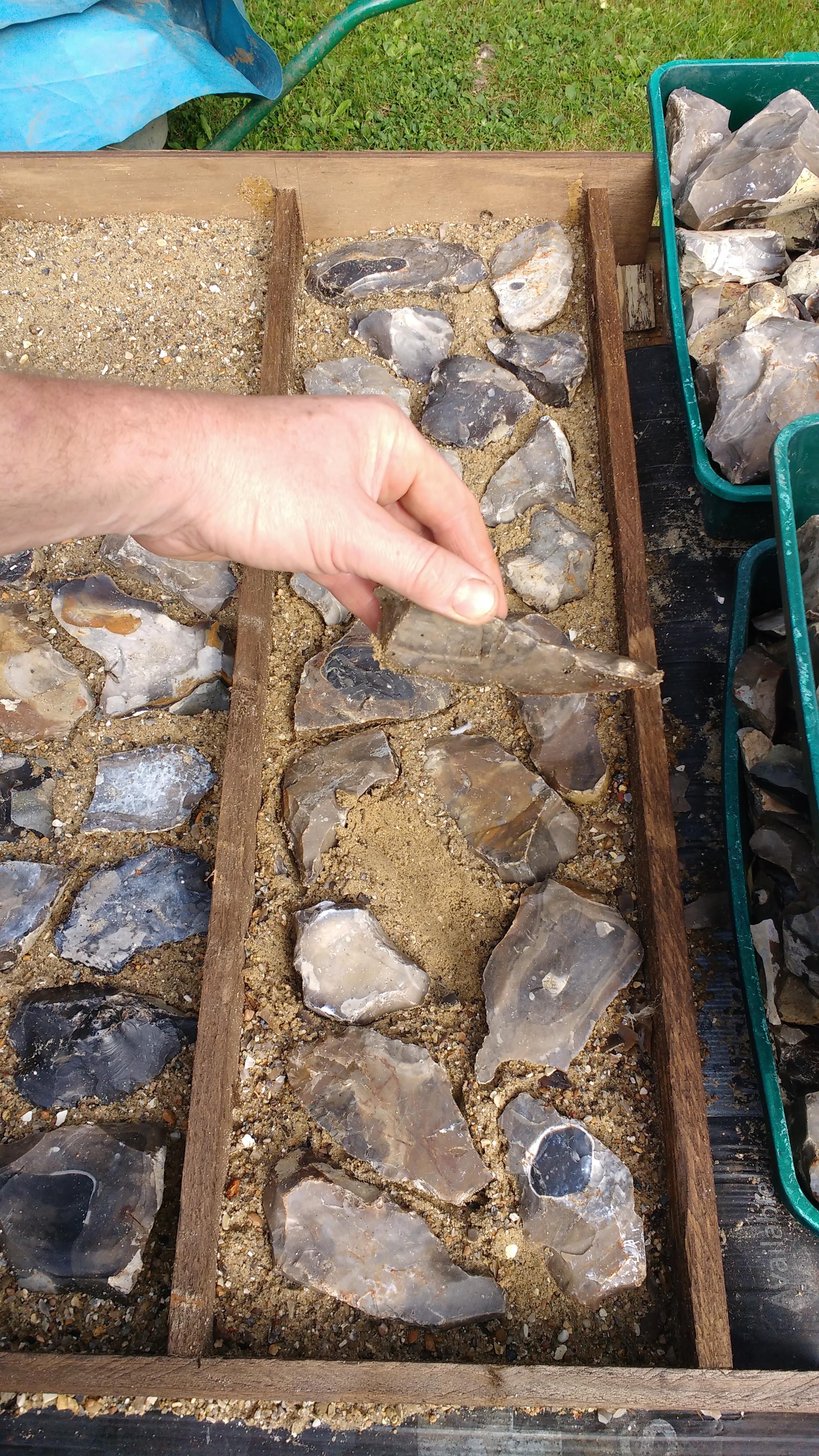

Onoff Posted October 29, 2021 Author Share Posted October 29, 2021 As alluded to above SWMBO has chosen some very pretty but unfortunately shallow flints that have very little tail. If I were to clean each flint (dishwasher?) then "glue" a small offcut of stainless mesh to the back would that work? Link to comment Share on other sites More sharing options...
Gus Potter Posted October 30, 2021 Share Posted October 30, 2021 On 20/09/2021 at 08:23, Onoff said: I've decided on my mix. Was waiting for SWMBO and the kids to lay out their panels. SWMBO had a go and imo it looks alright (panel No 4) but I don't think it'll work as there's little depth to the stones she's chosen. Thinking these shallow stones will maybe fall out over time? Onoff.. You are a star! .. what lovely hands. Are they yours? and the flints look great by the way. My view is that cement is not an option. All cements shrink.. flints have a very smooth impermeable surface and you won't get a flexible bond if you use a mix with any cement content. Plenty info about lime mortars from other poster already. One great thing is that if you use non hydraulic lime you can do a foot or so every few days.. just have fun! Just put a cover over it to keep the rain off. You may build say a foot every few days, but if it's not looking right you can take it off, clean the flints and have another go. Harder to do if using a cement based mortar. I real life you just need to get on with it, stand back and see how you go! even if you have a template once you get a foot or so up it will all go to pot. Link to comment Share on other sites More sharing options...
