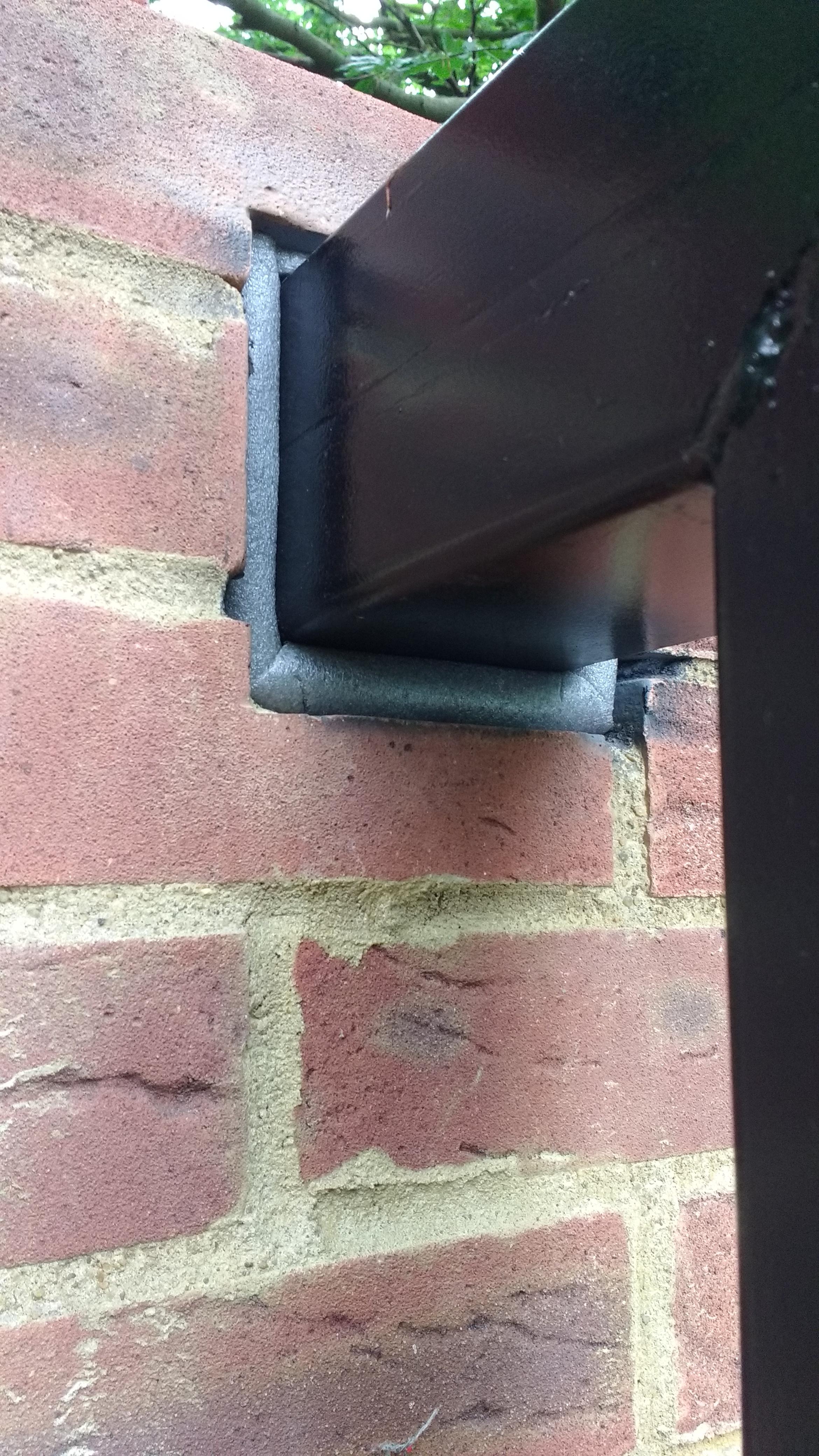

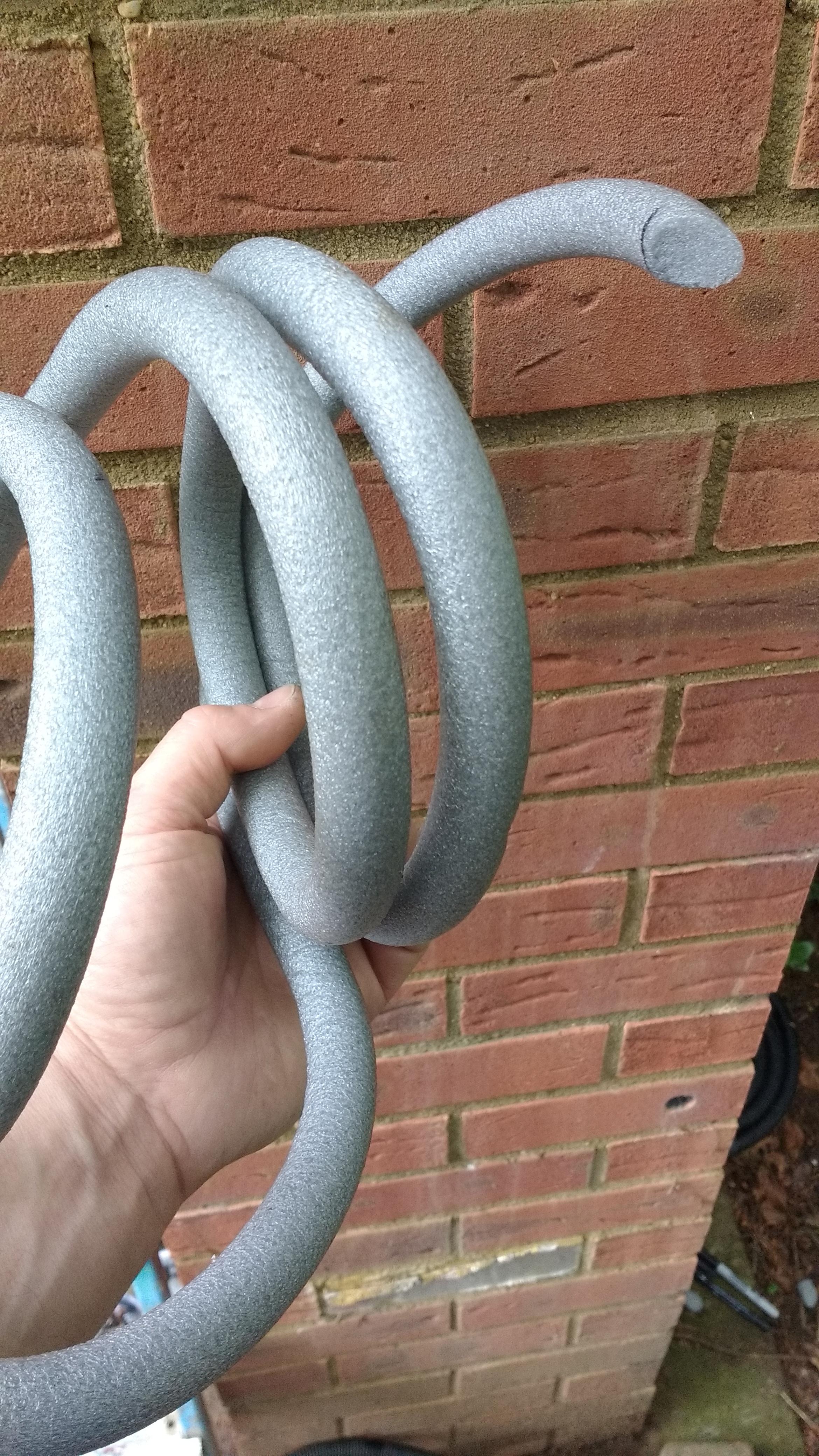

Onoff Posted June 29, 2021 Author Share Posted June 29, 2021 Getting ready for the buff coloured silicone! Packed with this stuff first: Looking forward to giving the pillars a mild Disclean! Link to comment Share on other sites More sharing options...

Onoff Posted June 29, 2021 Author Share Posted June 29, 2021 It's RUSTIC! ? 1 Link to comment Share on other sites More sharing options...

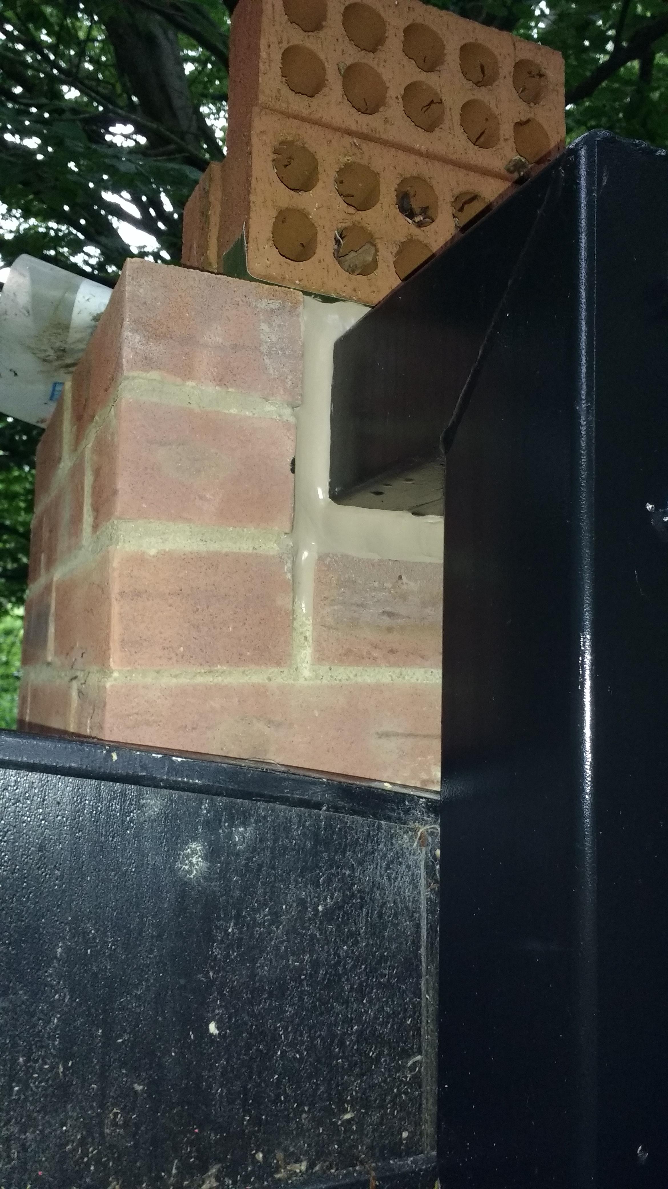

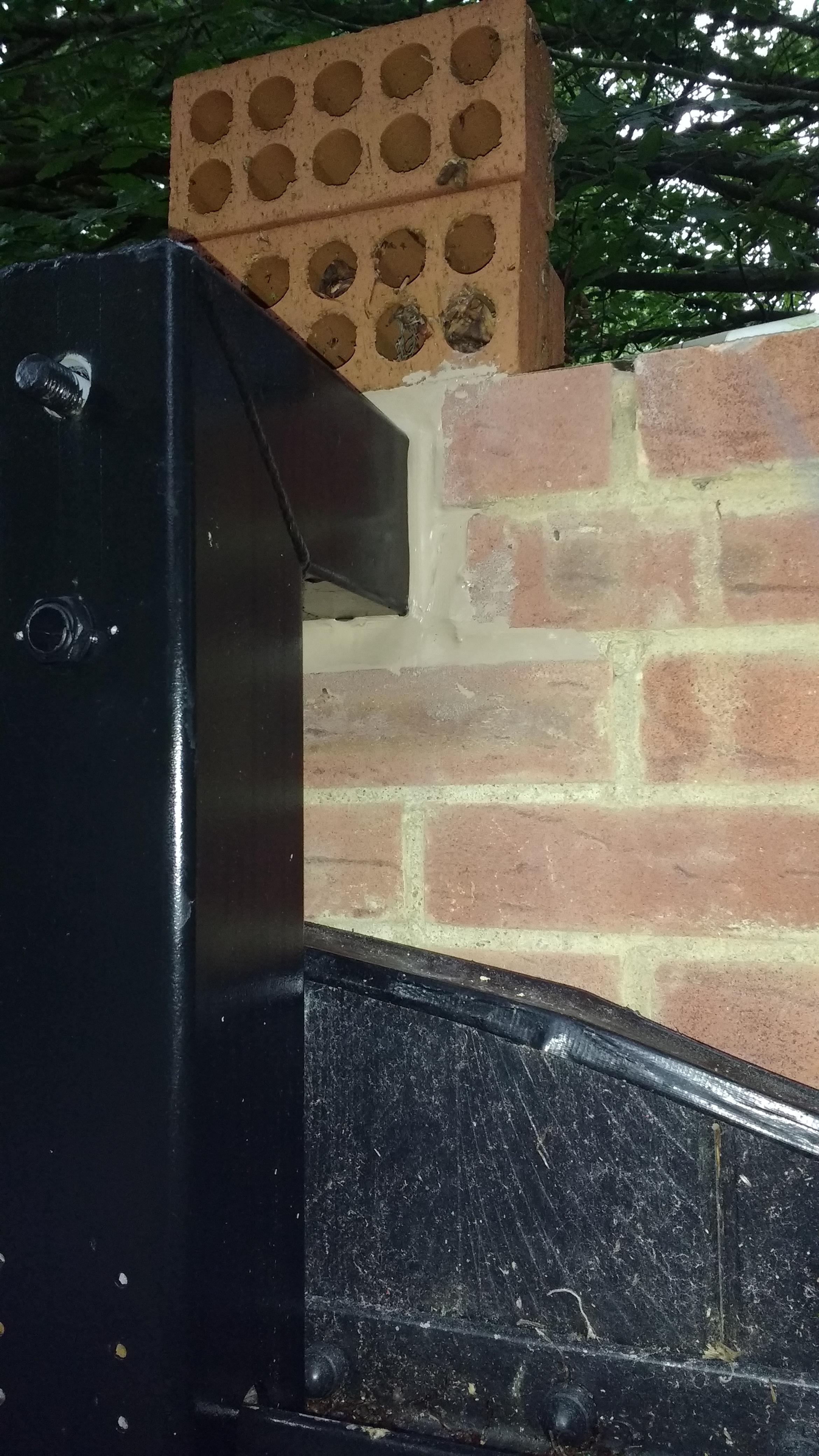

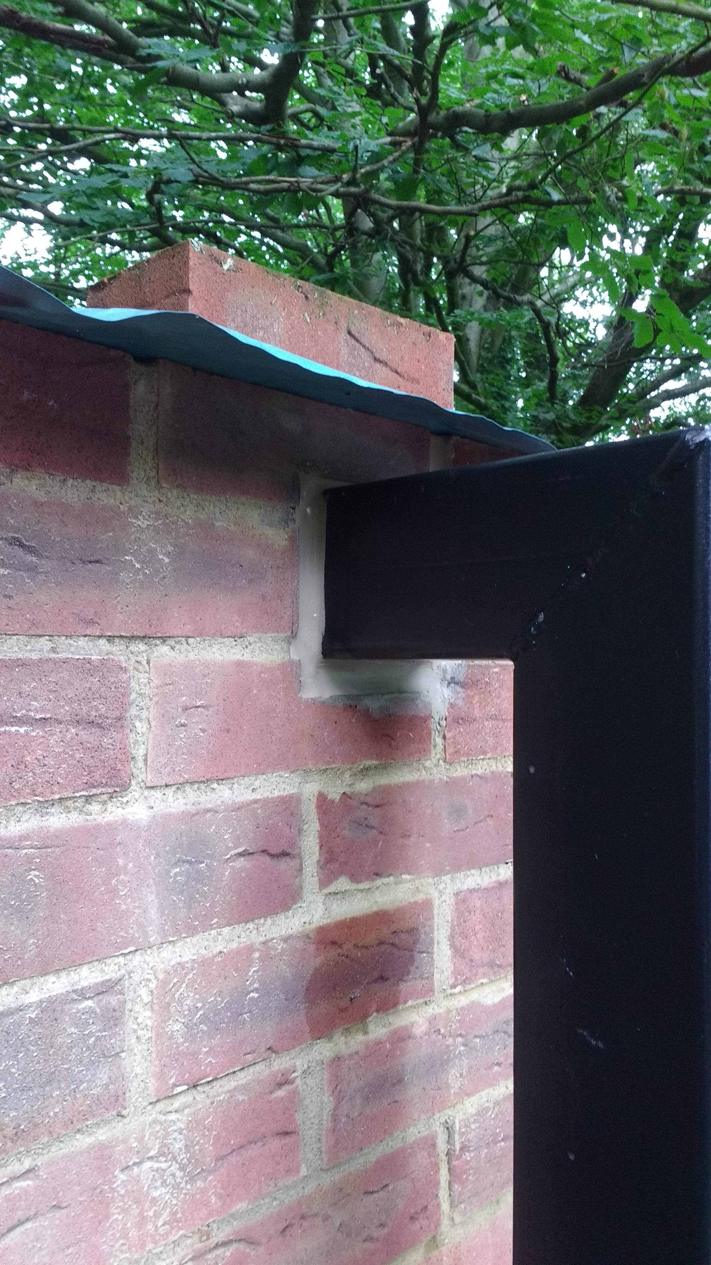

Onoff Posted June 29, 2021 Author Share Posted June 29, 2021 The other pillar: This side will be in shadow ?: A very careful application of silicone eater might tidy the bricks up a bit. Should have masked up first I guess! I'll admit to resorting to a surgical glove dipped in a water / washing up liquid mix to finish things off! 1 Link to comment Share on other sites More sharing options...

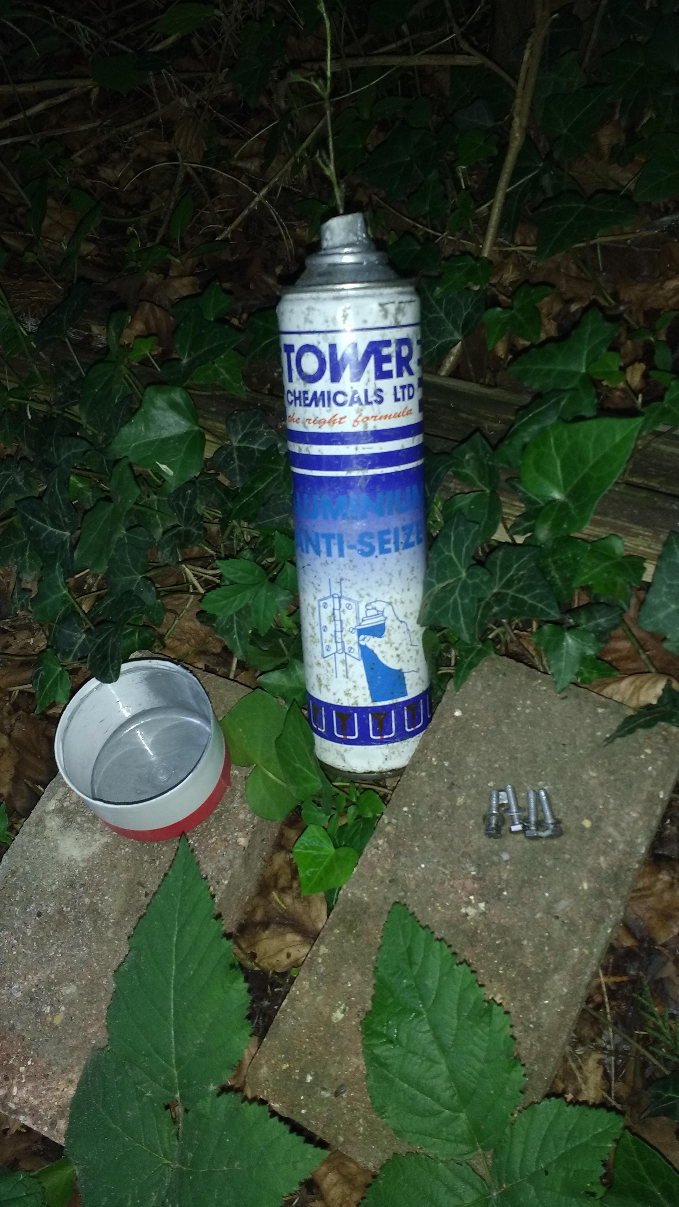

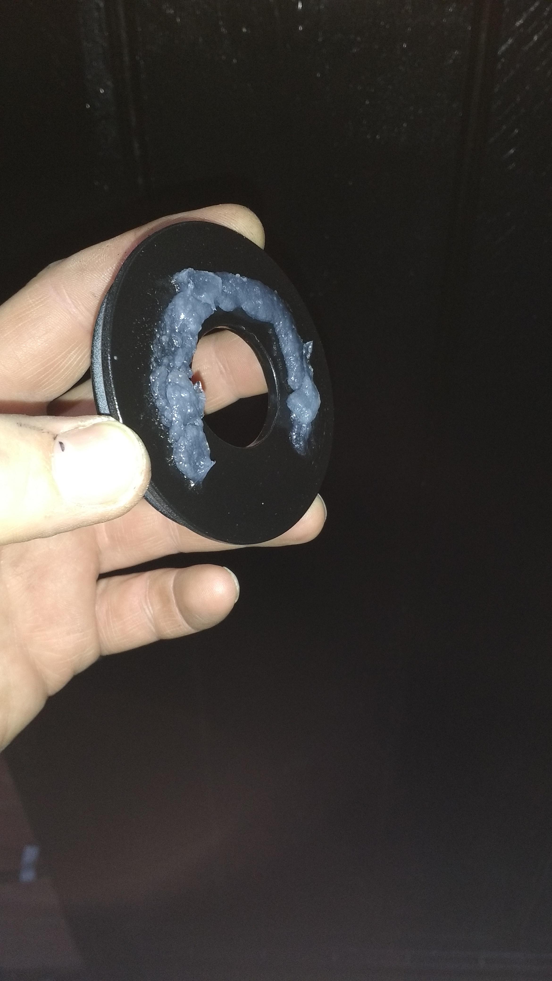

Onoff Posted June 29, 2021 Author Share Posted June 29, 2021 (edited) A smidge of aluminium anti seize on the M4 screws: A horse shoe of silicone grease: Nut 'em up: A good hard rub round the rim with a moist toilet tissue to get rid of the excess lube...and roughly what it'll look like finished. Still awaiting someone coming back who's hopefully laser cutting me some Celtic cross washers to go under the stainless dome nuts! Edited June 29, 2021 by Onoff Link to comment Share on other sites More sharing options...

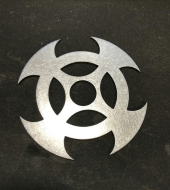

Onoff Posted June 30, 2021 Author Share Posted June 30, 2021 Test "washer" laser cut out of mild steel. One of these in stainless will go under the dome nut above the down lighter. Link to comment Share on other sites More sharing options...
Pocster Posted June 30, 2021 Share Posted June 30, 2021 55 minutes ago, Onoff said: Test "washer" laser cut out of mild steel. One of these in stainless will go under the dome nut above the down lighter. Ninja throwing star !! Link to comment Share on other sites More sharing options...
