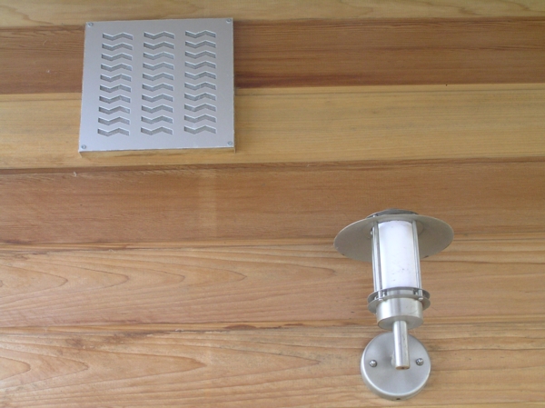

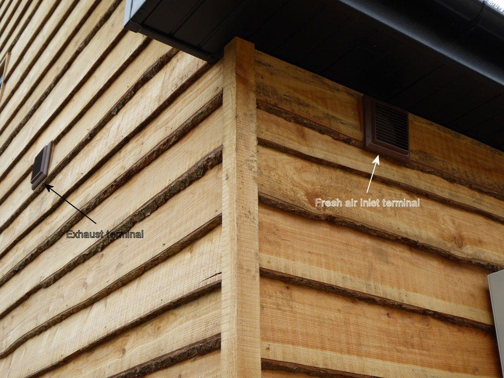

Jeremy Harris Posted July 8, 2016 Share Posted July 8, 2016 I used 150mm plastic duct (fine for the max airflow with our unit) but did, like Peter Starck above, find that the external fittings restricted the airflow. They also increase the external noise on the inlet, I think. It is surprising how much external noise there is with a short duct on the inlet - the exhaust doesn't seem to make much noise at all, even though the duct is still pretty short. What I've found is that the square plastic external terminals I've fitted, these ones: tend to collect a lot of fluff, spiders webs, dandelion seeds etc on the inlet side and need very regular (as in every two to three weeks in summer) cleaning. I also think they may well be quite restrictive, so I've bought some stainless steel cowl-type external grills that I'm hoping will reduce the flow noise a bit and not get so easily blocked up, like this, but for 150mm duct: Link to comment Share on other sites More sharing options...
Stones Posted July 8, 2016 Share Posted July 8, 2016 150mm pipework is what was specified for our house (by BPC) and we have an internal volume approaching 480m3. I recently took delivery of all my ductwork and MVHR unit. They had included the S/S external cowls pictured by Jeremy above which do look nice and smart, albeit for various reasons we are going out through the roof using 150mm spigot tile vents. Link to comment Share on other sites More sharing options...
ProDave Posted July 8, 2016 Author Share Posted July 8, 2016 I like those SS cowls. Do you want to sell your spare ones Jason? if so I'll buy them then I just need two lengths of rigid ducting to put through the wall. Link to comment Share on other sites More sharing options...
Jeremy Harris Posted July 8, 2016 Share Posted July 8, 2016 I must get around to fitting the new SS cowls I have, I've had them for months and just haven't got around to making up a tapered backing board from a bit of spare larch to allow them to fit flush with the cladding. Be aware that some suppliers charge really silly prices for those cowls, £40 plus each. I bought mine (which are absolutely identical to the one in the photo above, but 150mm rather than 125mm) for a lot less than the price some ventilation suppliers were aslking. IIRC, Mine came from ebay for around £20 each, probably from a seller like this one: http://www.ebay.co.uk/itm/Stainless-Steel-Ventilation-Vent-Outlet-Exhaust-Grilles-100-125-150mm-Ducting-/261528397833?var=560404344005&hash=item3ce44ea809:m:m4MVEHjFVSZC4Zds85pdE1g Link to comment Share on other sites More sharing options...
ProDave Posted July 8, 2016 Author Share Posted July 8, 2016 2 hours ago, JSHarris said: It is surprising how much external noise there is with a short duct on the inlet - the exhaust doesn't seem to make much noise at all, even though the duct is still pretty short. the lesson from that, in my case where for aesthetic reasons I plan to put one each end of the wall, is make the inlet the one that has the long run, and the outlet to the one that has the shorter run. Link to comment Share on other sites More sharing options...

Gone West Posted July 9, 2016 Share Posted July 9, 2016 I bought S/S vent cowls for my system because I thought they looked smart. I then read on a forum, can't remember where, that they reduce the flow of air significantly that is being taken into the MHRV unit. As I am using only 125mm ducting I decided to make my own vent that didn't reduce flow. Link to comment Share on other sites More sharing options...
Jeremy Harris Posted July 9, 2016 Share Posted July 9, 2016 That's a good point, I'll measure up the area of the open intake versus the duct area and see if there is a difference. Certainly the square plastic grilles I have are restrictive, I'm sure. Although they are around 200mm square, a lot of are is taken up by the slats, plus there is a plastic mesh behind the slats that seems to get clogged up fairly easily. One reason for me buying the cowl-type terminals was so that I could angle the intake (which is tucked up right under the eaves overhang) away from the prevailing wind, as one mistake I made was to put the intake and exhaust at right angles to each other, at the corner of the house. Although we've in a sheltered area, the slightest breeze does unbalance the system a lot, as I discovered when I was setting it up. The prevailing wind comes from the right in that photo above, so blows across the intake duct and probably creates a slight pressure reduction at the exhaust terminal. The plan is to angle the intake cowl so that there is also a slight pressure reduction from the prevailing wind, with the hope that this will help reduce the imbalance. I was also hoping that angling it like this might reduce the chance of wind-blown "fluff" getting caught in the grill. Link to comment Share on other sites More sharing options...

readiescards Posted July 10, 2016 Share Posted July 10, 2016 On 08/07/2016 at 16:02, JSHarris said: What I've found is that the square plastic external terminals I've fitted, these ones: tend to collect a lot of fluff, spiders webs, dandelion seeds etc on the inlet side and need very regular (as in every two to three weeks in summer) cleaning. Gosh I don't want to be going up a 3 storey ladder every few weeks to clear some fluff - might need to have a think how to clean the vents from inside 1 Link to comment Share on other sites More sharing options...
