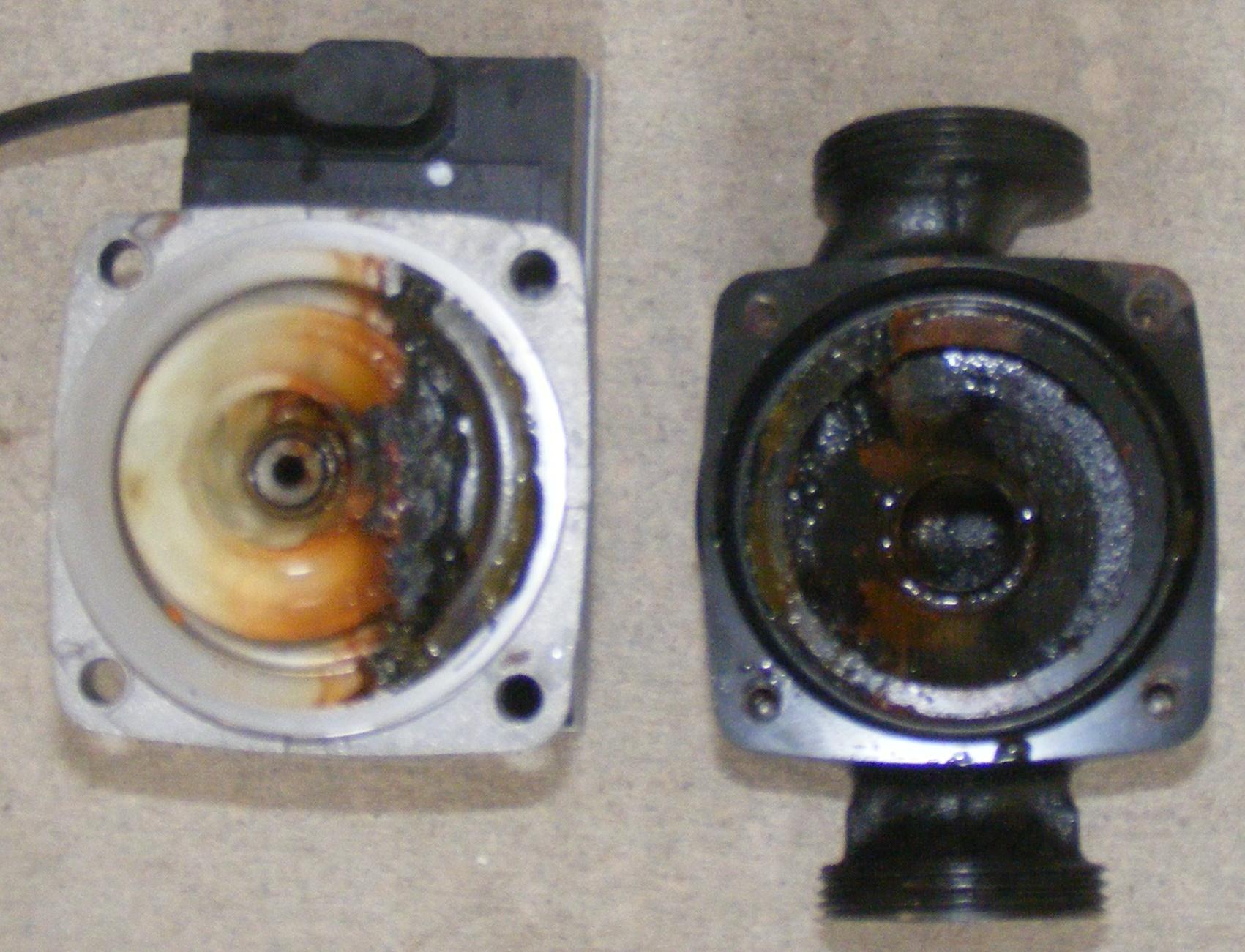

Anyway, I have done a post Mortem on the Wilo pump and it is not pretty.
Clearly this unit has been sat some time with some horrible rusty water in it. The pump was seized solid. It would not surprise me if the plate heat exchanger is not gummed up solid as well.

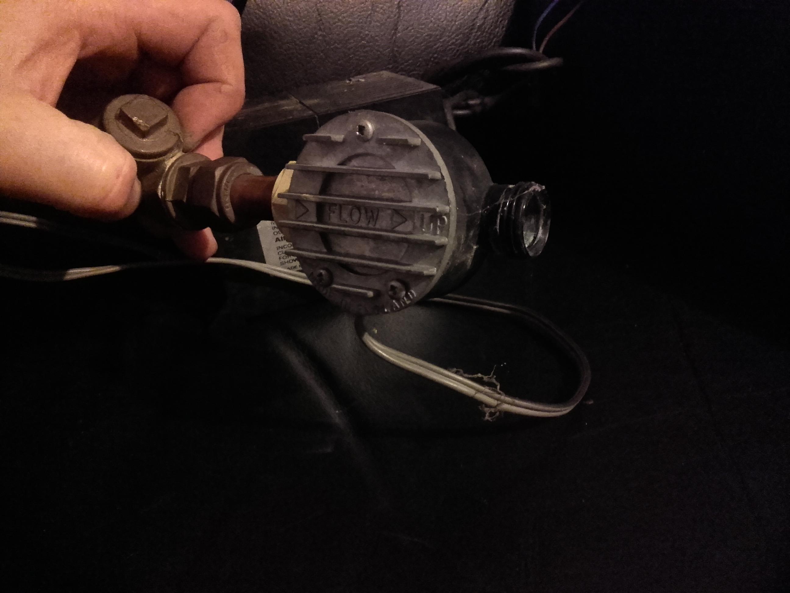

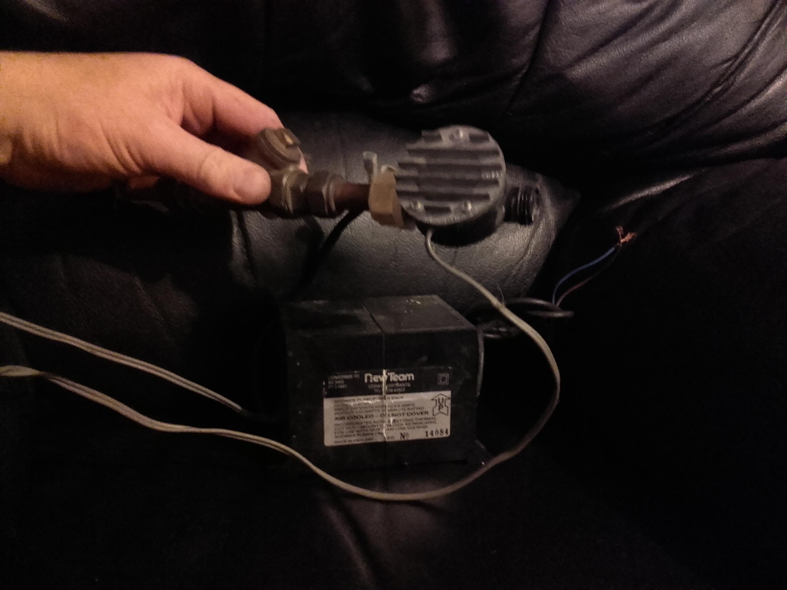

I might have an old flow switch off of a NewTeam shower somewhere...
Think it's 15mm though...come to think of it it might be for 24vdc.
Edit: Found it:

I am struggling to work out just how this got in such a state.  It was not just a case of plain water was left in the pump for a while. Once I cleaned it up, the body of the pump was pretty good, and the impellor is plastic and the other bit stainless steel. So the rust did NOT come from the pump or any other internal part of the heat pump which is all stainless, copper or brass.
So it must have been connected to a system full of dirty rusty water, and then not rinsed. Another unit with a dubious history?

Well I told them it was faulty and sent the picture of the pump.  They swear it was brand new and are arranging for the manufacturer to fix it. Watch this space.

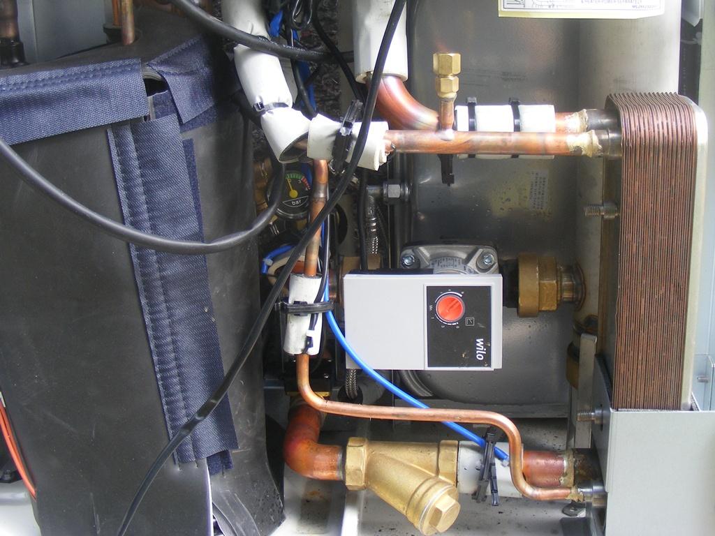

Here is a picture of the pump / phe / willis heater in the new one.pump_phe.thumb.jpg.4bc1766bdfa0f1eca95b91e725e5d7f9.jpg
Posted
8 minutes ago, PeterW said:
I'd pull the gauze on that Y Strainer too and see whats in there
I did, and it was pretty clear.
But I'll bet the bottom of the willis heater tube has some crud in it. And no way to drain that.
