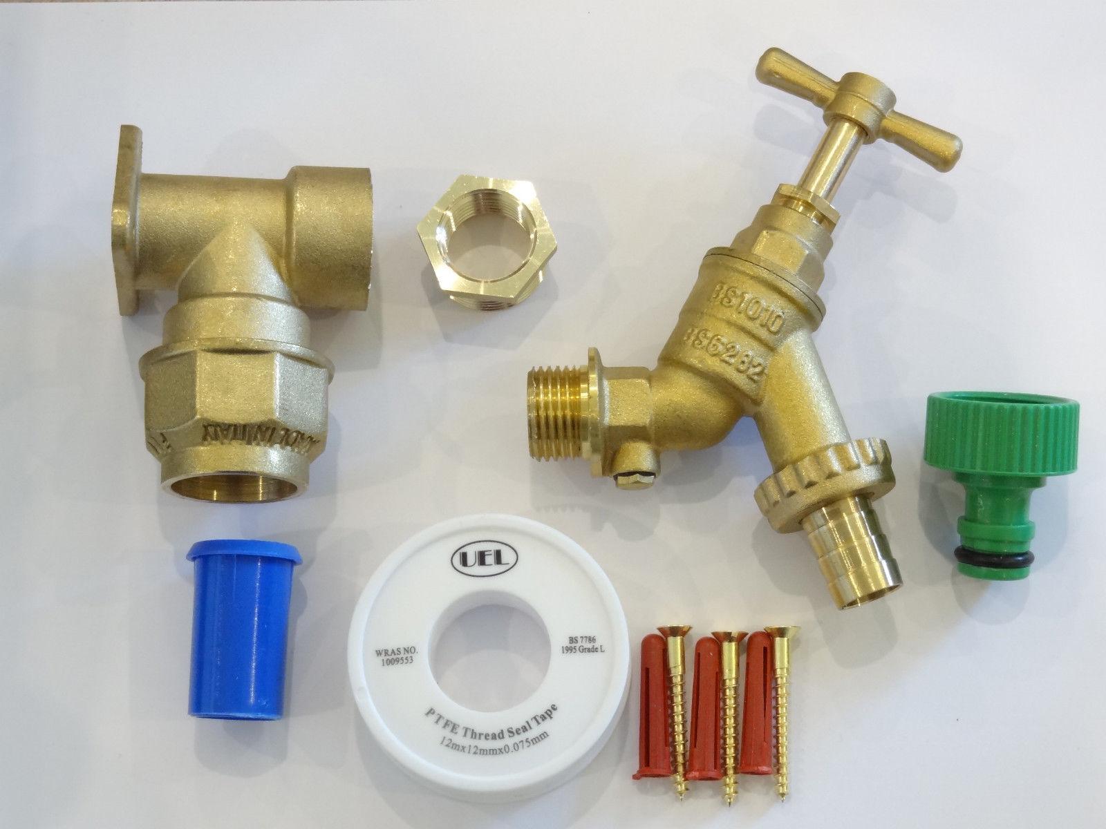

vfrdave Posted May 30, 2018 Posted May 30, 2018 I have an outside tap temporarily on site, it has recently started blowing off the end of the of the mdpe pipe. It is more or less identical to the one in the pics. Anyone got any wonderful ideas to keep it on the end of the pipe and stop my water main gushing water endlessly until found on site.
PeterW Posted May 30, 2018 Posted May 30, 2018 (edited) Bin the tap Get a Plasson 25/22 stop tap Make up a 22 > 22/15 Reducer > 15 section of pipe New 15mm tap with DCV Edited May 30, 2018 by PeterW Link
Nickfromwales Posted May 30, 2018 Posted May 30, 2018 You can get a fitting that'll go 25x15mm iirc. Link "Stick that in your pipe and....connect it".
PeterW Posted May 30, 2018 Posted May 30, 2018 Ignoring the Welsh wonder, I linked the Plasson 25/22 as you can reuse it on your house supply as a permanent stop tap..... ?
Nickfromwales Posted May 30, 2018 Posted May 30, 2018 3 minutes ago, PeterW said: Ignoring the Welsh wonder, I linked the Plasson 25/22 as you can reuse it on your house supply as a permanent stop tap..... ? Good save lol .

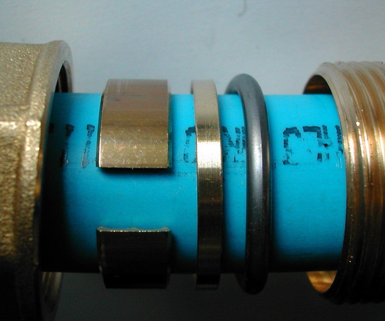

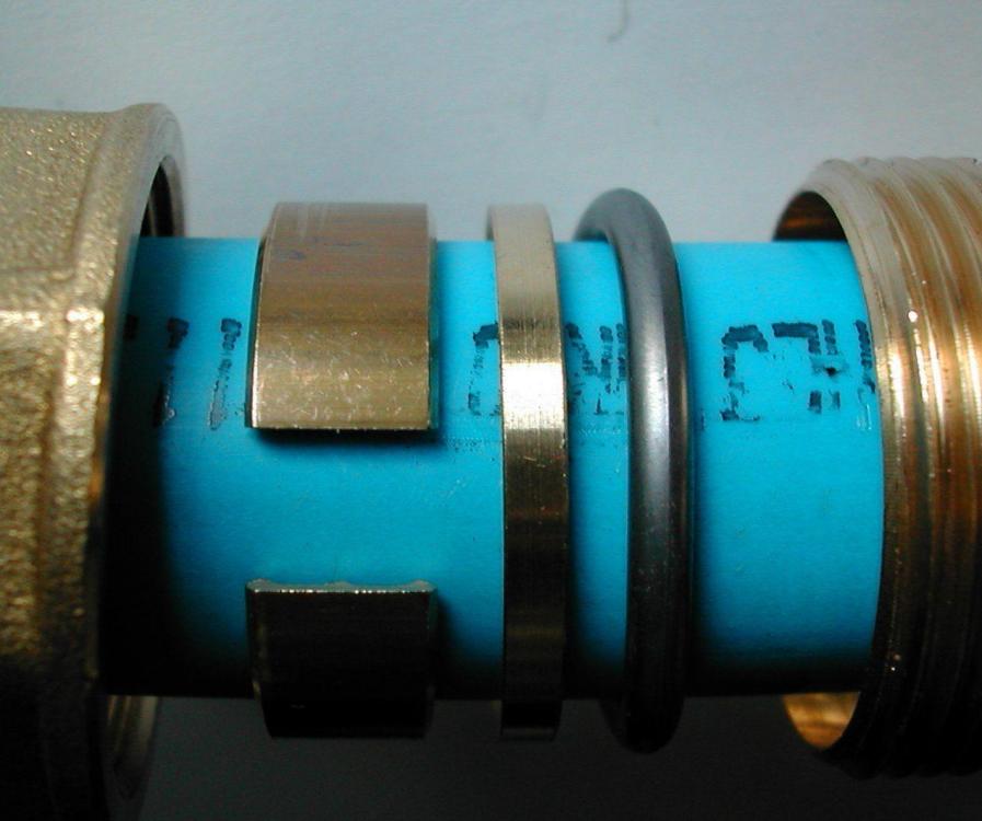

ProDave Posted June 2, 2018 Posted June 2, 2018 I just use an all plastic mdpe tap elbow into which a standard brass tap screws https://www.screwfix.com/p/floplast-mdpe-plastic-wall-plate-elbow-20mm-x/62324 The split ring on the left of your exploded assembly picture is supposed to have serations on the inside to grip the pipe. If the pipe is blowing off it is either not tight enough, or your serations are worn hence it is not gripping the pipe.
vfrdave Posted June 3, 2018 Author Posted June 3, 2018 Insert is fitted. The pipe was worn around the top from the serations so I cut the pipe yesterday and refitted. It seemed a good bit tighter than before but who knows there could be 6 bar pressure of water blasting everywhere.

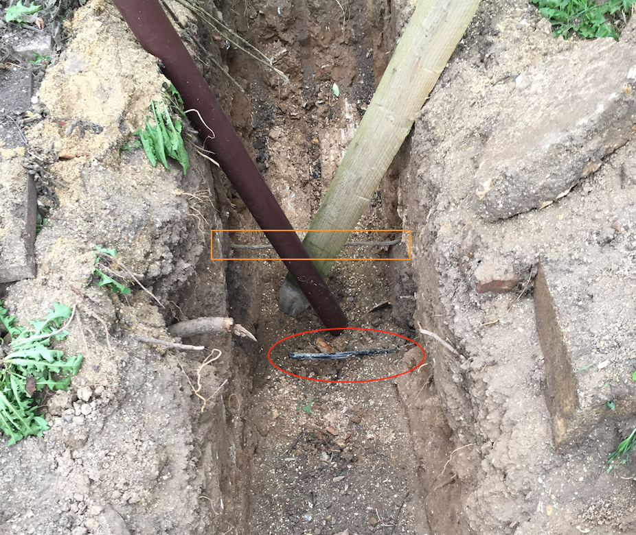

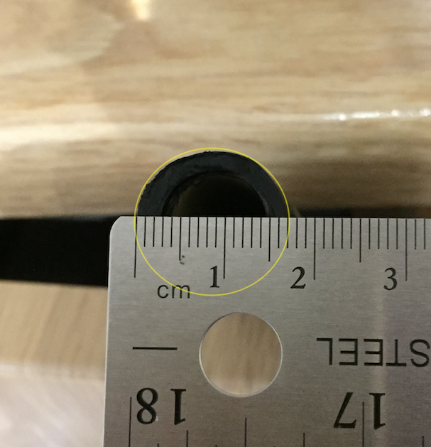

Russdl Posted August 20, 2018 Posted August 20, 2018 Well, a friend bought his mini digger round and we've found the water main... It's not iron or lead, it's black poly (is that the correct technical name?) We also unearthed a steel cable buried around the same depth, can anyone tell me what that is for? Should I hide it quick? The water main itself is externally just shy of 3/4" and internally it's pretty much bang on 1/2". So, have I got a 3/4" or 1/2" black poly main? I'm assuming it will be imperial as I suspect it's been there for decades (in new money, externally it's 17.5mm).
Nickfromwales Posted August 20, 2018 Posted August 20, 2018 I think it's 20mm old school mdpe. Plassoon fitting will go straight on and fix onto that with zero issue. If you want to tee in you'll have to expose about a metre so you can form an S in the pipe to bring the tee in, basically bending the shit out of it until you get success. If it's for a temp supply just cut 150mm out and whack an elbow on. Once vertical and above ground whack another bend on and then a 'plastic' stopcock. Alterations or damage can be easily managed by anyone on site then plus you can isolate overnight ( if on a meter and don't want any possible expensive leaks ).
Russdl Posted August 20, 2018 Posted August 20, 2018 Thanks Nick. It's definitely sub 20mm external diameter, no more than 17.5mm, should there really be a 2.5mm tolerance? The plan is to have a standpipe off the main at that location as a temporary supply and then, when the build is complete, run the main from that point to the new house. I was thinking of a 90° elbow up to the standpipe and at a later date, replace the 90° elbow with and in line join for the new supply. Are there massive flaws in that plan?
Nickfromwales Posted August 20, 2018 Posted August 20, 2018 The ruler doesn't lie. I came across this stuff a couple of times. Once, I found a galv coupler had just been forcibly turned onto the end of it and it had been there, without issue, for a bloody long time. I turn up and fit a new stopcock, during a full-on kitchen refurb, and the bastard starts leaking. About 2" of it left showing above the slab. After trying everything else with no success I just cleaned up and refitted the coupler and it held. No rhyme or reason but I was happy enough at that stage not to ask.
CC45 Posted August 20, 2018 Posted August 20, 2018 2 hours ago, Russdl said: also unearthed a steel cable buried around the same depth, can anyone tell me what that is for? Should I hide it quick? We found similar. We were told it was prob for earthing - no idea what needed earthing where we found ours.
ProDave Posted August 20, 2018 Posted August 20, 2018 Get your local DNO (electricity network operator) to come and look at the cable to see if it's "one of theirs" I did this when I uncovered an unexpected cable, which turned out to be a disused telecoms cable.
Russdl Posted August 21, 2018 Posted August 21, 2018 @CC45 that’s been our best guess up to now, pretty heavy duty earth though! @ProDave we have the electric DNO on site in a couple of weeks so I’ll get them to peer down the hole.
Russdl Posted August 21, 2018 Posted August 21, 2018 It turns out we have a 3/8" Alkathene water main. Is 3/8" big enough to produce the goods when it comes to connecting to the new house? To set up a temporary standpipe I've got a Plasson 90° elbow (with a blue adapter) the internal diameter of the blue adapter is about 7mm. Does anyone know of alternative connectors that don't restrict the 3/8" Alkathene, I'm guessing that 3/8" is too small and 7mm is way too small?
