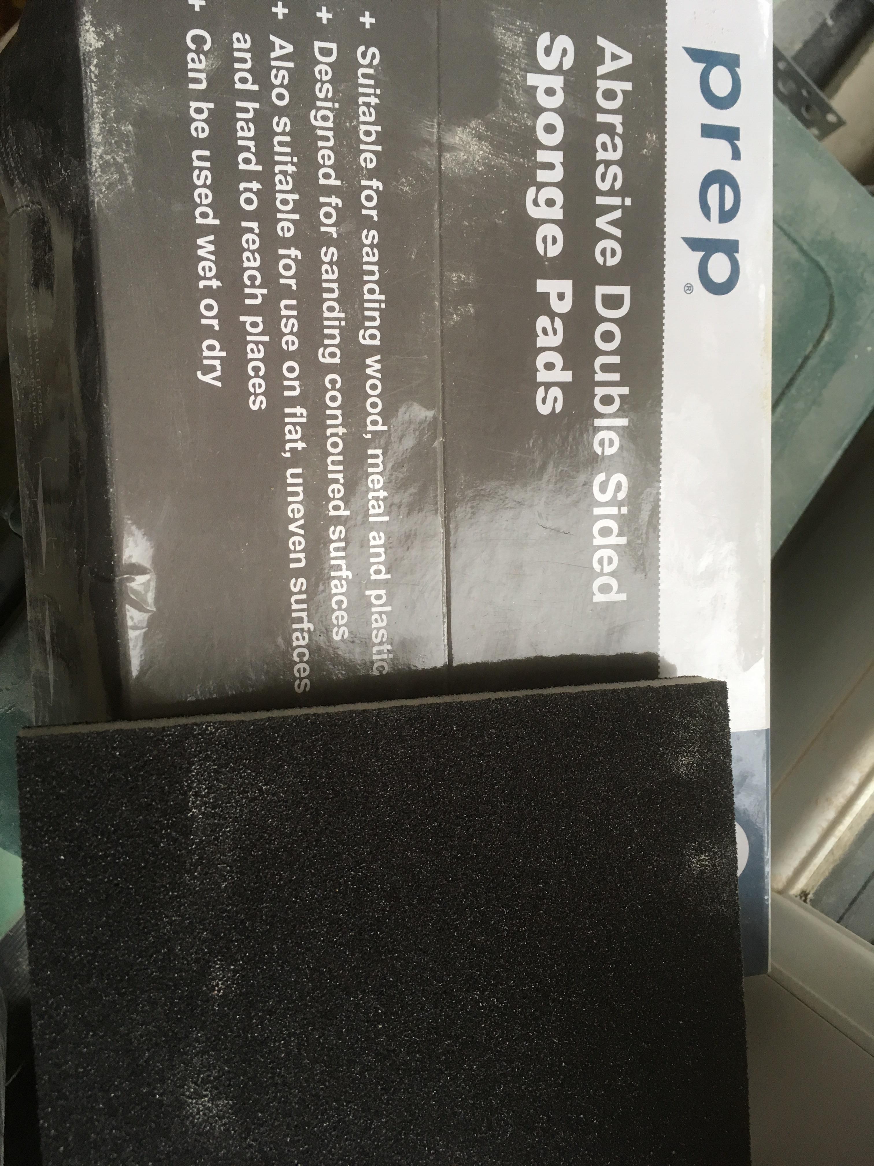

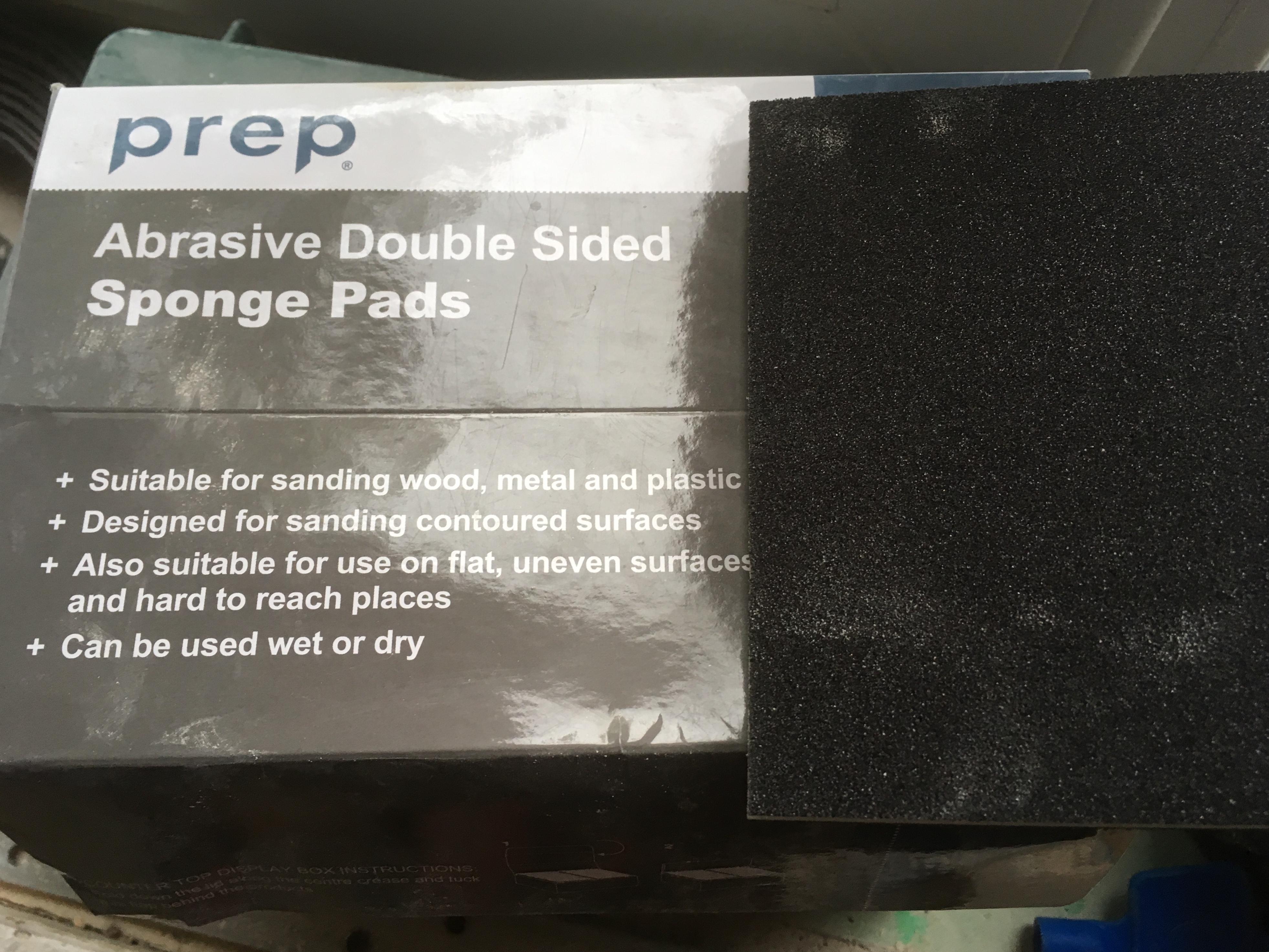

PeterW Posted May 29, 2018 Share Posted May 29, 2018 No need. I don’t use wire wool as you can leave bits behind that can rust. I use a piece of one of these 100 grit pads and go round the pipe then that’s it - flux and go as the flux will clean any chemical residue as it goes. 1 Link to comment Share on other sites More sharing options...
