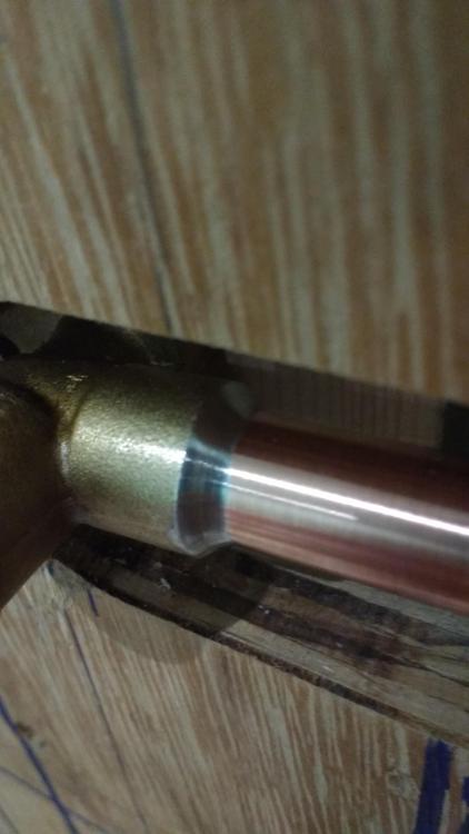

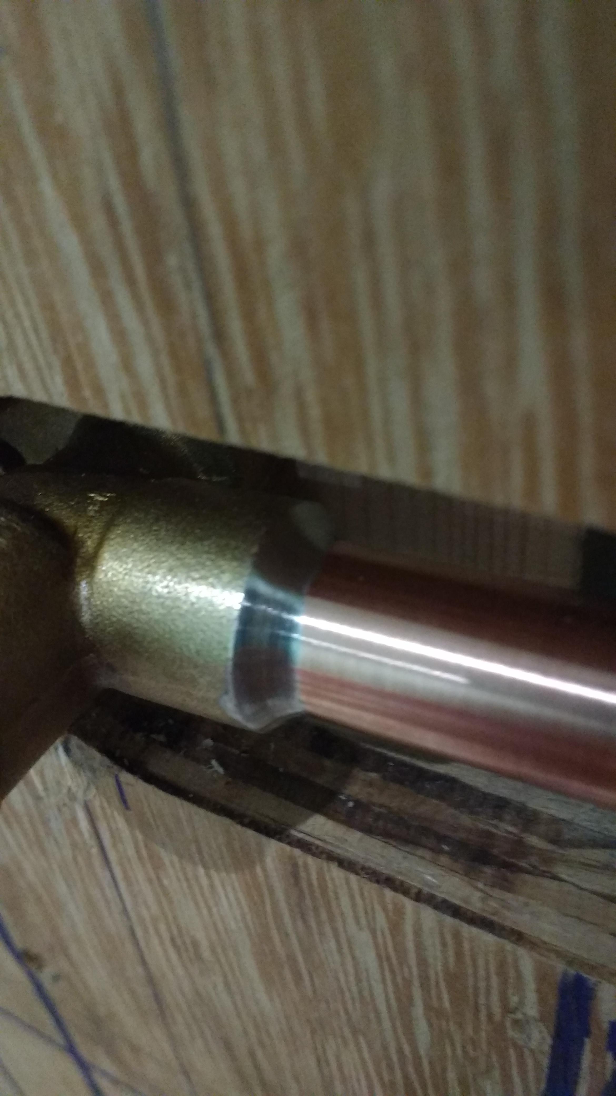

Should have added I don't think theres any benefit here in dismantling the joints youve already done either. Their Yorkshire, so would have made themselves off as per my previous.
Even if I've overheated the Hell out of them...more than once? :(
I've just ordered £30 worth of propane & lead free solder for the last couple :(
Posted
I very much doubt you've caused the weld to not form by overshooting the sweet spot. They may not look it, given that you've actually started to anneal the copper there, but the weld would have formed long before that.
Re-solder as per my instruction and report the results #2. ;).
Posted
Won't know the result until I turn the water on!
Posted
I think a bottle of Mapp lasts me 12-18 months and I’ve done about 2-300 joints off the current half full can ...... how much heat are you putting into those joints ..??!!
  • Like 1
Posted
I'll put money on it that they don't leak ( after you doing the remedial post-soldering ) but I'd be quietly confident regardless.
Posted

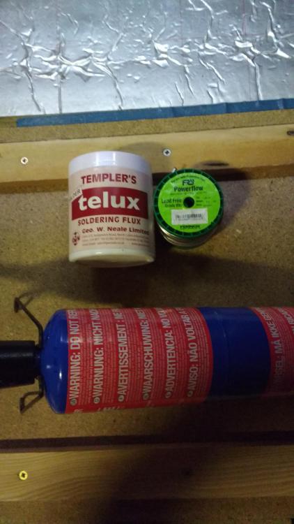

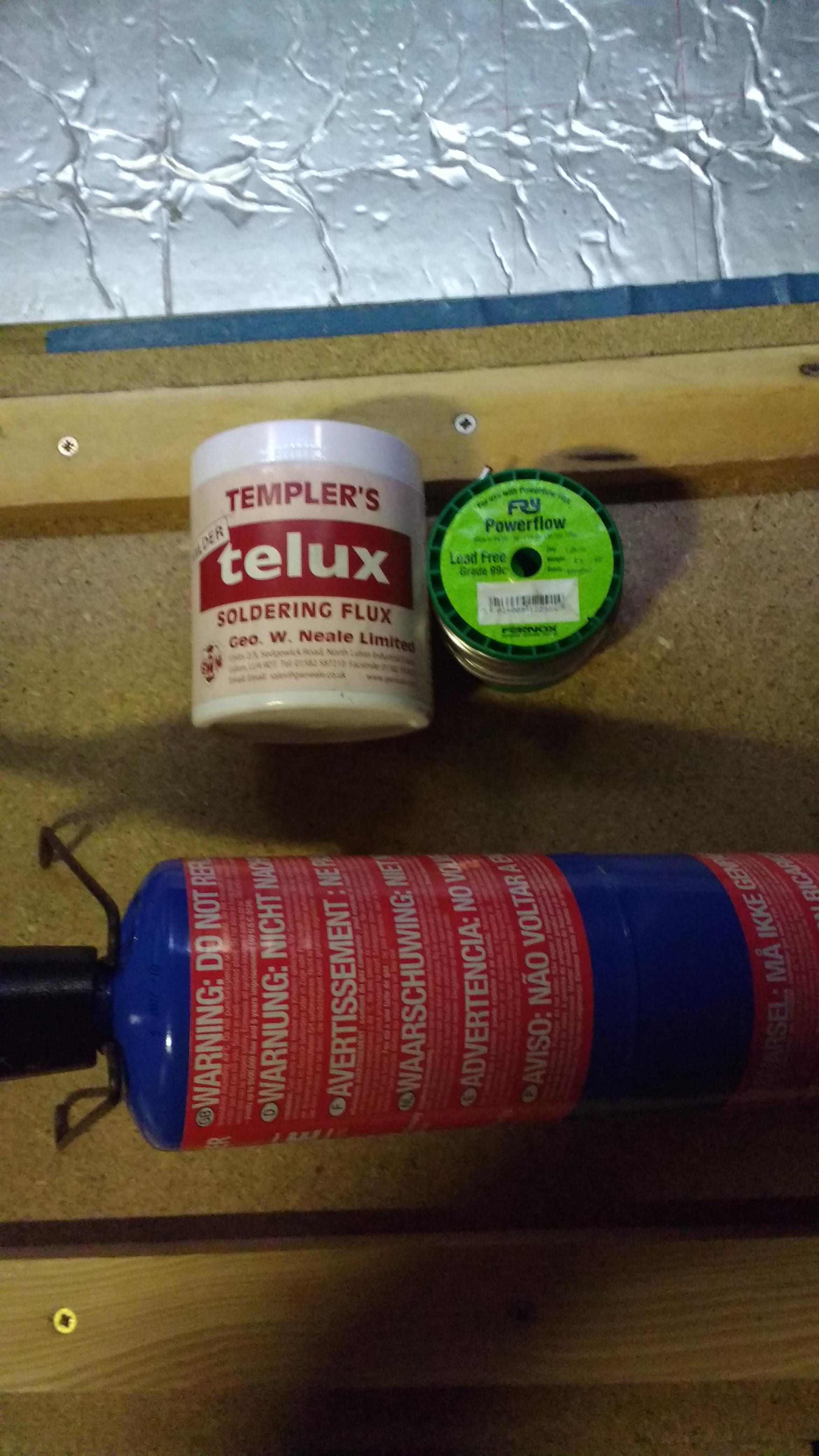

Not run out of MAPP, in fact I've a new bottle in the shed off the back of a job (I use MAPP with ZILT sticks to repair galvanised coatings). Only getting the propane to try less heat.
What's weird is I soldered the "valve" assembly using the same method and materials; wire wool, IPA clean, Templars flux, Powerflow leaded solder on Yorkshires. Used MAPP gas at the max flame setting. They came out fine...I thought. No blackening etc. I wonder if this was because I did it OUTSIDE thus the flame wasn't so hot?

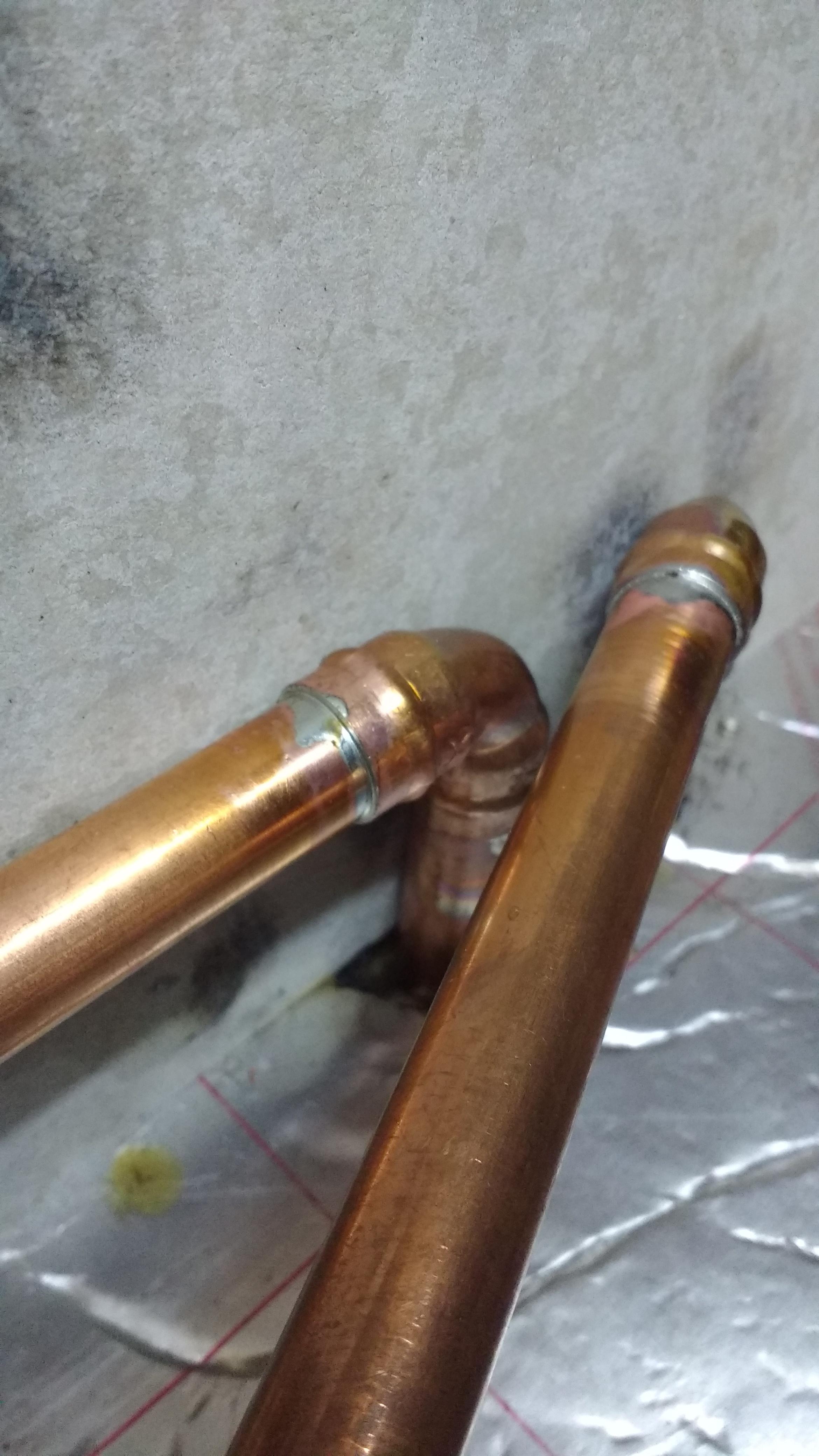

On 30/05/2018 at 14:50, Nickfromwales said:
Just too much heat, it's blatantly obvious so no need to think about it :).
Just re-solder as per my last and it'll be all gravy, baby. ?
Where is the begrudgingly, face like a smacked arse, you're right as usual emoji?

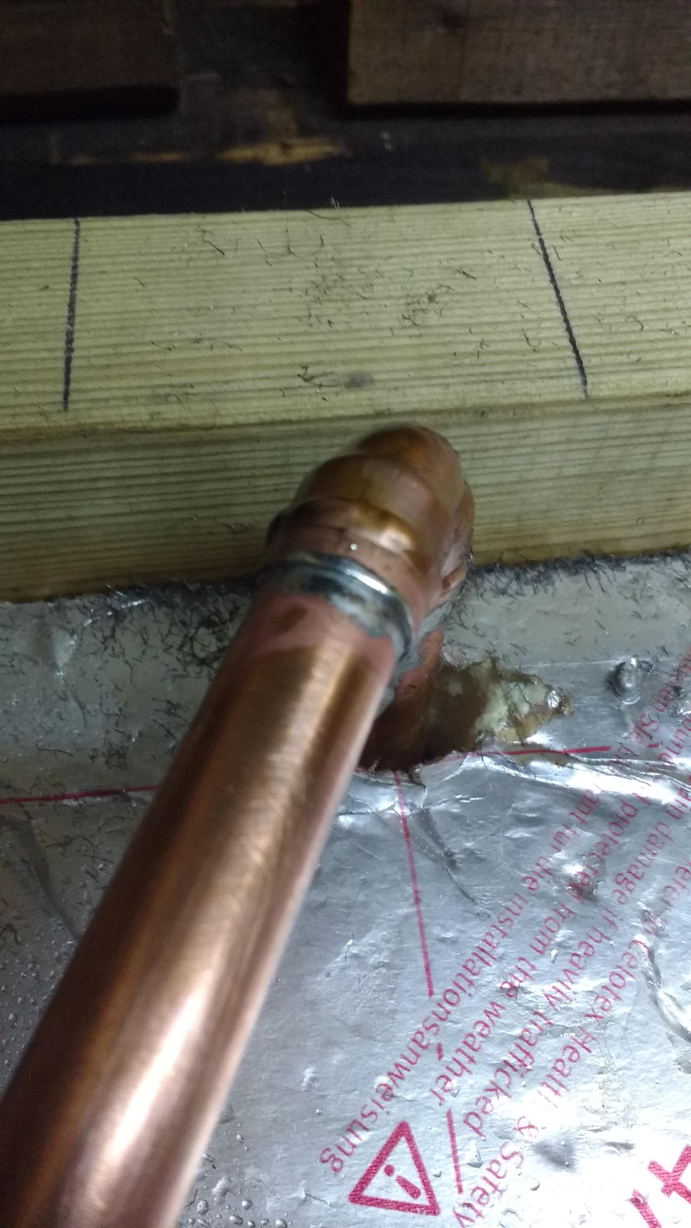

Did the new ones and went over the "old" like you said. Propane/lead free/Templars:
:ph34r:
  • Like 2
Posted (edited)
30 minutes ago, Nickfromwales said:
Did you put that one through a lathe ? ?
Nah, good, innit? Beginners luck I reckon.
Just got to sort the en suite shower when the new bar mounting kit comes, hopefully tomorrow and I can test all 25 soldered & 5 + compression joints.

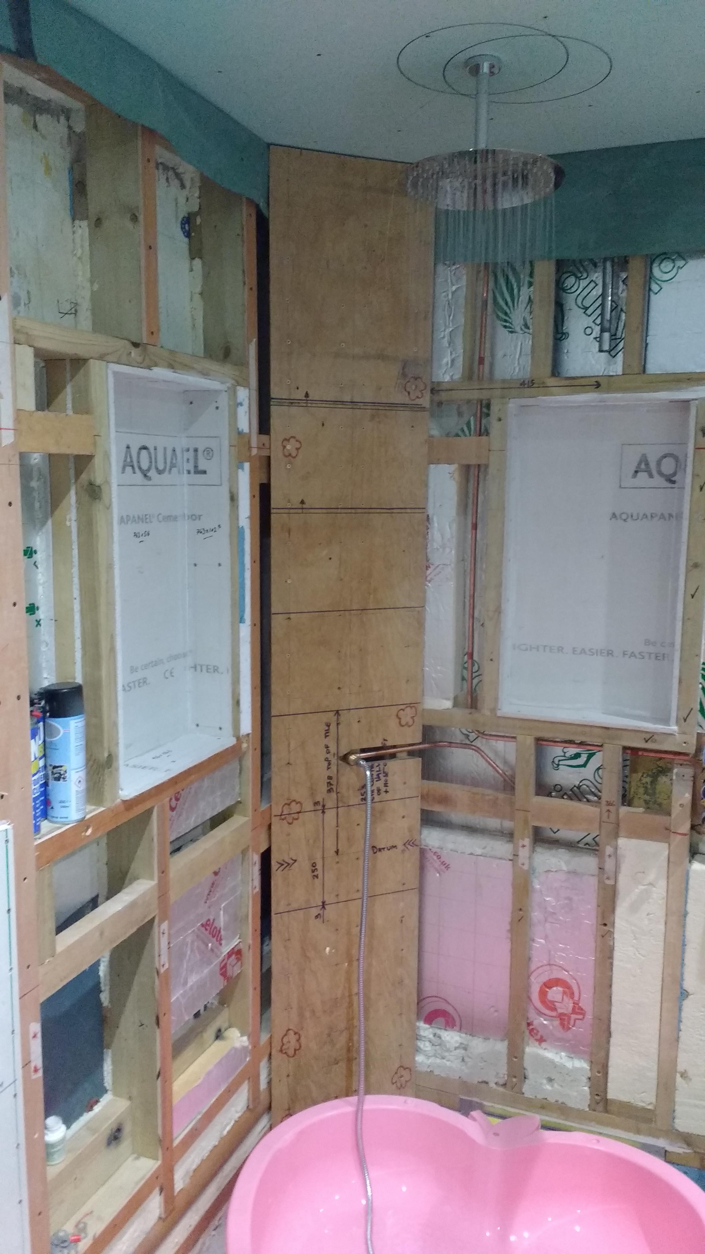

En suite shower back up and running, 14 soldered and 10 compression joints holding steady!
Going to drag an old paddling pool into the bathroom to test the rainfall head which should prove the soldered joints I was worried about! :)
