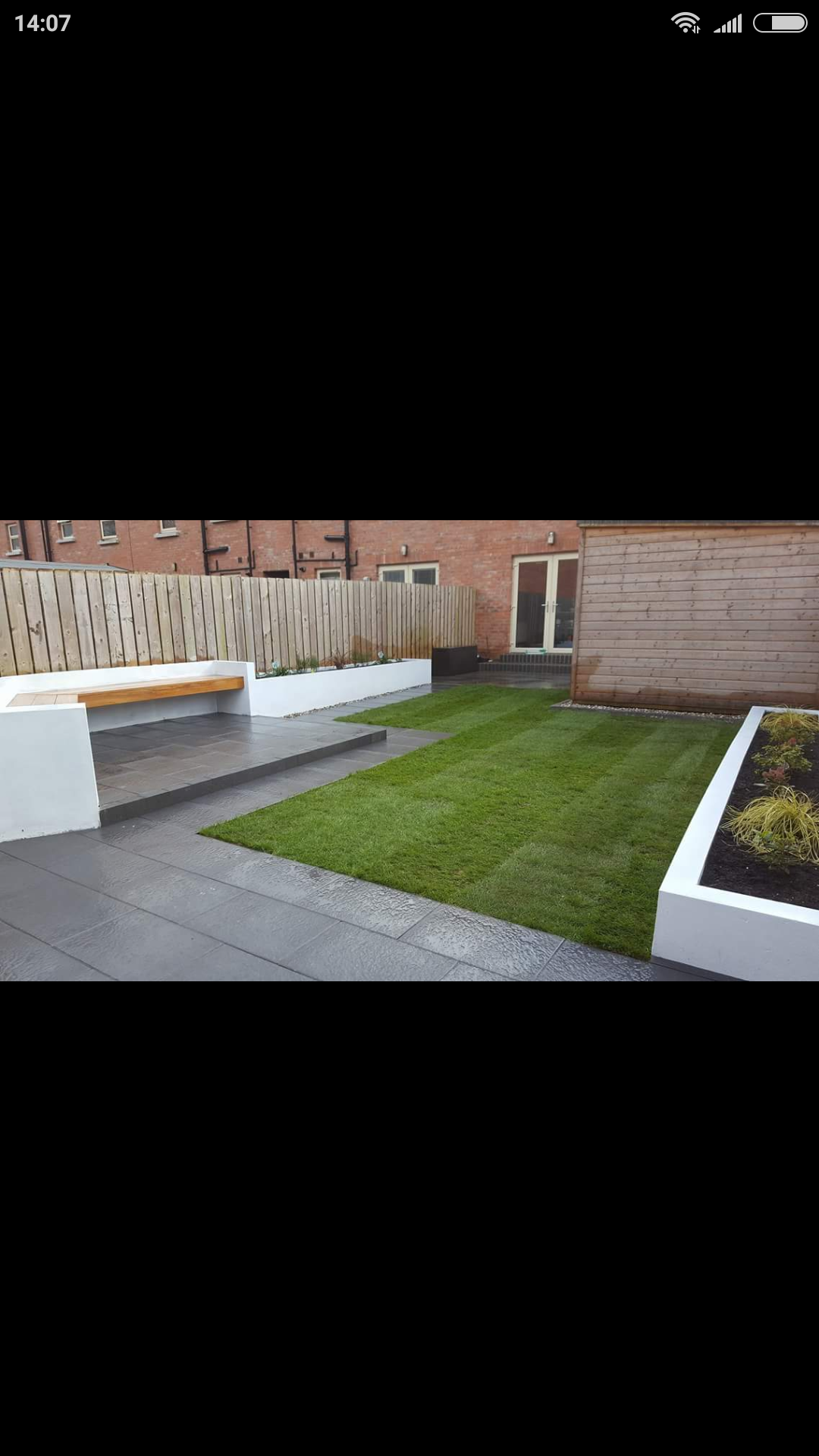

Declan52 Posted May 26, 2018 Posted May 26, 2018 So looking to do something like in the pic below but not sure which would be my best option. A: build in in block and get it plastered up. East enough to do but long term how will the nice crisp edges look in a few years. B: shutter it with some mesh in it. Bit more time consuming to get perfect but should be much harder to chip at the corners. ? Is there any other way to do this type of thing that I don't know about.

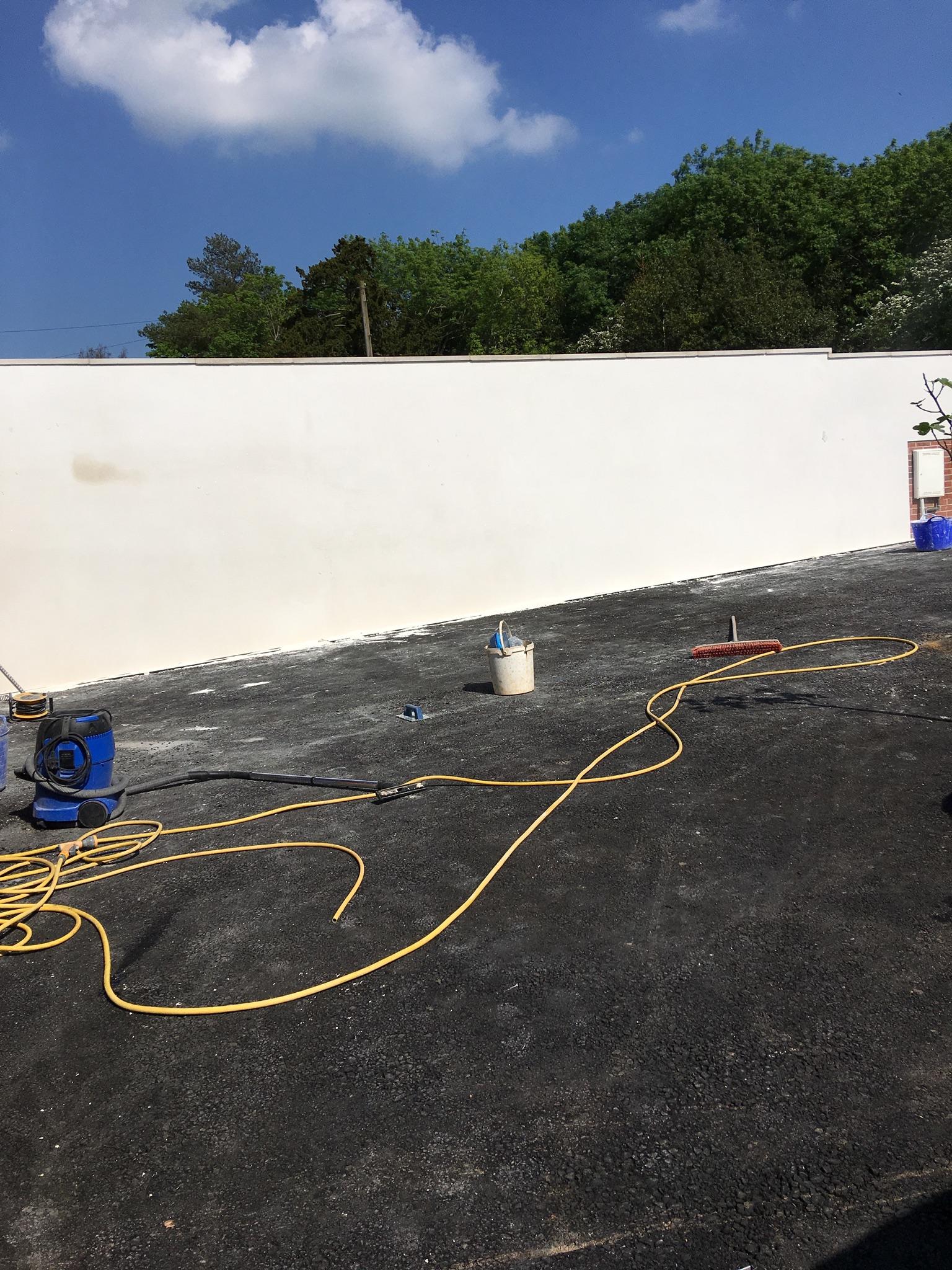

Trw144 Posted May 26, 2018 Posted May 26, 2018 I ve always wondered how wel a white plaster/render wall would last in the UK weather. The biggest issue is water on top without some sort of coping
Ferdinand Posted May 26, 2018 Posted May 26, 2018 (edited) Use one of those Thin Film renders? Or Perhaps get shares in Sandtex I have seen rendered walls with pantile etc tops. Edited May 26, 2018 by Ferdinand
Declan52 Posted May 26, 2018 Author Posted May 26, 2018 15 minutes ago, Trw144 said: I ve always wondered how wel a white plaster/render wall would last in the UK weather. The biggest issue is water on top without some sort of coping That's my biggest concern. It won't look right with copings on either.
Ferdinand Posted May 26, 2018 Posted May 26, 2018 (edited) Can you render the copings, or use distinctive materials such as coloured half moon engineering or glazed bricks, or something that looks sharper such as slate slabs or porcelain tiles? Edited May 26, 2018 by Ferdinand
Declan52 Posted May 26, 2018 Author Posted May 26, 2018 Could maybe plaster the sides and make up a mould type thing and use concrete for this.
ProDave Posted May 26, 2018 Posted May 26, 2018 Up here rendered garden wall don't do well before frost gets in and the render bursts and falls off. House walls never seem to suffer like this I assume because they never get so cold, and have a proper DPC to stop it getting damp behind the render (which I am sure many garden walls do not) I would build it in blocks, point it well, and paint it.

nod Posted May 27, 2018 Posted May 27, 2018 19 hours ago, Declan52 said: So looking to do something like in the pic below but not sure which would be my best option. A: build in in block and get it plastered up. East enough to do but long term how will the nice crisp edges look in a few years. B: shutter it with some mesh in it. Bit more time consuming to get perfect but should be much harder to chip at the corners. ? Is there any other way to do this type of thing that I don't know about. I get asked for quite a lot of this kind of render now The golden rule was never to render to the floor as it would act like a sponge I’ve got over this by base coating and wrapping the whole wall with a fibre mesh and top coat with K rend The wet on the top doesn’t seem to bother the render You can continually jet wash the render without it doing any harm If it was to stain in a few years It’s not a big job to roller a K rend colour enhancer on Its a nice look and can see why you like it
Declan52 Posted May 27, 2018 Author Posted May 27, 2018 If I went for render I would have put a stop bead at the bottom and covered it with some decorative stone. You reckon k rend a better option than silver sand and white cement.

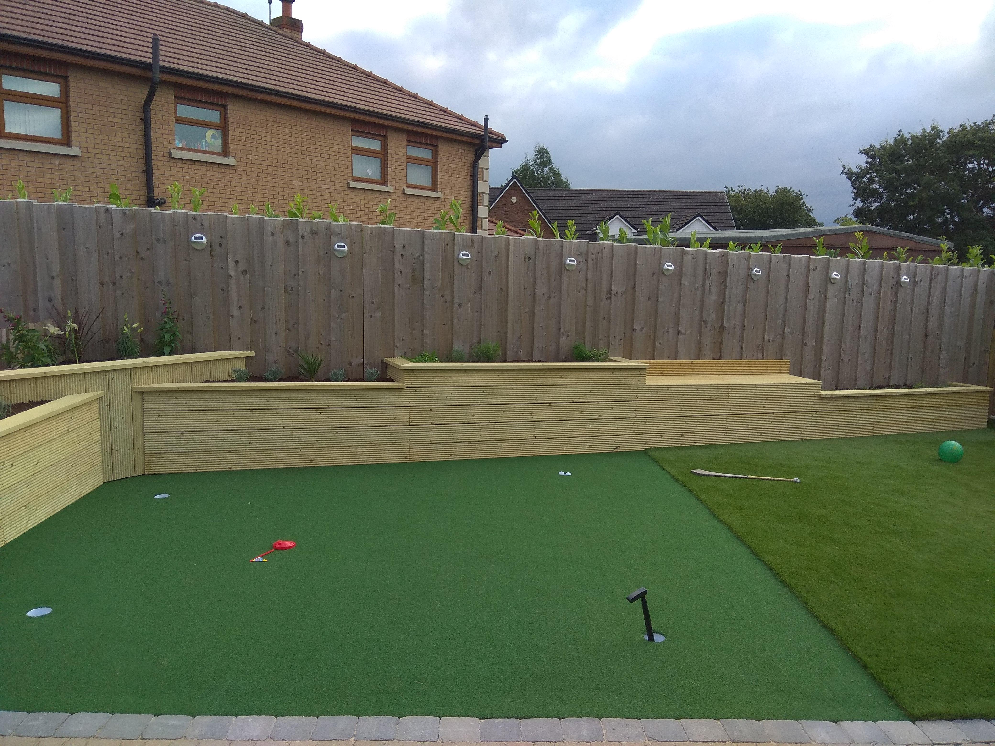

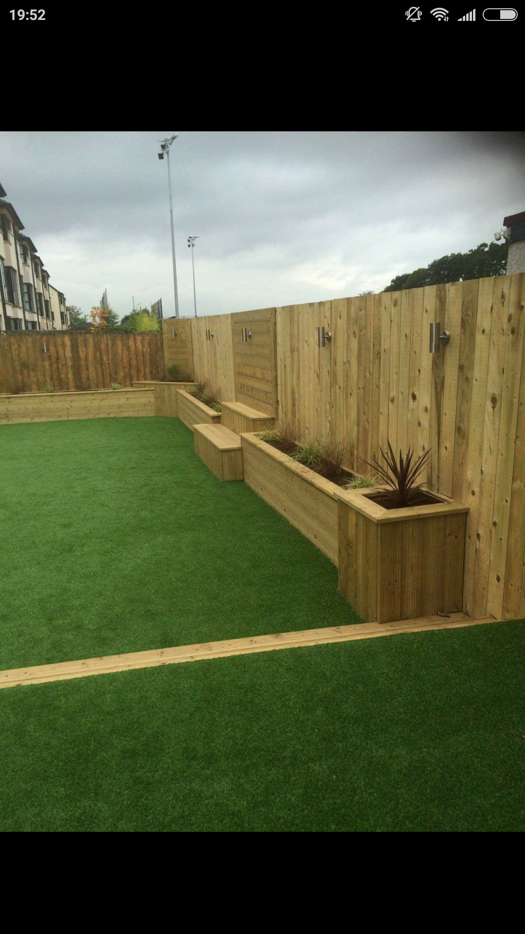

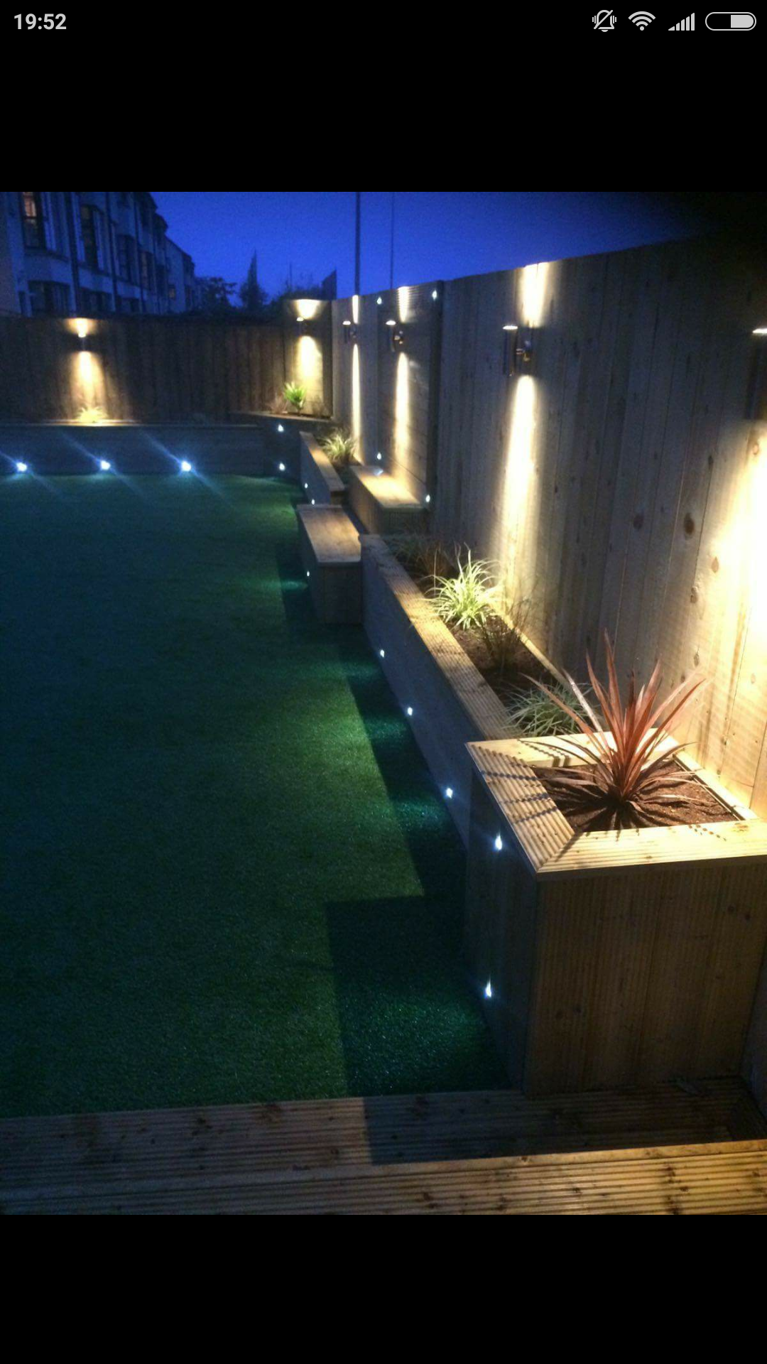

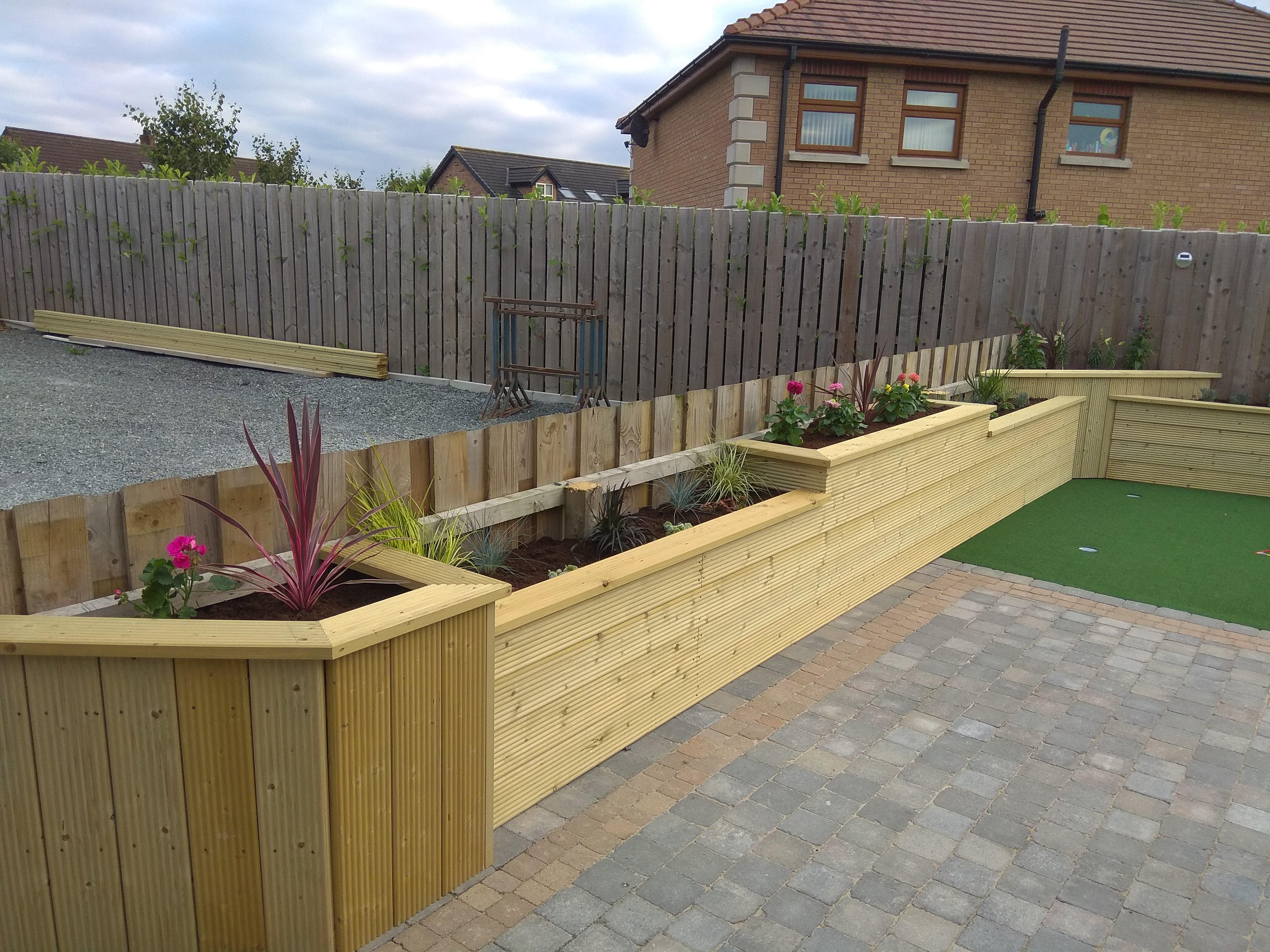

Declan52 Posted May 28, 2018 Author Posted May 28, 2018 Have found another option using timber. In the pics below they have used decking boards and while it looks decent it's not really what I am looking. So I could replace the decking boards with a cladding type board that some of you have used. In terms of hardwood what would be the best option here. I like the look of iroko. Any other types of hardwood that would be suitable.
Ferdinand Posted May 28, 2018 Posted May 28, 2018 (edited) Look at the woods used by coastal engineers. Though something like the plasticised wood cladding may be suitable. A huge amount depends on the deals you can make, as we all know. Hmm. Is there a sheet material that would be suitable? F Edited May 28, 2018 by Ferdinand

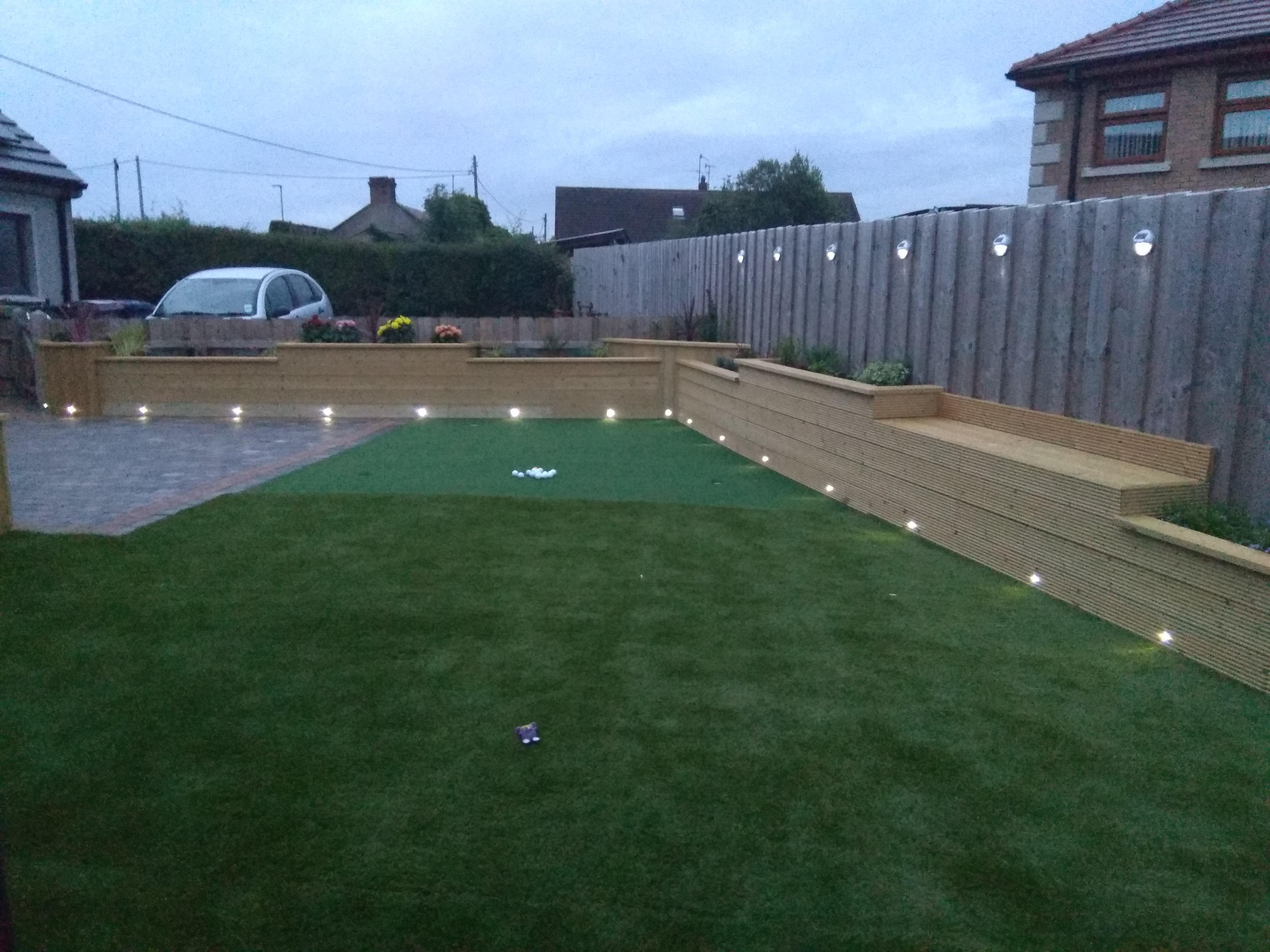

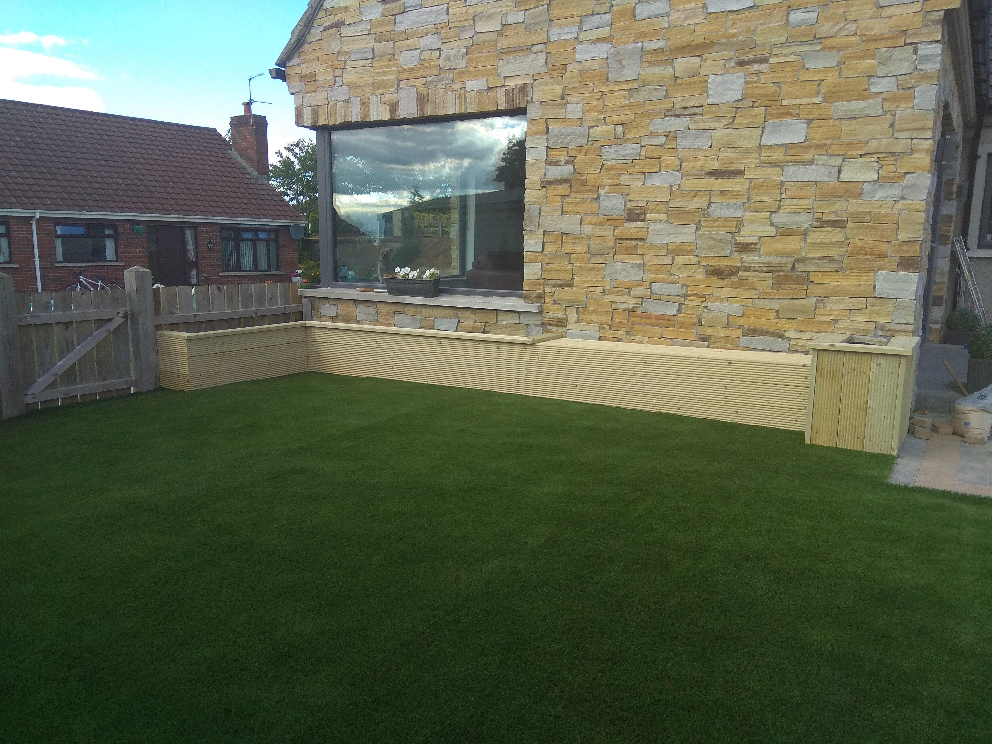

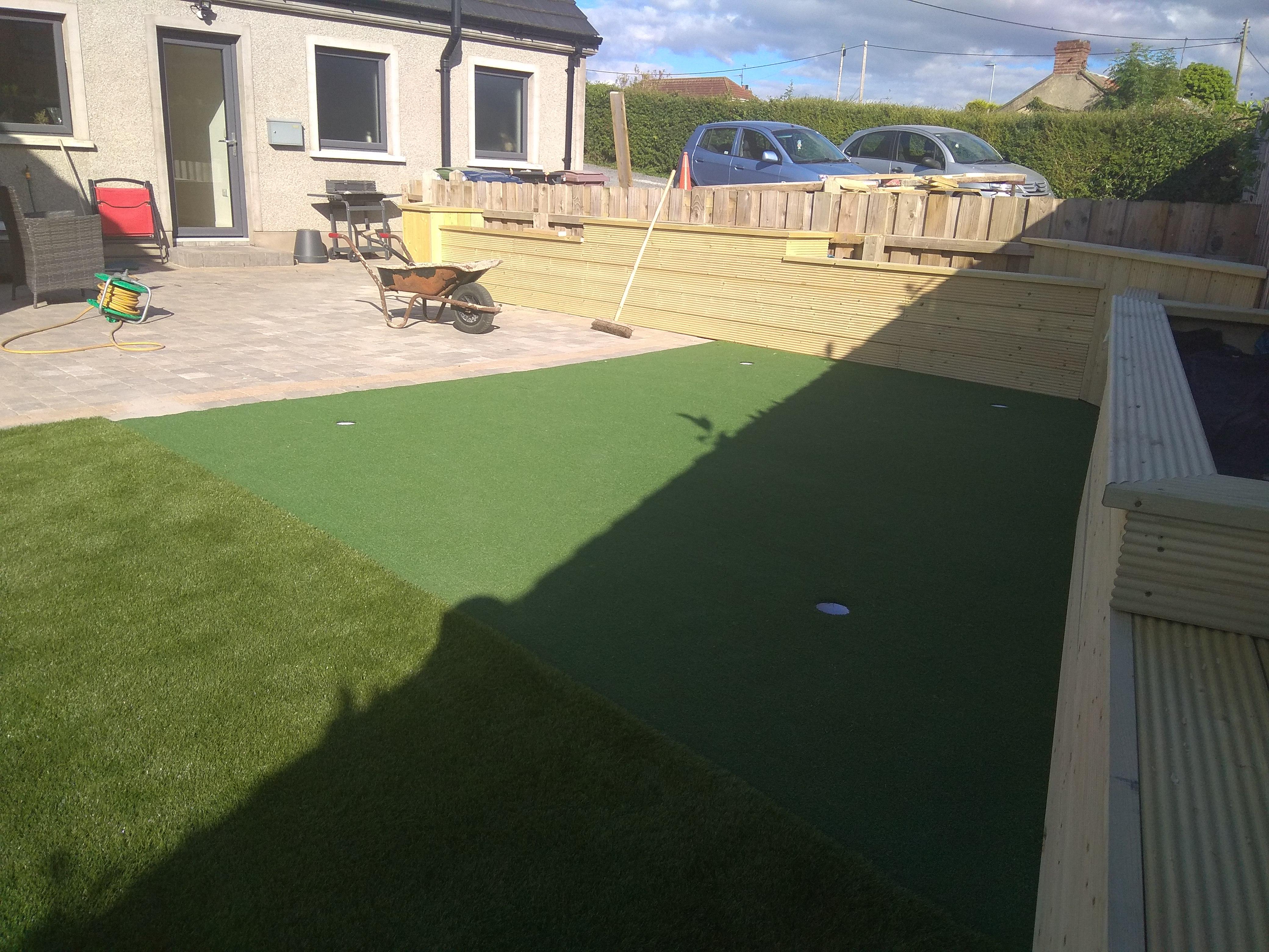

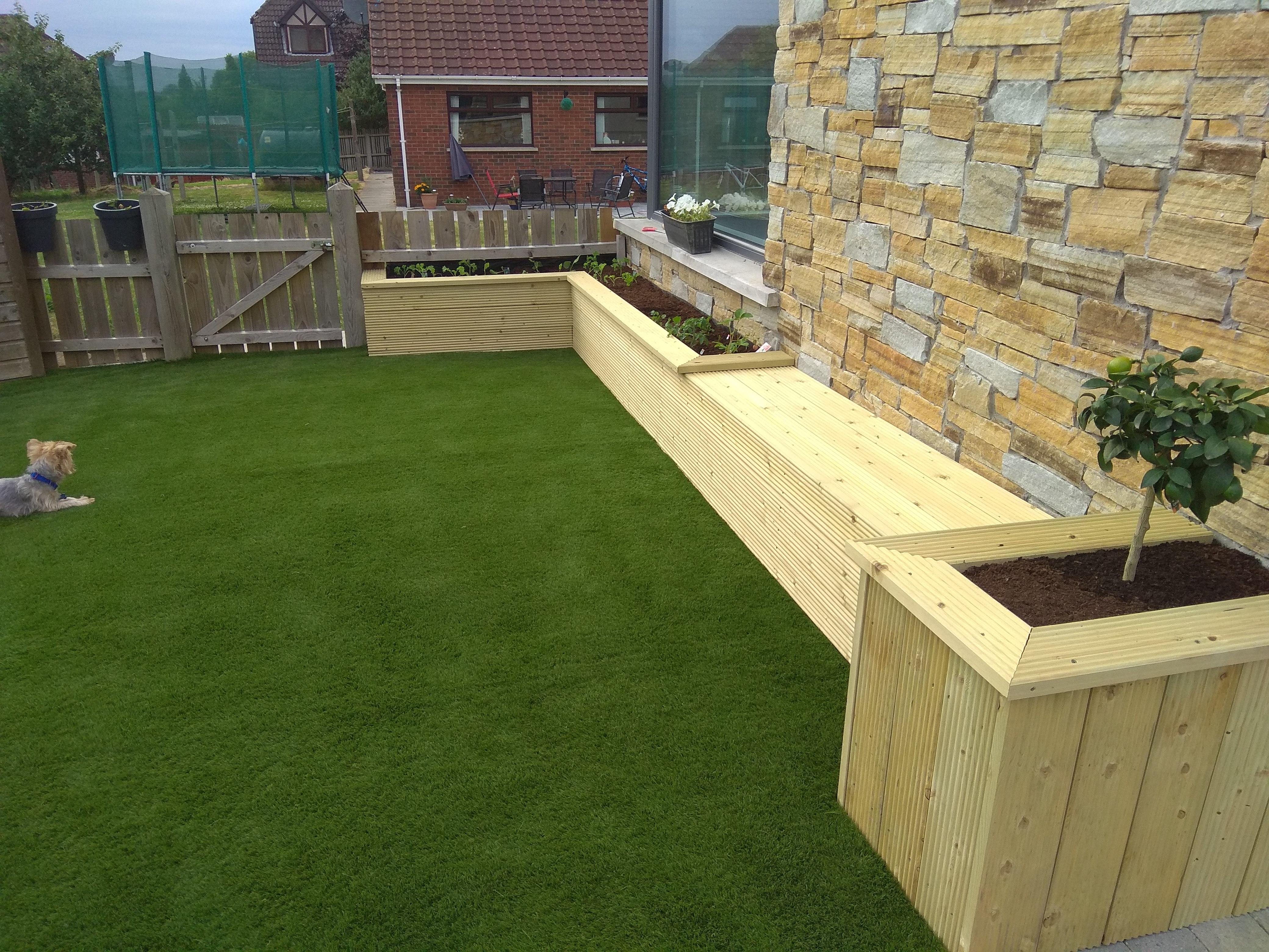

Declan52 Posted February 5, 2019 Author Posted February 5, 2019 Went with the decking type wall. Don't think the white wall look would last with my kids jumping over it and the frost. Its been in over 6 months and bar a few of the mitre corners opening up with the timber swelling and contracting it has been no need for any maintenance. I done it during the hot summer so the wood was always going to move about so come this summer if I think it needs it I might redo a corner if I could be arsed!!! I have it divided up so some sections are flowers and others are herbs and have another bit where there are lettuce, cabbage, tomatoes, chili's and garlic are planted. 1 1

newhome Posted February 5, 2019 Posted February 5, 2019 Looks fab! Yorkshire Terrier on the astroturf?
Declan52 Posted February 5, 2019 Author Posted February 5, 2019 11 minutes ago, newhome said: Looks fab! Yorkshire Terrier on the astroturf? Yeah that is sparkles the miniature yorkie. 1
JohnW Posted February 5, 2019 Posted February 5, 2019 (edited) Thanks for the photos, looks great @Declan52...when are you free to come down to do mine ? P.S. Who golfs with a hurley stick? Edited February 5, 2019 by JohnW
Declan52 Posted February 5, 2019 Author Posted February 5, 2019 1 hour ago, JohnW said: Thanks for the photos, looks great @Declan52...when are you free to come down to do mine ? P.S. Who golfs with a hurley stick? We are multi talented here so can swing either stick. My wife would kill me if I do any more homers, my wrist and both elbows are done. 1
