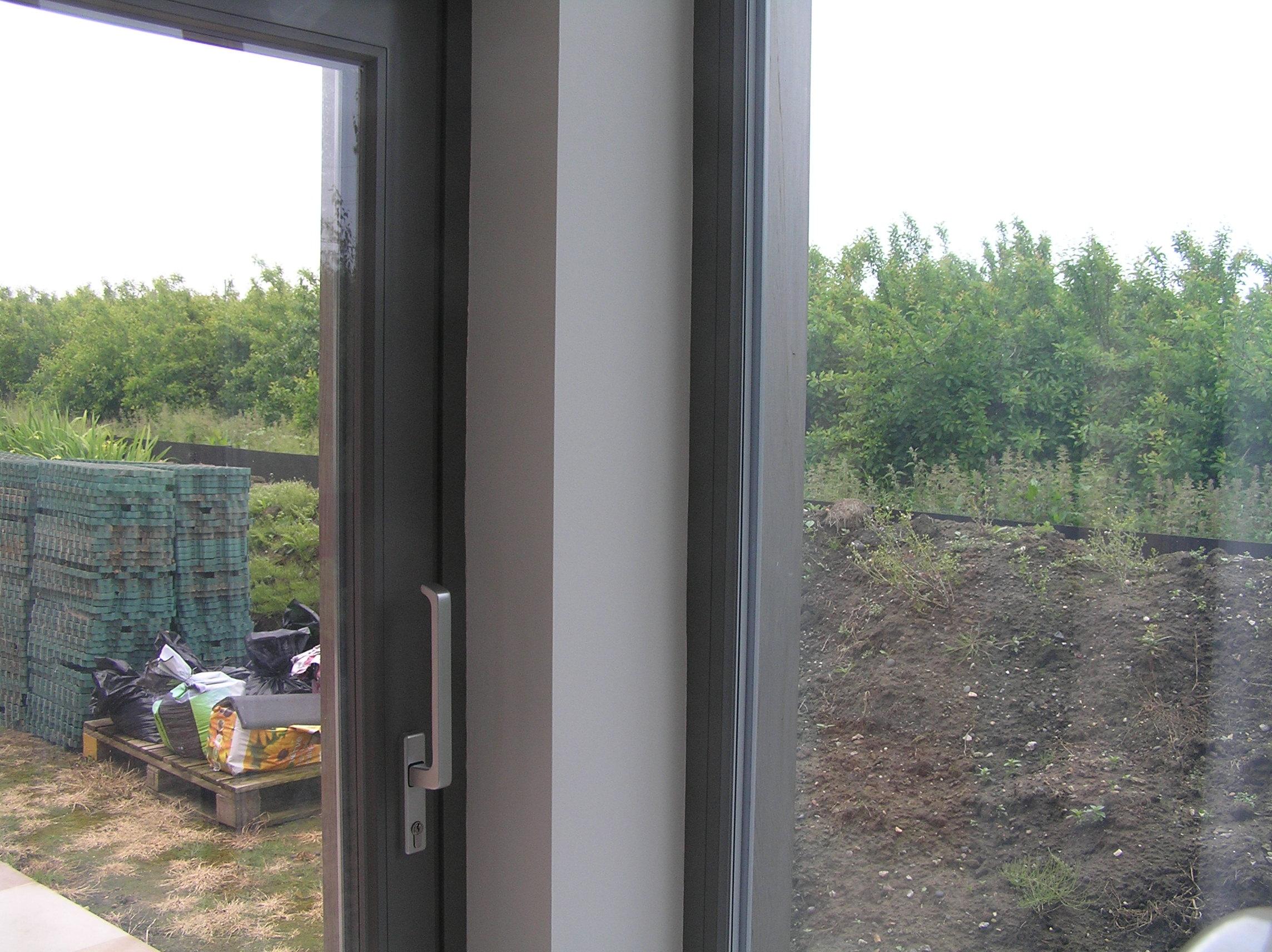

Ferdinand Posted June 2, 2018 Share Posted June 2, 2018 (edited) @lizzie there was a thread in early June 2006 where @JSHarris and @PeterStarck talked about this, including a sample test doe by Jeremy. The thread is linked below and these are the photos. You can see that the film is hotter. The patches are halfway up left and right. Read the thread for the commentary. F Edited June 2, 2018 by Ferdinand Link to comment Share on other sites More sharing options...

lizzie Posted June 2, 2018 Author Share Posted June 2, 2018 @Ferdinand I wont be taking up that quote for external blinds, its more than the Internorm windows cost! I am looking at other solutions for what is a real problem area. I found the old thread linked above and have read with interest, I also found a later one where Jeremy was thinking about replacing the glass with solar glass so from that I am presuming film only good as far as it goes...... Internal blinds are an issue to fit and look good on my big slider but in any event would only do part of the job, awnings I dont fancy and they would be difficult to fit and make look good, ditto on brise soleil. My areas are all South and South West facing so full sun. I guess I can always hope the British weather takes over and the hot sun is a rare visitor! Otherwise short term a few large garden umbrellas may do the trick!! Link to comment Share on other sites More sharing options...
