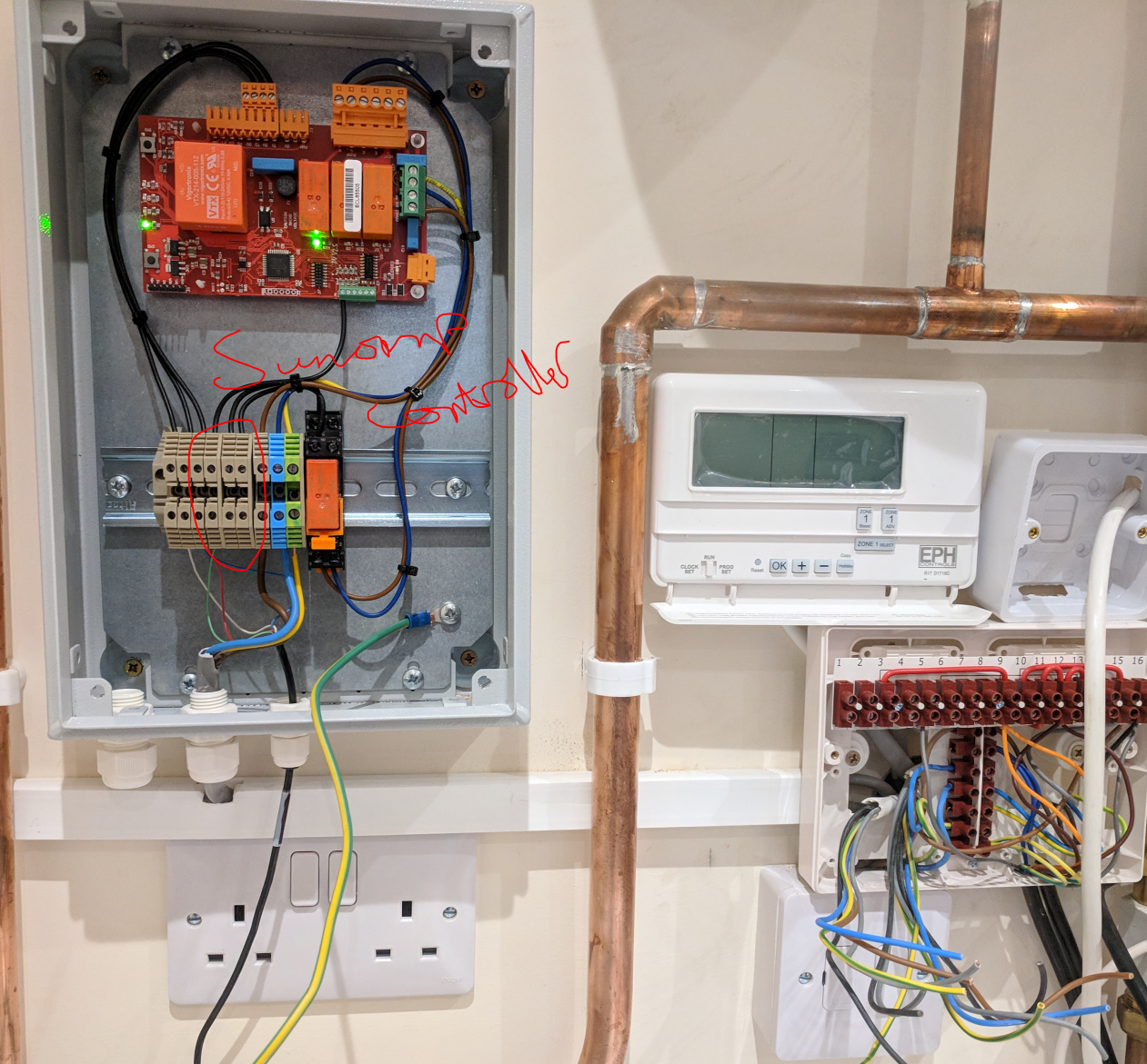

Ed Davies Posted October 14, 2018 Share Posted October 14, 2018 On 09/10/2018 at 11:45, readiescards said: Can the Sunamp A1-A2 connectors drive this ASHP directly? On 09/10/2018 at 15:08, Nickfromwales said: The 34 will get heated and then stop calling for heat Where does the PCM34 call for heat other than on the A1-A2 connectors (assuming it's not an electric one)? So readiescard's question is whether or not those connectors have an appropriate rating to drive the heat pump “directly”. Doesn't that depend on the details of the heat pump and what “directly” means rather than any discussion of the logic of the overall heating system? A 3 amp relay isn't going to sufficient to take the whole current of the heat pump but is probably suitable for other control inputs in some manner. Link to comment Share on other sites More sharing options...
Jeremy Harris Posted October 14, 2018 Share Posted October 14, 2018 8 minutes ago, Ed Davies said: Where does the PCM34 call for heat other than on the A1-A2 connectors (assuming it's not an electric one)? So readiescard's question is whether or not those connectors have an appropriate rating to drive the heat pump “directly”. Doesn't that depend on the details of the heat pump and what “directly” means rather than any discussion of the logic of the overall heating system? A 3 amp relay isn't going to sufficient to take the whole current of the heat pump but is probably suitable for other control inputs in some manner. I think you're right, the only call for heat is from the low current A1-A2 connections that control the 230 VAC power relay for the heater. Looking at the connections in our control box it looks very much as if one of the low power relays is used to switch 230 VAC to A1-A2, which in turn are connected to the coil of the larger DIN rail mounted power relay. There is room on the DIN rail to add another relay, so it would seem possible to add some form of ASHP control within the control box. The best arrangement may be to just make this a dry contact that closes when there is a call for heat, so that there's isolation between the power circuits within the Sunamp and the ASHP control system. Link to comment Share on other sites More sharing options...

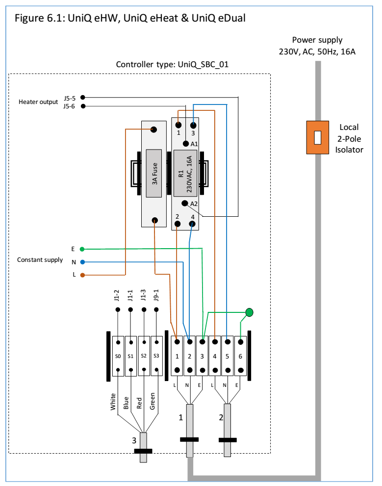

Ed Davies Posted October 14, 2018 Share Posted October 14, 2018 1 hour ago, JSHarris said: Looking at the connections in our control box it looks very much as if one of the low power relays is used to switch 230 VAC to A1-A2, which in turn are connected to the coil of the larger DIN rail mounted power relay. I think it's the other way round: looking at UniQ manual 180719.pdf Figure 6.2 it looks like the black thing with an orange plastic bit on the front on the DIN rail to the right of the connector blocks in readiescard's picture is relay R2. The low-power relay on the PCB controls the coil of R2 (via J5-1 and J5-2) and those wires going to the bottom of the relay (splitting off from the main loom by the “o” of “controller” in the red writing) which then provides dry contacts to A1 and A2 via the black wires out of its top (assuming there are two there, difficult to see in the picture). I.e., A1-A2 are connected to the contacts, not the coil, of the DIN-mounted relay. Agree, though, there's room in there to put a beefier 16 amp relay with its coil driven either by A1 and A2 (taking live and neutral from other connectors), or perhaps even directly from the J5-1 and J5-2 wires, but that it might be better to just use A1 and A2 to drive a separate relay closer to the ASHP if the dry contacts don't make sense as a direct control input for the heat pump (which I think they probably do). Link to comment Share on other sites More sharing options...
Jeremy Harris Posted October 14, 2018 Share Posted October 14, 2018 There's a difference between the two units, our's is as shown in diagram 6.1, with A1-A2 being the power relay coil: One thing I'm going to add to our system is a small box with a panel indicator light, to show when the unit is calling for heat, as at the moment there's no indication of the unit status at all. The old Sunamp PV had four LEDs on the side that showed its status, something I found useful. Link to comment Share on other sites More sharing options...

Ed Davies Posted October 14, 2018 Share Posted October 14, 2018 4 hours ago, JSHarris said: There's a difference between the two units, our's is as shown in diagram 6.1, with A1-A2 being the power relay coil: But readiescard's photo looks more like an SBC_03 controller (for the non-electric UniQs). It's only got one big non-connector DIN-mounted thingy, for starters. AIUI they have two Sunamps, a PCM34 and a PCM58, and this is for the PCM34 (doing UFH and DHW preheat off an ASHP). Are you sure you're not thinking of their other one? Also, take care as there are two A1-A2s in play here: the labels on the relays for the coils and the connectors on the DIN rails. I feel safe in assuming readiescard's original question referred to the connectors on the DIN rail because they put a great big red circle round them on the photo. Link to comment Share on other sites More sharing options...
Jeremy Harris Posted October 14, 2018 Share Posted October 14, 2018 10 minutes ago, Ed Davies said: But readiescard's photo looks more like an SBC_03 controller (for the non-electric UniQs). It's only got one big non-connector DIN-mounted thingy, for starters. AIUI they have two Sunamps, a PCM34 and a PCM58, and this is for the PCM34 (doing UFH and DHW preheat off an ASHP). Are you sure you're not thinking of their other one? Also, take care as there are two A1-A2s in play here: the labels on the relays for the coils and the connectors on the DIN rails. I feel safe in assuming readiescard's original question referred to the connectors on the DIN rail because they put a great big red circle round them on the photo. I did mention originally "Looking at the connections in our control box it looks very much as if one of the low power relays is used to switch 230 VAC to A1-A2, which in turn are connected to the coil of the larger DIN rail mounted power relay." I hadn't spotted that our controller was different internally. It's a coincidence that I'd just been looking inside our controller with a view to adding an indicator, driven from the A1 and A2 terminals. Given that the standard way of marking DIN mount relays is to label the coil as A1 and A2, I'm not sure that using the same terms to describe the dry contacts on the SBC_03 controller is that good an idea - it certainly managed to cause me to be confused! Link to comment Share on other sites More sharing options...
Ed Davies Posted October 14, 2018 Share Posted October 14, 2018 10 minutes ago, JSHarris said: Given that the standard way of marking DIN mount relays is to label the coil as A1 and A2, I'm not sure that using the same terms to describe the dry contacts on the SBC_03 controller is that good an idea - it certainly managed to cause me to be confused! Yep, not ideal. Maybe it evolved from a design which didn't have the relay in the box so the A1-A2 connectors would have gone to the A1-A2 coil inputs on an external relay. Link to comment Share on other sites More sharing options...

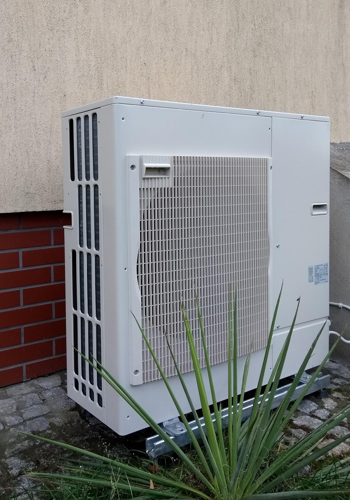

readiescards Posted November 2, 2018 Author Share Posted November 2, 2018 11 hours ago, PeterW said: Photos would be good !! With pleasure ? 1 Link to comment Share on other sites More sharing options...
ProDave Posted November 2, 2018 Share Posted November 2, 2018 Not wishing to be picky, but isn't that a little close to the wall? 1 Link to comment Share on other sites More sharing options...

testom Posted November 3, 2018 Share Posted November 3, 2018 11 hours ago, Gav_P said: Any photos of the rest of the system or your customer controller? ? Hi, pictures above were added by other happy users of PUHZ-W90. Nothing to do with my install and my "customised" contoroller. 1 Link to comment Share on other sites More sharing options...

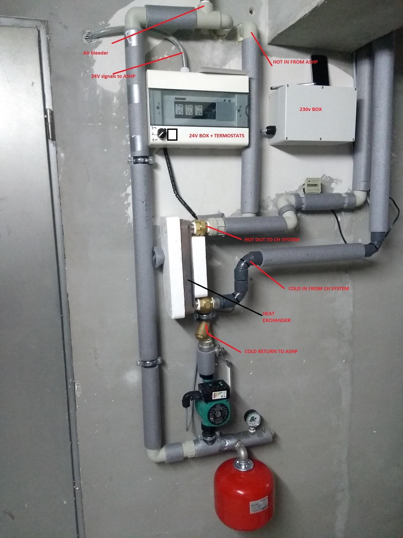

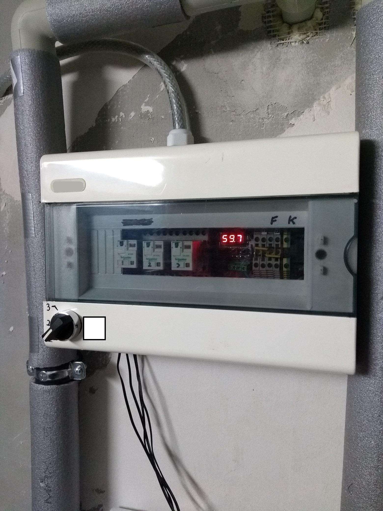

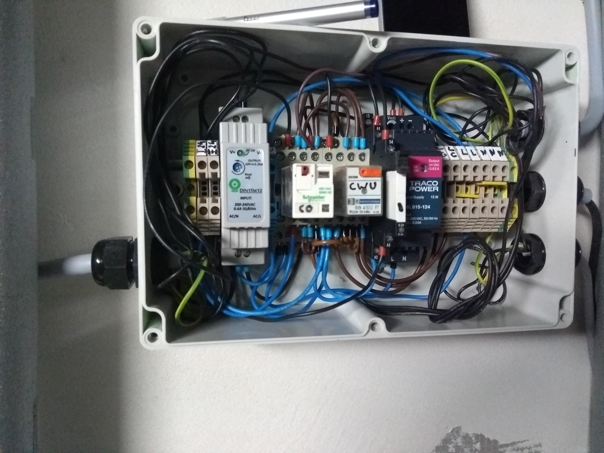

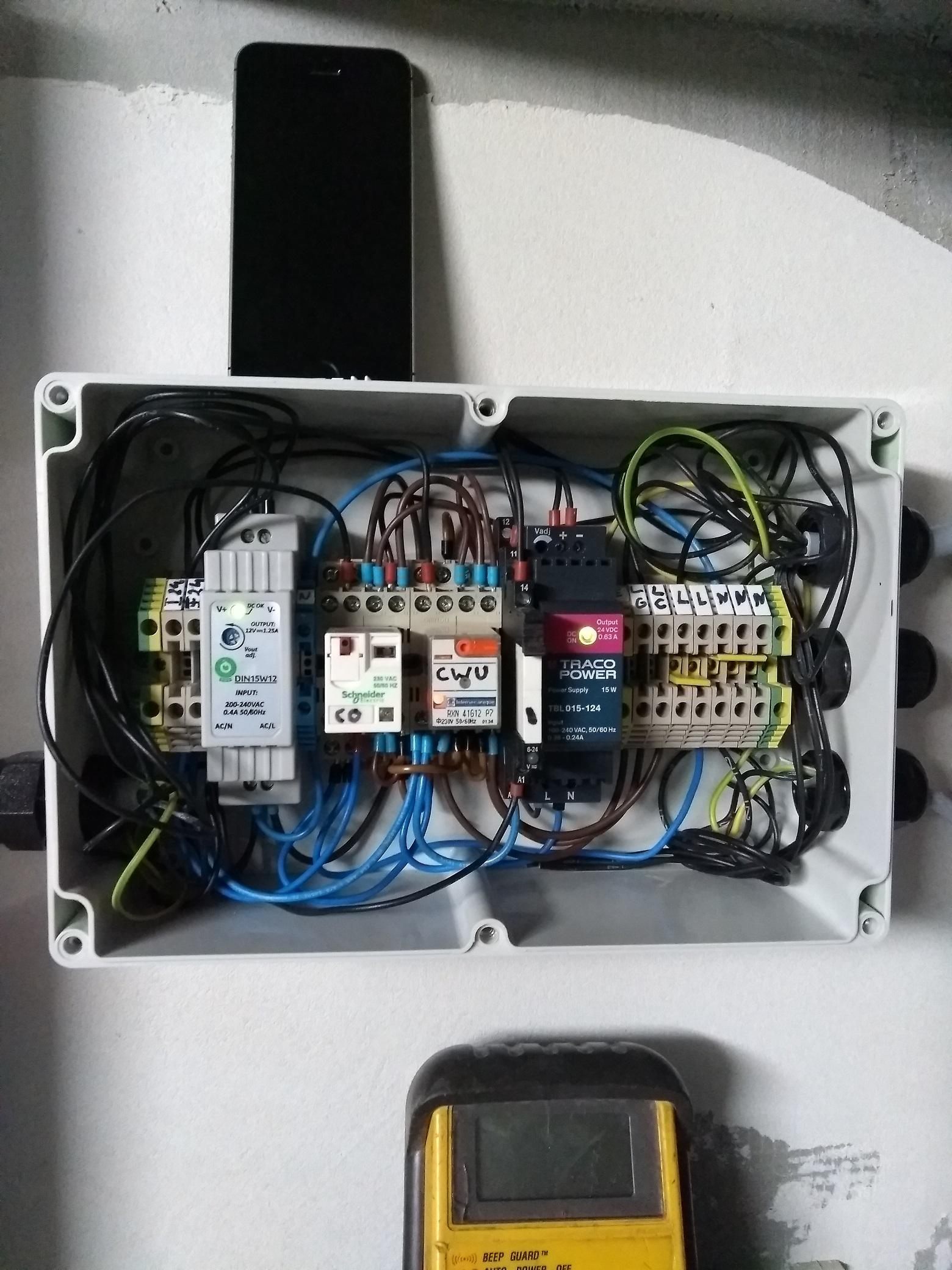

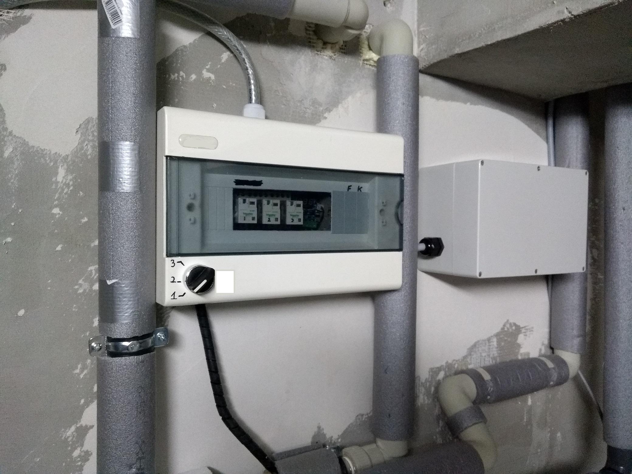

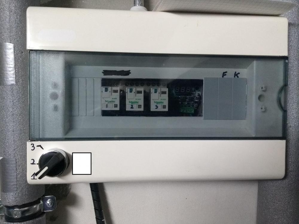

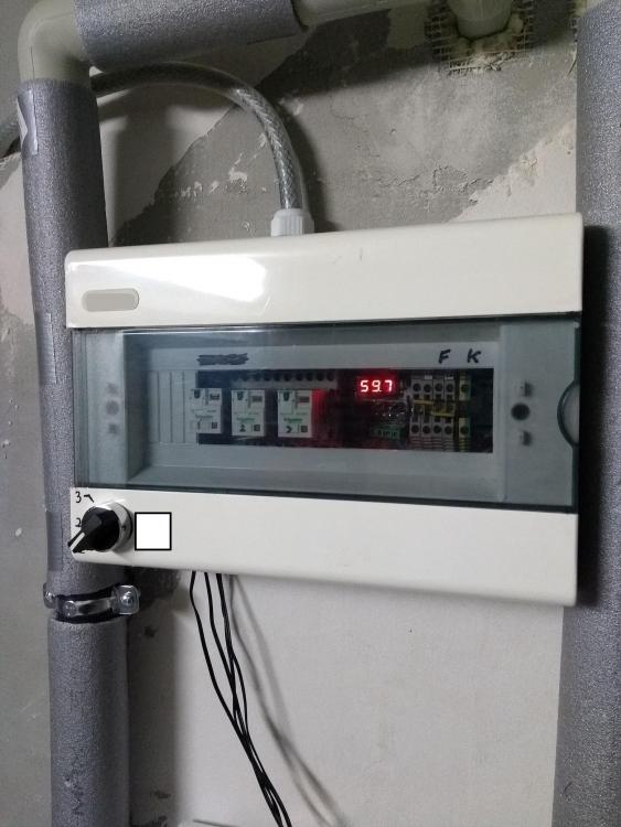

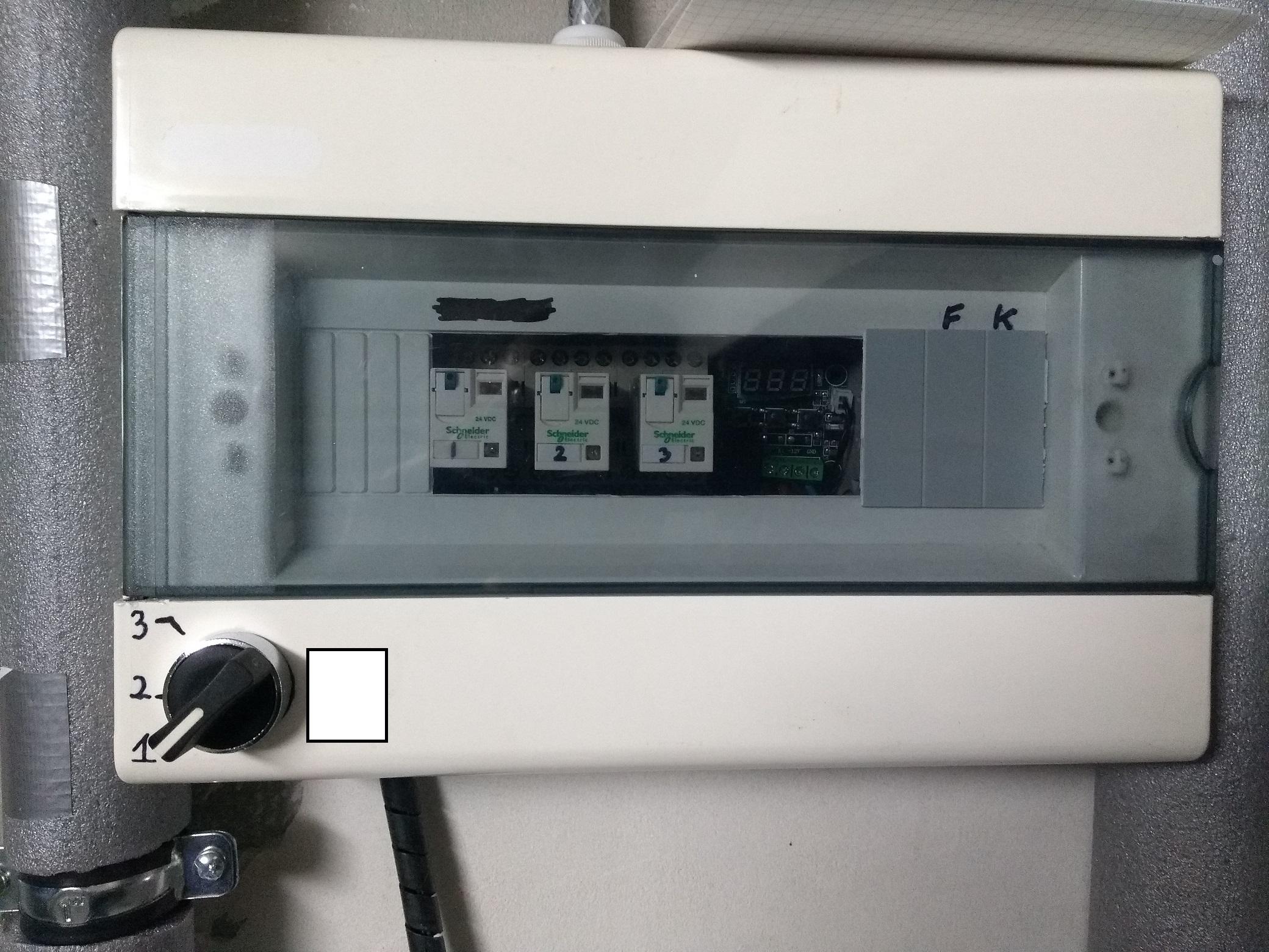

testom Posted November 3, 2018 Share Posted November 3, 2018 (edited) Now I will add few pics. Quick explanation to all - I am not based in UK or even in EU. I live in the middle of nowhere and Install is done with all possible materials I could possibly get on the market. It is done in resonable way and its safe for me for my domestic purpose. This is 1K£ project and I have sticked to the budget. There is one more connection box on the other side of the wall in my basement to which all this pictured is connected. I also heve there small knob and relays to switch between ASHP and oil boiler. At picutre no. 3 there you can see small hour counter sitting on the pipe. I have done some calculation - how many hours a day (including HW preparation) unit works and what is the daily power consumption. And this is something that absolutelly brings the smile on my face. - reading from the 2/11/2018 - 18,7kWh used, total run for 24h - 9,5h. 18.7/9.5 = 1.97kW 2kW to keep 22.5 degree of C at entire house! That is less than my kettle! Regards Edited November 4, 2018 by testom calculation added to the comment 3 Link to comment Share on other sites More sharing options...
testom Posted November 3, 2018 Share Posted November 3, 2018 (edited) On 02/11/2018 at 09:24, ProDave said: Not wishing to be picky, but isn't that a little close to the wall? I have checked the distance from the wall 34cm at my place Edited November 3, 2018 by testom 1 Link to comment Share on other sites More sharing options...

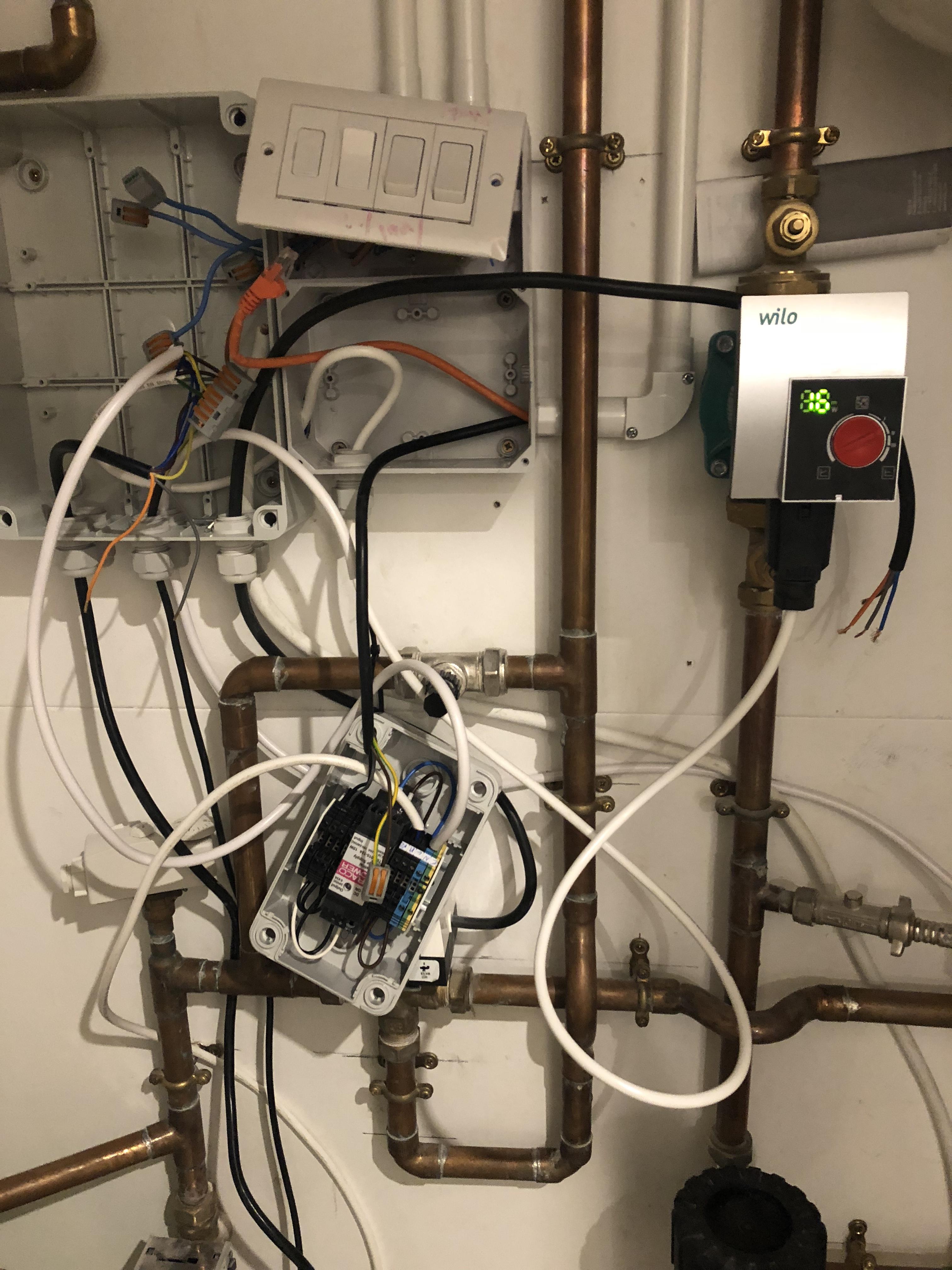

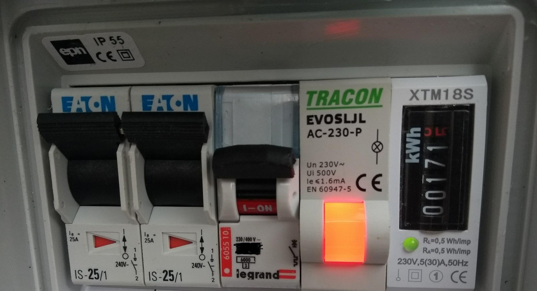

PeterW Posted November 20, 2018 Share Posted November 20, 2018 So.... Quick bit of jerry rigging of the controller last night after getting the 2nd fix radials completed and..... it fired up first time !!! I've left it on 65% load, and just got it chugging 27c water into the slab now for the next few days - it is a 9kw output at 7/35 so currently it is drawing around 5.2A - my fag packet calcs say that is around 1.3kW which would give a CoP of near on 4 so I'm quite happy ! This lot now needs to be cleaned up and the timers put in properly ! 2 Link to comment Share on other sites More sharing options...
Simplysimon Posted November 20, 2018 Share Posted November 20, 2018 come on @PeterW, trying to promote best practise on this forum, HSE will be visiting you when posting photos like that! 2 Link to comment Share on other sites More sharing options...
PeterW Posted November 20, 2018 Share Posted November 20, 2018 2 minutes ago, Simplysimon said: come on @PeterW, trying to promote best practise on this forum, HSE will be visiting you when posting photos like that! It was temporarily connected for the purposes of testing ..!! Didn’t have chance to take a photo of the finished installation as it was late ... 1 Link to comment Share on other sites More sharing options...
