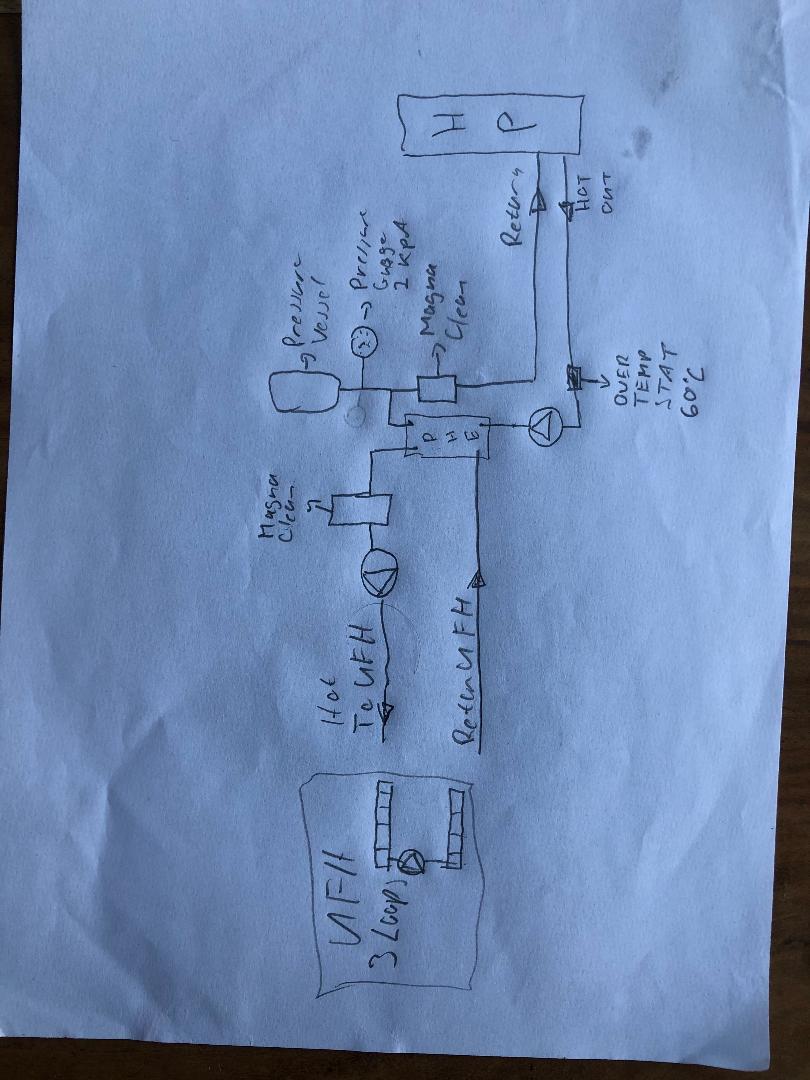

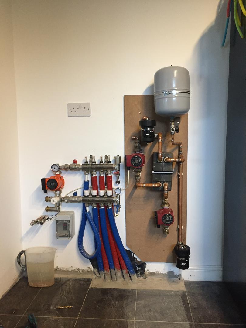

PTUK Posted December 5, 2020 Share Posted December 5, 2020 Hello Guys After a bit of help please. Error U1 Our DIY installed (with tanks to all the knowledge and help from this forum) IVT ran perfectly last winter. It warmed UFH up every night for 7 hours during economy 7 times without any issues (we had a mild winter in Lincolnshire). Switched it off in the spring and left it off until this November (was this my mistake?) This winter we've had several U1 Errors - High-pressure switch 63H activated. according to the Ecodan PUHZ-W85VHA2 manual it could be several things. I've check it during the day and it runs all day without issue, which should rule out items 1 - 10. It seems to only stop at night, maybe when its very cold? Stops very randomly. I checked the H63 switch it is closed in normal condition I can't activate it to check if it opens when pressure is above 4.15 MPa every time I have a day off I run it all day and it doesn't error. Below is the list of possible causes according to the manual with a comment. Any help very much appreciated. 1 Decreased water flow - circulating pump was set on 1 last year tried 2 and 3 this year, currently on 3 2 Clogged filter of water pipe - Unlikely it works when running during the day 3 Dirt of plate heat exchanger - Unlikely it works when running during the day 4 Locked water pump - Unlikely it works when running during the day 5 Malfunction of water pump - Unlikely it works when running during the day 6 Clogged or broken pipe - Unlikely it works when running during the day 7 Locked outdoor fan motor - I hear the fan running 8 Malfunction of outdoor fan motor - I hear the fan running 9 Short cycle of outdoor unit - Unlikely we run it 7 hours at a time 10 Dirt of outdoor heat exchanger - It is clean around and inside 11 Decreased airflow caused by defective inspection of outside temperature thermistor (It detects lower temperature than actual temperature.) - Clean but could be intermittently defective? 12 Disconnection or contact failure of connector (63H) on outdoor controller board - Checked the board, cable and plugs looks like new 13 Disconnection or contact failure of 63H connection - Checked cable and switch tested shows short when in normal condition could be intermittently defective? 14 Defective outdoor controller board - Looks like new could be intermittently defective? 15 Defective operation of linear expansion valve - I have no idea 16 Malfunction of fan driving circuit - Seems ok fan speeds up and slows down sounds normal Thanks Pieter 1 Link to comment Share on other sites More sharing options...
PTUK Posted December 5, 2020 Share Posted December 5, 2020 Hi guys Update, today the error U1 is coming on frequently. I bridged the U1 connector on the board to keep the HP running while testing the 63H switch. I monitored H63 with the ohm meter and the 63H switch does go open circuit which will cause U1 error. If I turn the demand for heat off the H63 goes back to short circuit quickly within a minute. Now the real questions. Does it really build up too much pressure causing the H63 to activate and if so why? Or is the switch activating too soon? Thanks Pieter Link to comment Share on other sites More sharing options...
ProDave Posted December 5, 2020 Share Posted December 5, 2020 I had a high pressure fault when I comissioned a GSHP for someone and speaking to the manufacturer, he explained it as low water flow, not taking the heat away from the HP quick enough so certain parts inside get too hot and the pressure gets too high. You mentioned slowing down your pump speed, I would start by increasing that again. Link to comment Share on other sites More sharing options...
PTUK Posted December 5, 2020 Share Posted December 5, 2020 19 minutes ago, ProDave said: I had a high pressure fault when I comissioned a GSHP for someone and speaking to the manufacturer, he explained it as low water flow, not taking the heat away from the HP quick enough so certain parts inside get too hot and the pressure gets too high. You mentioned slowing down your pump speed, I would start by increasing that again. Thanks Dave Last year the pump ran at 1 all year no issues. This year because of the error U1 I tried different pump speeds currently running at 3 for the last couple of weeks. I definitely take enough heat out. Inconing temp @ 55'C returning temp @ 35'C I do believe it is overtemp in the HP but can't figure out what is causing it. Thanks Pieter Link to comment Share on other sites More sharing options...
joth Posted December 5, 2020 Share Posted December 5, 2020 4 hours ago, PTUK said: I definitely take enough heat out. Inconing temp @ 55'C returning temp @ 35'C Dumping temperature and dumping energy are not the same thing. If you slow the pump to a virtual standstill you'd expect the difference to be even larger. Conversely running the pump at warp speed, even a few °C decrease would equate to a much larger energy transfer. There's probably an analogy with packed cars in a traffic jam vs nearly empty cars on a motorway and which one delivers more people per hour to their destination. 1 Link to comment Share on other sites More sharing options...
