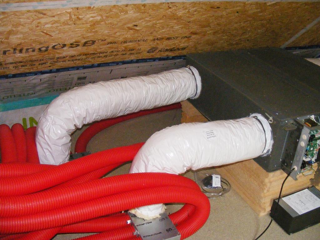

installing an mvhr really is simple, especially if using the radial ducting system from BPC.  It took me a weekend
It starts as 2 manifolds next to the mvhr
And 2 ducts in parallel run to each vent terminal
Posi joists do make it somewhat easier.
If you have quotes for £3K or more to install it, that will be your best "paid" weekends work ever.
