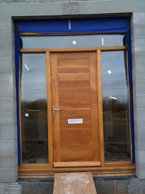

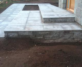

newhome Posted April 30, 2018 Posted April 30, 2018 Is this what you mean? This was mine going into the timber frame and quoins in front. It’s not quite finished In the second photo but we had to have a disabled ramp put there and the paving bridges the gap I think you’re meaning. Plus there is a very thin threshold drain between the paving and the door.
newhome Posted April 30, 2018 Posted April 30, 2018 (edited) Plus if it's the accessible entrance it has to be mega level - Borders Council is very hot on that. Edited April 30, 2018 by newhome
