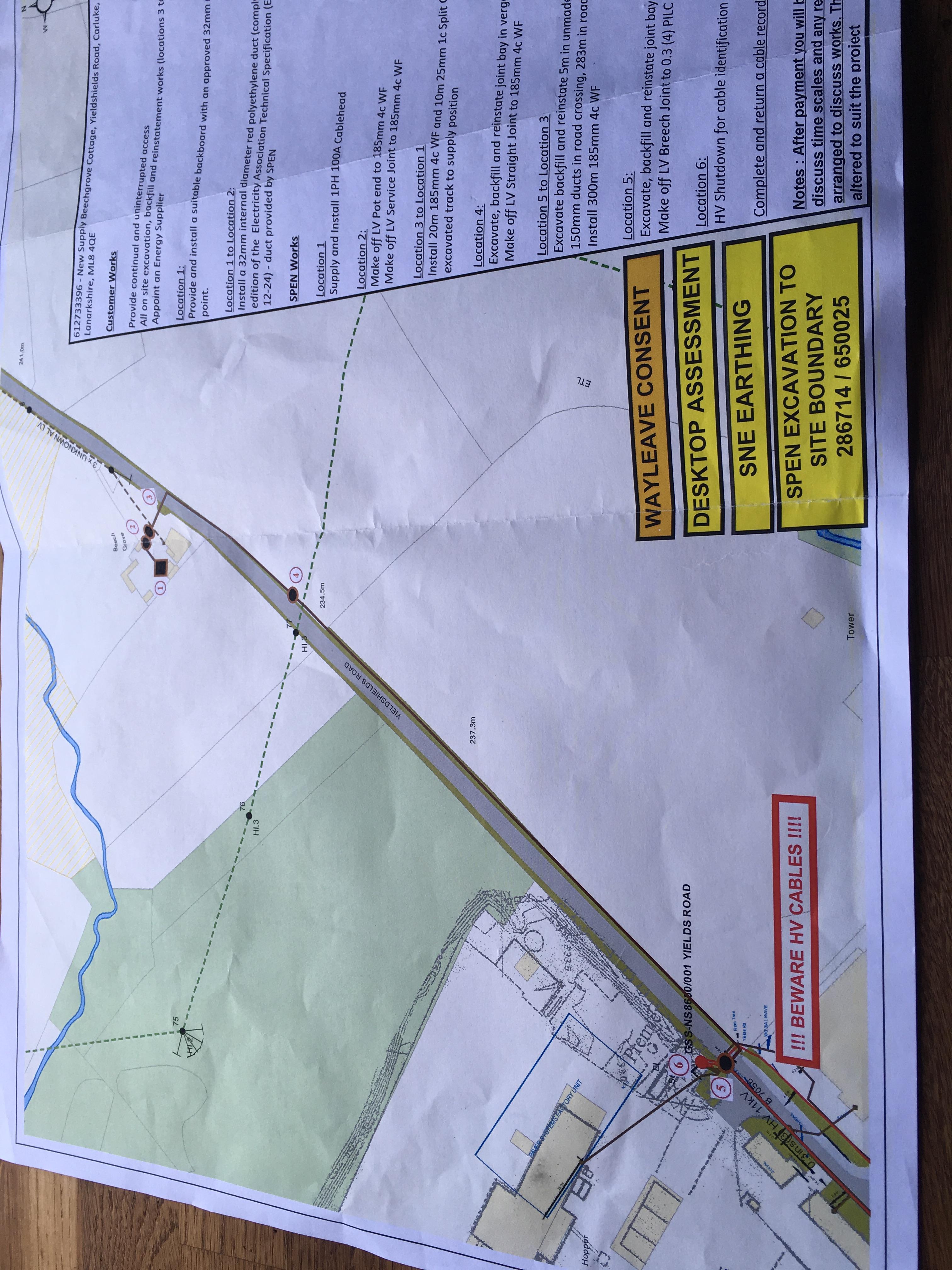

recoveringbuilder Posted April 27, 2018 Posted April 27, 2018 Starting a self build in the next few weeks and have just received my quote for electricity connection, take a seat before the reveal- £25000 , this is apparently because the pole situated in our ground has no capacity for us so they need to run a new line 283m from the substation, quite honestly we cannot afford this it’ll take an eighth of our build budget, any help gratefully received 1

ProDave Posted April 27, 2018 Posted April 27, 2018 Talk to them and see what they CAN supply from that pole. What KVA rating did you ask for? It's tempting to ask for 21KVA (100A) but you almost certainly do not need that. We were in a similar situation, adding an extra house to an existing 100KVA transformer. I just knew if I asked for 21KVA there would be a big cost for upgrading the transformer. So I sked for 12KVA and that could be accommodated from the existing transformer. Firstly 12KVA will be plenty for our house anyway, but the reality is we have the same cable and same 100A fuse as we would have if we had asked for 21KVA So go back and ask what capacity they could supply from the existing pole, and see if you can live with that. 1 2
recoveringbuilder Posted April 27, 2018 Author Posted April 27, 2018 We are in Scotland, they want it taken underground on the verge of the road,it’s a B road with grass verge, we know plenty of people capable of doing the machine work but they don’t have road works tickets, also I believe the 185mm 4 core cable required is very expensive , I’ve uploaded the plan they sent, depending on what time length you’re talking about we can go ahead with the build but need to find a way round this!

ProDave Posted April 27, 2018 Posted April 27, 2018 Anyone with a street works permit can do the trenching, but I found all the independent contractors were more expensive than the utilities. Depending on the road, even though they re only digging in the verge they may need traffic management as well. Before you go any further, where is your water and telecoms connections going to be? If they need the road or verge up, then don't be digging it up twice. In my case all 3 came from the other side of the road, so I had the road up only once, and Scottish Water were the cheapest of them all to make the road crossing. 1

recoveringbuilder Posted April 27, 2018 Author Posted April 27, 2018 We have looked at doing all the trench work ourselves but since it’s on the road side the chap we use with a digger thinks he may need a road work permit which he doesn’t have also we are under the impression we’d need to pay for the cable which seems to be over £50 a metre so still a lot of money for 283m!
ProDave Posted April 27, 2018 Posted April 27, 2018 The cheeky bit is they get you to pay for a 4 core cable, and use 2 cores. If someone then wants to build a house next door to you, then there would be "spare capacity" that you have paid for and they would get a cheap connection. Are there any other houses planned nearby? if so coordinate with them.

recoveringbuilder Posted April 27, 2018 Author Posted April 27, 2018 There are 5 plots currently being marketed next to us although no buyers yet, I have pointed this out to the energy company and that they could recoup their outlay further down the line as obviously 25k to them is a drop in the ocean whereas to us it will mean going without a lot of the stuff we’d planned but they won’t listen as they only have the application for power from us at the moment, they have said that should they get further applications we would be reimbursed some of the cost as long as it’s within 5 years!

recoveringbuilder Posted April 27, 2018 Author Posted April 27, 2018 I have now emailed them (as it’s almost impossible to get the right person on the phone) to ask if we would be able to have a reduced amp age , explaining that with the energy efficiency of the proposed house it’s unlikely we’d need the full whammy, I will await their reply once they get round to it, there’s one lesson I’ve already learned before we even start this project, nobody ever does what they say they’re going to do when they say they’re going to do it!
