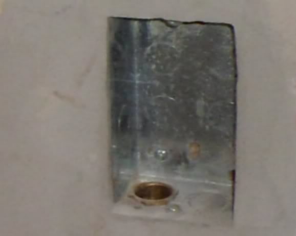

Onoff Posted April 14, 2018 Posted April 14, 2018 You should always try and future proof. I've put in 25mm galv conduit in the wall to my cooker. It's just got the 6mm T&E in there at the mo: 1
