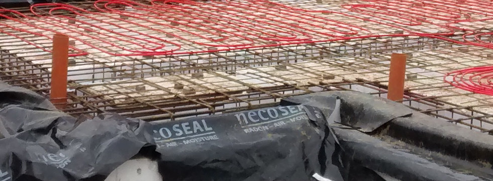

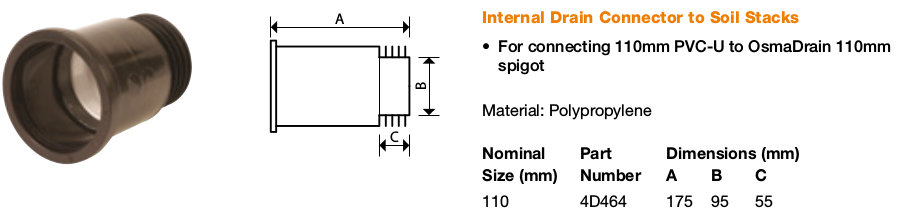

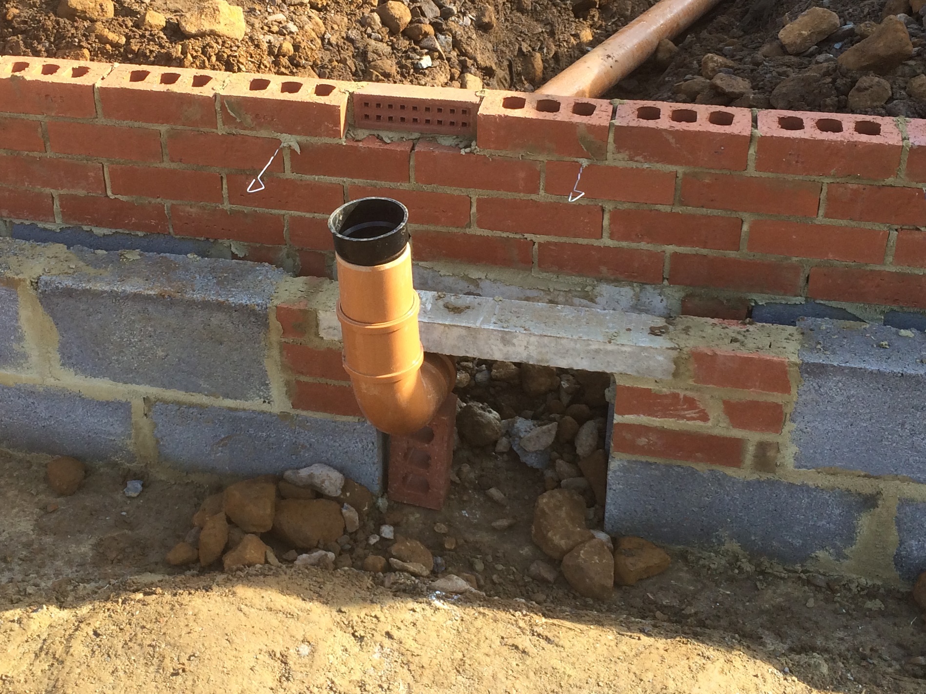

TerryE Posted June 29, 2016 Share Posted June 29, 2016 All of the underground fittings seem to show the underground 110mm terminating in a 110 push-fit female connector at ground level and you simply slot the bottom section of your soil stack into this. OK, I should have thought this one through when we did the slab but I didn't. What we did was to just use a piece of the straight generic 110 pipe that the slab crew provided which now comes out of the floor and which the guys seemed to view as standard practice. Our intent was and is to trim these to at or near slab level after the pour. See photo below. Osma do a female 110 push fit to male rubber sleeved insert as below, but the issue that we have is that our toilet connector from our toilet joins the stack at ~145mm above slab level so this is too tight. Can anyone recommend a lower profile M/F soil-underground connector or alternative approach? This can't be an uncommon problem. I really don't want to start to chip out concrete to recess one of these Link to comment Share on other sites More sharing options...
ProDave Posted June 29, 2016 Share Posted June 29, 2016 What's wrong with cutting the pipe about 50mm above ground and a standard double socket straight coupler, or in the case of the toilet a branch fitting? That fitting you show has a completelty different seal arangement, a bit more like that of a pan connector. Link to comment Share on other sites More sharing options...

Nickfromwales Posted June 29, 2016 Share Posted June 29, 2016 There should have been a double socket straight connector on the top of each upstand . In that, blank caps fitted to stop the concrete failing in, but most importantly to protect the fitting and its internal rubber seal. I'd not even consider using that fitting as I only ever use those for picking up from a clay soil pipe. The internal bore is too far reduced to be putting that at the START of the stack, sorry. Hire a 6" core drill, make a 6" hole in some 18mm ply as a guide, lay the ply on the floor and centralise it over the stack. Core drill down around 75mm and remove the spoil, then cut the soil just shy of the FFL and then attach said coupler. It's a bit of a pita but if I was there, that's what would be happening. Don't kango out around the pipe or you'll scratch / damage it and be unable to get a seal when you offer the fitting on. Link to comment Share on other sites More sharing options...

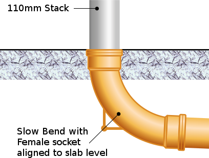

TerryE Posted June 29, 2016 Author Share Posted June 29, 2016 At least we got this advice now And for the benefit of others who might end up going down this shit hole, so correct method is: Or if your slow bend is lower add a short section of pipe which has a female socket at slab level or a straight pipe section with a double socket again aligned to slab level. Fill with a blanking cap whilst the slab-work is going on. And if I recall Dave actually had his cap about 1cm below the slab level so making power floating easier, and he then tapped this 1cm out after the slab had gone off. And now back to my cock-up and how we mitigate this. A few clarifications: When you say a double socket straight connector, are you meaning double push-fit (p/f) or would you use p/f+solder fit using PVC-U solder for the lower socket which is going to be resealed in the concrete? My inclination would be to use the latter rather than p/f upwards against the flow direction. That assumes that we've done the test on a piece fo soil pipe to make sure that the solder socket and the pipe are solder compatible. We have two soil pipes and only one has a ground floor toilet branch attached. The other has rodding access and a lower spigot to the utility sink waste. Surely if solder fit is compatible then can't I just position the double socket above the slab? Lastly if you are suggesting using a double p/f, then why not just use a triple socket branch direct onto the soil pipe and solder the bottom socket? We can use solder to expansion converter for the top socket to give the required expansion. It's just that doing the 6" core is going to be costly and risky -- if anything goes wrong then what is plan B? So if I can avoid this, I will. 1 Link to comment Share on other sites More sharing options...

TerryE Posted June 29, 2016 Author Share Posted June 29, 2016 @Nickfromwales About 30cm @RandAbuild Finishing off a single WC is easy because there are standard F/M fittings for this. Our problem is that this stack as well as the G/F toilet+basin also goes into the bathroom and takes another 2 toilets, 2 basins, a shower and a bath. As Nick says, we really need a smooth straight-bore connection from the internal 110 to the bit sticking out of the slab. A cement femail / pushfit double connector would be fine apart from fitting in the branch to this toilet on this stack. Link to comment Share on other sites More sharing options...

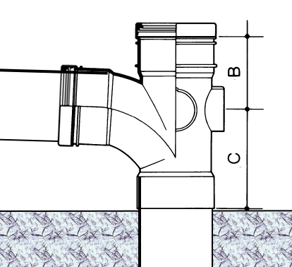

Nickfromwales Posted June 29, 2016 Share Posted June 29, 2016 It's just down to good practice tbh. Reducing the bore at the start of the stack would be a no-no for me. Anyhoo. A ground floor WC will have a 7" pipe centre ( from FFLevel ) where the soil leaves the pan. You'll need a fall in the pipe before it gets to the branch, thus determining the lowest point of the branch. An U/G ( underground ( terracotta coloured )) fitting with 3 sockets may JUST do it IF the socket is IN the slab NOT above it. I'll measure one later and double check. 1 Link to comment Share on other sites More sharing options...

Jeremy Harris Posted June 29, 2016 Share Posted June 29, 2016 If the pipe's cut dead square and with a slight chamfer on the inside top edge I can't see why there would be a problem with just fitting a normal swept branch on to it. It's nice to have a socket poking up at exactly the right height out of the slab, but my guess is that this is very rare. We have a swept bend, just like the one illustrated above, under our slab. However, because the insulation is 300mm thick and the slab another 100mm thick, the swept bend is way below finished floor level. We therefore had a tall stub of pipe sticking up out of the concrete, with a plastic cap taped on it to ensure it stayed clean. When I came to fit the swept branch at the base, all I did was very carefully cut the pipe to length, making sure it was dead square, with the required external chamfer to go into the fitting and a very light internal chamfer. The pipe abuts against the stop inside the branch which is, by design, fractionally smaller than the ID of the pipe, specifically to ensure that there's no upward-facing lip to catch anything. On one external 110mm pipe connection (the one from the kitchen waste external trap to the inspection chamber) the only way I could fit it was with a slip coupler. These have no internal lip, so it is essential that you cut the ends of both pipes absolutely dead square. I'm sure there is probably a tool for doing this, but I made up a jig, using a bit of 6" x 6" x 1/4" aluminium alloy angle that I happened to have. I stuck it in the band saw and made a dead square saw cut through 3/4s of it, and I then used this to cut all the pipes dead square. I found that this made life very easy, as I just marked where I wanted to cut on the pipe with a Sharpie, put the jig on so I could just see the black line in the slot, duct taped the jig to the pipe (both sides), then used a wide mitre saw blade in a hacksaw frame to cut the pipe. The wide mitre saw blade is better than any other saw blade, IMHO, as it is wide enough to stay square in the jig and has no kerf on the teeth, so doesn't wear the jig away, plus it makes a cleaner cut through the pipe. To clean the inside of each pipe end to get a very slight chamfer I used a self-aligning metal deburring tool (like this: To chamfer the outside of pipes fitting into push-fit connectors I just clamped my belt sander into a Workmate at the right angle, turned it on then rested the pipe in the gap in the Workmate bed and rotated it against the belt. This gave a nice even outside chamfer every time, and only needed a quick scrape with a Stanley knife blade to get the fluffy bits off. 3 Link to comment Share on other sites More sharing options...
TerryE Posted June 29, 2016 Author Share Posted June 29, 2016 @Barney12 the coupler that you mention wont give me the depth to include a branch @warby I am using one of these on the first floor for the two toilets but I only need a single branch on the ground floor. @NickfromwalesNick, if I have 2½° fall-away from my pan that about 5cm so the branch centre should be around as far as I can see the pipe centre at the branch needs to be around 12cm above FFL or 13½cm above the slab. However I have a Gerberit with wall hung pan so I can play around with the connection height a little as well as the gradient, so I could get away with around 15½cm or so. That's enough to fit a D/SW Single Branch such as the one below, which requires 152mm. OK I still need an expansion gap on the pipe but I 've got a rodding access immediately above this which I could make push fit at the top or I could use the converter kits which convert a solder fit socket to a push fit one. As Jeremy points out I will need to be anal about getting the cut accurately square which is going to pain in the arse given the position of the pipe but I can make a jig and use a tenon saw and finish off with the old woodworkers trick with a sharpie. And this is still dependent on being able to solder the PVC-U 110 drain to a PVC-U 110 stack branch. Anyway having done a bit of cut and paste from the OSMA catalogue this is what I am looking at (C=152mm): 1 Link to comment Share on other sites More sharing options...
Jeremy Harris Posted June 29, 2016 Share Posted June 29, 2016 That's exactly what I have. Works fine. no problems at all. FWIW, it's exactly what's at the bottom of the stack in our 1983 built bungalow, too, as unforeseen problems before we sell have resulted in me having to rip out and replace the separate WC (the cistern has just cracked, and as it's a lovely green suite in there we've decided to bite the bullet and replace it all before we stick the house on the market). Link to comment Share on other sites More sharing options...

TerryE Posted June 29, 2016 Author Share Posted June 29, 2016 36 minutes ago, Nickfromwales said: I''m not sure about where the hang ups are coming from with having a pushfit at the base of the tee, eg a triple pushfit socket tee, as using double socket connectors, bends and 45's etc is commonplace. ... You get one shot with these. Thanks Nick. As you said you only get one shot and whilst the solvent working time is ample for a 50mm pipe or smaller, this is a 110mm joint in an awkward position. Normally, if the odd joint goes wrong then you say shit and at worst you might need to cut the pipe to use an inline double socket to rotate it or whatever. For this one joint, it would be a case of having to core down through 75 mm of concrete and rebar as you first suggested -- at a minimum. On reflection I think that I'll go with a pushfit. As long as the riser is cut nice and square and finished properly there shouldn't be any issues. Link to comment Share on other sites More sharing options...
Nickfromwales Posted June 29, 2016 Share Posted June 29, 2016 It's what I would do, and have done on just about every stack I've ever connected to. No issues yet, and I'd assume that if shitty black and grey waste water had been leaking anywhere, particularly inside the envelope of a customers home, I'd be the first to know . 1 Link to comment Share on other sites More sharing options...
