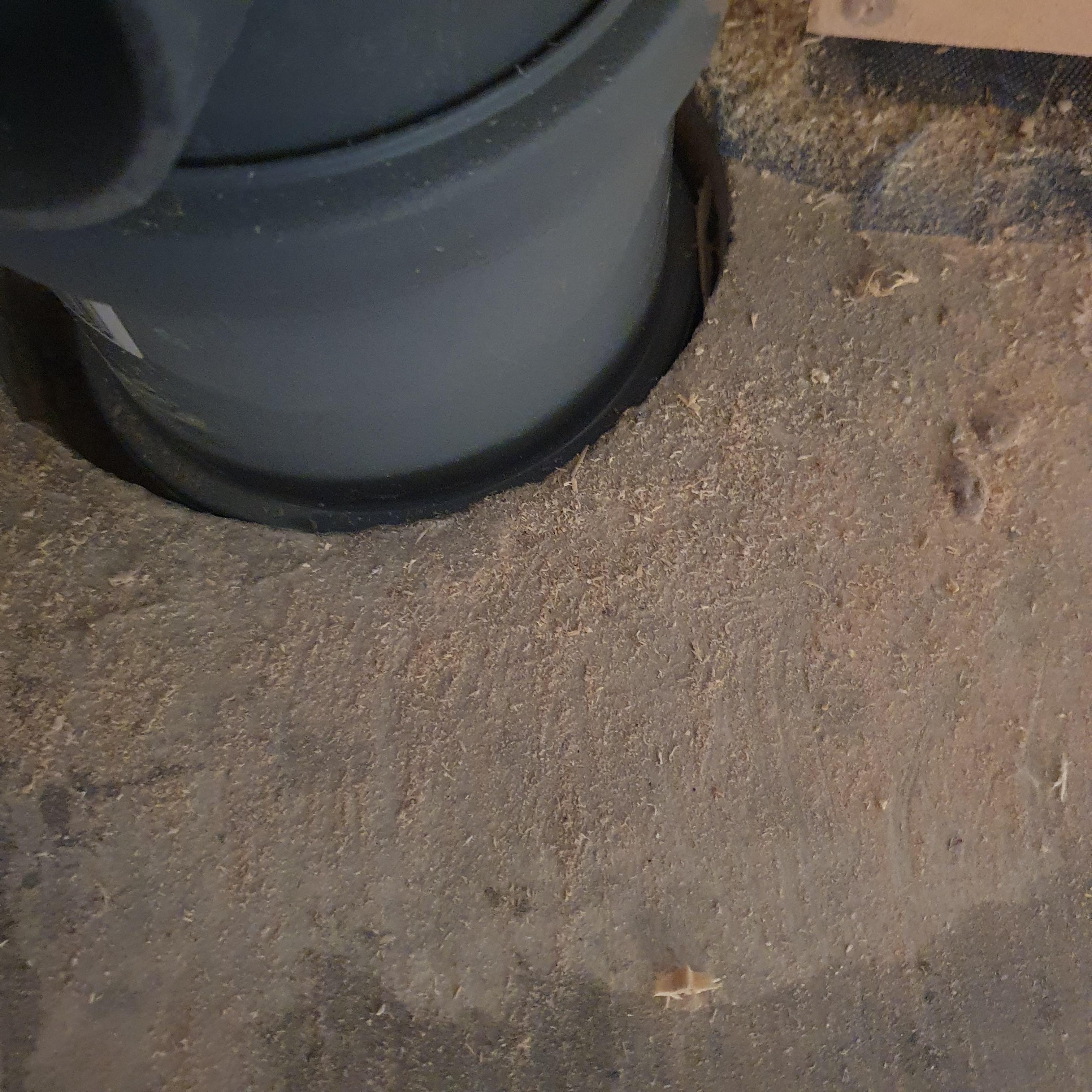

Forgot to mention this before, but one solution is to wrap the stub in a couple of layers of foam roughly at the height of where the concrete slab will finish. That way you can pull out the foam, trim the stub and get a coupler to sit nicely into the slab in the gap created by the foam.
I was connecting my stacks up the other day and this worked almost perfectly. I got the foam out, no need to chisel any concrete and the 15 ish mm gap created by the foam was just right for a coupler to push into.
My mistake was to be too high with the foam on the pipe, I was only an inch into the concrete when I pulled it out, it was enough but if id placed the foam a little lower I could have had a good two inches space to play with.
@SuperJohnG may be an option when setting your pipes in. It saves the headache of getting the socket to the exact height it needs to be.

@LA3222 thanks and I had been thinking about it. Did you just order some foam online?
I've been looking at my rebates for the levels thresholds this week, I had planned to build shuttering boxes, but just realised I'd be much easier just buying some extra EPS sheets and sticking them on the void I wanted. Seems much easier to do. Did you have any voids/ rebates?
I just used some 15mm foam i had laying around, gave it a couple of turns around the soil pipes and taped in place. You can see in the pic it leaves a nice tidy gap around the pipe in which to get a coupler, just set my foam a little higher than I would have liked but it worked. I haven't any experience with rebates etc. I suspect you're on the right lines with setting some EPS in place as a mould.
