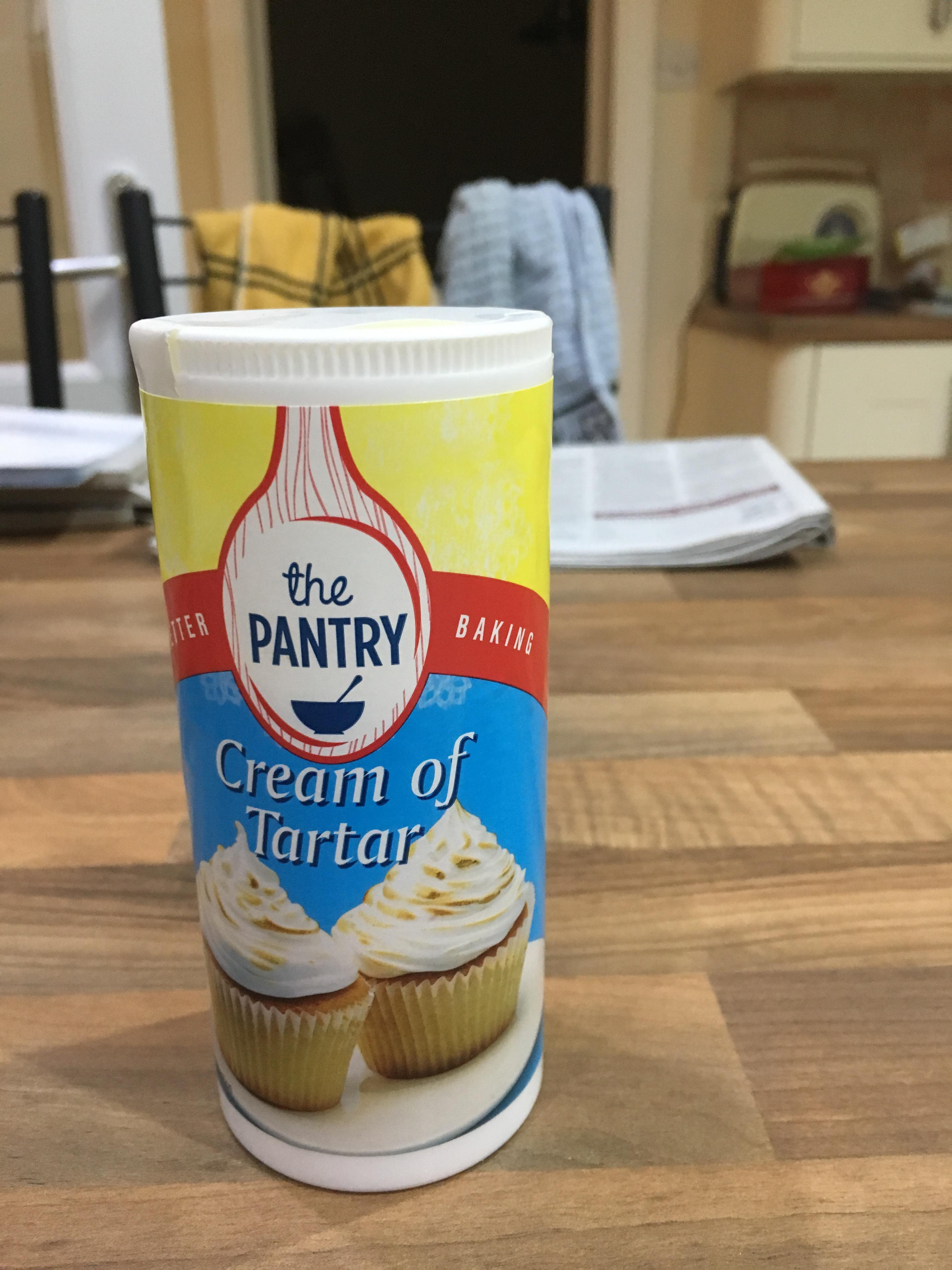

nod Posted April 5, 2018 Posted April 5, 2018 2 hours ago, Onoff said: So I need (hopefully this year ) to do some plastering in the bathroom. The 3m x 3m ceiling and half a wall above the bath 3m wide and 1.3m wide. These are the tools I have collected over the years: A hawk, a mixing paddle and a couple of trowels one being a big stainless steel one, both from Wickes. The ceiling has 4 downlights and the big body dryer - all easily removeable. The wall over the bath: A couple of damaged patches on the wall. Tbh most of this damage will be covered by a nom 4" filed upstand: No idea how this occured or how to prepare so it doesn't show through. The half wall will be painted. Concrete floor to ceiling is 2470mm. Standing in socked feet I can touch the ceiling but wouldn't be able to get any pressure on it. Going to have a crack myself. Worst case I eff it up and get the BiL to go over it. Other than tape the joints any tips? Should I get one of those internal corner trowels? Cheers Top tip Get a tub of cream of tartar Half a tea spoon per bag Makes the finish easier to use and acts a a retarder 1
nod Posted April 5, 2018 Posted April 5, 2018 Just now, nod said: Top tip Get a tub of cream of tartar Half a tea spoon per bag Makes the finish easier to use and acts a a retarder Forgot to say always coat the joints with a separate mix Even on a small cieling Tapered edge always show if you don’t 1
Onoff Posted April 5, 2018 Author Posted April 5, 2018 (edited) 23 minutes ago, nod said: Forgot to say always coat the joints with a separate mix Even on a small ceiling Tapered edge always show if you don’t So you do a small mix, do the joints then bin it? Cream of tartar in first coat and finish coat? Just remembered I bought one of these too: I've two 4' joints that just butt up and aren't tapered edges: Edited April 5, 2018 by Onoff

nod Posted April 5, 2018 Posted April 5, 2018 12 minutes ago, Onoff said: So you do a small mix, do the joints then bin it? Cream of tartar in first coat and finish coat? Just remembered I bought one of these too: I've two 4' joints that just butt up and aren't tapered edges: No mix a small amount fill any joints or beads then add your water for the cieling or wall Add some creama Stair it well Then add powder as normal
