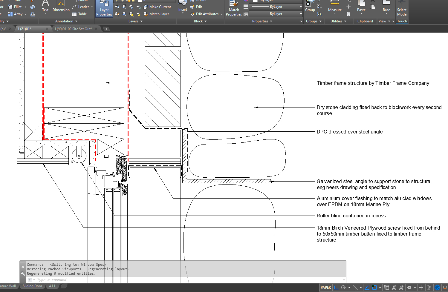

Dudda Posted April 5, 2018 Share Posted April 5, 2018 Coincidence: I’m an architect and had a meeting with a timber frame manufacture just this morning asking him to make all the opes 50mm larger as well. I’ve created a detail where the window blinds are hidden from view and a birch ply window surround frames the view. See below. As for the insulation in your situation you should be fine but I’m not 100% following the detail. Is the insulation only the depth of the window frame or the depth of the ope? Have you a drawing you can show us? 1 1 Link to comment Share on other sites More sharing options...

Tin Soldier Posted April 10, 2018 Author Share Posted April 10, 2018 I'm so confused as to how to attach the windows to the frame. The opening is literally 50mm bigger all round The insulation is 25mm, The straps on the window are 2.5mm attached is a pic of the proposed window installation detail for the blockwork part of the house also attached is a pic of a window, dry fitted with 25mm roofing batten packers last night obviously I could line the opening with 25mm insulation, but I don't like the idea of screwing a strap into the frame through insulation. I cant find any detailing anywhere that shows what to do with the straps? Link to comment Share on other sites More sharing options...
Dudda Posted April 10, 2018 Share Posted April 10, 2018 (edited) I don't see what's wrong in using the small battens like what you're at. If you think about a wall it's timber with insulation cut to fit between. Around the window it's the same thing in your case with some timber pieces and you'll have to cut 25mm insulation and fit them between. If you make the timber pieces a bit wider you may also be able to use them to fix the plasterboard or window boards into. You can go getting special straps made or look at special expensive insulation that can take the weight of the window but I'd keep it simple and use small pieces of timber (but a bit wider and treated) like you already are. EDIT: Just see 'B' on plan is a 25mm timber packer to support the window so very similar to what your at. Edited April 10, 2018 by Dudda Link to comment Share on other sites More sharing options...
Tin Soldier Posted April 10, 2018 Author Share Posted April 10, 2018 Cheers Dudda I think I'll get some wider treated 22mm board, cant seem to get wider 25mm treated wood I guess 22mm is fine as the strapping is 3mm, and any other slack I can shim Link to comment Share on other sites More sharing options...
