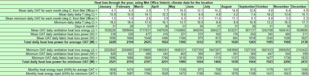

I found the SAP assesment particularly unhelpful. It gives me the total energy used in a year, but not the very much more useful heat input required at any particular condition.
For that I found @JSHarris heat loss spreadsheet far more useful.  With all the data for my house input into that, it tells me the peak heat input to the house will be a little under 2.5Kw when it is +20 inside and -10 outside.  That should comfortably be met by my 5Kw ASHP driving under floor heating and should leave it plenty of time for heating DHW as well
That is the figure you need to size a heat pump for a particular house.
Went through the same process using LoopCAD. Looks like around 6.5kW for us for -2c/20c.

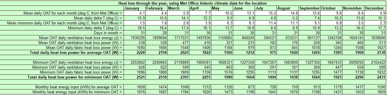

Our kWh requirements are shown below using both @JSHarris's excellent Fabric & Ventilation Heat Loss spreadsheet and our revised (as designed) SAP report.
January heat energy input for minimum OAT = 1876 kWh Heating.thumb.JPG.fe752c8612f7574c293b1ce5b89f0cae.JPG

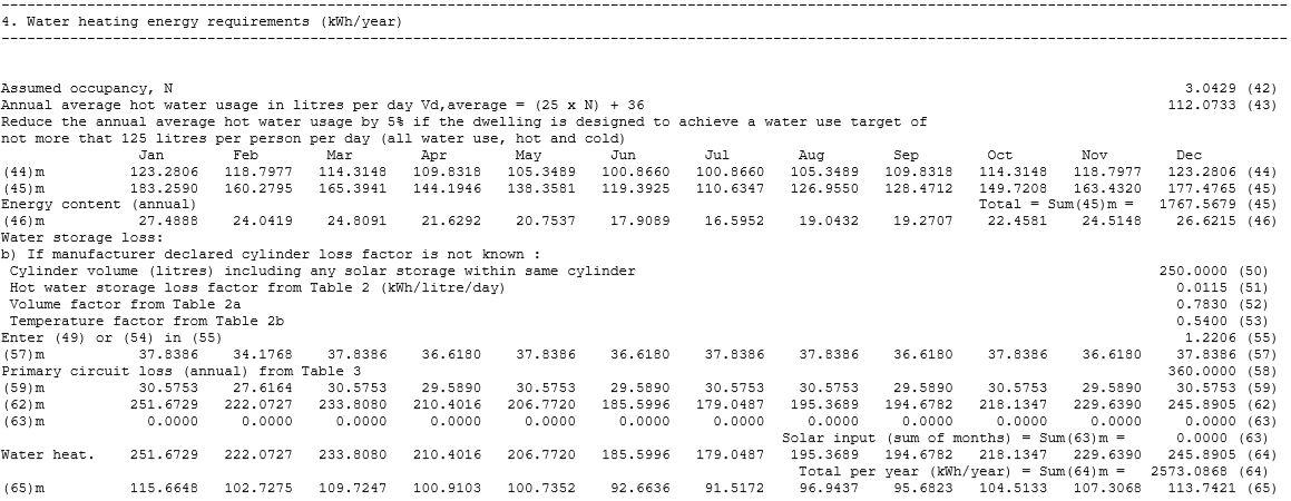

  • Water heating - 2,573 kWh/year SAP_water.thumb.JPG.ca63a39dc0ffce4dea13bef9d4daf4d7.JPG

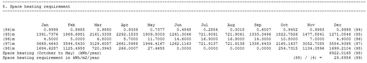

  • Space heating - 6,922 kWh/yearSAP_space.thumb.JPG.9c22946b7666772187c2bf2033d41920.JPG

I must confess to not fully understanding all the results displayed above - could some kind soul please explain them to me in very simple terms?
e.g. Space heating requirement of 6,922 kWh/year...does this mean using average external temperatures I will need to purchase 6,922 kWh each year (from oil, gas or electric supplier) to maintain a constant internal temp of 20 degrees?
