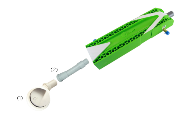

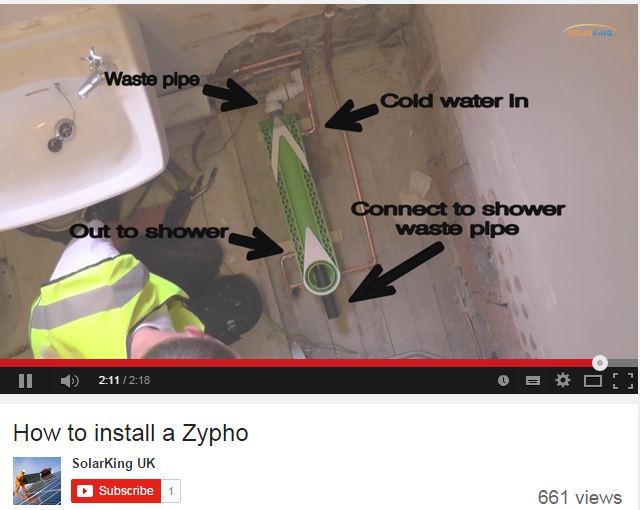

Jeremy Harris Posted March 25, 2018 Share Posted March 25, 2018 Just spotted this on Ebay: https://www.ebay.co.uk/itm/Zypho-Shower-Waste-Water-Heat-Recovery-Unit-Ref-Z8DWPT3-/222784960687?clk_rvr_id=1477658349340&rmvSB=true I've checked out the manufacturer, Zypho, and although the efficiency isn't great, the units look like they are easy to fit and reasonably affordable. If retrofitting to an existing installation, then this unit looks a better bet, as it accepts a 40mm inlet and outlet pipe and is under 500mm long: https://www.zypho.eu/products/zypho-izi/ Payback periods look reasonable, too. 1 Link to comment Share on other sites More sharing options...
ProDave Posted March 25, 2018 Share Posted March 25, 2018 24 minutes ago, JSHarris said: Just spotted this on Ebay: https://www.ebay.co.uk/itm/Zypho-Shower-Waste-Water-Heat-Recovery-Unit-Ref-Z8DWPT3-/222784960687?clk_rvr_id=1477658349340&rmvSB=true the major "problem" with that is it does not accept a 40mm input allowing you to keep the existing wet wall shower trap that is installed. It looks to want to replace the shower trap and it's too late for that now. I similar thing with 40mm in and 40mm out would be quite easy to retrospectively fit to our existing run of shower waste pipes. Link to comment Share on other sites More sharing options...
Jeremy Harris Posted March 25, 2018 Share Posted March 25, 2018 15 minutes ago, ProDave said: the major "problem" with that is it does not accept a 40mm input allowing you to keep the existing wet wall shower trap that is installed. It looks to want to replace the shower trap and it's too late for that now. I similar thing with 40mm in and 40mm out would be quite easy to retrospectively fit to our existing run of shower waste pipes. Which is why I linked to the other model in that post that does have a 40mm inlet and outlet: https://www.zypho.eu/products/zypho-izi/ I've found an Irish supplier, but they want €243 for it, and a UK supplier, but they want £800 for it...................... Link to comment Share on other sites More sharing options...
ProDave Posted March 25, 2018 Share Posted March 25, 2018 That would do. At the moment I have separate 40mm wastes from each shower to the stack (my philosophy to only have a single item on each "small" pipe) so that would either mean 2 of them, or combine the 2 showers onto one 40mm waste. I am actually more inclined to try and find a length of 40mm copper pipe, some 10mm annealled copper coil, and get soldering...... Link to comment Share on other sites More sharing options...

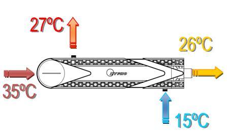

Jeremy Harris Posted March 25, 2018 Share Posted March 25, 2018 I'd say it definitely needs a thermostatic shower to work, as it's going to take a few minutes to heat up and during that time the "cold" water feed to the mixer will change in temperature a fair bit. A thermostatic shower should compensate for that change with no adjustment needed to the shower temperature. You can buy them from Ireland for €243 from here, not sure of the shipping cost: https://www.greentherm.ie/product-category/energy_efficiency_upgrades/waste-heat-recovery/ Or HeatraeSadia stockists sell the same unit here for about £800: https://www.heatraesadia.com/products/renewables/waste-water-heat-recovery/megaflo-horizontal-izi-shower-heat-recovery-unit (yes, rip-off UK is seemingly alive and well...................) 1 Link to comment Share on other sites More sharing options...
ProDave Posted March 25, 2018 Share Posted March 25, 2018 The idea is you pre heat the cold water feed to the shower with the wast recovery, and the thermostatic mixed adjusts to use less hot and more of the pre heated cold to maintain the same temperature. 1 Link to comment Share on other sites More sharing options...
Ferdinand Posted March 25, 2018 Share Posted March 25, 2018 SO that looks to be complication-free using this with gas, then? PRovided the shower is thermostatic. F Link to comment Share on other sites More sharing options...
Jeremy Harris Posted March 25, 2018 Share Posted March 25, 2018 4 minutes ago, Ferdinand said: SO that looks to be complication-free using this with gas, then? PRovided the shower is thermostatic. F Yes, should be. AFAICS, the main issues are sourcing them at a fair price (the Heatrae Sadia price is just very silly, and the Greentherm price isn't much better) and the fact that they do need annual cleaning. The latter seems easy - they recommend a standard bathroom cleaner like Mr Muscle plus the long narrow brush they can supply. 1 Link to comment Share on other sites More sharing options...

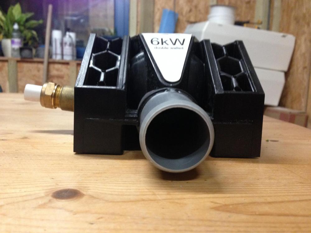

Jeremy Harris Posted March 25, 2018 Share Posted March 25, 2018 Just been doing some more digging around, and found some photos that seem to show that a 40mm pipe can be connected to the unit that has the integral drain: Link to comment Share on other sites More sharing options...
