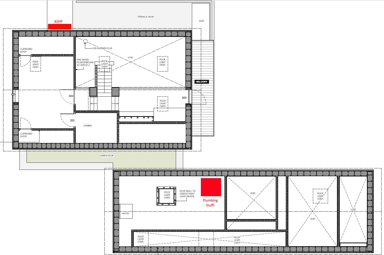

andy Posted November 17, 2018 Posted November 17, 2018 13 hours ago, readiescards said: The system works! A ASHP feeds a PCM34 Sunamp that acts as a preheat for a PCM58 Sunamp and also a ufh buffer. The PCM58 has an electric immersion element to charged it ( to be solar PV at some point in future) Though the late addition of a back up pair of Willis units added some complications: @Nickfromwales can explain it in detail if anyone wants to know more. Ah ha - this is exactly what I'm thinking of! Would seem to be a good solution to me for my place - the only unknown I've got is the ASHP would need to be a split unit with quite a run between the units (circa 15m, TBC). Is that likely to be an issue? I will upload a picture as that'll explain better... 1

Jeremy Harris Posted November 17, 2018 Posted November 17, 2018 9 minutes ago, andy said: Ah ha - this is exactly what I'm thinking of! Would seem to be a good solution to me for my place - the only unknown I've got is the ASHP would need to be a split unit with quite a run between the units (circa 15m, TBC). Is that likely to be an issue? I will upload a picture as that'll explain better... Why does the ASHP have to be a split? There's no real problem with running a (often cheaper) monoblock, with the flow and return pipes 15m long, using insulated pipe. 1

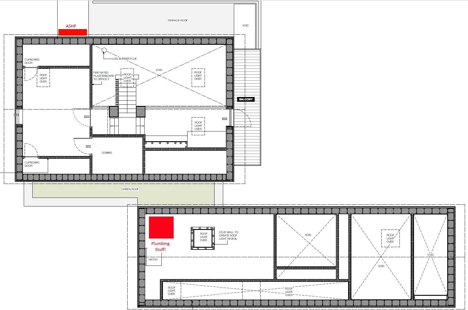

andy Posted November 17, 2018 Posted November 17, 2018 31 minutes ago, JSHarris said: Why does the ASHP have to be a split? There's no real problem with running a (often cheaper) monoblock, with the flow and return pipes 15m long, using insulated pipe. As ever, thanks @JSHarris. Clearly I'm getting confused as to when a split system is needed... Here's a pic to explain the planned location of the external unit and where the plumbing needs to be (that could easily be move left to decrease the distance a little). I was wondering about either running a heavily insulated pipe through/under the slab to minimise distance or around the perimeter (that would seem a more future proof approach).
Jeremy Harris Posted November 17, 2018 Posted November 17, 2018 You can get pre-insulated twin pipe for just this sort of job, where you need to run the flow and return from a boiler or heat pump some distance underground: https://www.polypipe.com/housing/pressure-systems/pre-insulated-pipes Laying this before your slab goes down would seem to be a reasonable option. 1
Nickfromwales Posted November 17, 2018 Posted November 17, 2018 Yup. Buy the Pre-insulated pipe, chuck it under the hoos and job done ✅ 1
andy Posted November 18, 2018 Posted November 18, 2018 Thanks Nick, would I take the insulated pipe up through slab and to loft to avoid joins? Assume that's probably safest long term. Locating it on the other side of the loft area would give a run of about 13m - this does seem to be on the long side for monobloc ASHP from what I'm reading. I think a circa 6kW ASHP should be right for our requirements (2,700W peak heating load plus DHW). I think I need a plumber who knows Sunamps...

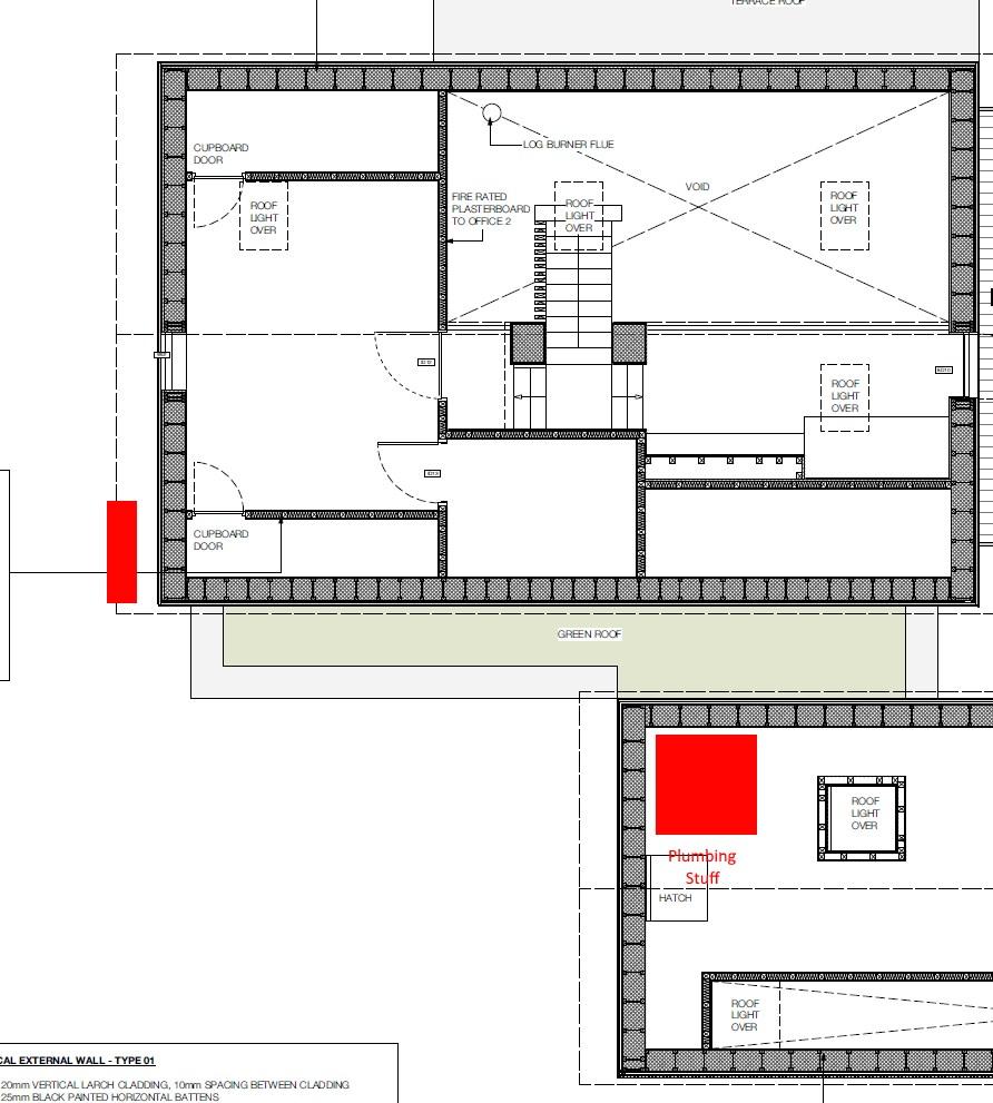

andy Posted November 19, 2018 Posted November 19, 2018 Actually, even though the left of the picture is facing the road, it's still all on my land (not directly onto the road) and I don't think I'd need planning if I placed it here - my garage is in front of it between us and the road but does that meet the PD requirement of "any part of the development would be forward of a wall forming part of the principal elevation or side elevation where that elevation fronts a road"...?
ProDave Posted November 19, 2018 Posted November 19, 2018 How tall is the ASHP? something up to 1 metre tall is allowed in front of the building line usually.
PeterW Posted November 19, 2018 Posted November 19, 2018 Some councils require PP for ASHP as they create “noise nuisance” so cannot be near other properties.
ProDave Posted November 19, 2018 Posted November 19, 2018 22 minutes ago, PeterW said: Some councils require PP for ASHP as they create “noise nuisance” so cannot be near other properties. They do in Scotland, only PD if 100 metres from your boundary. Again it's the obsession with noise thing. I dare not mention to the planners my MVHR vents when on boost make more noise than the ASHP. Not an issue for a new build, just include it on your plans, but more red tape and costs if you want to retro fit one to an existing property.
