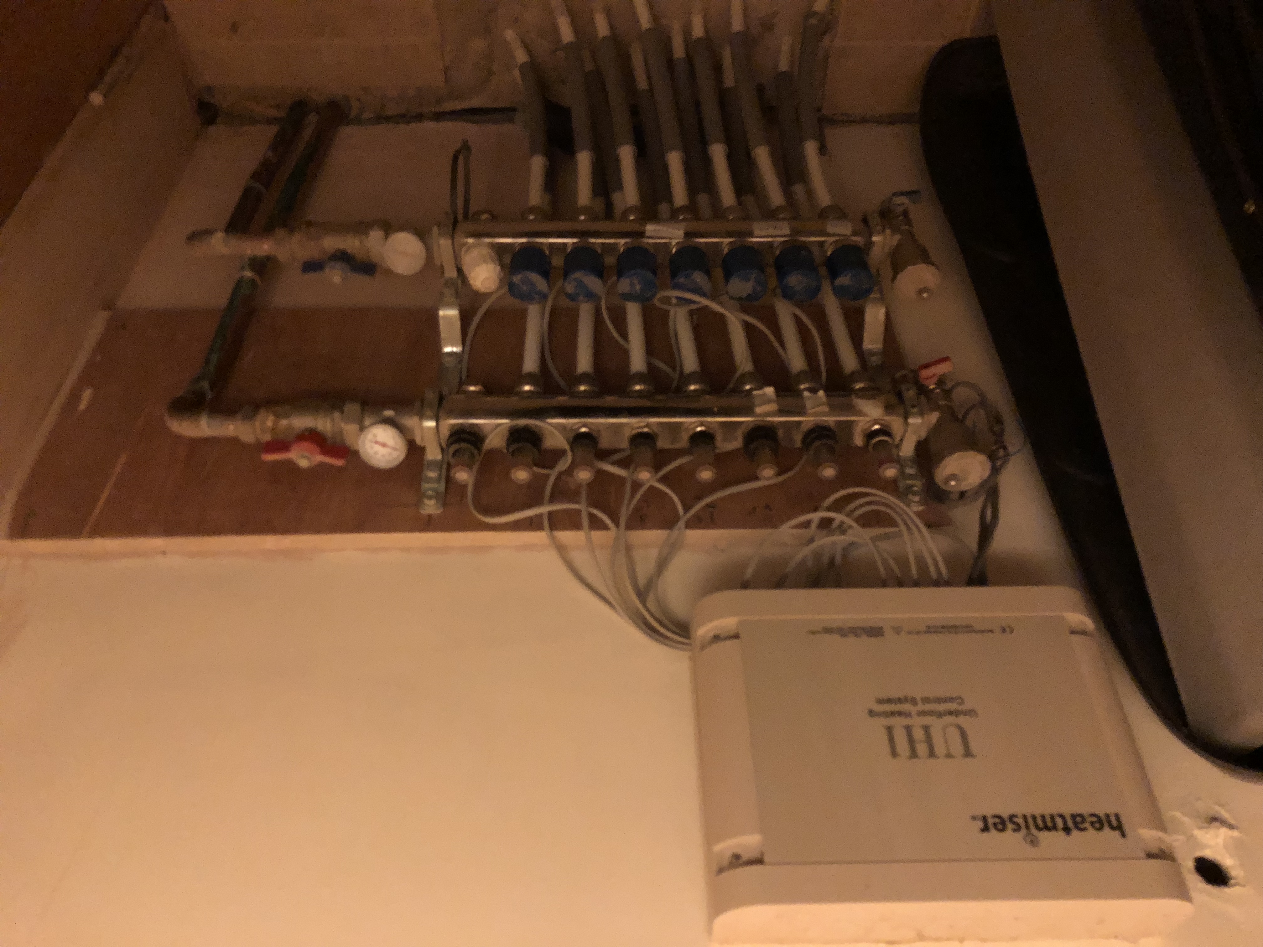

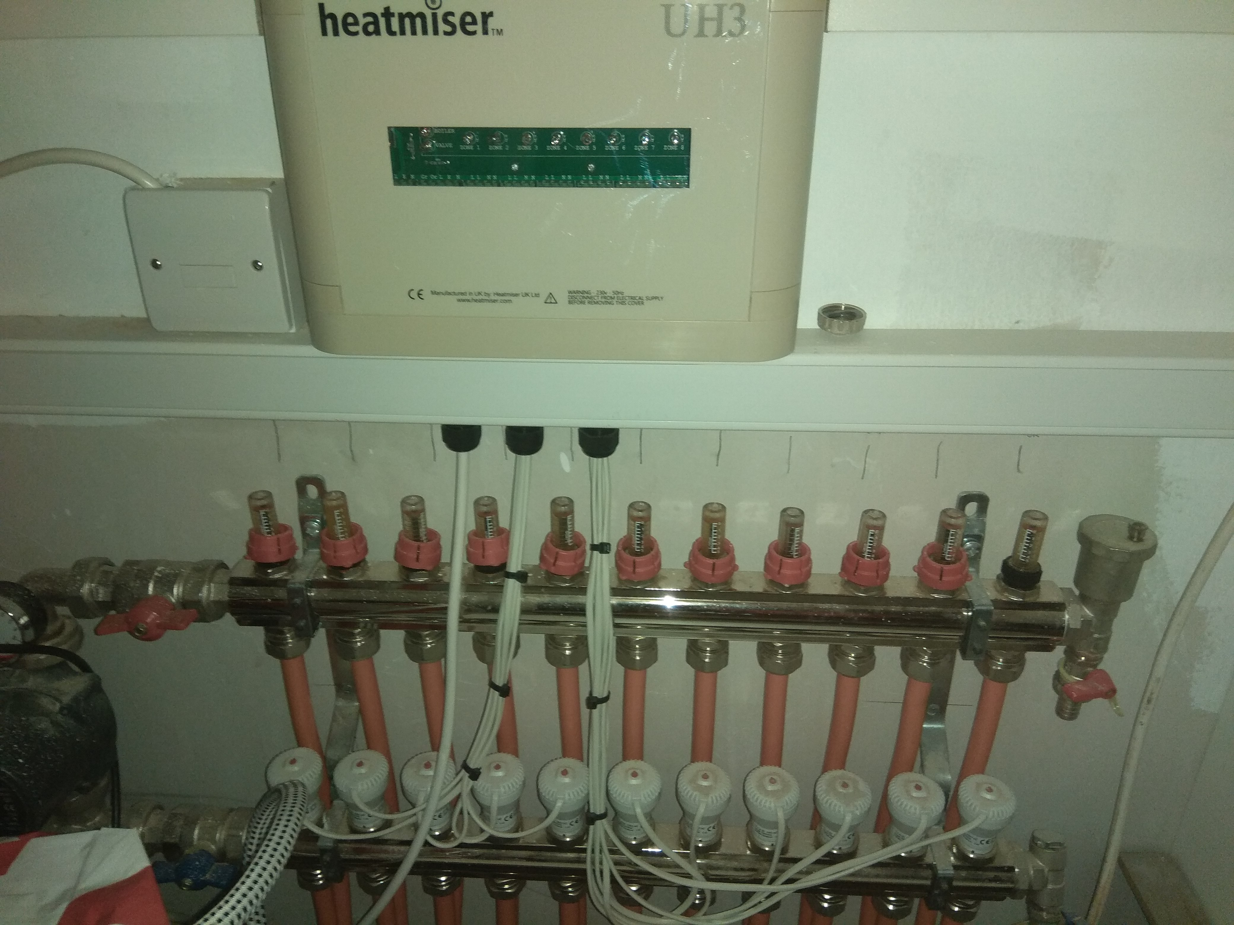

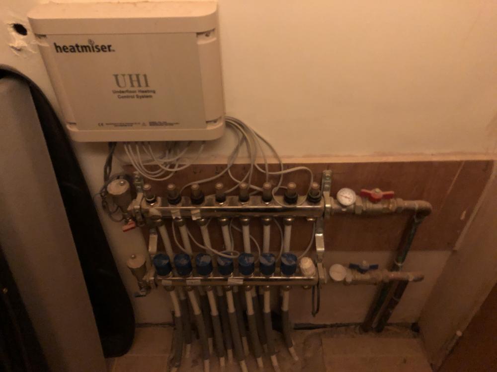

newhome Posted February 22, 2018 Author Share Posted February 22, 2018 23 minutes ago, Declan52 said: I have all heatmiser in mine. All the stats are linked to a control unit which is then linked to the valves on each loop on the manifold. Yep, I have 4 of these! Link to comment Share on other sites More sharing options...
Nickfromwales Posted February 22, 2018 Share Posted February 22, 2018 We'll worry about room stats and zoning once we can get some clarity on the key elements, like being able to run a bath lol. Link to comment Share on other sites More sharing options...
HerbJ Posted February 22, 2018 Share Posted February 22, 2018 This brilliant and what BH is all about The Heatmiser UH3 is only a fancy wiring centre. My son installed one in an extension and it was fairly straightforward =-I attach a brochure with simple schematic Heatmiser-UH3-Wiring-Centre.pdf Link to comment Share on other sites More sharing options...
