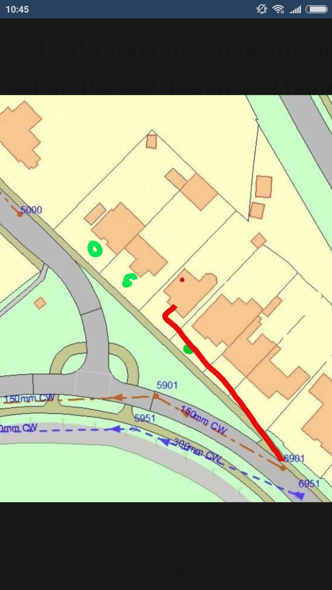

Ed_MK Posted February 17, 2018 Share Posted February 17, 2018 Well..its a bit like columbo folks ..but this time we don't know the answer in advance ...but there is plenty of "just one more things" We got in touch with Anglian waste water to connect our aging in-laws up to the main sewer .. (house on map below with red dot) ..and they sent us this very plan. Connect to 5901 they said ...which is a fair way away ....they dont do the work themselves they have a list of contractors ...and so i got one out for a quote you don't want to know ...honestly! that manhole is 3 metres deep and has a ladder down it ...Apparently we would need to come in at invert level and so the digging and the fitting of a manhole on my in-laws land is like 6 figures Bang! So while he was there he noticed their neighbours (green dot) have a manhole in their drive, so he had a peep and it IS a sewage mahole !!! ....but rather than going to 5901 ...it appears to be heading to 6901 Now the current owner knows nothing of how the house got on mains sewage, but there is a legend, rumour, call it what you will that all these houses have a "spur" in the drive way ...which in his case would make sense as the road doesnt look dug up. So i got advice to get a CCTV camera shoved down it ...but after several phone calls I was told that the rod cameras will only go one way ? and that if the neighbour is on some type of lateral? ..with spurs? then they probably wouldnt get to see it ..so it would be a waste of £200 apparently there are "crawler" camera and ones with prehensile sections ...but these are "mad money" and only large contractors or the water board themselves have access to this technology ....(i bet even Area 51 dont have it) So there you have it ...do you guys think my only alternative is to get on the old "banjo and barrow" or do i sell my car to we buyanycar, the wife to Harvey weinstein and pay potentially 15k 1 Link to comment Share on other sites More sharing options...

Jml Posted February 18, 2018 Share Posted February 18, 2018 Do you know if any others in row are connected to mains, if not may be worth finding out, especially if to other side of your in-laws. Bit detective work without initial cost, may help determine sewer runs. Lots of public sewers are not mapped, many only became public after change in ownership laws of 2011, where ownership passed to water companies. Link to comment Share on other sites More sharing options...
Declan52 Posted February 18, 2018 Share Posted February 18, 2018 Can you not take the pipe out from the in laws then across the lawn into the neighbours manhole then it will go on into the main sewer. The other 2 houses to the left with the green dots where do they connect in to the sewer??? You will have to bung them a few quid and sort out the legal stuff to allow you to have this easement set up but would be still cheaper than major road works. Link to comment Share on other sites More sharing options...

Ed_MK Posted February 18, 2018 Author Share Posted February 18, 2018 Ok, thanks Guys Let me tell you the 2 houses marked in green above are all on Cesspits (as is our inlaws) that road northwards leads to a little village church and on our side of the road very few houses some of them VERY old and from what i can gather the only few that are on mains have had to dig up the road, across the road to the newer development I am guessing which is out of sight on the left of the map. the neighbour is a nice guy, but comes across as a very private person..even when we wanted to LOOK into his manhole it seemed to take 30 seconds of consideration, so I am surmising that it will be a 99% chance of a "No" to dig across his block paved drive to a manhole that he may think COULD become overloaded with other peoples ...how shall i say "tom tit" Regarding money, i think he and his wife are doctors, or anaesthetist or something and I can't see a brown envelope and bottle of Pinot Grigio cutting it . ..they probably earn more in a year than i do in ten! ...So I guess its back to basics ... We could find space for a treatmant plant ..but to be honest with the Polystorm hole in the back and the extensive pipework to channel it means it will probably end up close to the 5/7k anyway ....and to be honest we have experience off cesspits (i know a plant is different) but my wife will equate it with a cesspit , and that mean emptying 4 times a year, the end of the garden smelling like an egyptian gutter and the joy of standing in wellies with a long rod 3 or 4 times a year shouting down the garden ...."is it going down yet" ....nope, she definitely wont go for it ...She is one of the type that when they produce a "richard the third" .....wants it to move as far and as fast as possible away from whence it came Link to comment Share on other sites More sharing options...

Ed_MK Posted February 19, 2018 Author Share Posted February 19, 2018 (edited) Well as i said i have a new "expert" coming tomorrow... I think what has them all flummoxed is that if you LOOK at my neighbours manhole it is set up to travel AWAY from where we all think it should (red arrow shows direction of waste in manhole) I am correct in thinking that the Anglian water "arrows" shows direction of the drain and not source? surely that would be nuts LOL !?!? So why oh why would a person lay a drain (or lateral) that points AGAINST the flow ?..it is DEFFO going up the footpath and it appears ....(which would be insane) is heading roughly to 6901.. although none of them have "lifted" that yet as they say it is not possible that they would connect to that one.. ...which TBH i seem to agree with. I mean these manholes are NOT new, and could be there since the road was extended in the 80's at the latest early 90's and the neighbours manhole has for SURE gone in in the last 7 years Edited February 19, 2018 by Ed_MK Link to comment Share on other sites More sharing options...
Jeremy Harris Posted February 20, 2018 Share Posted February 20, 2018 The direction arrows should be the direction of flow. My experience with Wessex Water was that they didn't really know where some of their pipes were, as a large part of the network predates the formation of the water companies and may even predate the old water boards that preceded them. In our case the village had it's own small water corporation, set up in the late Victorian era, and as well as the records of positions being in error or lost, there are pipes that the water company own that they don't even know of! What was fairly common practice was to run a private sewer along a row of houses and then have that connect to a main sewer at one point. From your plan, and the approximate date of construction of the nearby houses, do you think it's possible that there is what would have been a private sewer that runs along under the front gardens of the houses in the rough direction of your arrow? Our last house had this arrangement, it was in a row of four built at the same time and there was an 8" (I think) sewer running across the front gardens of all four, then connecting to the main sewer in the lane at one end. In the past these private sewers were the responsibility of each householder, but relatively recently the law changed and made them the responsibility of the water companies. As above, though, my experience has been that the water companies have no knowledge of these old private sewers; they add them to their drawings as and when they come across one. Link to comment Share on other sites More sharing options...
