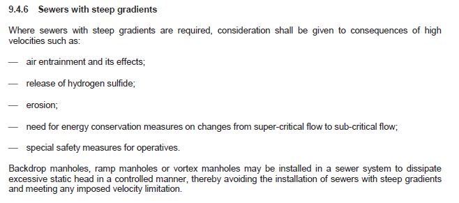

There's no restrictions in either the Building Regs or in the British Standards regarding how steep a fall you can lay a foul drain at (apart from the restrictions governing minimum gradients)
Some relevant extracts:
First extract is from BS8301:1985 Code of Practice for Building Drainage (now superceded)
Second extract is from BS EN 752:2008 Drain & Sewer Systems outside Buildings
Edited by Ian
Thanks for that, so it seems that there has been a change of view on this over the past 35 years!  Makes me wonder what caused our old drain to block so often.  That was in pre-drain camera days, so the views of the guys clearing it was probably guesswork.  It was also clay pipe, so might have been a dislodged joint or similar.
