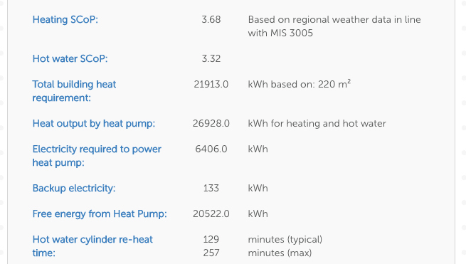

Nestor Posted February 15, 2018 Author Posted February 15, 2018 Our draft SAP says we have a primary energy demand of 19200 kWh/year. Nuheat have quoted for both heat pumps and say we have a total building heat requirement of 21913 kWh/year. RHI could pay for most of the pump and install cost. @ragg987 Do you know what your SAP energy demand was and how much you use annually ? A friend just fitted an ASHP and just had a bill for nearly £300 for a months electricity so he's not happy. @ProDave I have digger but really can"t face digging 500 metres of trench. @Alexphd1 A heat pump for less than a grand, how?? @vivienz Similar issues regarding requirements, I struggle to understand Sunamp? What does it all mean,
Jeremy Harris Posted February 15, 2018 Posted February 15, 2018 A basic monobloc inverter ASHP, of a good, known and trusted brand, can be had for less than £1000 if you hunt around. Any ASHP that is using £300W of electricity in a month is either absolutely massive or is set up so badly as to not be worth having. There are a LOT of badly specified/set up/installed heat pump installations around. In this cold weather I've been keeping an eye on the energy used by our ASHP. It heats the whole house to around 21 deg C, using UFH, and pre-heats the hot water. In the past month of pretty cold weather (nights down as low as -3 deg C around here) the electricity used by the heat pump has totalled 67 kWh over that month, so a cost of under £15, including the standing charge. That's a daily cost of around £0.50, not taking account of the fact that some days (like right now) the heat pump is being powered entirely by the PV, so is costing nothing at all to run. At a guess I'd say the true cost in electricity for heating over the past month would be well under £0.50 per day, allowing for those clear and sunny cold days where we've had quite a bit of PV output.

Nestor Posted February 15, 2018 Author Posted February 15, 2018 10 minutes ago, JSHarris said: Any ASHP that is using £300W of electricity in a month is either absolutely massive or is set up so badly as to not be worth having. There are a LOT of badly specified/set up/installed heat pump installations around. @JSHarris Its a 12kW for a very well insulated 200 sq m new build. I think the set up needs looking at. Your figures are very impressive, is there any point having solar thermal if you have PV with a diverter, can you have both? Can someone clarify the RHI, is it just based on your EPC rating and an estimate of your energy requirements or do you submit actual units used like the Solar PV tariff with a meter? Thank you.

Jeremy Harris Posted February 15, 2018 Posted February 15, 2018 8 minutes ago, JamesP said: @JSHarris Its a 12kW for a very well insulated 200 sq m new build. I think the set up needs looking at. Your figures are very impressive, is there any point having solar thermal if you have PV with a diverter, can you have both? I couldn't see any merit in solar thermal, it's expensive to buy and install, produces very little output in winter, needs regular maintenance and doesn't perform as well as might be expected from the apparent efficiency difference between that and PV. There are some interesting comparisons of costs etc here (although a bit out of date now): https://edavies.me.uk/2011/12/pv-heating/ https://edavies.me.uk/2012/01/pv-et-flat/ https://edavies.me.uk/2012/01/solar-per-area/ https://edavies.me.uk/2012/11/pv-dhw/ Yes you can have both, but you have to bear in mind that solar thermal can only ever deliver heat energy when the collector on the roof is hotter than the tank or other thermal storage system. PV can deliver heat into a tank or other thermal storage system no matter what the temperature. 1 1
