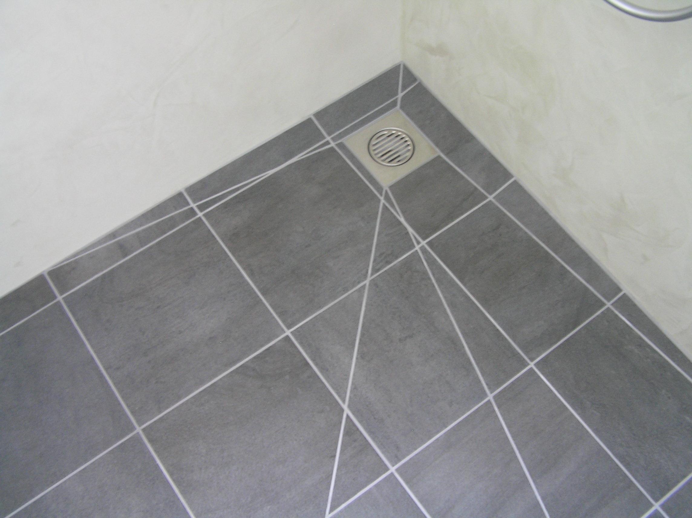

Onoff Posted July 17, 2018 Author Posted July 17, 2018 Back to the shade difference question... I've 16 tiles in this corner to lay something like this: Assuming all the boxes of tiles are the same shade reference / production run, then do I just use them as they come out of the box or do I pick "1 tile from each box" to account for up any shading differences? Or is this less of a problem nowadays? Cheers
Nickfromwales Posted July 17, 2018 Posted July 17, 2018 I never mix batches. Just open the nearest box and whack it down, then go grab the next one and keep going. Just thinking, if these are ceramic then you could easily re-finish the edges with a diamond whetstone. 1
Onoff Posted July 17, 2018 Author Posted July 17, 2018 3 minutes ago, Nickfromwales said: I never mix batches. Just open the nearest box and whack it down, then go grab the next one and keep going. Just thinking, if these are ceramic then you could easily re-finish the edges with a diamond whetstone. Ta. I was thinking on the same lines to put a slight bevel on the cut edge. It'd maybe take out some of the small chips. The other thing I was thinking was to sacrifice 8 tiles so a cut "tile" on the fall line is in fact made from two good ones. If I go that route thinking I could use the score 'n snap manual Rubi cutter.
Nickfromwales Posted July 17, 2018 Posted July 17, 2018 As long as the tips of the cuts dont snap off then yea. TBH the wet cut and diamond clean up should be less wasteful and be spot on.

Onoff Posted July 17, 2018 Author Posted July 17, 2018 (edited) First tile cut! I ditched the fence tbh and did it freehand. Once again @Nickfromwales was right and you CAN cut freehand and follow the line / correct a bit. So, warts and all: A tad off: A ragged rhs edge., hoping a whetstone might ease that edge so I can use both bits of the tile. Looks worse on the photo. The pointy end didn't quite survive: Happy enough with this interface of the 4 tiles: This, where the pointy bits meet will just have to have a bit more grout. The fall line is the diagonal: You can see the fall, as intended. My CAD and angle bead casting frame thing paid off I think: Close up: And the long slope: Beer o'clock now! ...and an M&S curry! Edited July 17, 2018 by Onoff Curry photo added!

Nickfromwales Posted July 18, 2018 Posted July 18, 2018 Looking good TBH. As these are ceramic you may need to paint the upper part of the cuts as the grout wont stay flush or proud after sponging back. You don't want to see the terracotta. Car spray paint, and it'll cover the bits of breakout too if you mask up well enough. Most instances don't see two cut edges butted up with a groutline so deffo worth considering IMO. "we've come this far !"
Onoff Posted July 18, 2018 Author Posted July 18, 2018 1 hour ago, Nickfromwales said: Looking good TBH. As these are ceramic you may need to paint the upper part of the cuts as the grout wont stay flush or proud after sponging back. You don't want to see the terracotta. Car spray paint, and it'll cover the bits of breakout too if you mask up well enough. Most instances don't see two cut edges butted up with a groutline so deffo worth considering IMO. "we've come this far !" Ta. As I say at each "two cut edge butt" one tile is pretty good and the other less so - tb invisible from standing up looking down. That's me trying to save tiles. I have the option, for the sake of 8 tiles to replace the dodgy edge halves with score 'n snapped ones. Would grey "garage" type floor paint applied with an artist's fine brush work? Any particular brand of car spray? Doesn't it come off when you wash the tiles / over time? Lastly, a whetstone, where from? Cheers

Onoff Posted July 18, 2018 Author Posted July 18, 2018 I'm quite pleased with that. Going to play with the Rubi cutter now! Falls good: Was aiming for 13-26mm and it's about 18mm. Level not short enough here really but it falls: 4
