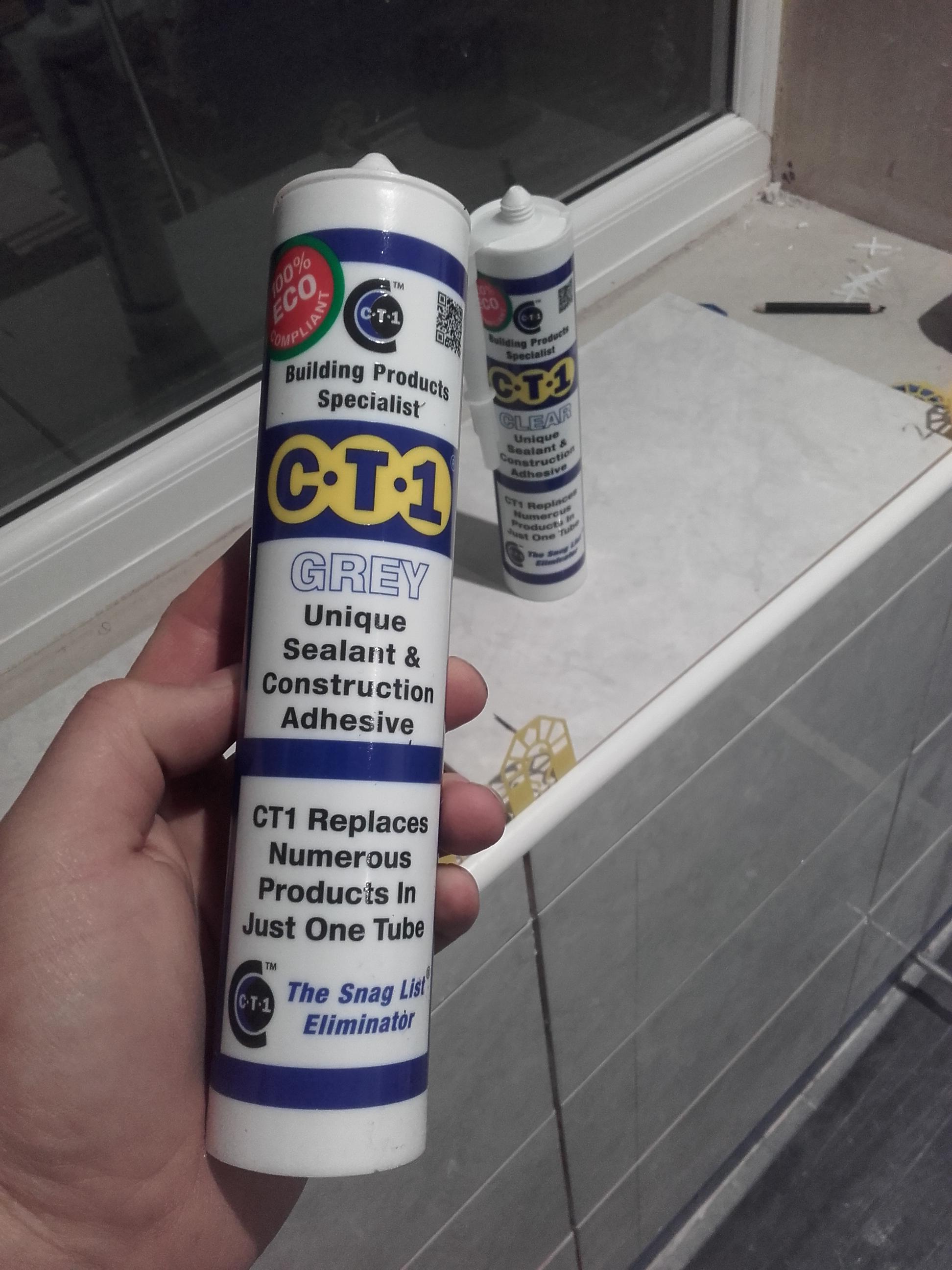

bassanclan Posted October 30, 2018 Posted October 30, 2018 6 hours ago, Onoff said: CT1 then colour matched silicon over that that can be redone as and when? You can get grey CT1 which will be ideal for your job anyway. Either put your grout in first or ct1 in the joint, but I wouldn't be bothering with "silicone" unless you were set on it being white. 1

Onoff Posted October 30, 2018 Author Posted October 30, 2018 1 hour ago, bassanclan said: You can get grey CT1 which will be ideal for your job anyway. Either put your grout in first or ct1 in the joint, but I wouldn't be bothering with "silicone" unless you were set on it being white. If I say clear CT1 the 1mm gap first and let dry then grey CT1 a bead I can see the grey CT1 sticking like sh!t to the clear CT. When the grey gets old and tired and I rip it off it could conceivably pull out the clear CT1 from the 1mm gap. @Nickfromwales method of grout in the 1mm gap followed by easily replaceable colour matched silicon seems more sensible maybe? I can't see that when the standard silicon gets grubby it will pull the grout out? Another option maybe; clear CT1 in the 1mm gap, let dry then colour matched silicon bead. The question is again when removing the grubby bead will it pull on the CT1? Must admit I'm erring towards CT1 at least in the 1mm gap.
bassanclan Posted October 30, 2018 Posted October 30, 2018 If you are concerned then why not put the grout in the gap as @Nickfromwales says then grey CT1 over if you like? Not sure why you would want to put an inferior product "silicone" when you can use grey CT1 which is not going to be far off the colour of your grout anyway

Nickfromwales Posted October 31, 2018 Posted October 31, 2018 On 30/10/2018 at 08:30, bassanclan said: If you are concerned then why not put the grout in the gap as @Nickfromwales says then grey CT1 over if you like? Not sure why you would want to put an inferior product "silicone" when you can use grey CT1 which is not going to be far off the colour of your grout anyway Have you bought the grey CT1? I’m guessing not , because if you had, you would NOT be recommending it for this application. CT1 in the 1mm grout line? What colour? How is the white grout supposed to make a seal against the CT1, or how would you stop the grout so there was a gap for the CT1 to go in the last 1mm? Not going to happen ?? Read back, as I mentioned using the white grout and ramming it under the tile and into the intersections where the grout lines rise. Then I mention using grey silicone. Not inferior when used to your advantage ?. White CT1 goes custard yellow and anything other than clear is the worlds biggest pig to get a token bead with that doesn’t look like it’s been applied by a Wildabeasts hoof. Just imagine the grey over spill going onto the white grout, and from there it’ll be downhill to the booze cabinet. CT1 isn’t available in shades of grey, and the grey they have will look like gutter sealant. To summarise, I’m not a fan of that idea 1
Nickfromwales Posted October 31, 2018 Posted October 31, 2018 Not a problem on the trims where you can wipe them to nothing with baby wipes, but try an internal angle and not getting it onto the white grout.
bassanclan Posted October 31, 2018 Posted October 31, 2018 I've used the grey in this exact situation (internal angle) and had no problem. Put two lines of masking tape to keep a straight run and plenty of multisolve on your finger to help smooth it
Onoff Posted October 31, 2018 Author Posted October 31, 2018 4 minutes ago, bassanclan said: I've used the grey in this exact situation (internal angle) and had no problem. Put two lines of masking tape to keep a straight run and plenty of multisolve on your finger to help smooth it How thick a bead are we talking about here btw?
bassanclan Posted October 31, 2018 Posted October 31, 2018 Just now, Onoff said: How thick a bead are we talking about here btw? Whatever thickness you want, but put your lines at 2-3mm vertical and 2-3mm horizontal
Onoff Posted October 31, 2018 Author Posted October 31, 2018 1 hour ago, Nickfromwales said: Have you bought the grey CT1? I’m guessing not , because if you had, you would NOT be recommending it for this application. CT1 in the 1mm grout line? What colour? How is the white grout supposed to make a seal against the CT1, or how would you stop the grout so there was a gap for the CT1 to go in the last 1mm? Not going to happen ?? Read back, as I mentioned using the white grout and ramming it under the tile and into the intersections where the grout lines rise. Then I mention using grey silicone. Not inferior when used to your advantage ?. White CT1 goes custard yellow and anything other than clear is the worlds biggest pig to get a token bead with that doesn’t look like it’s been applied by a Wildabeasts hoof. Just imagine the grey over spill going onto the white grout, and from there it’ll be downhill to the booze cabinet. CT1 isn’t available in shades of grey, and the grey they have will look like gutter sealant. To summarise, I’m not a fan of that idea I was going to use this, silver grey one: https://www.screwfix.com/p/mapei-mapesil-ac-111-solvent-free-silicone-silver-grey-310ml/93192? Assuming I ram white grout in the 1mm gap first are you saying that CT1 is harder to apply than normal silicone? Also that it will maybe stain the white grout? Cheers
Nickfromwales Posted October 31, 2018 Posted October 31, 2018 7 minutes ago, Onoff said: I was going to use this, silver grey one Assuming I ram white grout in the 1mm gap first are you saying that CT1 is harder to apply than normal silicone? Also that it will maybe stain the white grout? Cheers Grey matched silicone = ✅ CT1 harder = ✅✅ Stain the white grout ? = ✅✅✅✅✅✅ Stick with me kid ? 1
