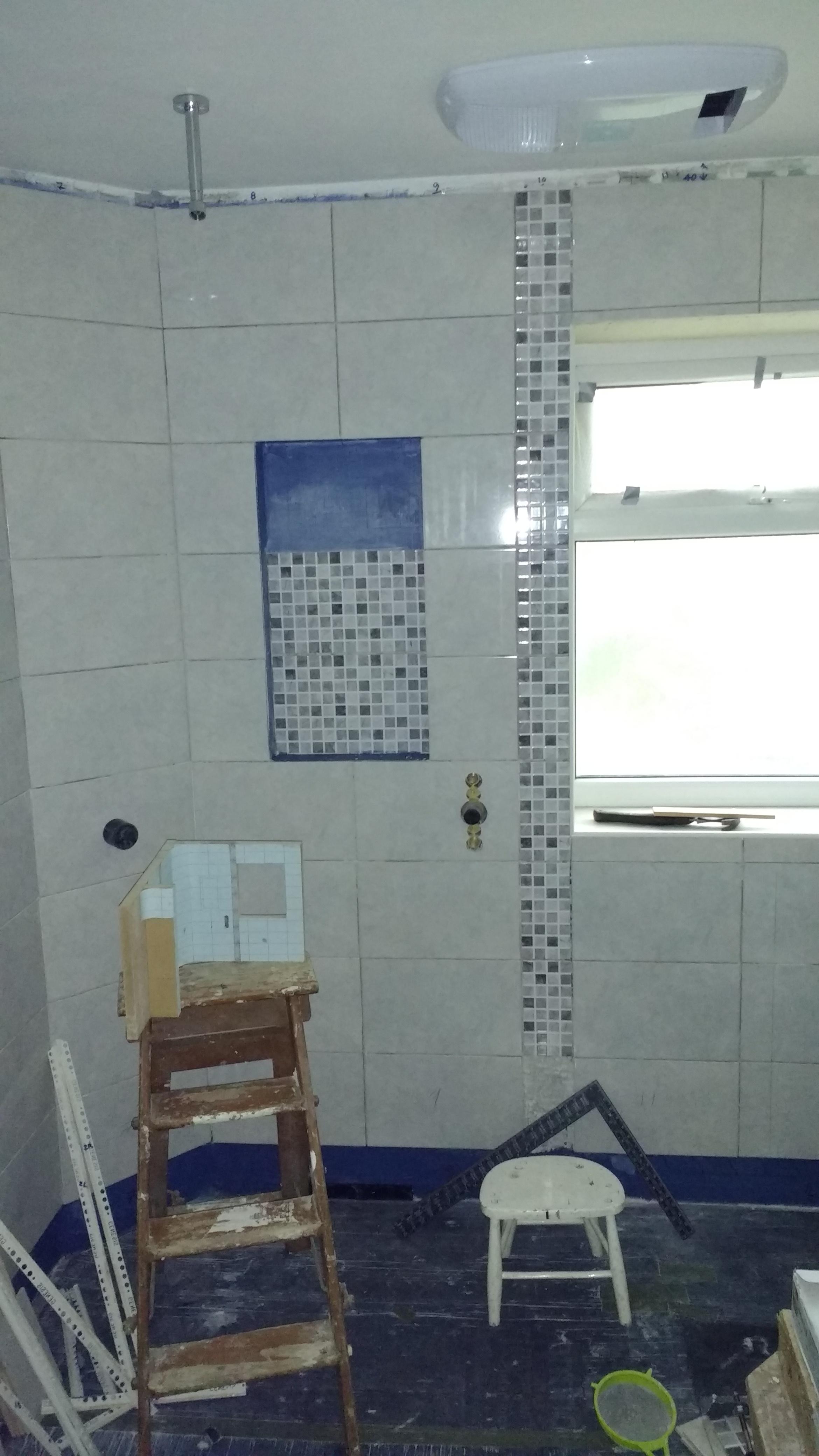

Onoff Posted October 26, 2018 Author Posted October 26, 2018 (edited) It was bugging me where I went wrong to end up with pissy little rips up by the ceiling. After all the model I made showed reasonable width cut tiles top and bottom. The culprit I thought was the shower mixer positioning. The model had it on a grout line but I put it in the middle of a tile. But no, that wasn't the issue. Decent tile size at the floor and 4 full tiles up to the pocket. So then I'm thinking some form of accumulative error. Not that either... The culprit...ME! The floor to ceiling height is nom 2470mm. I made the model 2570mm! 140mm tiles at the top would have looked better than 40mm! Tbh with slight tweaking I could have had a slightly higher pocket, near full tile at the ceiling and near full tile at the base. Also no rip along the window sill. Never mind. Edited October 26, 2018 by Onoff 1

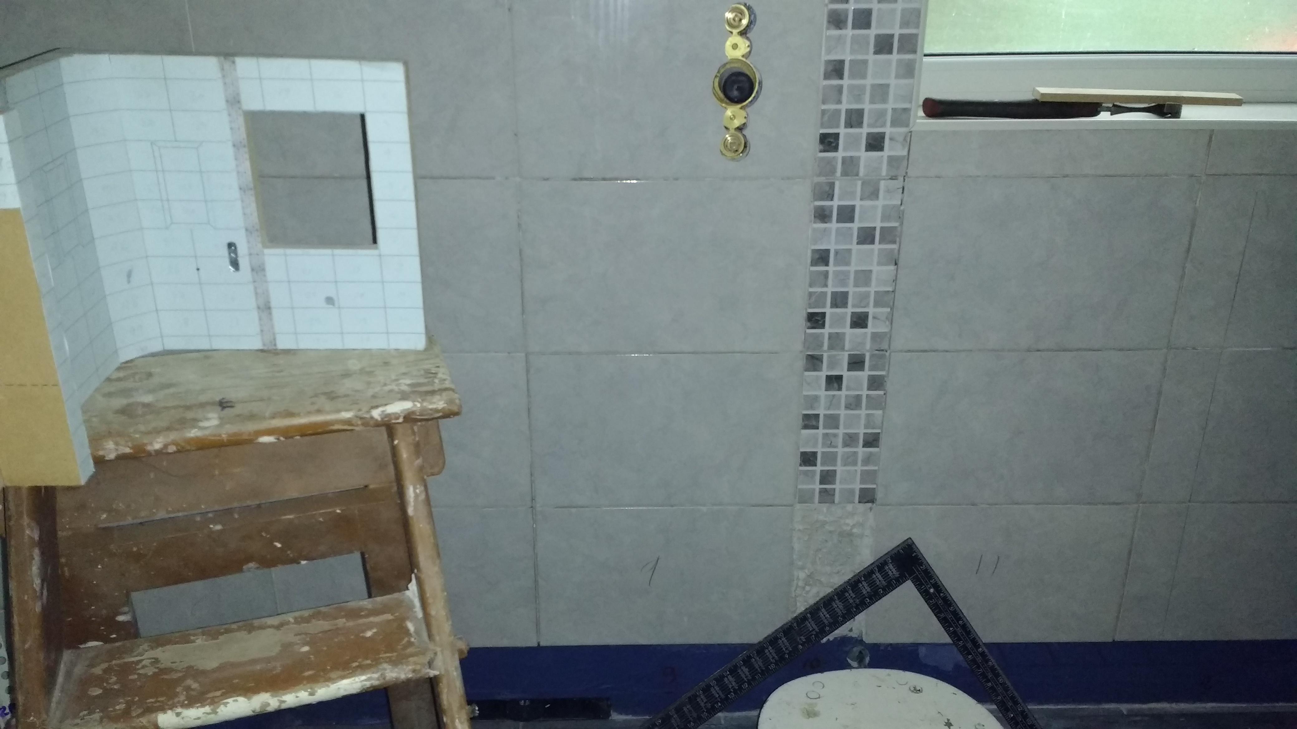

Onoff Posted October 28, 2018 Author Posted October 28, 2018 A few fiddly ones at the bottom stuck on today. All on 1mm packs to achieve the requisite "credit card" distance off the floor: 3
Pocster Posted October 28, 2018 Posted October 28, 2018 5 minutes ago, Onoff said: A few fiddly ones at the bottom stuck on today. All on 1mm packs to achieve the requisite "credit card" distance off the floor: Looks well smart ! ?
Tennentslager Posted October 28, 2018 Posted October 28, 2018 Yes, very nicely done old fruit. Time to start shopping for new towels
Nickfromwales Posted October 28, 2018 Posted October 28, 2018 Nothing not to like there chief. Once grouted it'll be a thing of beauty.

Onoff Posted October 29, 2018 Author Posted October 29, 2018 @Nickfromwales, A question...when I do the window sill tiling: SWMBO doesn't want to feel the edge of the tile trim ideally (when SHE cleans ), she wants it flush with the tile. Should I then set the tiles flush but leave a nominal credit card size gap and fill with colour matched silicon? Cheers
Nickfromwales Posted October 29, 2018 Posted October 29, 2018 Depends how straight the tiles are. If like most ceramic they have a slight cup to them then you may well be better off doing the gap and siliconing. Put some packers down to rest the tiles on and pick the best tiles out of the bunch and see what the results are like. 2 hours ago, Onoff said: SWMBO doesn't want to feel the edge of the tile trim ideally (when SHE cleans ), she wants it flush with the tile. PS, so does everyone else 1
Onoff Posted October 29, 2018 Author Posted October 29, 2018 Removing the 1mm (yellow) packs and the tips of a few are in there tight and stick fast though snapped off flush. No way are they coming out. Presume OK to just grout and (colour matched) mastic bead over?
bassanclan Posted October 29, 2018 Posted October 29, 2018 Yes of course. Personally I would still just ct1 (no grout) my thinking being if there is any movement it might be in the junction between wall and floor but everyone has their own way of doing things 1
Onoff Posted October 29, 2018 Author Posted October 29, 2018 1 hour ago, bassanclan said: Yes of course. Personally I would still just ct1 (no grout) my thinking being if there is any movement it might be in the junction between wall and floor but everyone has their own way of doing things CT1 then colour matched silicon over that that can be redone as and when? 1
