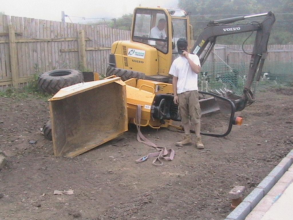

Same goes with the dumper. They are very dangerous bits of kit. They can tip over if you are not careful.
+1
I nearly got bounced off one going over what seemed like a reasonably small bump at moderate speed. I hadn't strapped in because I was only moving it a short way, but it gave me new respect for what those big bouncy tyres could potentially do.

Ok I’m a little scared. Please take this on board.
Please please do not hire a 1 ton high tip dumper.
They are BLOODY DANGEROUS
hire a 3 tonne dumper they are very stable and you will have to be very silly to tip it over.
The high tip 1 tonners fall over if you just look at them funny.
Unless you have a very narrow site the 3 tonne one is easier to load as the bucket is bigger.
