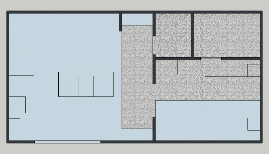

Crofter Posted February 14, 2018 Share Posted February 14, 2018 I'm aware of the basics of an MVHR install, that you want to keep everything balanced, you want to maximise the distance between supply and extract points, and that you want to extract from areas of higher humidity i.e. bathrooms and kitchens. My problem is that with a very small open plan house, I am struggling to find places to put the supply vents. I obviously want an extract in the bathroom, one in the kitchen, and I think it would be good to put one at high level in the loft space as that is where all the humid warm air will tend to go. These three points would end up as far from one another as it is possible to get. If I then had a single supply vent centrally located, that would maximise the distance between supply and extract points. But it's obviously not great from the point of view of keeping everything balanced. I'll try to attach some pictures of the house and a floorplan later. Link to comment Share on other sites More sharing options...

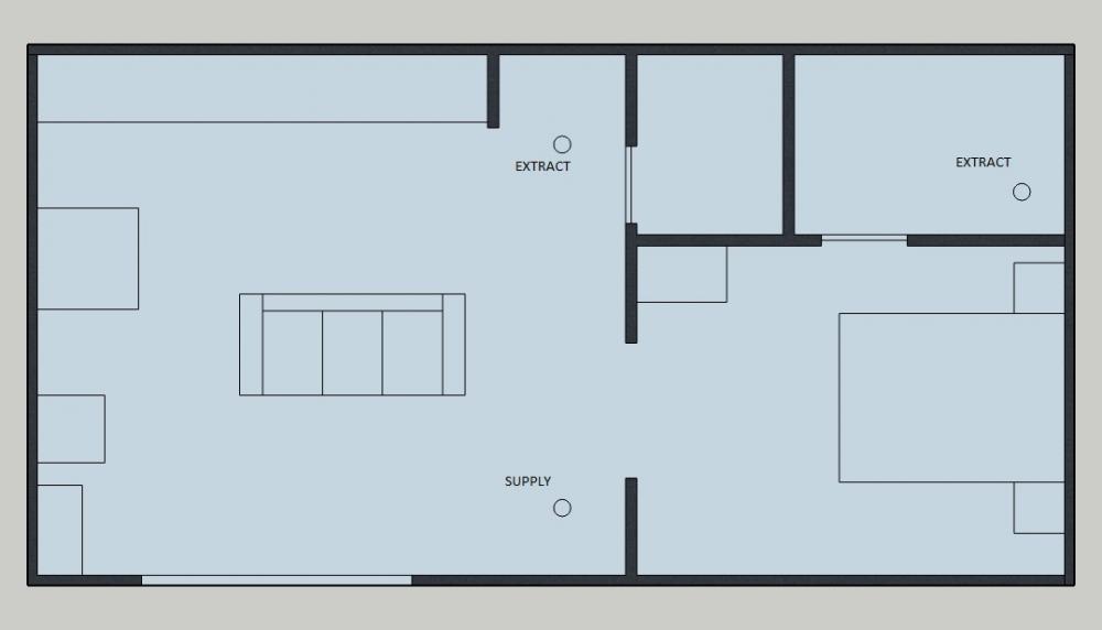

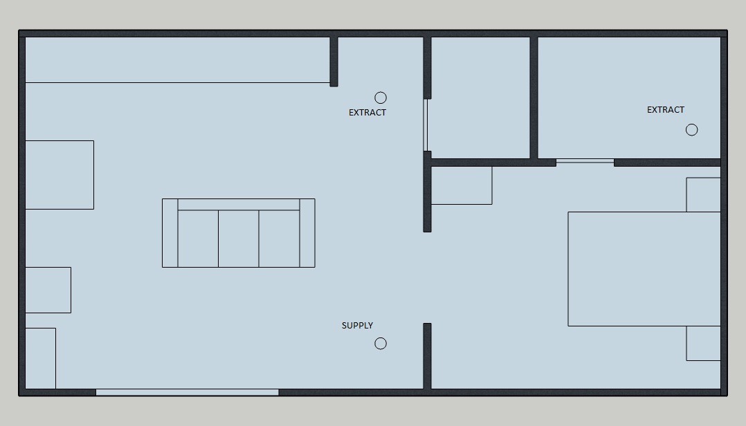

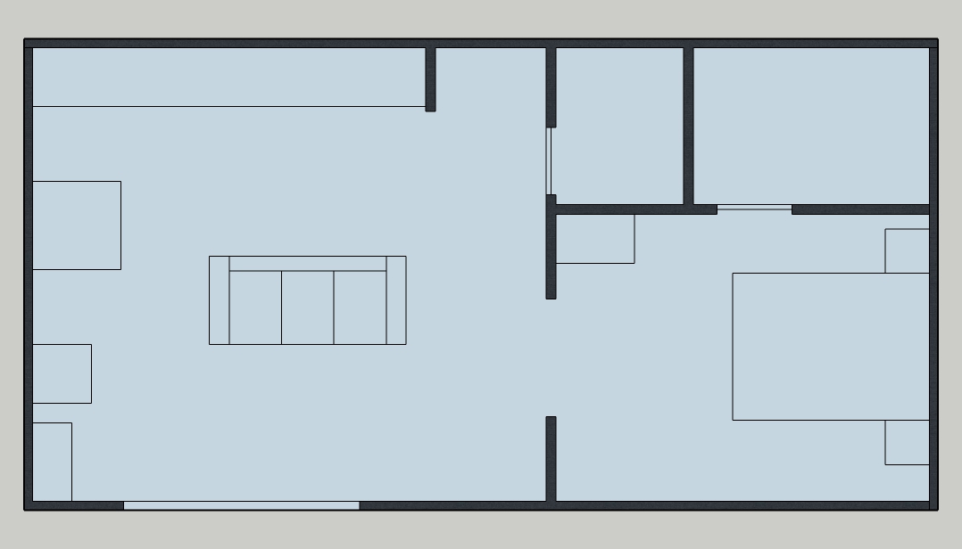

Crofter Posted February 14, 2018 Author Share Posted February 14, 2018 OK as promised, some rough sketches showing the space I have to work with. First one shows the floorplan. The main room is open to the bedroom via a double doorway- this was originally going to have french doors in it, but I have shelved that plan at least for the time being. There is a cupboard off the main room, and an en-suite off the bedroom. Second pic shows, in grey, the areas in which it is possible to fit ducts/vents for MVHR. Vaulted ceilings prevent any ducts being taken outside of these zones without recourse to ugly box outs, which would be aesthetically unacceptable. The third pic shows my proposed vent locations, with one additional extract in the warm loft space, not shown. Link to comment Share on other sites More sharing options...
Jeremy Harris Posted February 14, 2018 Share Posted February 14, 2018 You have a big "dead" air space to the left, because the air from the centre supply terminal will tend to "short circuit" across the extract duct opposite. Ideally you want a fresh air terminal in the bedroom at the bottom right in that sketch, and another in the living area in the bottom left. As you can't get them there, can you fit one at the far right centre over the bed and would it be possible to run an exposed rigid duct from the shaded area across to the extreme left? Maybe try to make it into a feature, with a bit of small section galvanised duct, the sort if industrial look? The extracts are OK where they are. 1 Link to comment Share on other sites More sharing options...

Crofter Posted February 14, 2018 Author Share Posted February 14, 2018 Thanks for the feedback Jeremy. One thing that I haven't been able to convey in the sketches is that it would be possible to put vents into the 'internal gable', which is at the left hand edge of the shaded area in the main room. This would allow vents higher up in the room, right up to the apex- but of course that brings them close to the centreline. Link to comment Share on other sites More sharing options...

Dreadnaught Posted February 14, 2018 Share Posted February 14, 2018 For the supply terminal, could you have the terminal not in the ceiling directing air from above and downwards but mounted in the internal gable and facing into the big air space to the left, located as close to the current location that you have shown in your diagram and as far as the internal gable structure would allow? Thus, could it be that the supply air could be directed into the big air space and so minimising the short circuit that Jeremy mentioned, perhaps using a special design of terminal that directs the air? I have no knowledge of MVHR ducting so disregard my idea if you wish. Link to comment Share on other sites More sharing options...
Crofter Posted February 14, 2018 Author Share Posted February 14, 2018 4 minutes ago, Dreadnaught said: For the supply terminal, could you have the terminal not in the ceiling directing air from above and downwards but mounted in the internal gable and facing into the big air space to the left, located as close to the current location that you have shown in your diagram and as far as the internal gable structure would allow? Thus, could it be that the supply air could be directed into the big air space and so minimising the short circuit that Jeremy mentioned, perhaps using a special design of terminal that directs the air? I have no knowledge of MVHR ducting so disregard my idea if you wish. I'm not sure what will work best. I had actually been thinking about putting the extract at the apex of the internal gable, as that would prevent a pocket of warm moist air gathering up there. The problem with placing vents on the internal gable is that you are reducing the space between them the higher up you go. Link to comment Share on other sites More sharing options...
Dreadnaught Posted February 14, 2018 Share Posted February 14, 2018 2 minutes ago, Crofter said: I had actually been thinking about putting the extract at the apex of the internal gable. I like your idea better than mine. Could you have the extract not at the apex but as high and far towards what I assume is the kitchen and facing towards it, and the supply as you have marked it, facing downwards, so within your constraints maximising their separation. I wonder what an MVHR designer would recommend. Link to comment Share on other sites More sharing options...

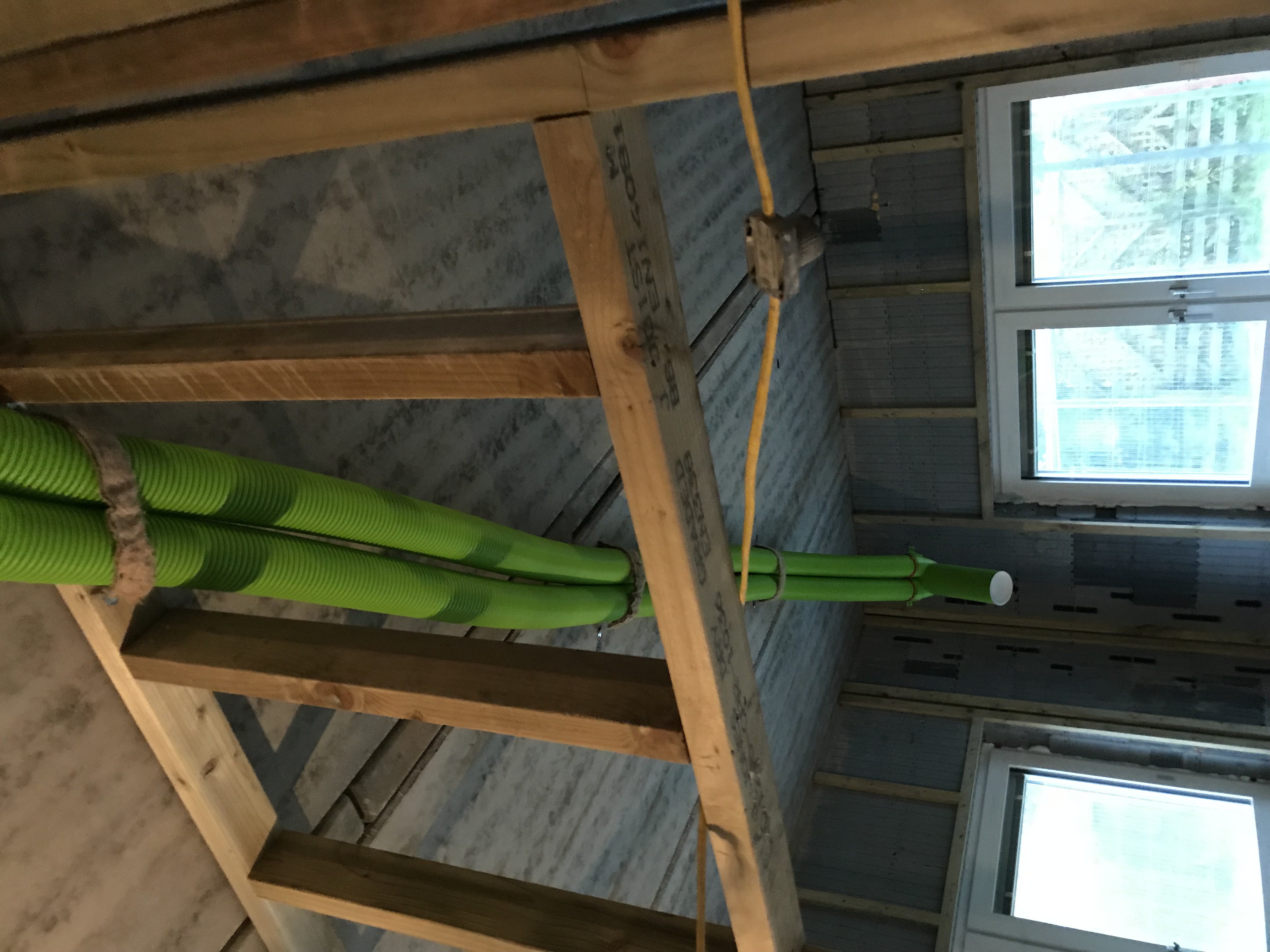

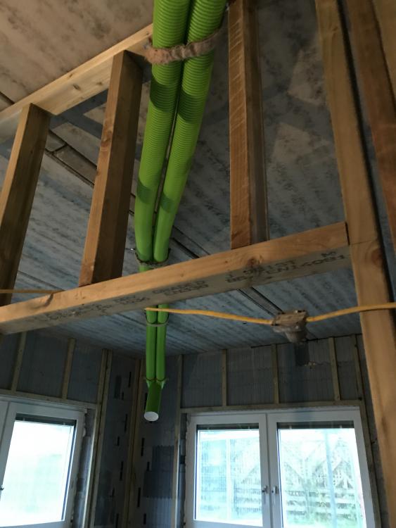

Crofter Posted April 1, 2018 Author Share Posted April 1, 2018 So, today has largely been spent clearing all the junk out of my loft space in preparation for MVHR install. I'm amazed at the amount of stuff that I had squirreled away up there, in a house that isn't even inhabited yet. Mostly packaging and various offcuts kept just in case. Anyway, it's decision time for my MVHR install. As noted in my posts above, I will have an extract near the kitchen and one above the shower. Another will go in the loft space. One supply will go in the living room. I can relatively easily add a second supply in the bedroom, but it would be directly above the head end of the bed. As MJNewton says: On 2/17/2018 at 22:07, MJNewton said: I've been wondering about how careful one must be with siting of supply terminals assuming there is a risk that moving air - even warm air - can have quite a cooling effect on people beneath/near them? I seem to recall one installation manual stating a need to avoid siting them over beds and seating areas, presumably for this reason. Could you (and/or of course any others with MVHR) comment on how 'draughty' supply terminals actually are in practice? Is this a legitimate concern? The bedroom ceiling is vaulted so the supply terminal would be nearly 12ft above floor level. Finally, is there merit in having a trickle supply in the loft space, to match the extract? Link to comment Share on other sites More sharing options...
Jeremy Harris Posted April 1, 2018 Share Posted April 1, 2018 I'd not worry about it if it's that high up. The only time it will have anything other than a barely detectable flow will be when the system is on boost, and it's unlikely to be on boost when people are sleeping. 1 1 Link to comment Share on other sites More sharing options...
