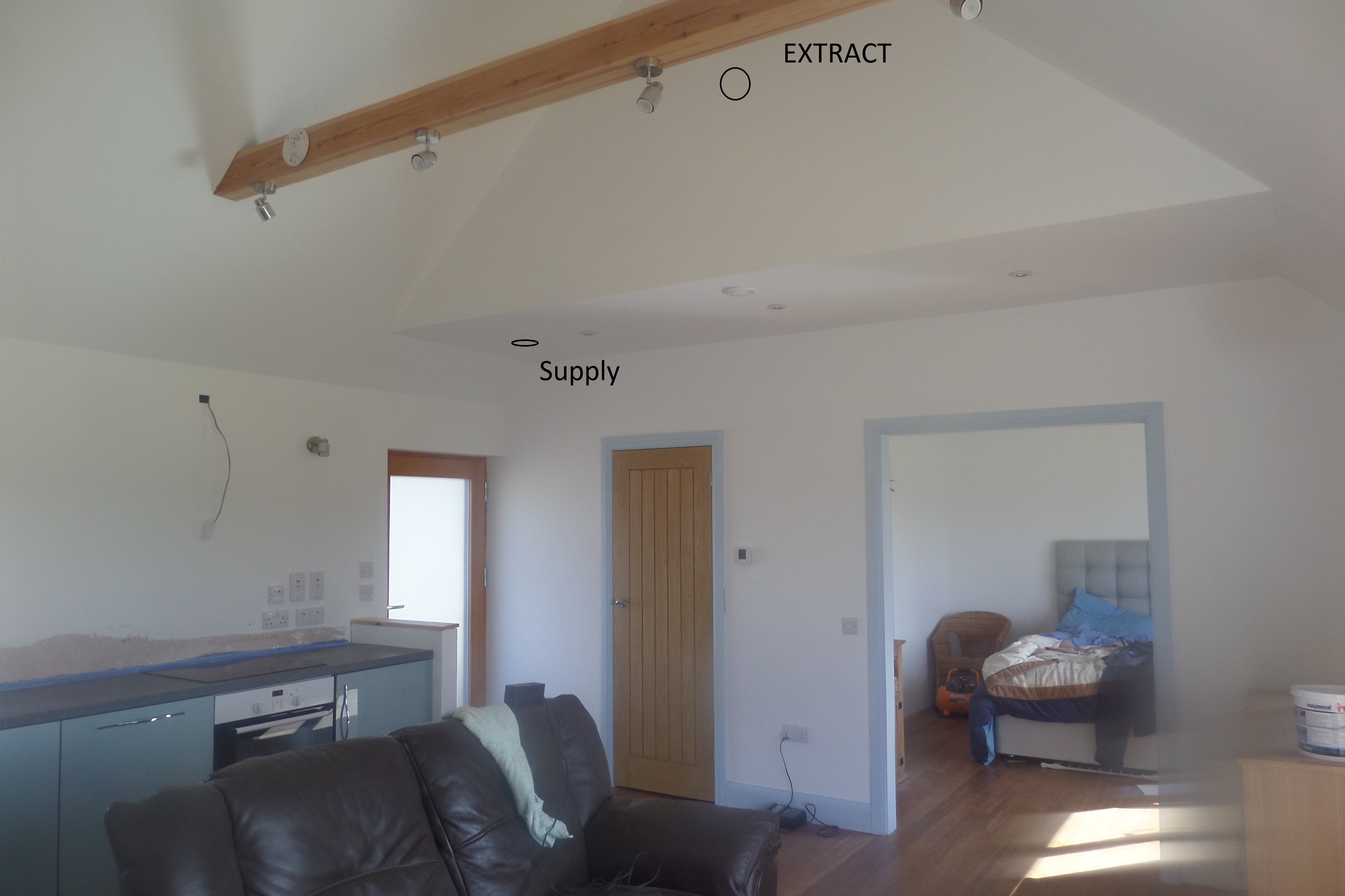

The noise has made me reconsider where I should put the vents. So my new plan is:
One extract above the shower (as previous plan)
One extract at high level in the kitchen/lounge space
One supply above the front door
If the noise proves acceptable, I would like to add a second supply above the bed, so this gives two pairs which should be easier to balance.

Only one extract (above the shower) and one supply (at the front door, about as far from the extract as possible). I'll add second extract at high level in the kitchen/lounge.
