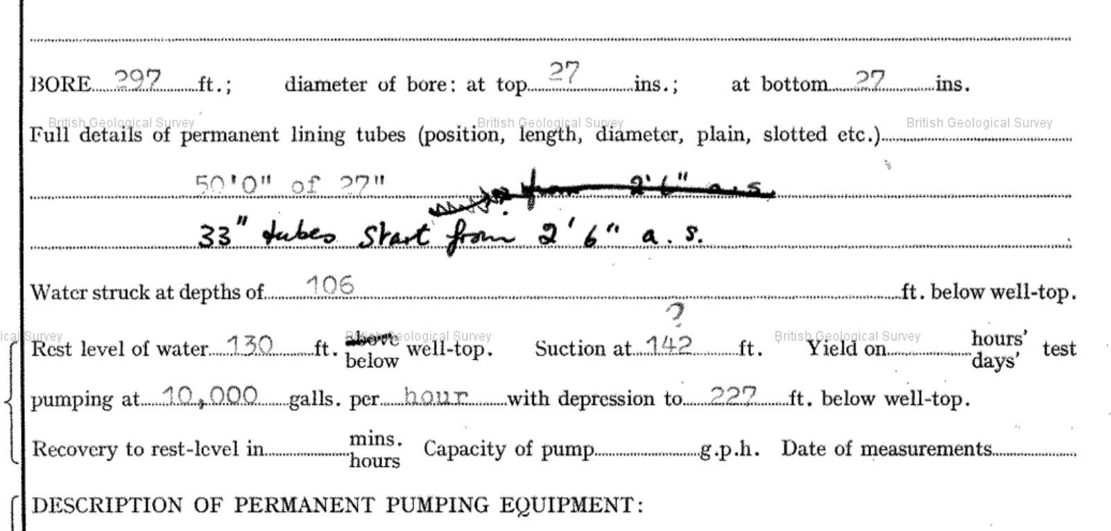

Onoff Posted October 1, 2019 Author Share Posted October 1, 2019 Ressurecting this and following on from @patp's thread I took a look at the data for the nearest borehole to me last surveyed in the 60's. No idea if these figures are "good" or not and what they'd be like now, 50/60 years on. The next borehole down, I'm literally between the two, showed similar figures. We're at the bottom of a valley and there's a few boreholes, in a line. Can't see that we wouldn't be on this water course. Link to comment Share on other sites More sharing options...
Jeremy Harris Posted October 1, 2019 Share Posted October 1, 2019 10,000 gallons per hour is massive, the most you are allowed to extract without needing an abstraction licence is 20,000 litres per day, so that has around 54 times the maximum abstraction capacity of a private borehole with no licence. It's also a big borehole, around three times the normal diameter. A normal domestic borehole would be drilled at around 200mm/8" and then be fitted with a 112mm/4" PVC liner, with a slotted section at the base to allow water in. Our borehole is 53m deep (174 ft), has a standing water level that's about 4.5m below the top, and which dropped to 11m below the top when test pumped at 1,500 litres per hour for 2 days. We use around 400 litres per day, for just the two of us. Our borehole cost (after correcting for the cock-ups) around £9,000, including the cost of the pump, filtration, pressure vessels etc. 1 Link to comment Share on other sites More sharing options...
Onoff Posted October 1, 2019 Author Share Posted October 1, 2019 @JSHarris, thanks for that. There's no g'tee I'm assuming of hitting water though is there? Happy to pm you a link to see exactly where we sit in relation to the two boreholes. How did you know you were going to hit water to make it worthwhile drilling? Based on what was around you already? Also on the old surveys there's no analysis of the water. How do you go about that / rough cost? Cheers Link to comment Share on other sites More sharing options...
Jeremy Harris Posted October 1, 2019 Share Posted October 1, 2019 15 minutes ago, Onoff said: @JSHarris, thanks for that. There's no g'tee I'm assuming of hitting water though is there? Happy to pm you a link to see exactly where we sit in relation to the two boreholes. How did you know you were going to hit water to make it worthwhile drilling? Based on what was around you already? Also on the old surveys there's no analysis of the water. How do you go about that / rough cost? Cheers I paid for a hydrogeological survey, which gave lots of useful information, and cost £250 plus VAT. The chap I used was Tim Baker, at BA Hydro Solutions http://bahsltd.com/index.htm I'd not hesitate to recommend him, as his report was really helpful. Here's a copy of it so you can see what you get for the money: Passivhaus Mill Lane Hydrogeological Assessment V3.1.pdf Link to comment Share on other sites More sharing options...
Declan52 Posted October 1, 2019 Share Posted October 1, 2019 3 hours ago, Onoff said: @JSHarris, thanks for that. There's no g'tee I'm assuming of hitting water though is there? Happy to pm you a link to see exactly where we sit in relation to the two boreholes. How did you know you were going to hit water to make it worthwhile drilling? Based on what was around you already? Also on the old surveys there's no analysis of the water. How do you go about that / rough cost? Cheers You look at old boreholes like you have done. Sometimes when you strike water its a tiny trickle that takes all day to fill the standpipe. Others it's like you have found old faithful geyser and the water hits 4/5m high and you get a free very cold shower. We hit an artesian well on a job in an underground car park in Belfast and very very nearly flooded the whole floor of the car park, about 8m depth of water. Had to be pumped out quicker than it came in which was a lot of water and then a large steel cap bolted to the floor, borehole filled with powdered bentonite to plug it and welded shut. That was a fun few days!!! Link to comment Share on other sites More sharing options...
Jeremy Harris Posted October 1, 2019 Share Posted October 1, 2019 5 hours ago, Onoff said: Also on the old surveys there's no analysis of the water. How do you go about that / rough cost? Sorry, @Onoff, missed this bit earlier. There are two ways to get an analysis done. Your local authority environmental health people have a legal obligation to provide a fixed price analysis service for domestic water supplies. The price is set by central government, and currently the charge here is set at £17.05 for a standard water analysis, which is far less than any lab will charge. In our case, because the local authority would lose money on every analysis they are asked to do, they refuse to accept samples provided by anyone other than their own staff, so they can then charge a hefty "sampling fee" of £105 on top, to push the price up to enough to cover their costs (I'm pretty sure that the people who wrote the legislation didn't intend them to do this...). Often it's cheaper to just find a local lab that will undertake water analysis and take your own samples to them. We have a lab a few miles away that accepts private samples, or there are other labs, like the one that the hydrogeologist we used has, that will either send out sample bottles to be filled and returned, or will specify the size and type of sample bottles needed. The bottle used for collecting the bacterial analysis sample has to be sterile, and there's a procedure for cleaning and disinfecting the tap that the sample is taken from as well. The really cheap option is to buy a test kit from one of the many online suppliers and do your own analysis. Not hard to do, and there are test papers available for many common water contaminants. These won't test the total hardness, though, although you can buy electronic meters for doing this (I have a collection of them, happy to lend them out if you need them). You can also buy a bacterial analysis kit online, but it's so challenging to make sure that everything is sterile when using it that I'm not convinced it's much use. A lab test is best, as this will identify specific bugs, if there are any, whereas the kits you buy online will give a positive indication for a wide range of stuff, much of which is harmless. Best of all is if you happen to know someone that can do you a favour at a very well known lab that has comprehensive analysis facilities... 1 Link to comment Share on other sites More sharing options...
