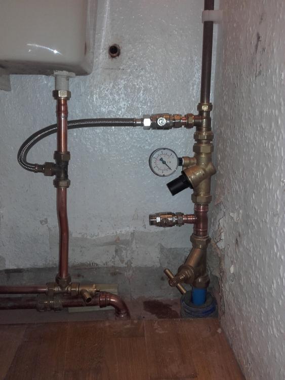

Plan this morning was to form some sort of an access chamber around the stop cock inside the fence, this being the OLD meter position.
Lucky I looked as WE HAVE ANOTHER LEAK! This is I'm guessing on the old remaining section of iron between this stop cock and the meter.
20161029_111517
Will be calling the water board shortly. Going way back they came out and changed the elbow to the iron in the picture:
SAM_0955
It was the actual black plastic elbow that was at fault back then, on the side, not even on one of the joints.
This is way back:
SAM_0959
Can't see this time that it's anything else other than the old bit of iron.
And the weekend just went! (To think I was going to finish the bathroom too..... :) )
That original 10' bit of iron between the stop cock inside the fence and the roadside meter was a tad rusty...
20161030_124758
20161030_124818
I dug out the bank by hand and laid a new bit of 25mm MDPE in, in 63mm duct.
20161030_124828
20161030_133422
Deeper and steeper than it looks that trench!
I even squared off the rough sawn end of the tube where the meter sits
20161030_121226
And found a paving slab to sit the stop cock inside the fence
20161030_133748
(YES, I know the bottom of the fence is knackered! Madam didn't want gravel boards in case in impeded the wildlife!)

What's the deal with the (light blue) fittings that attach either side of the stop cock? Are they done up hand tight, should you assemble with a bit of "paste"?
SAM_3947
The above photo is the original set up. I've just put my new, blue 25mm MDPE in reusing the fittings. Might have a weep on one! I did though tweak them up with the 5 holes.....
59 minutes ago, PeterStarck said:
Just another job to add to the list!
I'll probably lift the panels and take the (rotten) bit off the bottom then fit 300mm gravel boards anyway.
Shouldn't really need anything if the rings are intact ... if you can dry it out a quick smear of clear silicone sealant (WRAS approved of course) sho
Ta. Might be nothing, I'll check again when home. I did wonder if a smear of "gasgrease" would work?
12 minutes ago, PeterW said:
Gas Grease ..?? Would need to be something that's ok with potable water and I know Silicone doesn't react with MDPE
I only said gas grease as a nod to Nick! :)
This is the stuff I have, Jet Blue Plus; according to the bumpf for potable water and good for polyethylene which is I believe what MDPE is?
