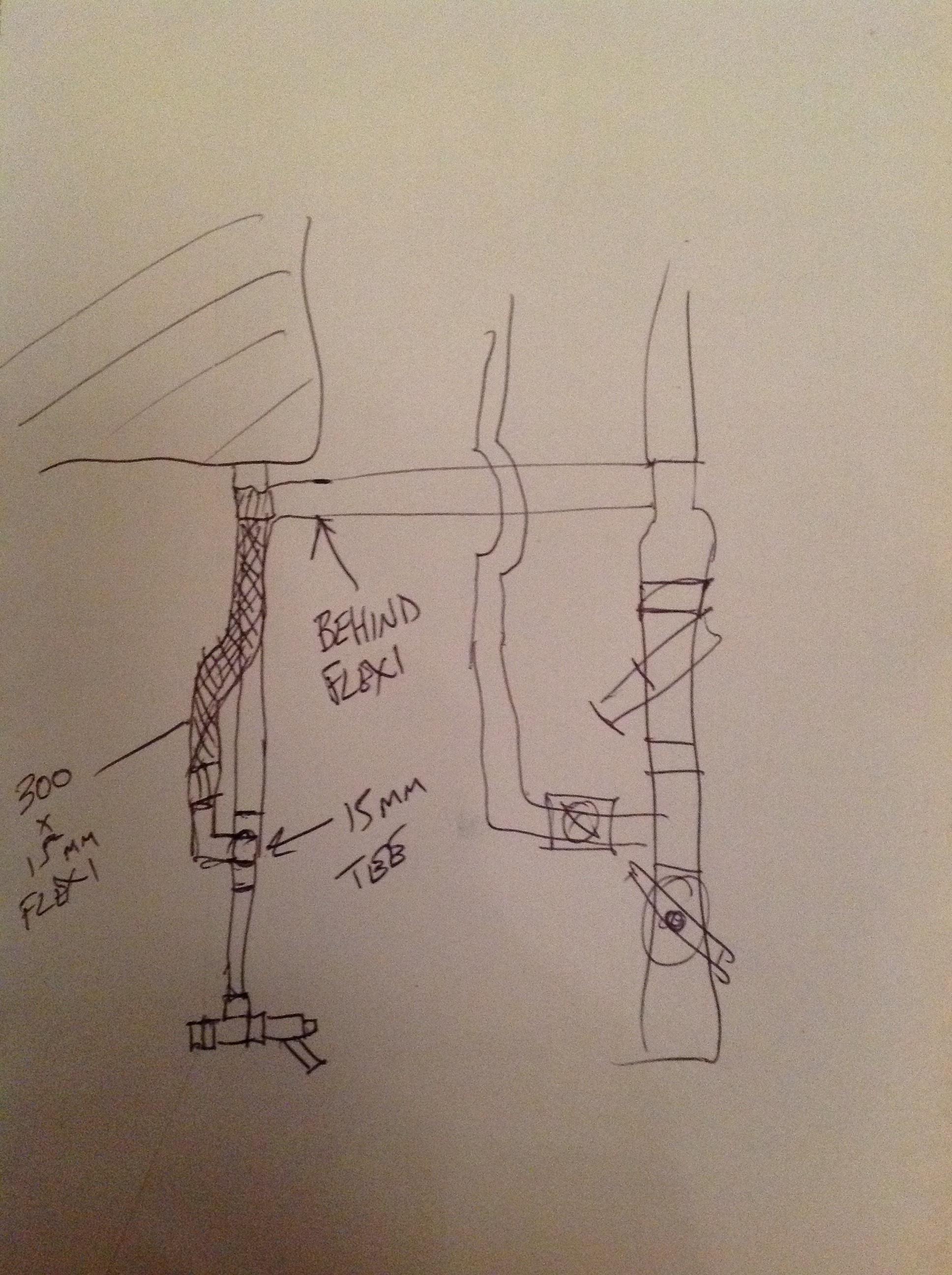

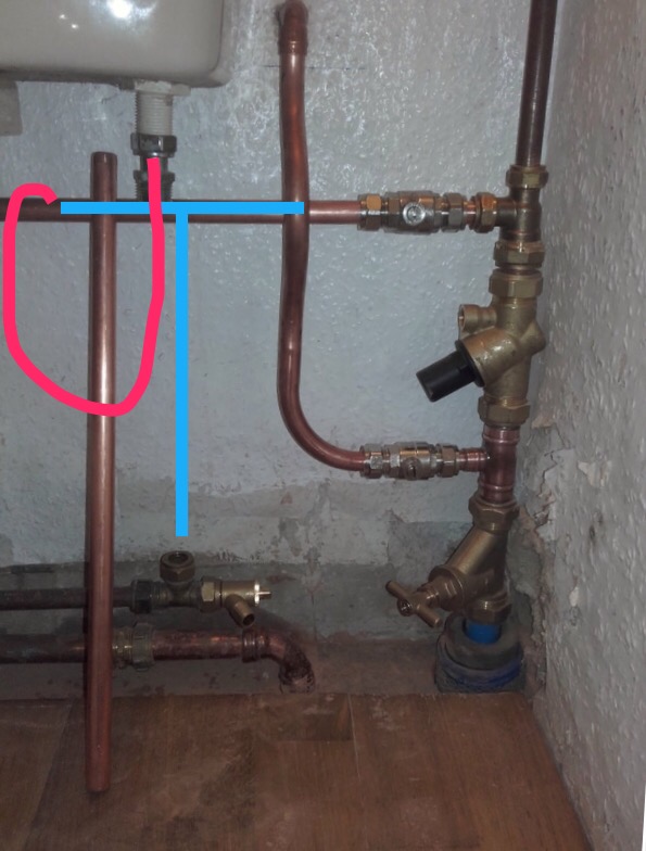

October 16, 201610 yr Author Hmm... Putting this lot in and tbh I thought this might be an issue. On the right, first then I've the stop cock on the MDPE, then a tee off to the outside tap via an isolator. Next comes the PRV with a tee above to feed the cistern and cloak basin. BUT.....the horizontal tee off to the cistern puts the 15mm pipe too high to practically connect to the cistern and then drop to the tee with the drain dock on: At the mo I've the chrome tap connector on the cistern pipe. Any suggestions? Cheers
October 16, 201610 yr Take the feed for the cloakroom branch behind the cistern inlet and vertically straight down to the compression tee and DOC. 300mm or so down that vertical drop put a 15mm tee and an M&F 15 bend facing vertically and connect that to a flexi. Take the flexi and use that to feed the cistern and open an 4-pack. Pic here shows the tee turned sideways for illustration ( if you can call it that ) but I'd put it forward facing so the two pipes are one in front of the other. Use a ballofix flexi so you have isolation for the wc. Fit the flexi forts and that'll tell you where to cut into the vertical 15mm pipe. Drawing done whilst making fish fingers for 4 gannet-esque kids so please be gentle.
October 16, 201610 yr Author Cheers. Effing fiddly this plumbing lark! Not sure what size the "tap" connector is on the bottom of the cistern. It measures 21mm across the threads and a 24mm spanner fits? 15mm x 1/2" or 15mm x 3/4"? Thinking I might just be able to get an end feed, solder ring tap connector on and then a tee underneath.

October 16, 201610 yr +1 to what @Nickfromwales said about using the flexi as they are much more forgiving. If that cistern is coming out in the future then you will need some movement around where the next one connects. If it was me I would drop a straight leg into the pipe along the bottom of the wall and extend out to the left and then use a flexi off that - gives you the choice when you replace for either a left or right hand fill.
October 16, 201610 yr Author 1 minute ago, PeterW said: +1 to what @Nickfromwales said about using the flexi as they are much more forgiving. If that cistern is coming out in the future then you will need some movement around where the next one connects. If it was me I would drop a straight leg into the pipe along the bottom of the wall and extend out to the left and then use a flexi off that - gives you the choice when you replace for either a left or right hand fill. I spent ages on that saddle bend! It'll look lost
October 16, 201610 yr 2 minutes ago, Onoff said: I spent ages on that saddle bend! It'll look lost Nah..!! Dodgy iPhone edit but something like this

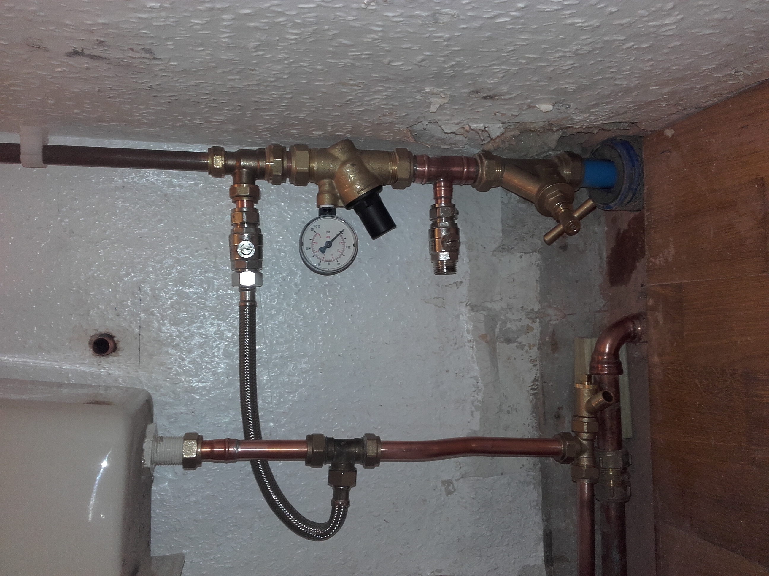

October 17, 201610 yr Author Bit the bullet and went with a flexi. I assume they're OK straight into the compression T / isolator valve. Btw the isolators are Pegler half decent ones. I'll sort the outside tap tomorrow. Bit miffed with the PRV gauge as its all plastic rather than brass as shown on the Sfix site. Needed some PTFE tape in the threads to get it tight. All nutted up now so a bit straighter.
October 17, 201610 yr That's not what was in my uber crap drawing . The flexi going straight onto the compression fitting isn't cricket I'm afraid. Is this a temporary arrangement until the framed WC goes in ?
October 17, 201610 yr Author 6 hours ago, Nickfromwales said: That's not what was in my uber crap drawing . The flexi going straight onto the compression fitting isn't cricket I'm afraid. Is this a temporary arrangement until the framed WC goes in? Erm.....you know my "temporary"! Tbh probably won't use the spare Geberit frame here or at least just yet. This WC is at the end of a narrow corridor that's been formed by hiving off a strip from the downstairs bedroom. Its not been done well either to my mind. Long term plan is to widen the corridor slightly and make an en suite shower room. So although the WC will be roughly where it is now it won't be exact. Back to me connecting the flexis like this...why not? Is it that the rubber washer doesn't seat properly on the compression fitting faces? Cheers EDIT: What was I thinking! I'll ditch this flexi and fit a compression one with short bits of pipe in the fittings. Edited October 18, 201610 yr by Onoff
October 18, 201610 yr You should have a flat faced copper to iron ( 15x1/2 male ) and the female end of the flexi turns onto that. Did you misinterpret my drawing or did you just freestyle it ? The nut and olive side of the flexi should have been teed into the vertical drop and made off to copper pipe leaving the flexi end to go straight onto the cistern inlet / stem. I leave you alone for 5 minutes..........

October 18, 201610 yr Honesty is the best policy The only thing that will let you down is that rubber seal onto the compression tee. I had a few let me down in my 'early years' and don't risk it anymore.
October 18, 201610 yr Author And the crowd goes wild as Onoff finishes something.....(nearly)! A little off piste to the suggestions but it puts the isolators in line. Fascinating watching the PRV going up and down! Cheers all. EDIT: Just got to screw the tap on outside. Edited October 18, 201610 yr by Onoff
October 18, 201610 yr Author Bugger! The 25mm MDPE to the stopcock is leaking a tad. Yes there's an insert in the pipe, yes the olive (metal) that came with the stopcock is on the pipe. Doing it up and it's starting to squeak.....
