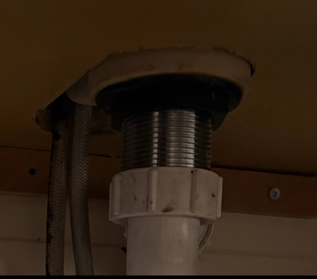

Plug broken so doesn’t work properly but unfortunately it’s been pushed down a bit too far, absolutely no idea how to get it out - any ideas appreciated!

Go from underneath take the u bend off to get access.
Yeah I assumed that, take it off and just push it all up?
Or just unscrew the whole metal piece and replace with new assembly - you seem to find spares for this stuff
Can’t seem to get the mechanism out. Haven’t got a spanner big enough to loosen the black bit - any ideas?
Once I’ve got that loose, should the whole mechanism come out fairly easily?
I think if you unscrew the white waste pipe - which you should be able to do by hand - you may be able to get to the waste from underneath.  Failing that, you may need to replace the waste.  Is it a clicker one?

Yeah clicker one. Took the waste off but couldn’t get to it, argh!

If you can turn the push down plug bit it can be unscrewed to change the push bit. A suction cup might pull it up if it's strong enough?

Managed to get the plug clicker out. Reinstalled but getting very slight dripping from the black bit, just seeping out. Any ideas why? It’s super tight
Washer is shot?
New washer and or plumber's gunk (thread compound that does not harden) on it and the thread.
Pack on top and under the washer with say Sikaflex, BT1 etc. Push the trap down into it until it squidges out but DO NOT let it turn as you tighten the black nut. Wipe the excess off with the cheapest, unscented baby wipes and leave to set.
The washer is cross threaded, either a new washer or what they said above.

I guess we should consider mention the leaking, rotten flexi's feeding hot and cold into the mono-block mixer tap.
43 minutes ago, Nickfromwales said:
Well spotted.
Yes that's well spotted too, I did see but ignored them.

Nick's last point is the one I would not leave alone. Those flexis in the photo look tired, and once they start weeping at the braid they can fail without much warning, so I would swap them while you already have the waste apart. It is a small job compared with a cabinet floor soaked through, and it is worth checking the board under the sink for any soft spots while you are in there.
