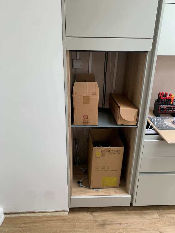

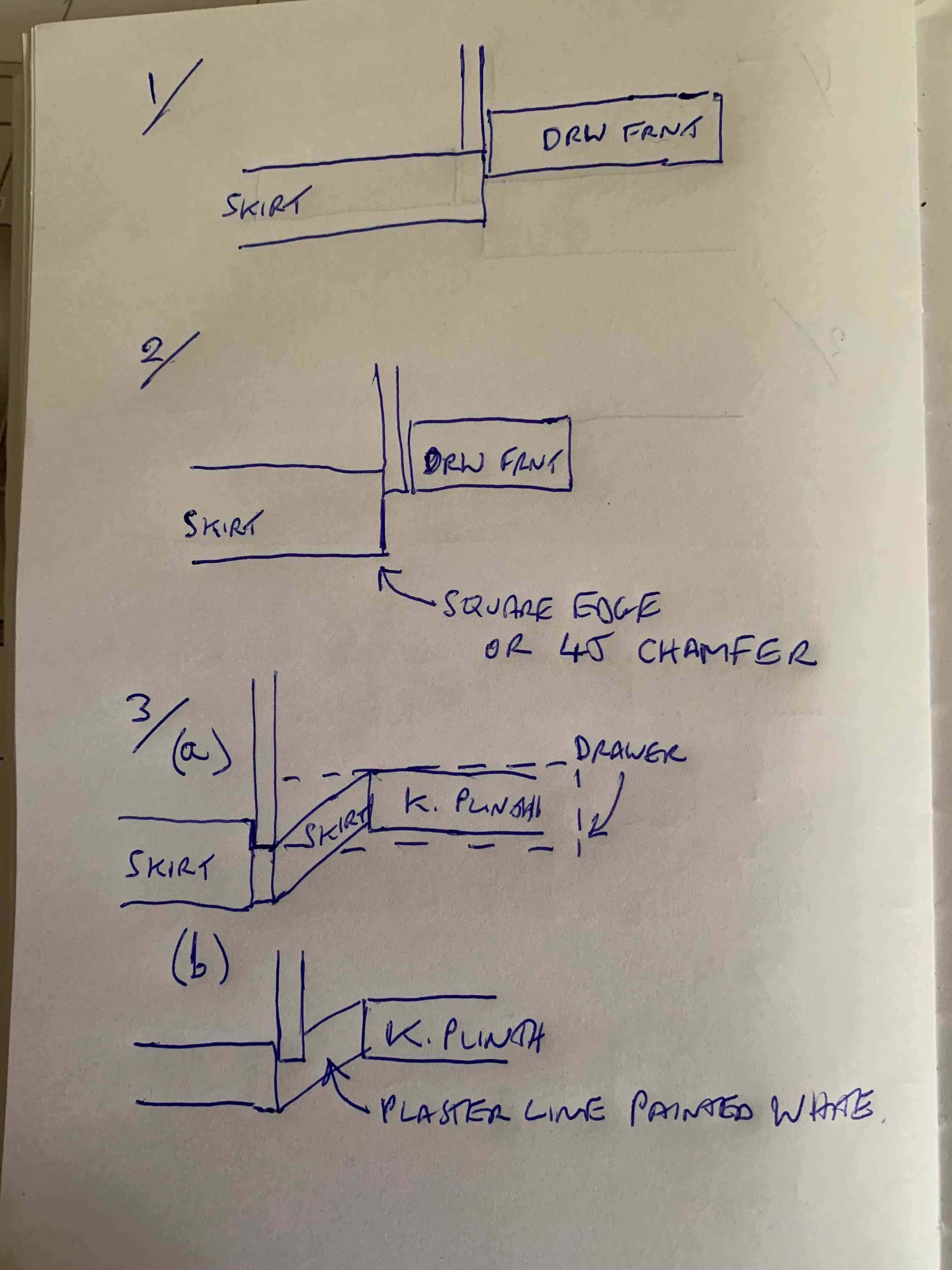

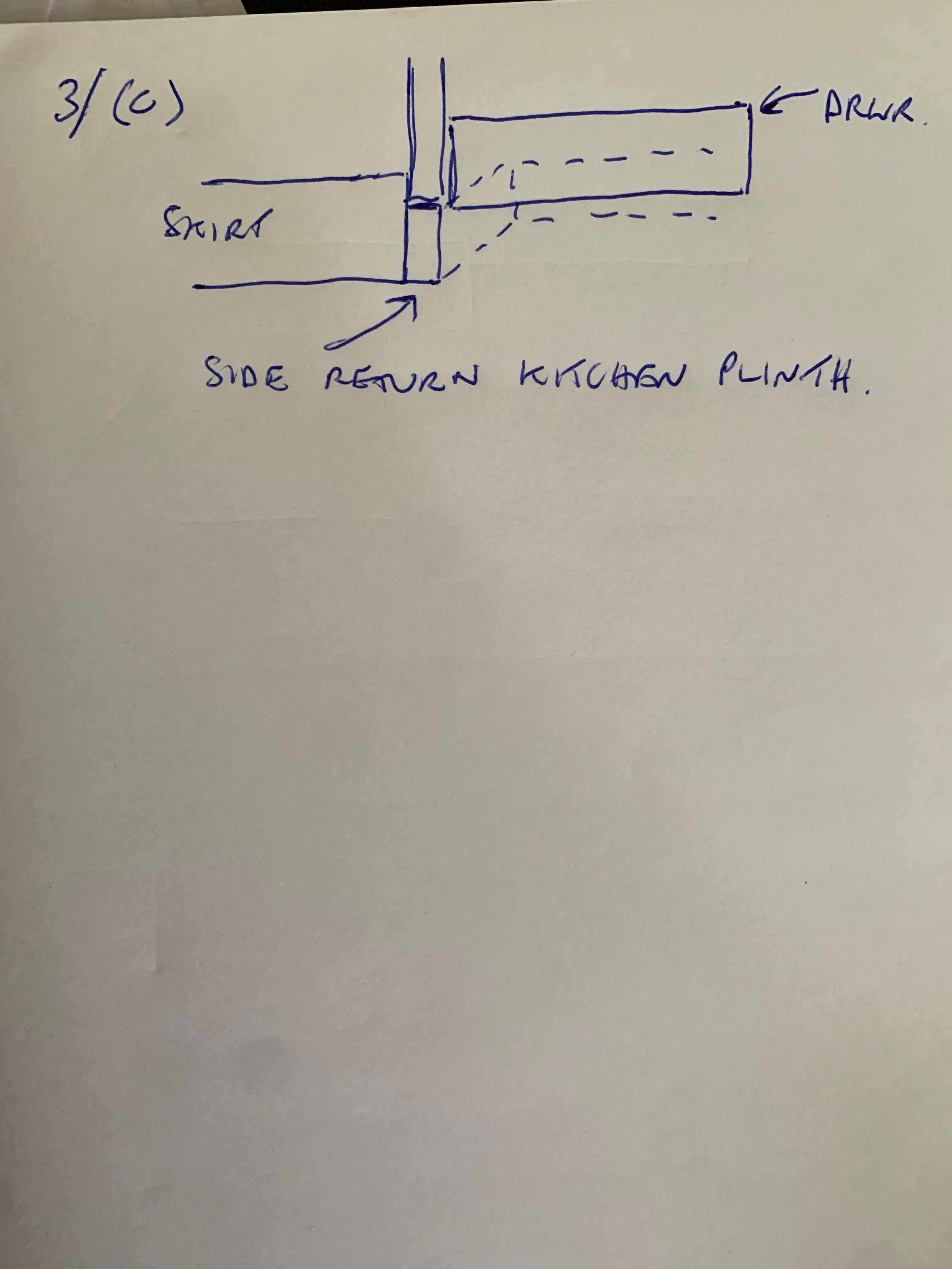

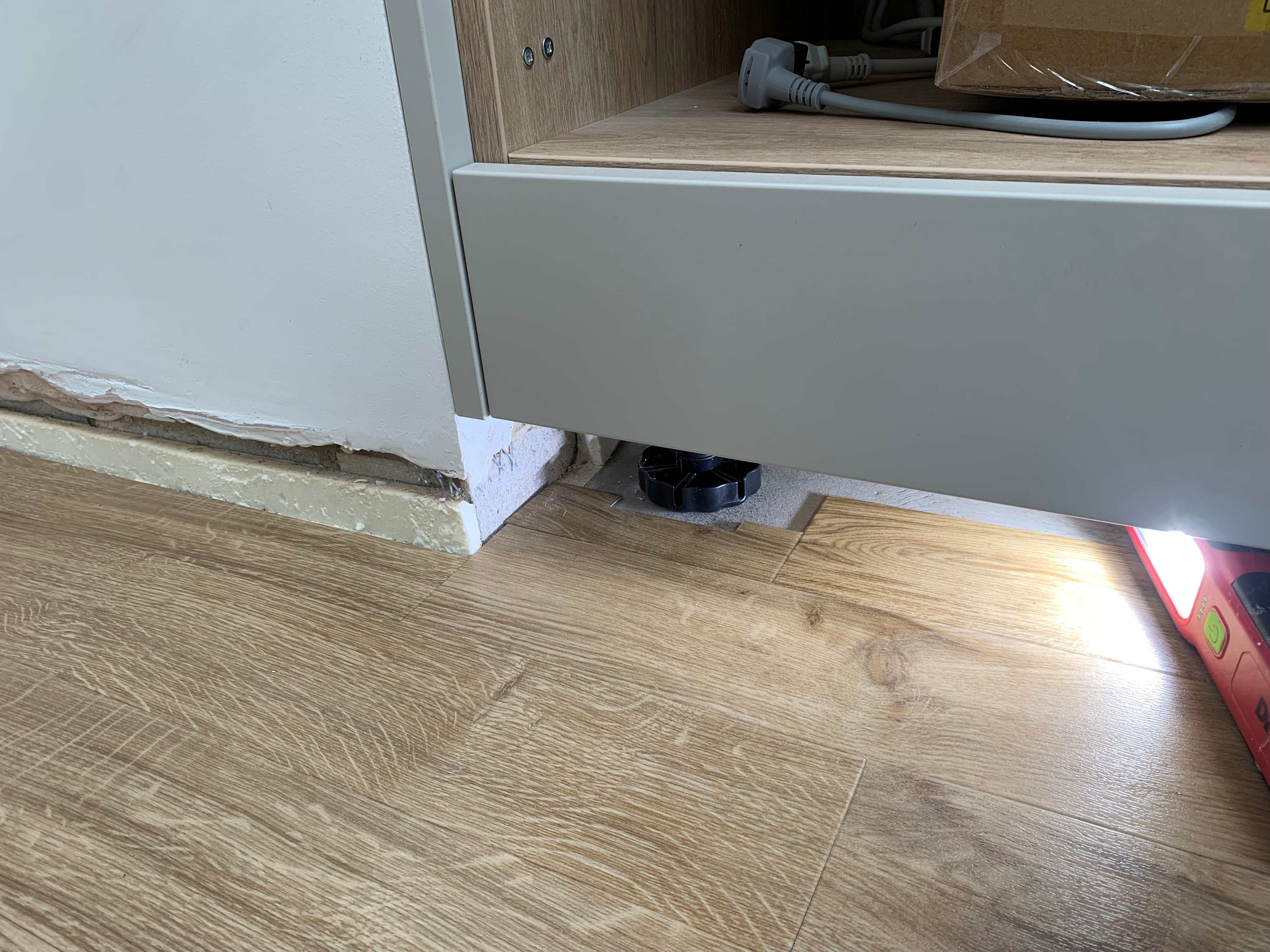

Spinny Posted 6 hours ago Posted 6 hours ago (edited) Any experience and suggestions on how this bit of my kitchen fit should get finished ? See pics. The bottom of the vertical kitchen end panel which is edge-on is 90mm above the floor. The adjacent kitchen horizontal panel at the bottom is a 'push-to-open' drawer. I am expecting to fit 100mm skirting to the adjacent wall and the skirting will be painted white. The kitchen fitter is returning shortly and will fit the kitchen plinth. 1/ Fitting the skirting to extend and run over the top of the edge-on kitchen panel seems wrong. It will not match the bottom of the drawer front in height, the kitchen panel is designed to edge the kitchen drawer - just as it edges cupboard doors higher up. 2/ Finishing the skirting at the corner of the wall seems best, but if so should it be finished square, or with a chamfer at 45 deg ? 3/ What should happen below the edge-on kitchen panel ? (a) Wrap white skirting around but cut the height down to fit under the kitchen panel with some weird joining detail ? (b) Fill/plaster the side wall just under the edge-on kitchen panel following the plaster line down, and paint white as far back as the kitchen plinth when fitted ? (c) Get the fitter to make a 'side return' to the kitchen plinth, so that there is a short piece of plinth between the bottom of the kitchen panel and the floor (effectively extending the bottom of the kitchen panel down to the floor with a join line. This type of join between wall and cabinetry seems like a common occurence - do you have one ? how is it finished ? Many thanks for any and all responses. (PS I am suspicious that the end panel should actually have been run right down to floor level ? Is this what other people have ? My kitchen had some missing panels when they came to fit and they repositioned some long vertical panels in order to get most of the fit done. So not sure if this has changed this detail without admitting it ?) Edited 6 hours ago by Spinny
Mr Punter Posted 3 hours ago Posted 3 hours ago I think stop the skirting at the end of the plaster and cut a 45 back to the wall to account for any skirting profile. Finish the bit on the left of the kitchen unit with filler and paint and fit the plinth as normal. You already have the gap thing going on between units (I assume for handleless), so don't make it look more complicated.
