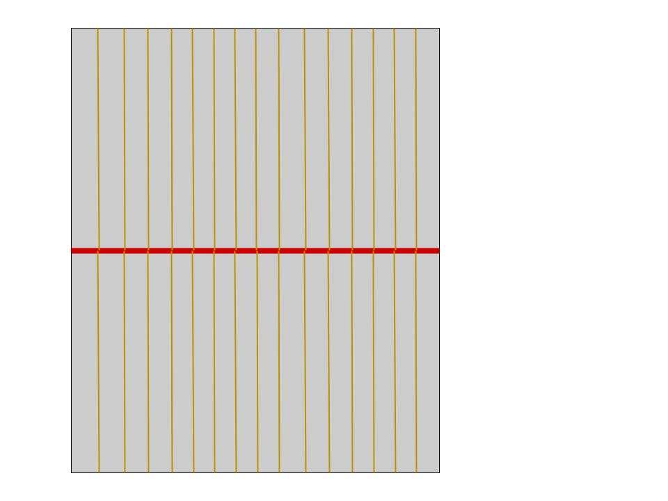

BotusBuild Posted August 18 Posted August 18 The new garage being built with ICF walls has an internal floor dimensions of about 5m x 6m, with the single pitch (flattish) roof sloping from one 6m side to the other. My current plan is to put in a central 5.5m(ish) beam with joists at right angles (~3m each). Q. Glulam or steel for the central 5.5m beam?

BotusBuild Posted August 18 Author Posted August 18 A quick bit of research show the Glulam to be about £50-70 cheaper, but would as @Mr Punter says would be deeper. For clarity, this is an approximation of the proposed layout described above (ignore the uneven spacing of the 3m joists)

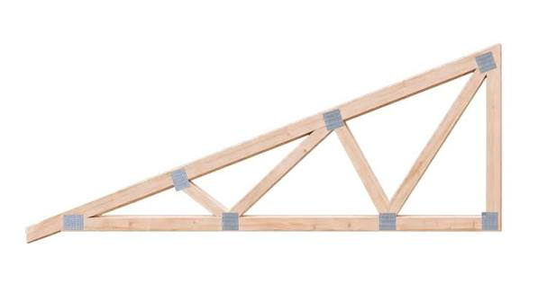

Tony L Posted August 18 Posted August 18 I don't have the same expertise as the other contributors to this thread, but I'd have thought buying in some ready made trusses, to give a low angle dual pitch roof would be the best solution. If you tell the truss company what your roof finish will be, they'll work out the truss spec' for you.

Gus Potter Posted August 19 Posted August 19 Here is the roof plan. I've screen shotted it, you won't be able to read the detail but can see the shape. Each cold formed cee was a different size, but cf providers can handle it provided you give them a schedule. All for £1552.00! The schedule looks like this, but if the walls are parallel then it is much simpler as all the cees are the same length. On 18/08/2026 at 10:23, BotusBuild said: The new garage being built with ICF walls has an internal floor dimensions of about 5m x 6m, with the single pitch (flattish) roof sloping from one 6m side to the other. I would explore using cold formed joists, creating the fall can be really easy!

JohnMo Posted August 21 Posted August 21 On 19/08/2026 at 08:19, BotusBuild said: Yes So you don't have a flat roof. You could have made life easier doing the walls flat at the top and then a single angle truss, made to suit you low angle, so no steel or glulam needed
BotusBuild Posted August 21 Author Posted August 21 But then I wouldn't have had the headroom I wanted inside
