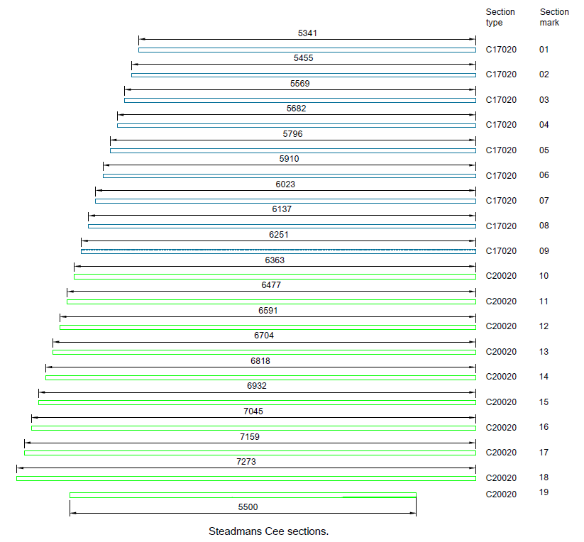

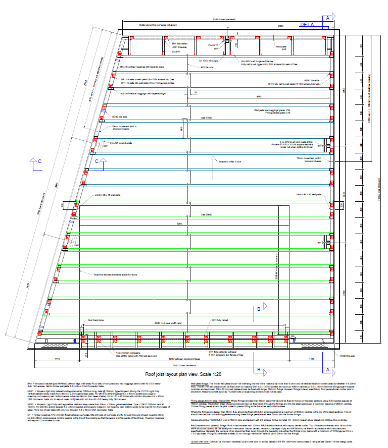

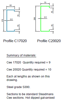

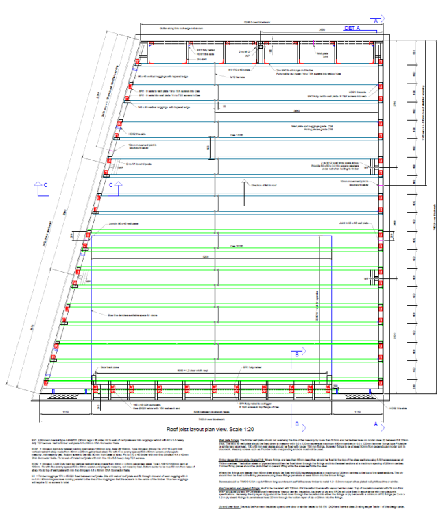

Here is the roof plan. I've screen shotted it, you won't be able to read the detail but can see the shape. Each cold formed cee was a different size, but cf providers can handle it provided you give them a schedule. All for £1552.00!
Thanks mods for removing my drawings with the Client info, you have saved the day at my end! Reposted below, redacted:
