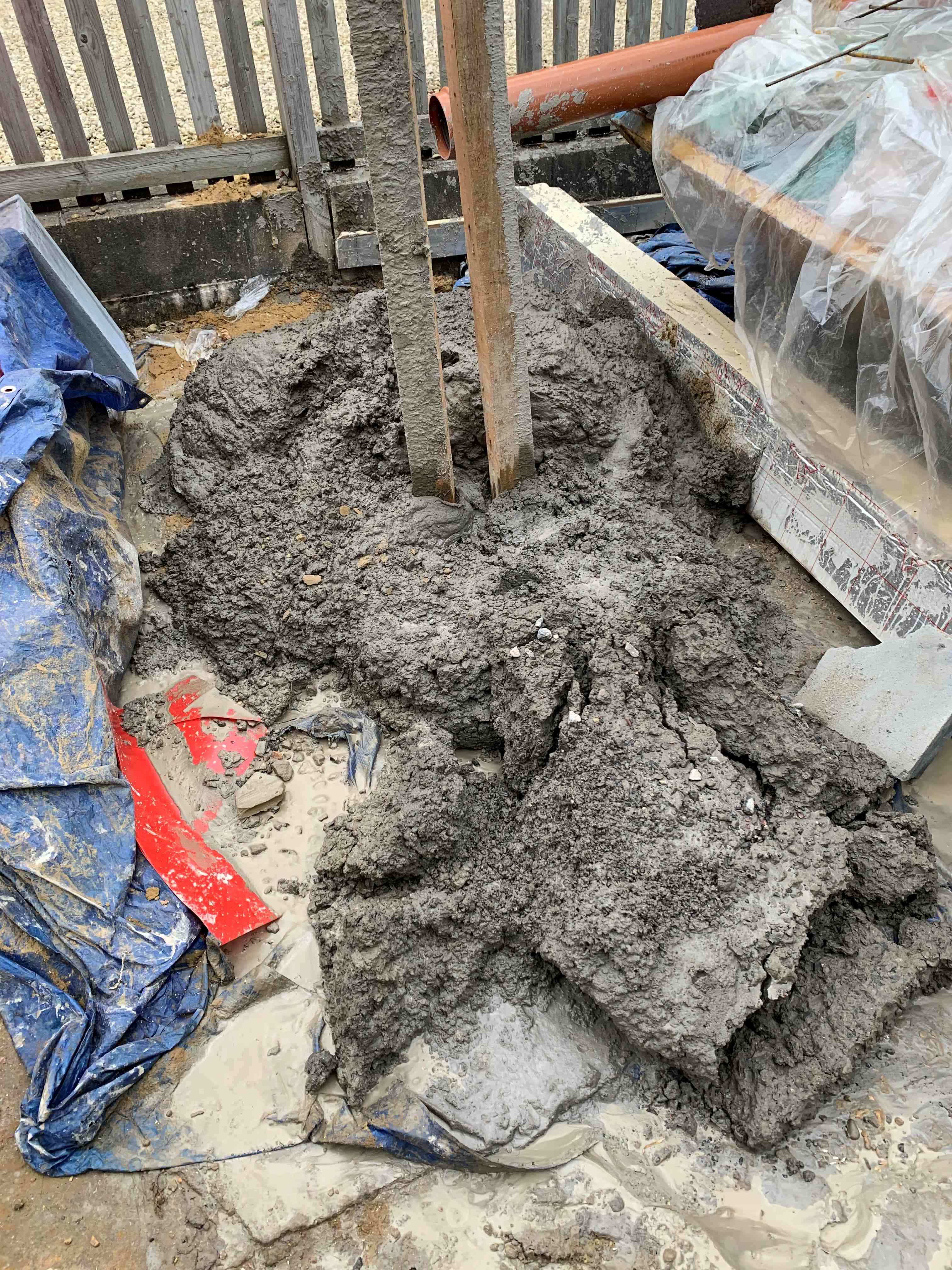

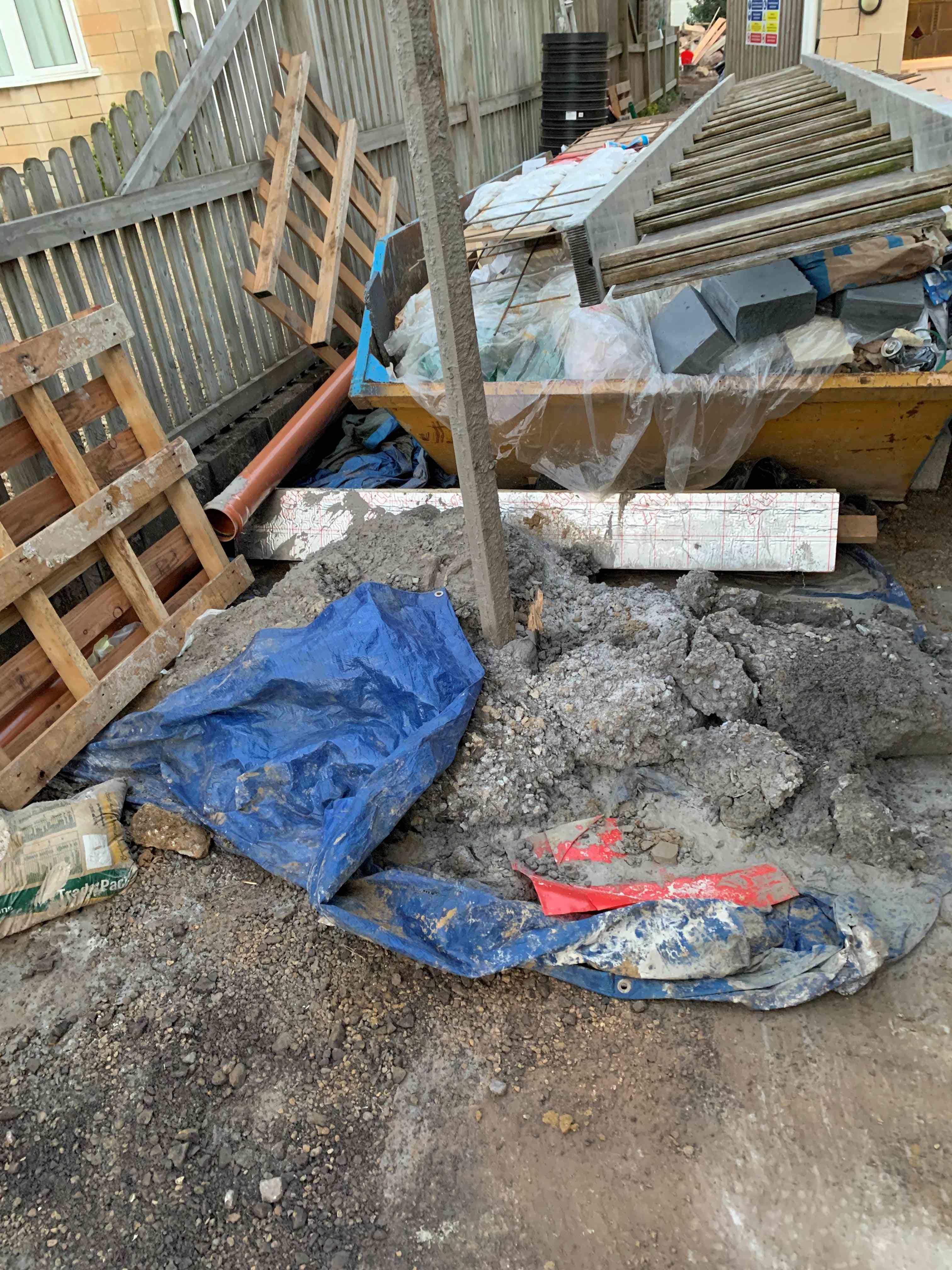

I made sure the washout area was a spot that would be later paved / concreted over. Each time there was a dump of concrete or cement, I'd rake it out flat and level. Ended up covering a good 20m²+ and 100mm+ thick by the time we were done. Concrete pumps produce a lot of waste!
We had huge pumping lorry 4 times, so a lot of wash water and unused concrete. Basically got it dumped on our driveway, then broke up before it fully set where it was bit thick. All of it is under our drive way.

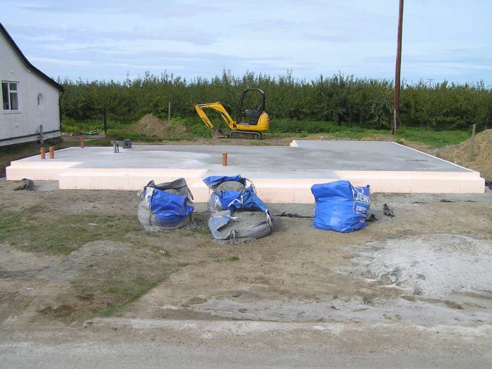

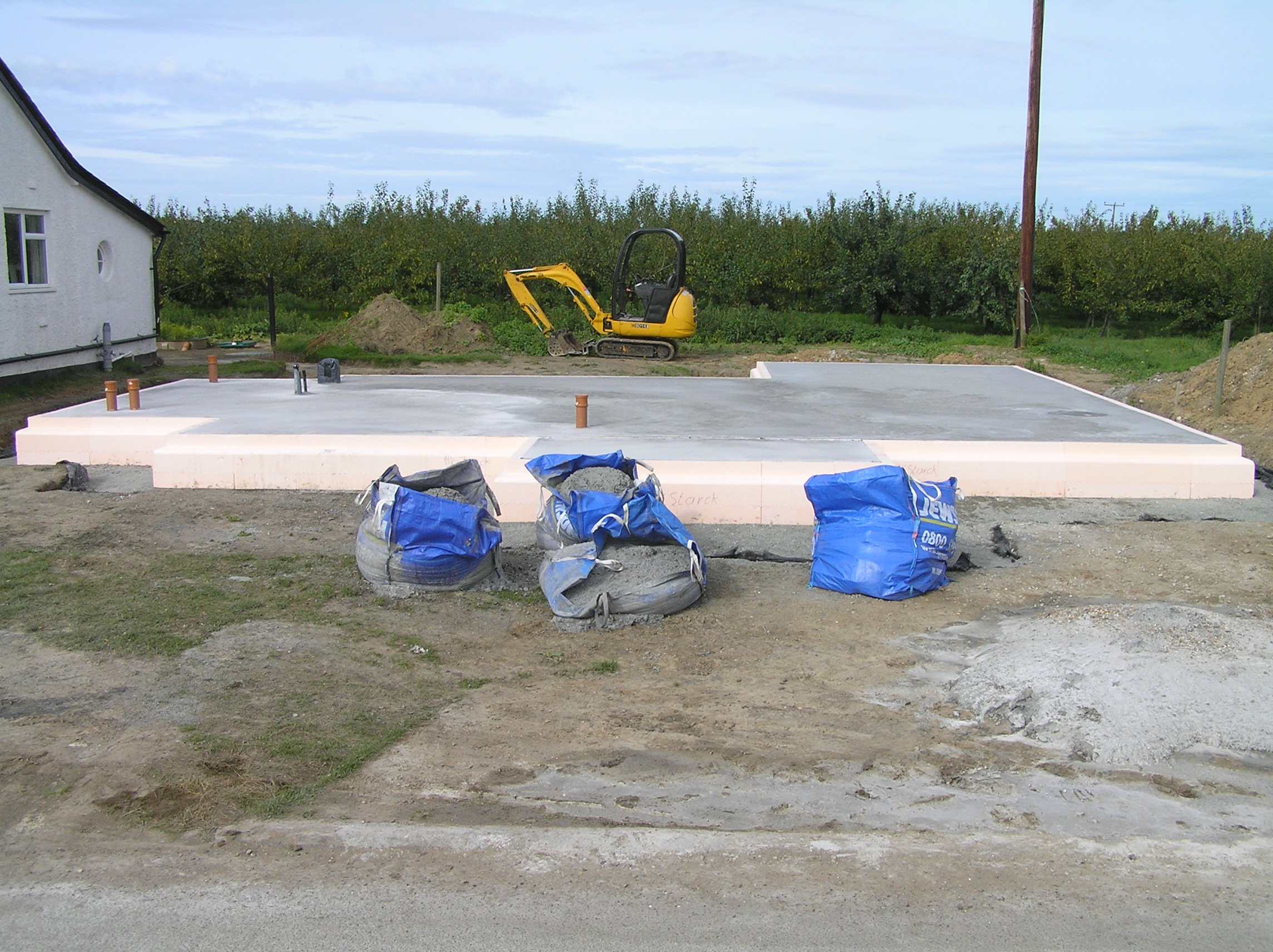

We just used bulk bags, which all the excess concrete and washout went into. Excess water drained out of the bottom.
18 minutes ago, Gone West said:
bulk bags,
Great idea. Did you deliberately make the leftovers ultra wet to avoid  a solid lump?
No, the team laying the concrete asked where they could put the excess and washout, and we had bulk bags lying around. There wasn't that much really.
Then you broke up the concrete for hardcore?
I wish we could return the big bags and they were recycled. Or the material didn't turn to plastic dust if you try to reuse them.
