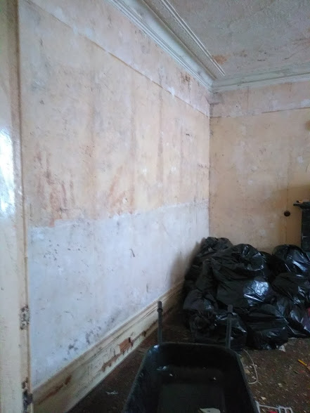

Simplysimon Posted February 14, 2018 Posted February 14, 2018 it ain't woodworm, they can't suck it that dry! is there any mycelium ( long white stands) or rusty dust? it does look like dry rot, what condition is the floor in? any bounce in the floor if the boards are running parallel to that wall? 1
Yzzy Posted February 14, 2018 Author Posted February 14, 2018 12 minutes ago, Simplysimon said: it ain't woodworm, they can't suck it that dry! is there any mycelium ( long white stands) or rusty dust? it does look like dry rot, what condition is the floor in? any bounce in the floor if the boards are running parallel to that wall? Floor has MDF on it from what I've seen, will investigate tomorrow once I get all the rubbish sacks out and video again.... me bouncing up and down on it !! ... Any of the mold where? On the skirting or anywhere in the house ... only there is a whole host of colours and variations of mold about the house

Yzzy Posted February 14, 2018 Author Posted February 14, 2018 (edited) Yes it will be the hoarded shite for years..... the wall in question had a huge wall unit against it for almost 40 years, Daddy used to go in to the room and gas heater heat it to buggery while playing music, smoking etc with his friends and then during the day it was left un-heated... no central heating in the house. So I suspect it might be that.... please!!! lol cant see any pattern on the wall of the mold though... There was on other walls in the kitchen for example.. I thought it was some plant roots that had travelled from the plant pots she suspended on the walls!!! This is the room and the wall above the skirting.... I have no idea why half the wall is different... Edited February 14, 2018 by Vision Of Heaven
Onoff Posted February 14, 2018 Posted February 14, 2018 I'd be looking under the floor. Can 'o worms maybe! Looks like that wall has maybe repaired before... 1

Hecateh Posted February 14, 2018 Posted February 14, 2018 (edited) 1 hour ago, Vision Of Heaven said: Yes it will be the hoarded shite for years..... the wall in question had a huge wall unit against it for almost 40 years, Daddy used to go in to the room and gas heater heat it to buggery while playing music, smoking etc with his friends and then during the day it was left un-heated... no central heating in the house. So I suspect it might be that.... please!!! lol cant see any pattern on the wall of the mold though... There was on other walls in the kitchen for example.. I thought it was some plant roots that had travelled from the plant pots she suspended on the walls!!! This is the room and the wall above the skirting.... I have no idea why half the wall is different... The line being the position of a dado rail 1 hour ago, Vision Of Heaven said: That looks like my parent's place - 30's house, Above the line had had simple wallpaper below had had heavy duty paper that was painted repeatedly with gloss paint Edited February 14, 2018 by Hecateh
Yzzy Posted February 15, 2018 Author Posted February 15, 2018 This is totally different cement though and only on that wall... I am wondering if there had already been a dry rot issue there and it wasn't dealt with correctly ... The hallway has glossed over wallpaper... it's so weird! Why did people gloss walls??
Ferdinand Posted February 15, 2018 Posted February 15, 2018 12 minutes ago, Vision Of Heaven said: This is totally different cement though and only on that wall... I am wondering if there had already been a dry rot issue there and it wasn't dealt with correctly ... The hallway has glossed over wallpaper... it's so weird! Why did people gloss walls?? Easier to clean with perhaps smoke :-). 1
Hecateh Posted February 15, 2018 Posted February 15, 2018 32 minutes ago, Vision Of Heaven said: This is totally different cement though and only on that wall... I am wondering if there had already been a dry rot issue there and it wasn't dealt with correctly ... The hallway has glossed over wallpaper... it's so weird! Why did people gloss walls?? 19 minutes ago, Ferdinand said: Easier to clean with perhaps smoke :-). Protection against the ravages of 7 kids.

Onoff Posted February 15, 2018 Posted February 15, 2018 Have you got suspended wooden floors downstairs? Well worth looking to see if the airbricks have been covered over /compromised. Also if you've had some dodgy extension on there in the past it might have interrupted the "by design" airflow under the house and left it inadequately ventilated. Are you in a position to do it up to a minimum, saleable standard and then flog it to some mug who likes a challenge? Put the money towards a low energy self build. I appreciate the sentimental attachment. Our place the wife was born in then by an odd sequence of events we bought it 40 years later. The size of the mortgage isn't worth the grief I sometimes think. Everything is failing. I'd have honestly been better off setting fire to £20 notes. I don't think our kids will thank us if it becomes theirs. 1

Jeremy Harris Posted February 15, 2018 Posted February 15, 2018 The video looks very like wet rot hyphae to me. Compare with these photos: Dry rot does something similar, but looks a bit different, with white hyphae: The good news is that wet rot is generally easier to treat, the bad news is that the floors are going to have to come up for sure, to see what's under there. 1
Onoff Posted February 15, 2018 Posted February 15, 2018 (edited) On a Victorian place of that age (I own a couple of 1860's terraces) there should really be visible air vents front and rear so you get cross ventilation to keep under the floor damp free I wonder if the "1920/yellow brick" add on at the back has interrupted this? The leaky flat roof won't help. At the moment due to various issues I'm in the "sentiment is overrated" camp btw! Edited February 15, 2018 by Onoff 1
