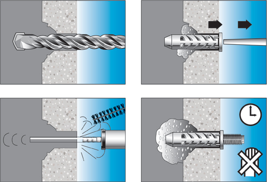

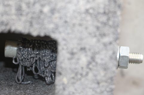

Onoff Posted January 30, 2018 Posted January 30, 2018 Resin with a mesh sock? http://www.fixfirm.com/category/fixings-screws-nails-anchors-chemical-anchors-resin-injection-anchor-sleeves 1

Russell griffiths Posted January 30, 2018 Posted January 30, 2018 Mr @Onoff has the right answer a resin anchor with a mesh sleeve or sock as he puts it, used in civils work when fixing a stud into hollow blocks.
Onoff Posted January 30, 2018 Posted January 30, 2018 (edited) These sorts of things: & this: https://www.rawlplug.co.uk/products/bonded-anchors/bonded-anchors-accessories/installation-accessories/r-pls/ Edited January 30, 2018 by Onoff
mvincentd Posted January 31, 2018 Posted January 31, 2018 https://www.hilti.co.uk/anchor-fixings/injectable-adhesive-anchors/r4803
